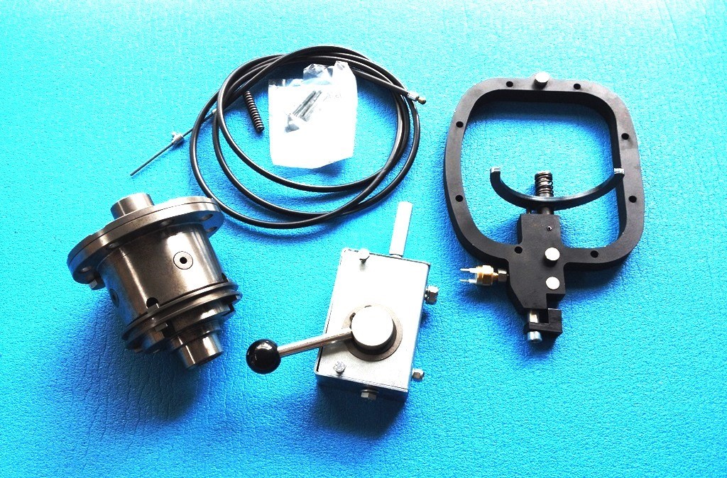

Rear axle diff lock kits are available from Italy with manual on/off, same as Y10 4x4 rear axles will do the trick.
fiat 5933627, and
BLOCCAGGIO DIFFERENZIALE PANDA 4 X 4​
