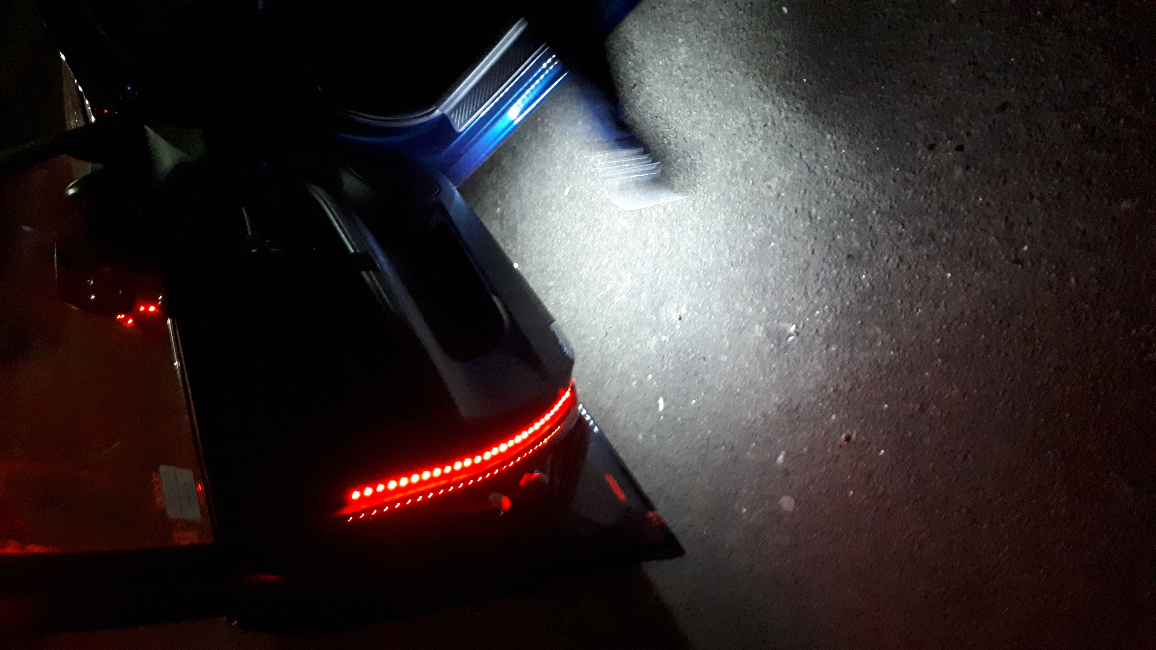

Not the Fiat but I used black faced red led light strip up the side of the doors and white along the bottom edge.(picture sideways)

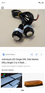

I got a pair of these off eBay and fitted them to the Stilo boot light wiring. Pretty bright and the only thing is that I am at the mercy of the lighting control of the car. I was thinking about fitting a on & off switch, to give me the better control.
Use a relay and separate feed(from the battery) then you can switch any load? Be sure to use a blocking diodereverse polarity) across the relay coil.
