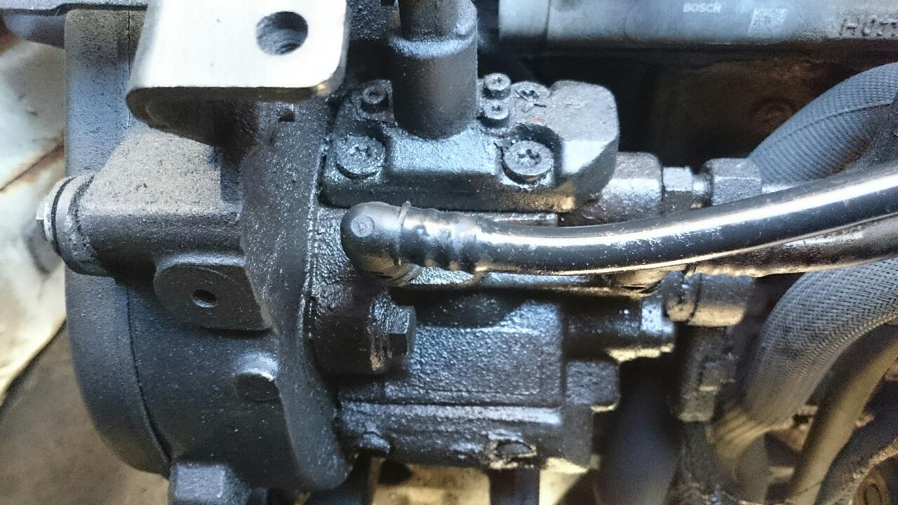

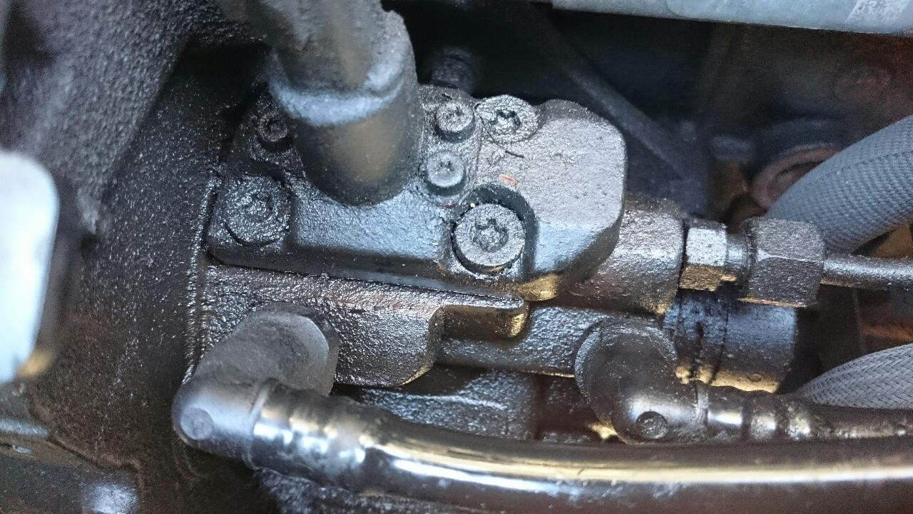

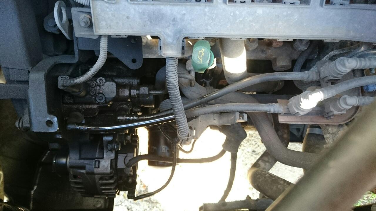

Hi all, hopefully someone can help with some info.
I have a 2004 1.9 Diesel Turbo JTD which has developed a leak from the main diesel pump in the engine bay. I have uploaded some photos and the leak seems to be coming from under the rectangular box on top of the pump which is held on by what looks like 4 rather large, 5/6mm, torx head bolts. I have rang Fiats and they do not list an O ring or gasket for this part as it comes comlete with a new pump attatched. It looks like it will unbolt which is why I thought you may be able to replace an O ring or gasket. Any ideas or help with this is much appreciated as need to get it fixed asap.

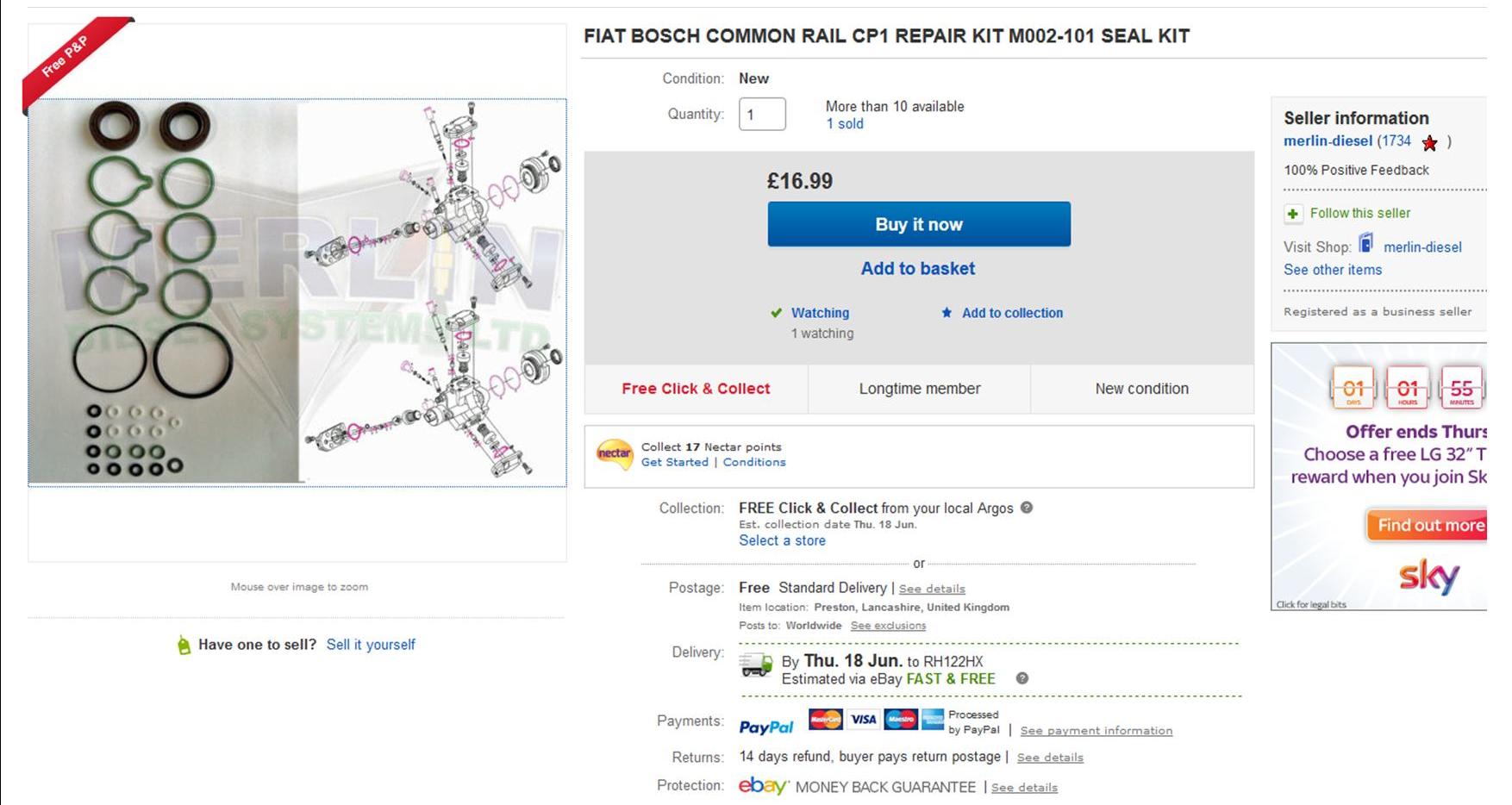

Search eBay for cp1 seal you'll get full kits for about £20. You'll need to clean that meticulously before you remove the third piston solenoid any crud getting in there could be a very expensive bill for pump and injectors.
Many thanks for your reply ecunotemu. Will order one of those up and give it a go. There had to be a seal in there. Fingers crossed. Thank you.
