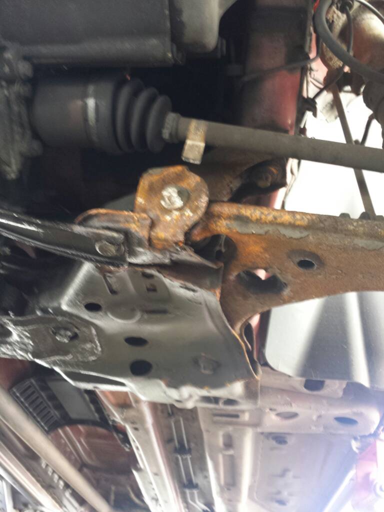

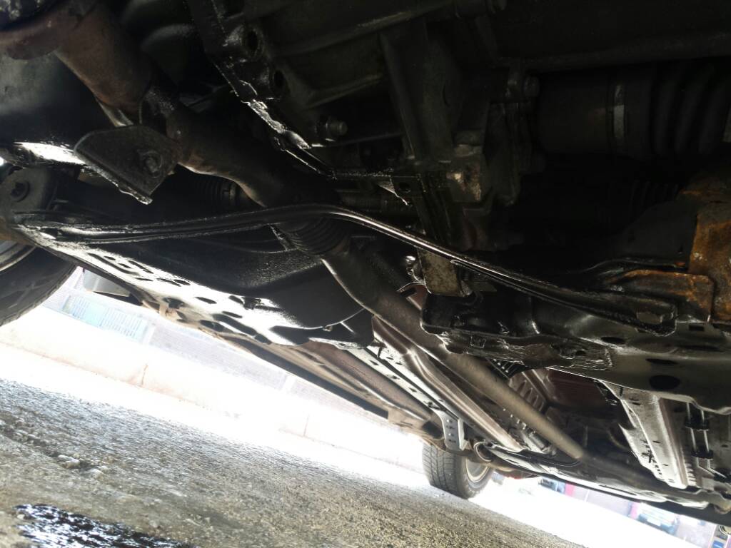

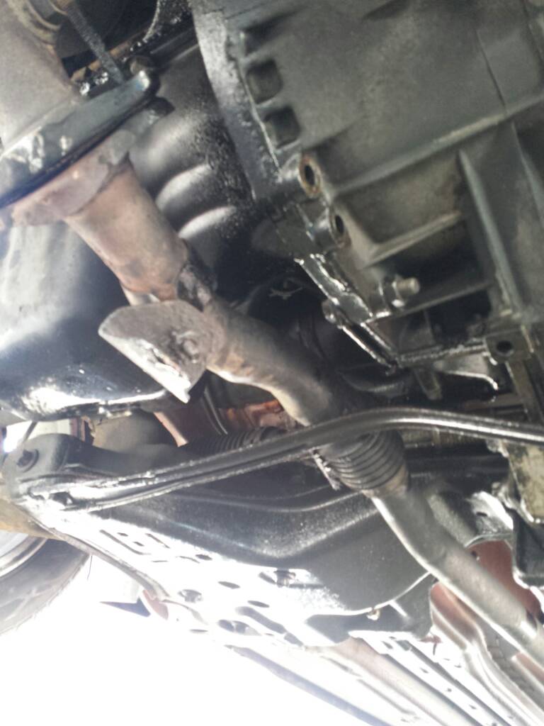

Got pics of the subframe damage....
Excuse the oil leak. This is a preexisting problem and was due in to be getting sorted this week :(
As you can see the brace has been pushed up and snapped the exhaust close to the flexy, and the passenger side of subframe has been bent up, resulting in the wishbone bending, well bowing, and the shock has gone and the topmount has too.
So far I have a 2nd hand subframe, with 2new wishbones, 2new topmounts and 2new shock absorbers

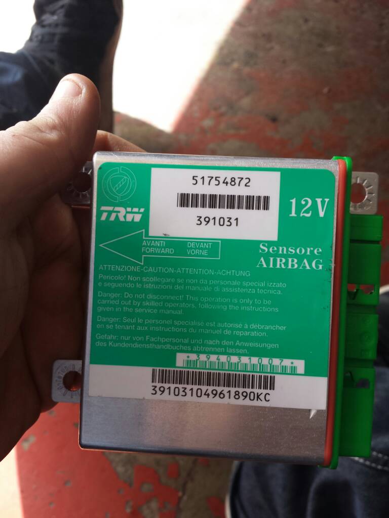

Question. This is my airbag module ...(1st pic) this is the only one I can find on eBay that comes from a car with 6airbags... So will it work? Also what numbers am I looking at? Also what do you think of getting them reset?
Part number is the very top 8 digit one, they don't match. Check Eper to see if one replaced the other, if it didn't I'd go down the resetting route (y)
