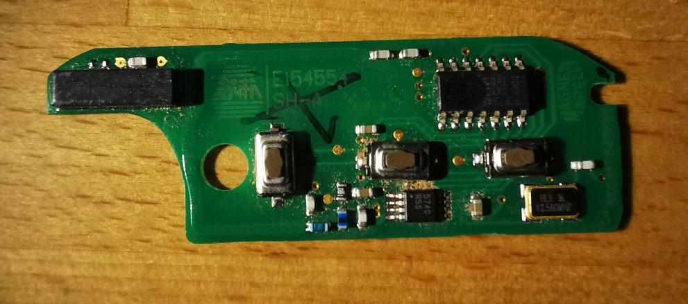

I can only speak on my own experience with the 2011 Ducato keyfob, which looks like this:
Probably the one for the 2012 Panda is exactly the same.
The original PCB looks like that:
I was able to buy this pre-programmed PCB on the internet, but when I checked a couple of months later they were no longer available. I was told that there are virgin PCBs still available that might be pre-programmed at distance, but some data have to be read from the BCM / ECU (I can't remember which one) probably with an EEPROM reader. That cannot be done with MES nor AlfaOBD. It could also be done by a specialized workshop who can get the data from the BCM / ECU in their workshop.
The black rectangle on the left is the immo transponder. It is inducted by the antennae around the ignition. Diagrams could be found in ePER (for the location and part numbers) and in eLearn (for the functionnal description and wiring).
The other part of the PCB (the locking / unlocking buttons) is powered by the battery on the other side of the PCB.
These are two separate functions of the keyfob and both need separate programming in MultiEcuScan.

I agree with what @the green vanper has told you.
The chip he showed in photo ( top left of circuit board) is what the antenae ring around the key hole reads and there is nothing any one can do without suitable electronic equipment to change that chip as it is non powered and not connected electrically to the key fob.
Usually after using suitable computer to interogate the cars computer they program a new blank chip to fit in a key as they have boxes of unprogrammed chips. You can buy those chips from eBay cheaply but without the equipment , they are useless!
All the rest of that circuitry in key fob is to do with the remote key lock/unlock door side.
I have had many vans etc. with no remote function , they simply have that chip inserted in a slot in end of basic key and have no electrical attachment, it is merely read by that antenae ring around the key which sends that signal to the immobiliser side of computer.
