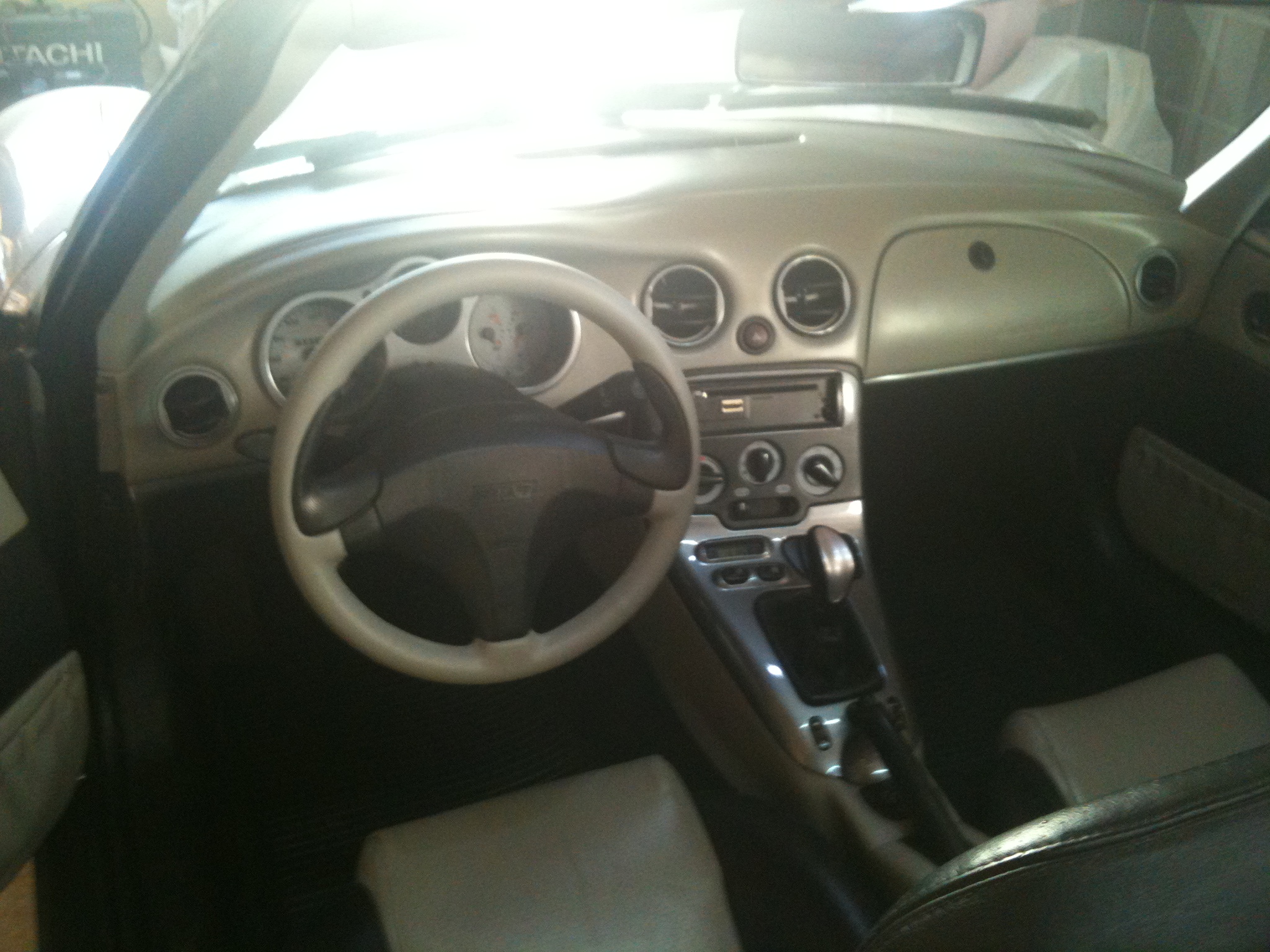

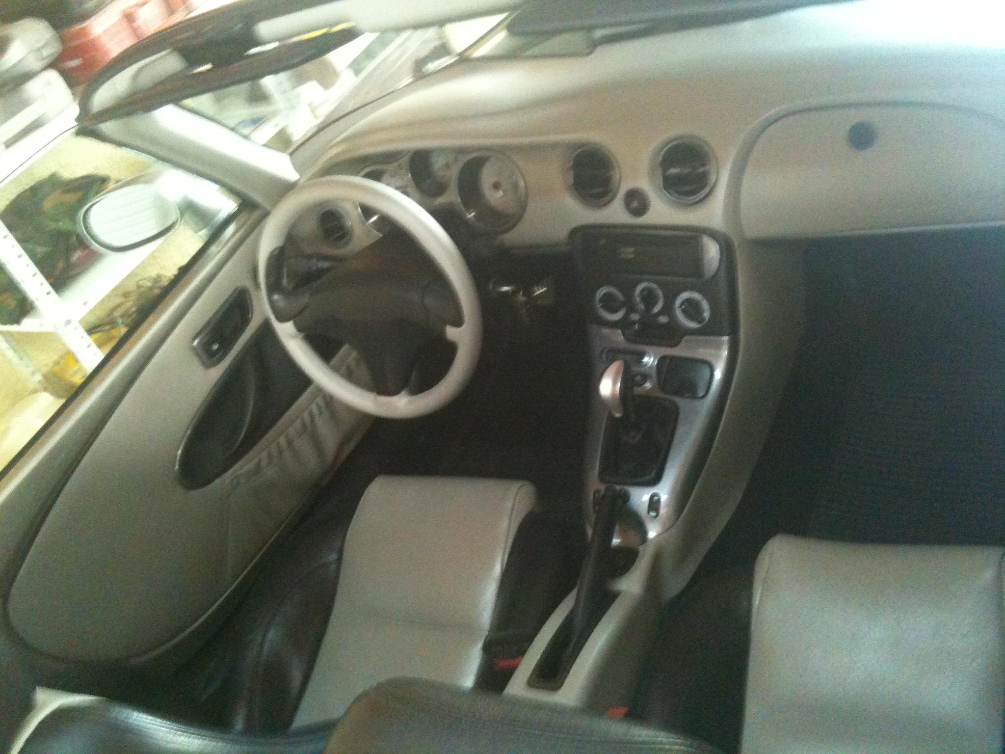

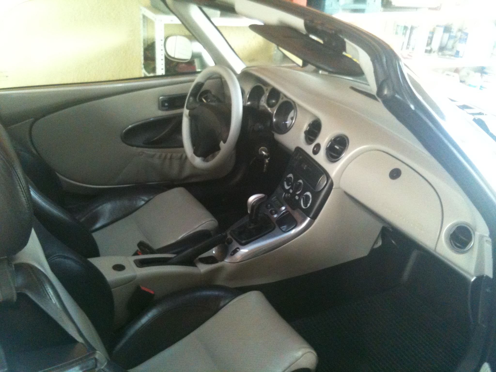

Hiya People! :)

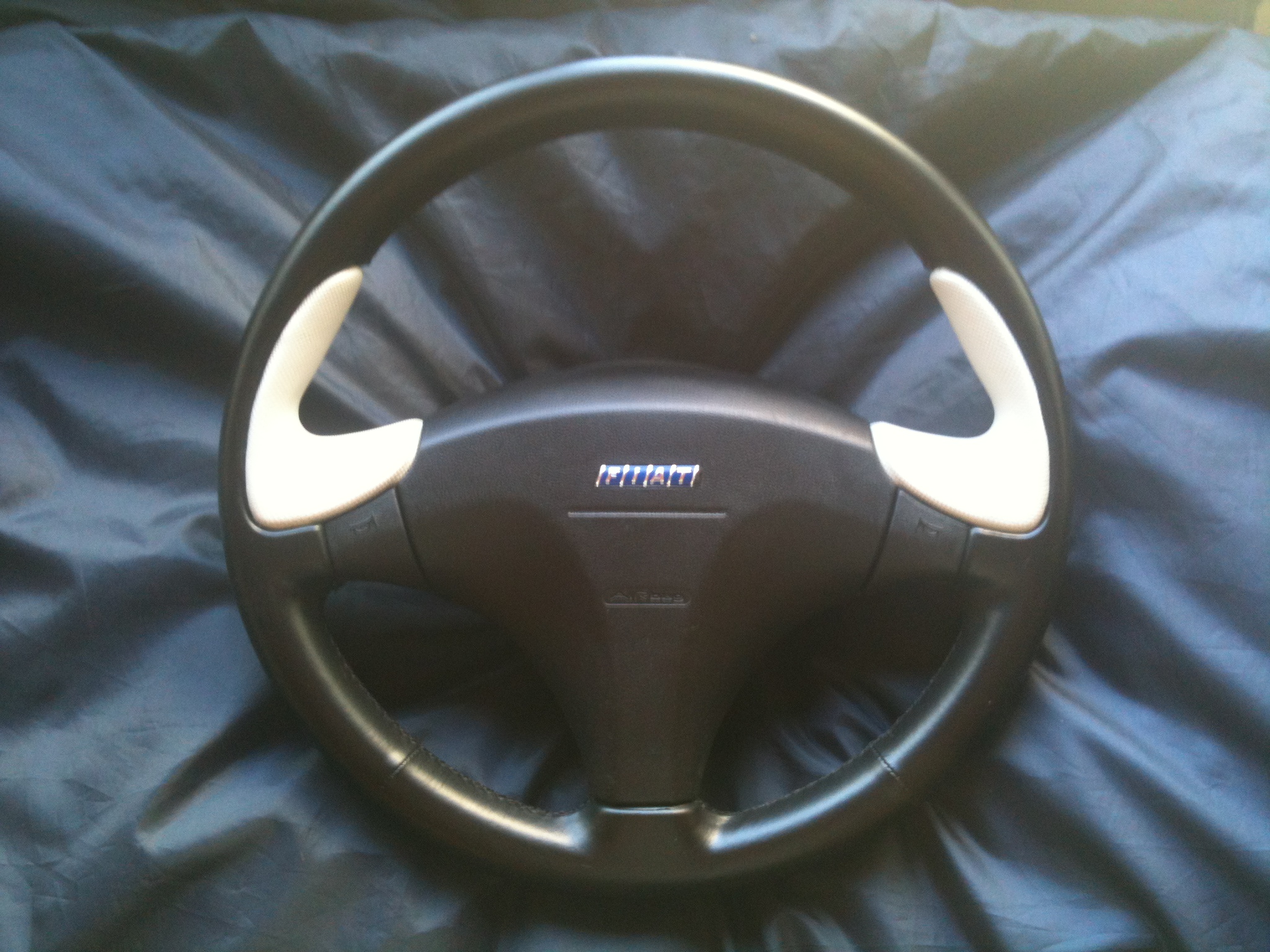

Been a while since I posted, just a few pics of my new interior as just got my wheel back.
The white one is for Bollie.. (y) but still waiting for your other bits.

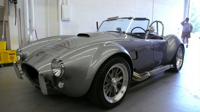

Discovered there is 5 shades of the 647 steel gray (silver) found on my B, mine is 3 shades lighter than dark, although I like the color I,m thinking of painting her something different.
This looks nice. :D
matte black will be awesome color... but it's pain to clean. every finger print is visible on that color.

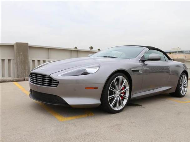

Hiya!
Decided on the color. :D

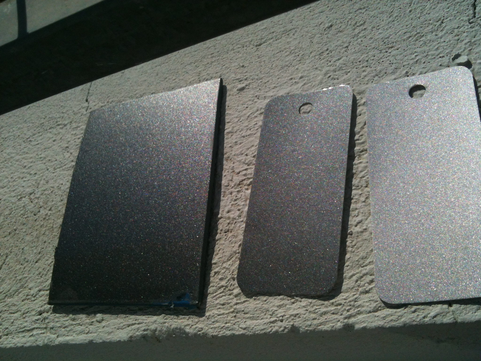

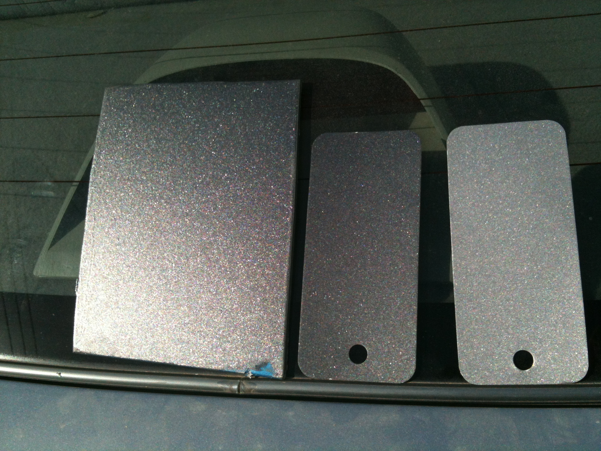

Tungsten silver found on the Aston martin and the color shown on the cobra..
Here's some color swabs I chose, its the far left with lots of metallic flake and some pics on a car.

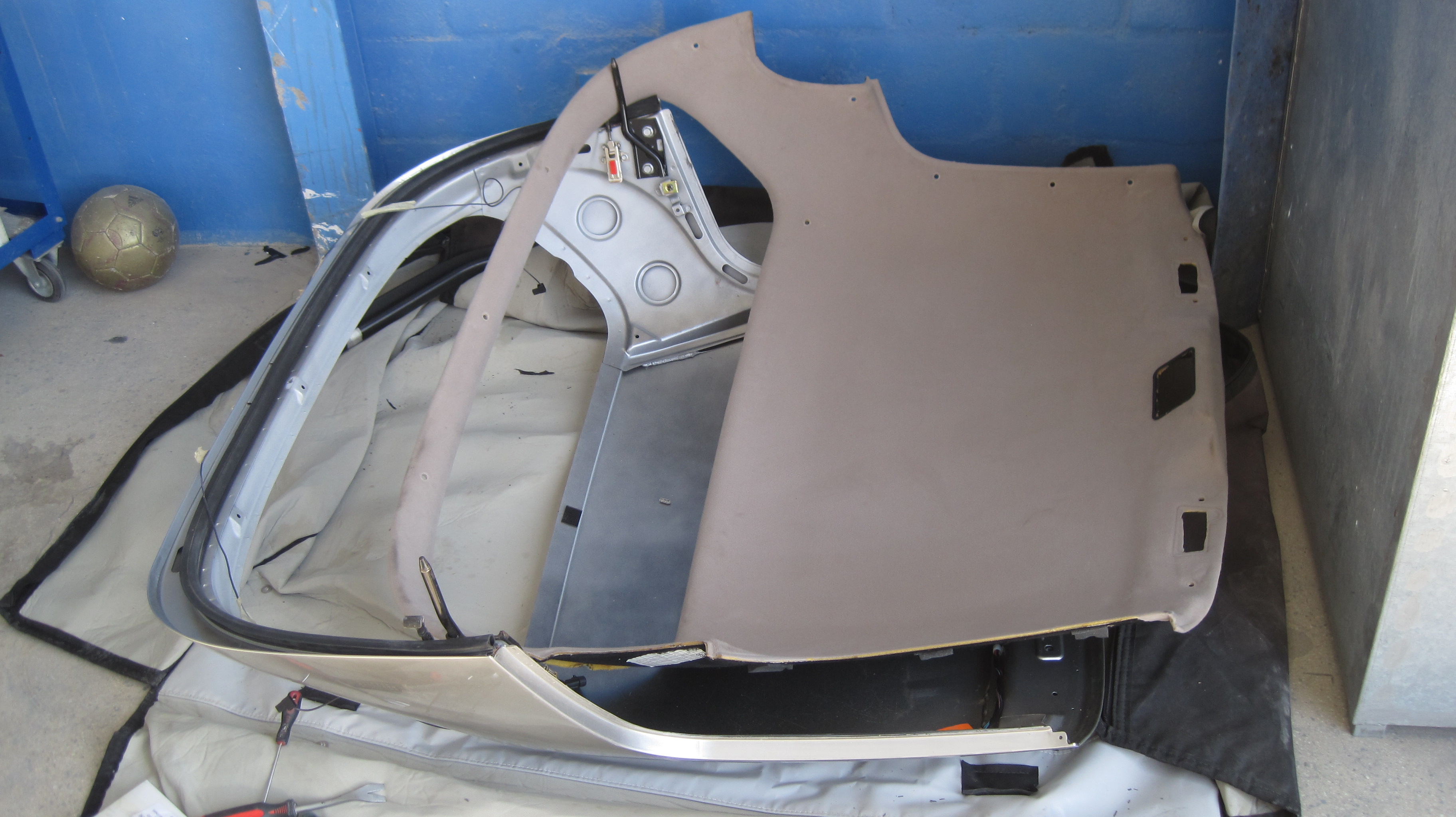

Some more work today! and some modification tweaks :D

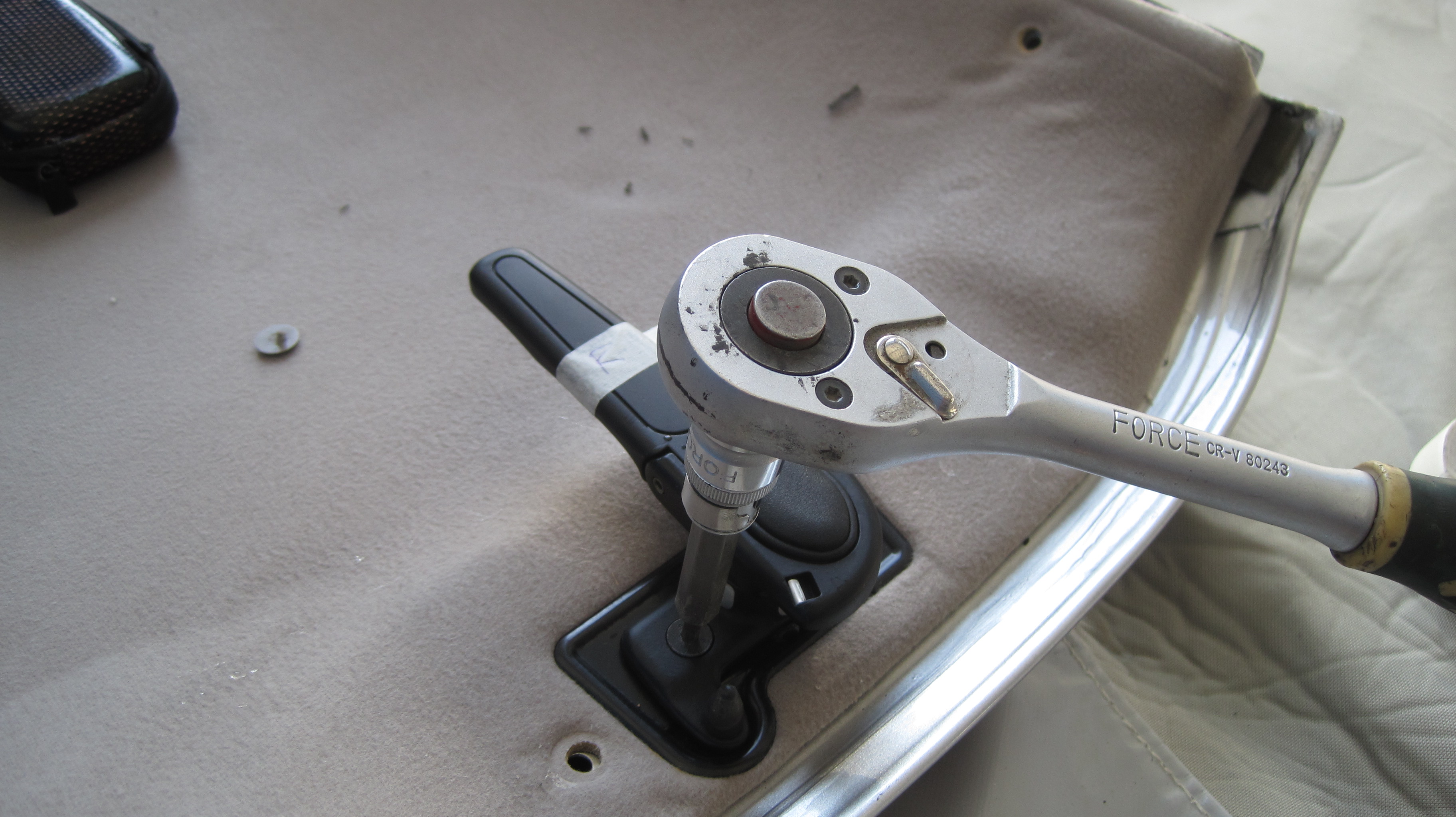

Stripped down the hardtop, and discovered the head lining was on it way out,
so will be fitting a new one. This is actually good because i can now change the color and add a more professional up to date material. IMG_2608.JPG

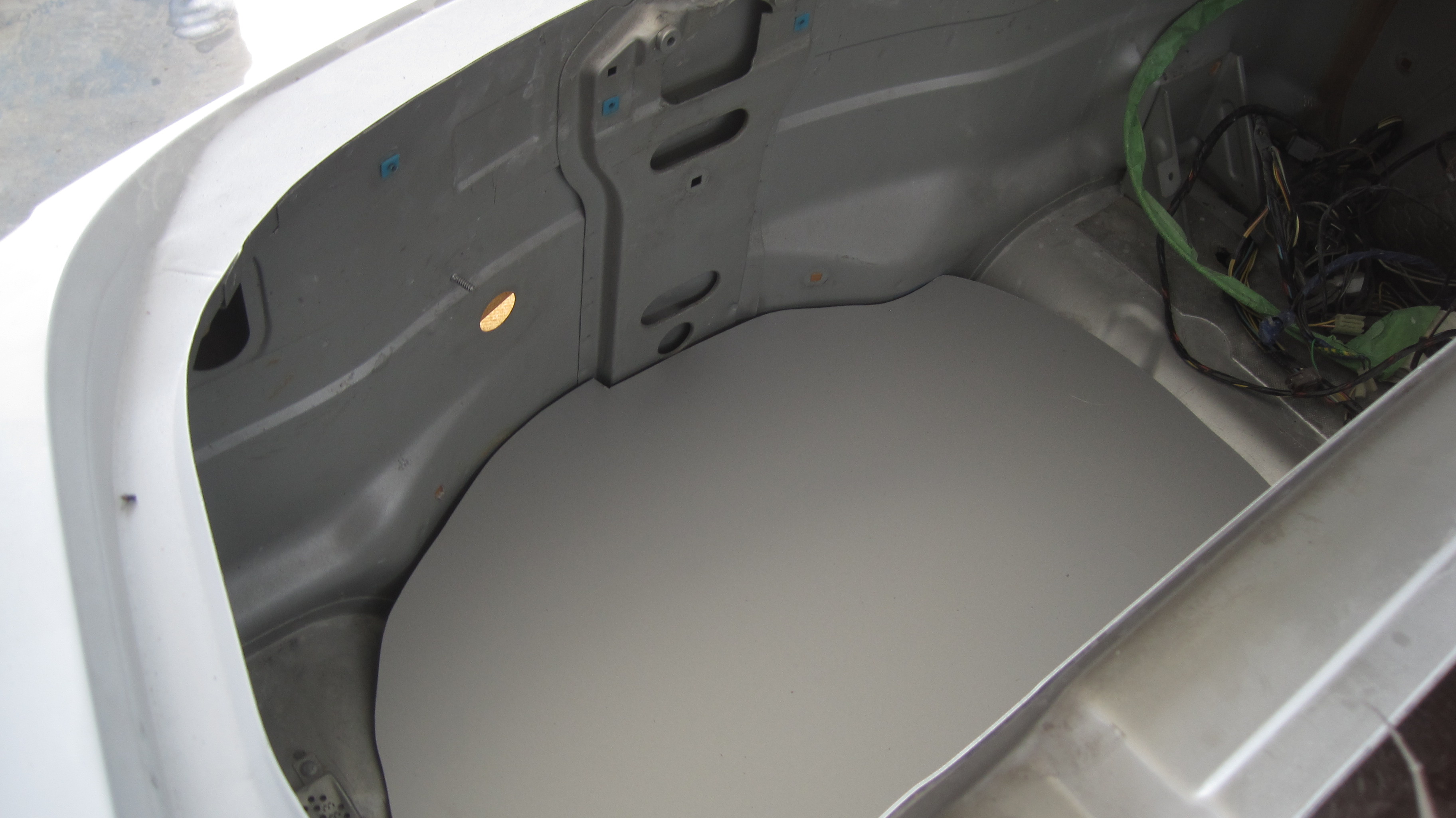

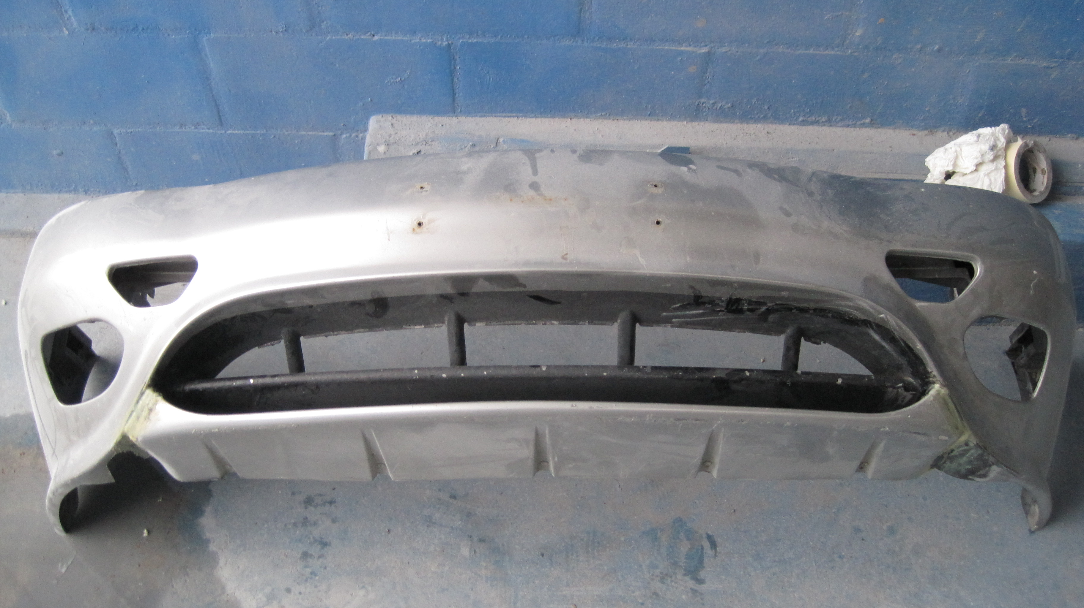

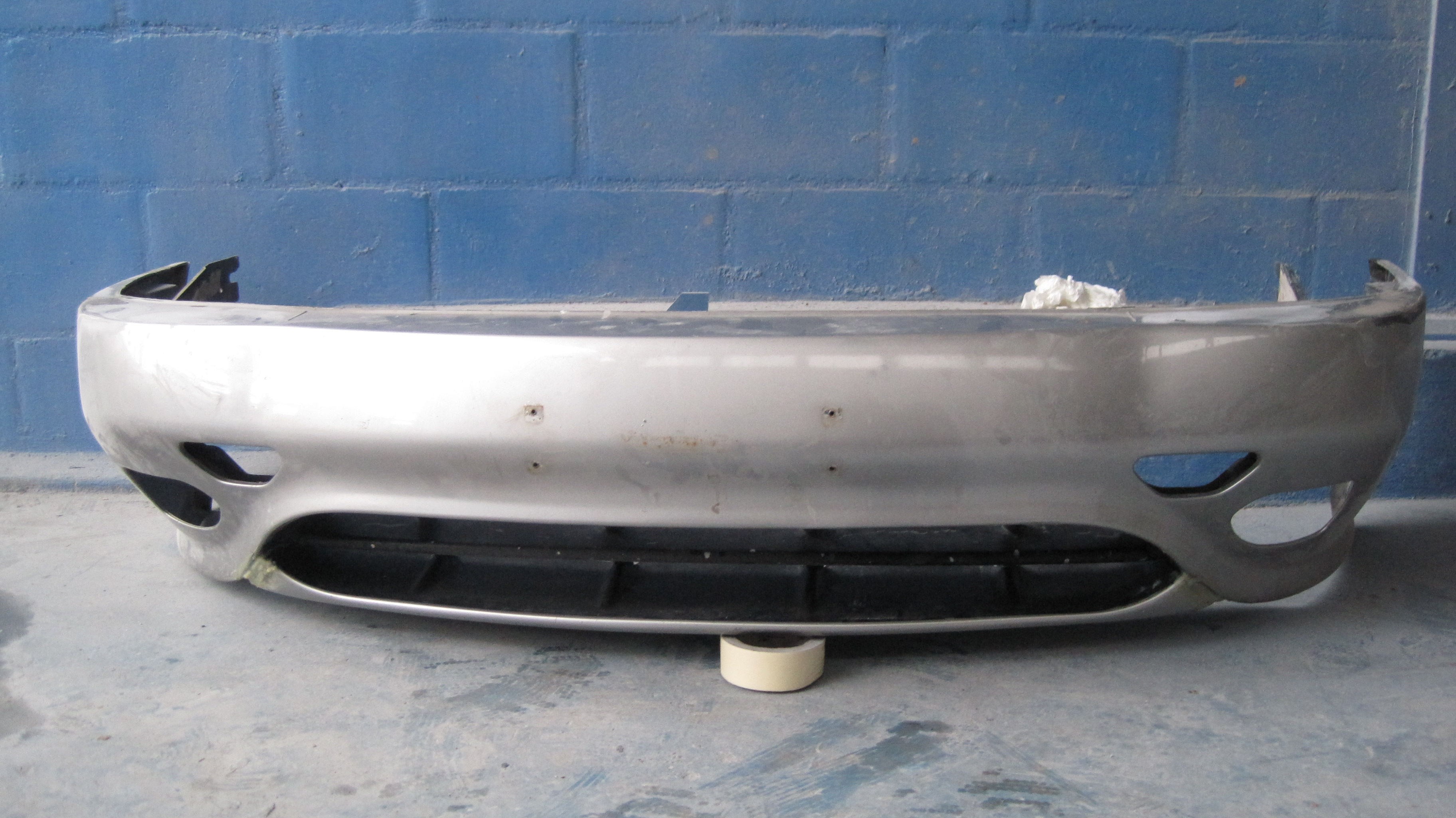

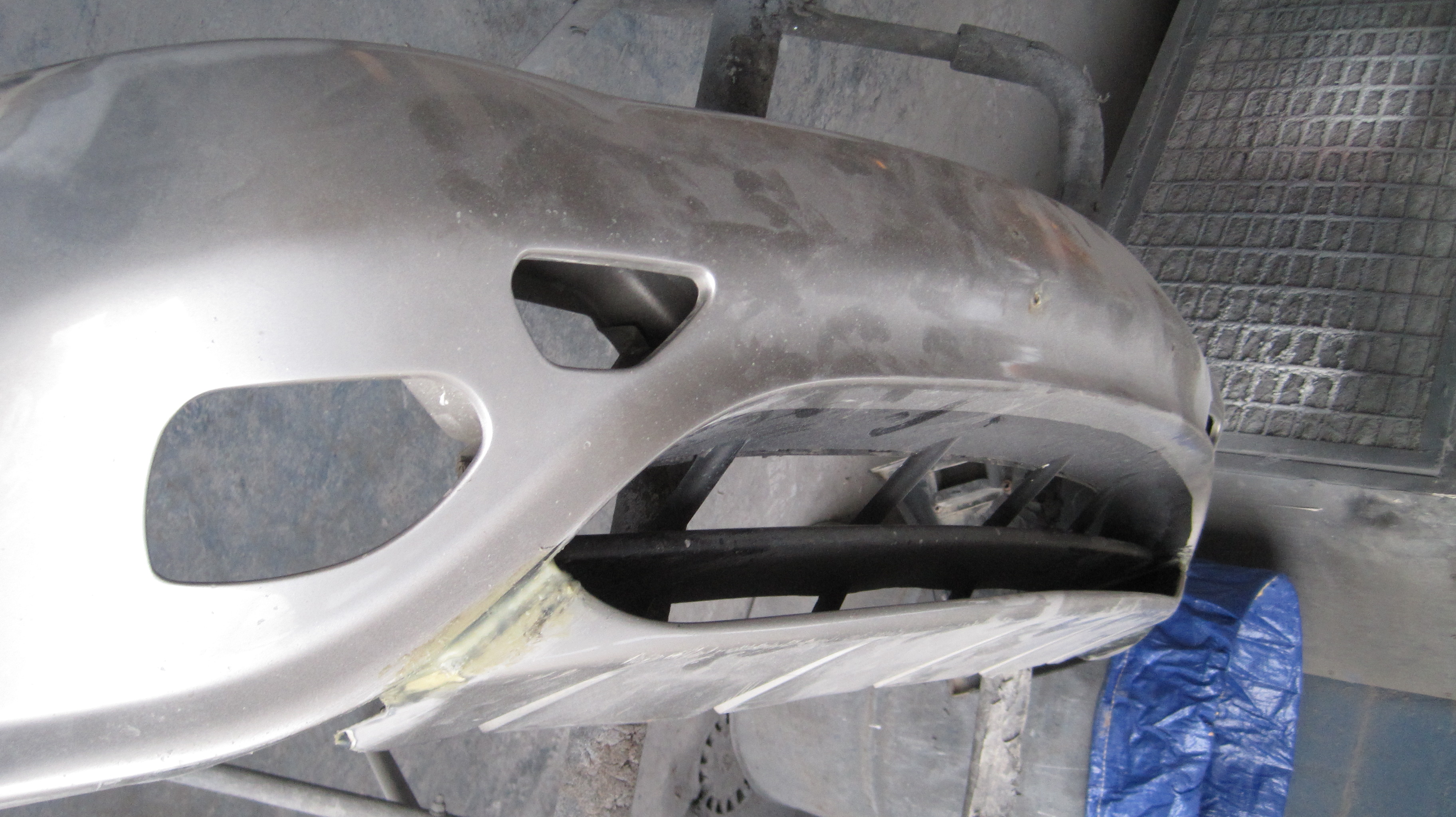

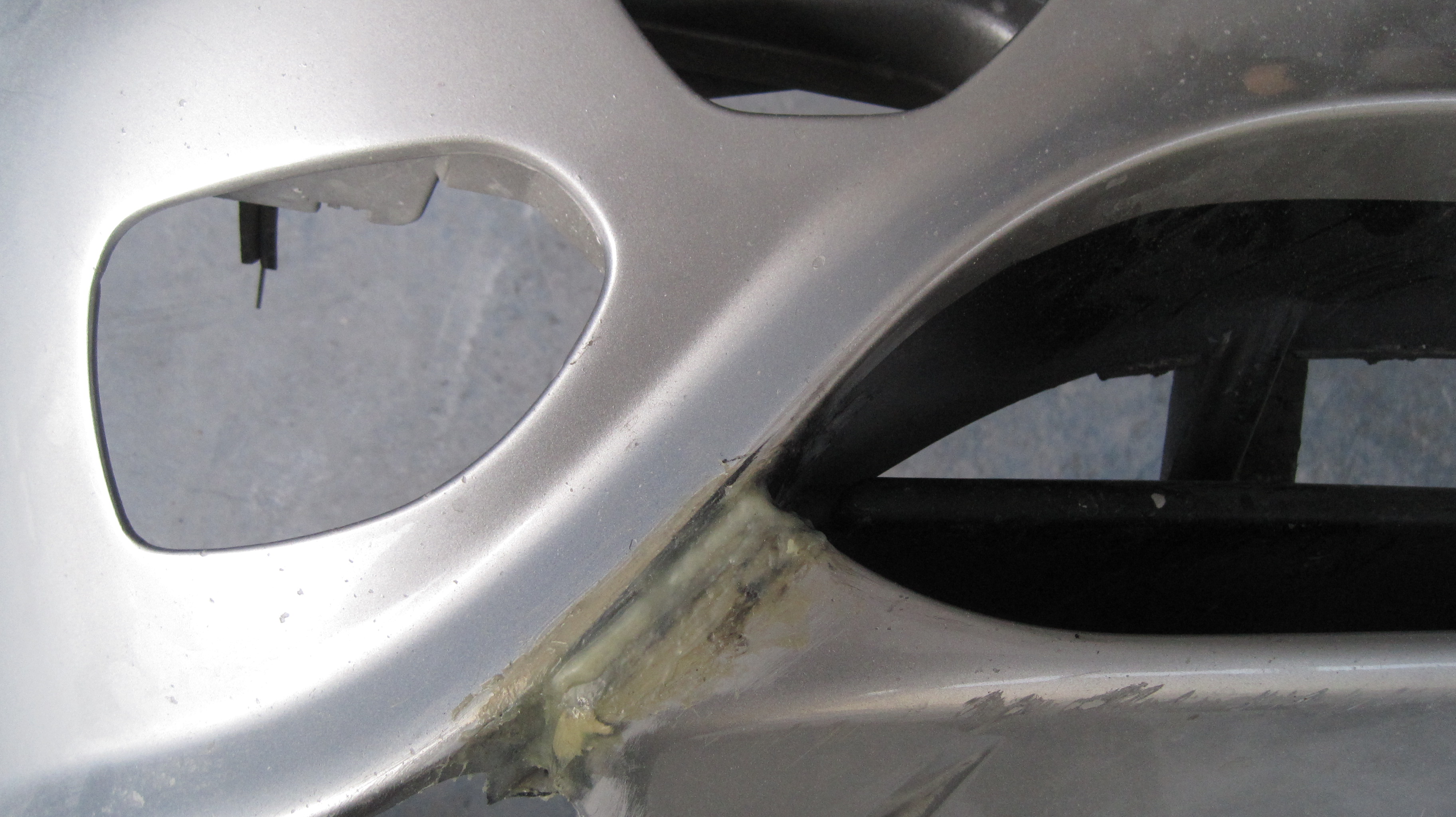

Also made some small changes to the front bumper where the Naxos lip spoiler sits. Where it joins the bumper there are usually gaps between the two pieces, but now I have filled the gaps so the bumper will look as one piece.

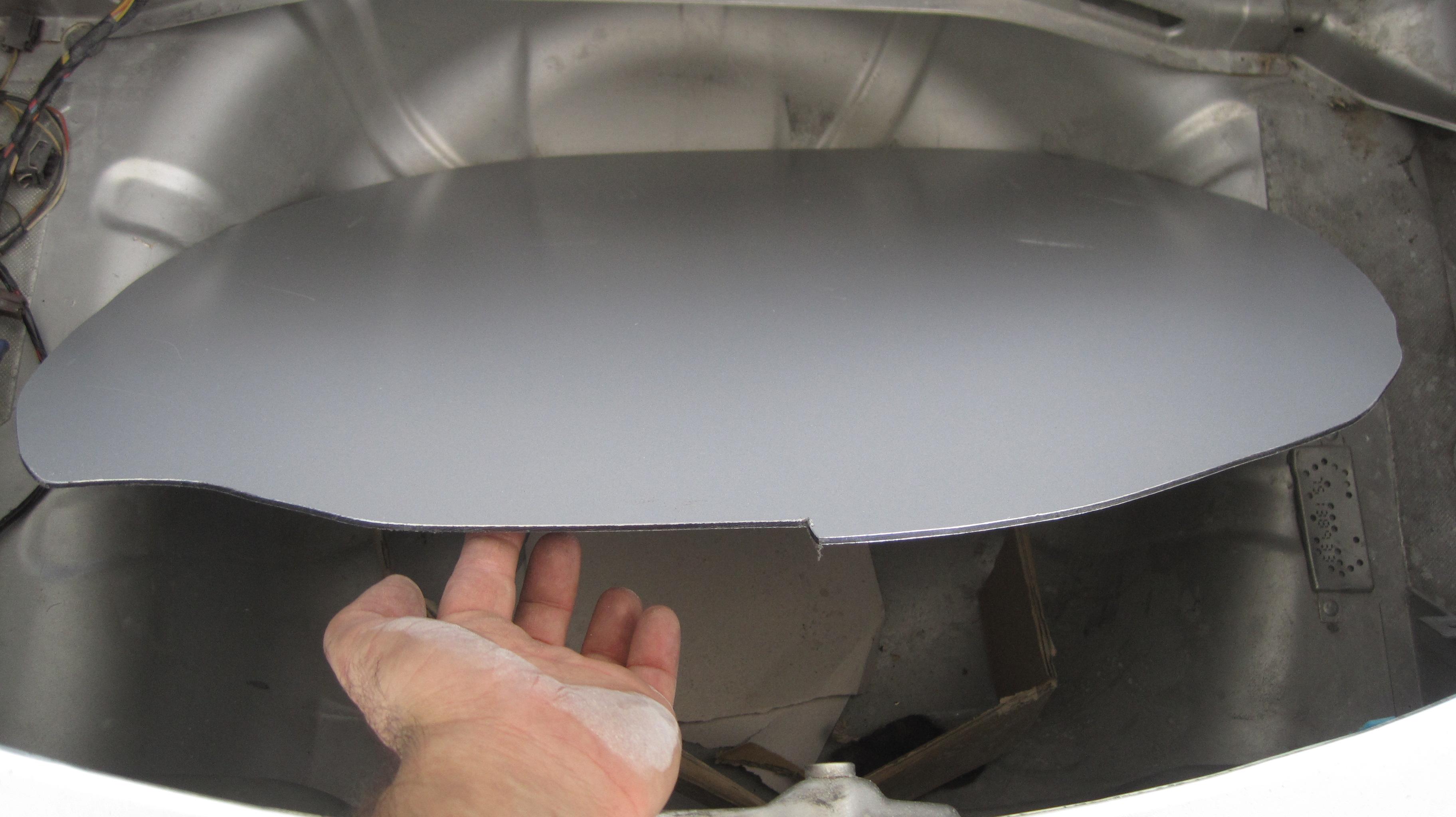

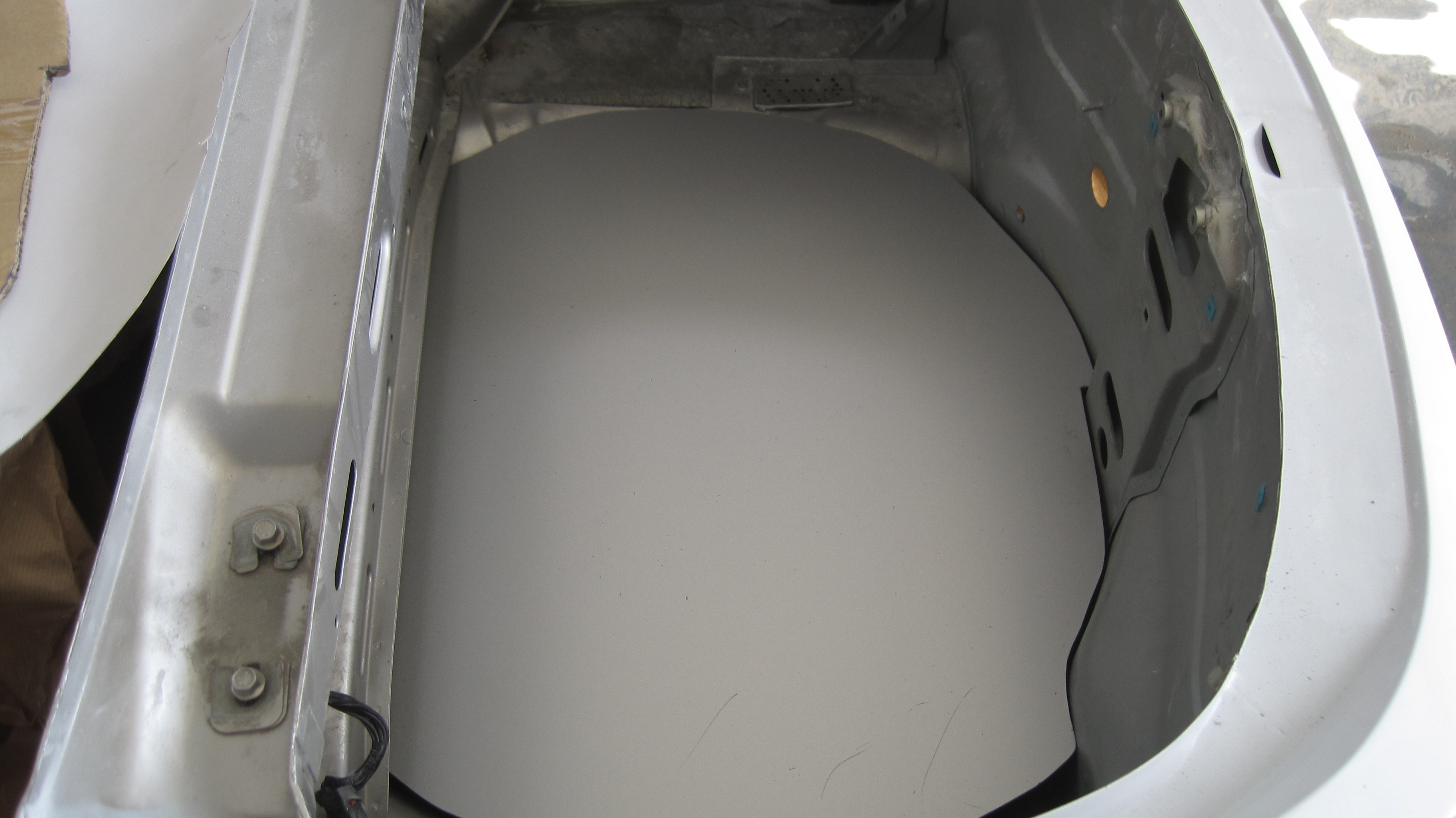

And in the rear boot, I have removed the spare, (with my brake mods, it wouldn't fit anyhow) and made a plate that will sit where the wheel once was. I've used the lite weight alucobond material that I made my battery tray with again and so have shed some overall weight from the vehicle.(y)
Indeed :) Completely changes the attitude from dolphin to shark! What did you use to fill the gap?

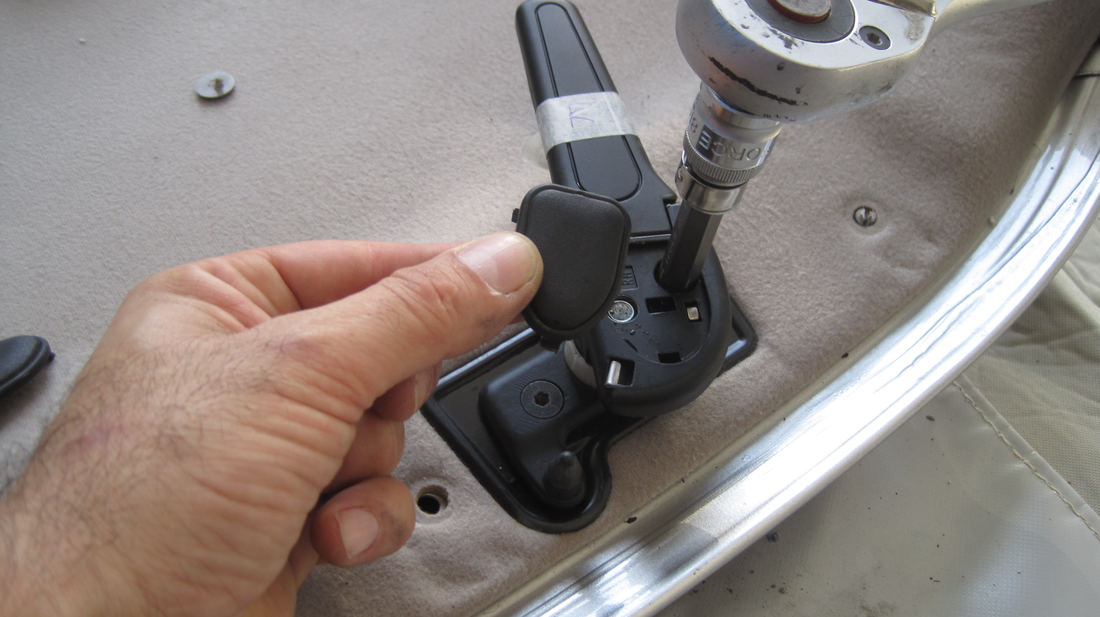

I had bought the upgraded window guides from Henk (Barchetta parts) a while ago and now had the opportunity to fit them.
This should allow the windows to adjust up tightly to the rubbers and reduce any unwanted wind noise. :)
