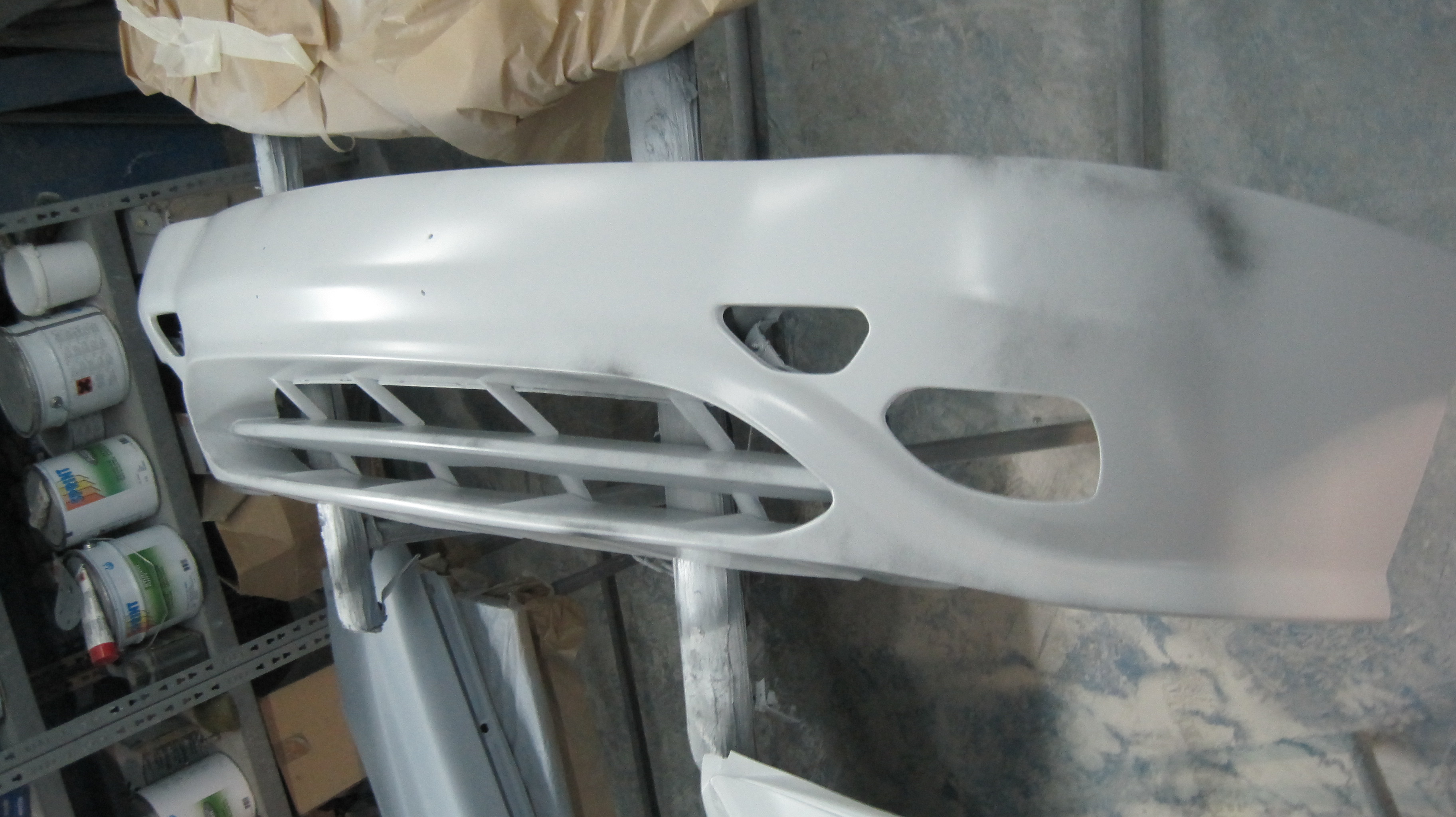

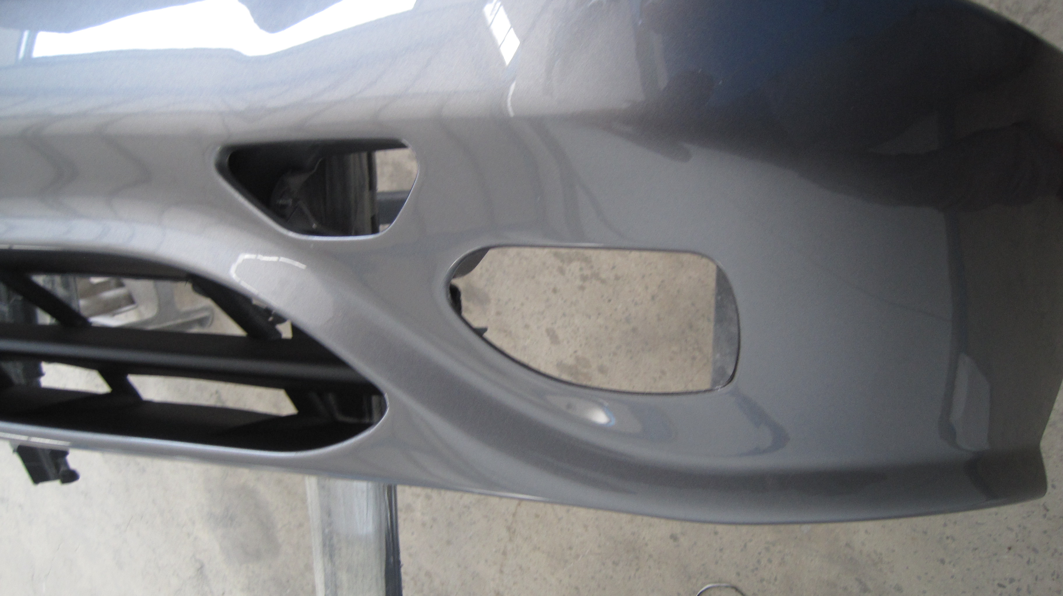

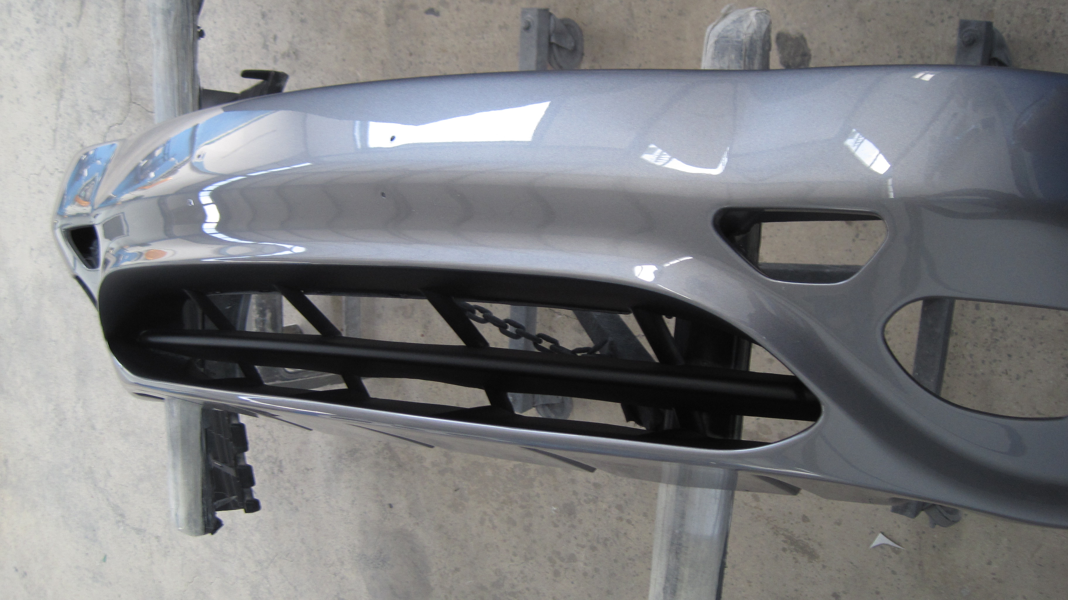

Love that bumper mod - it's amazing how such a small change can create such a different impression. Looks like it was always meant to be that way.

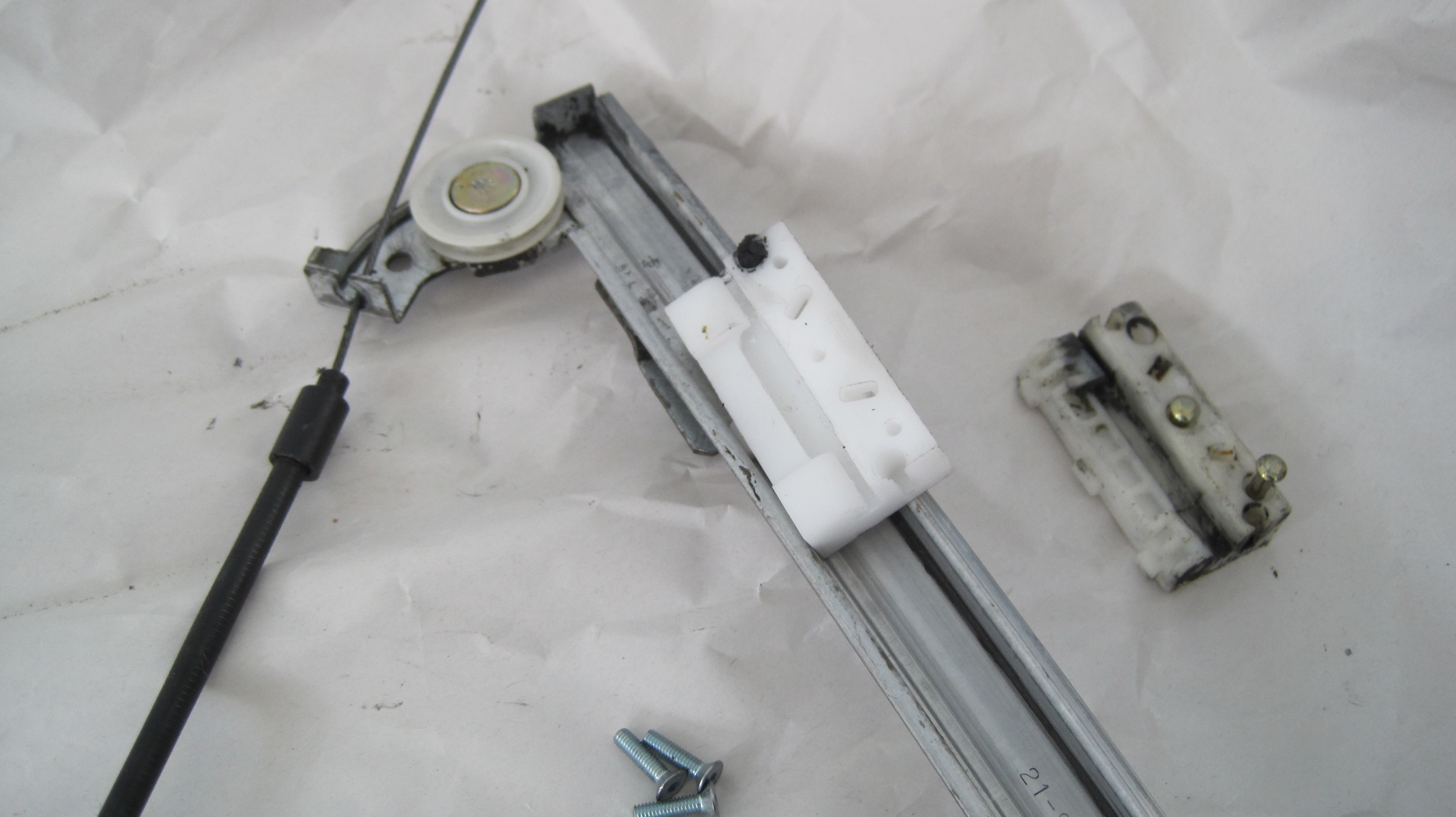

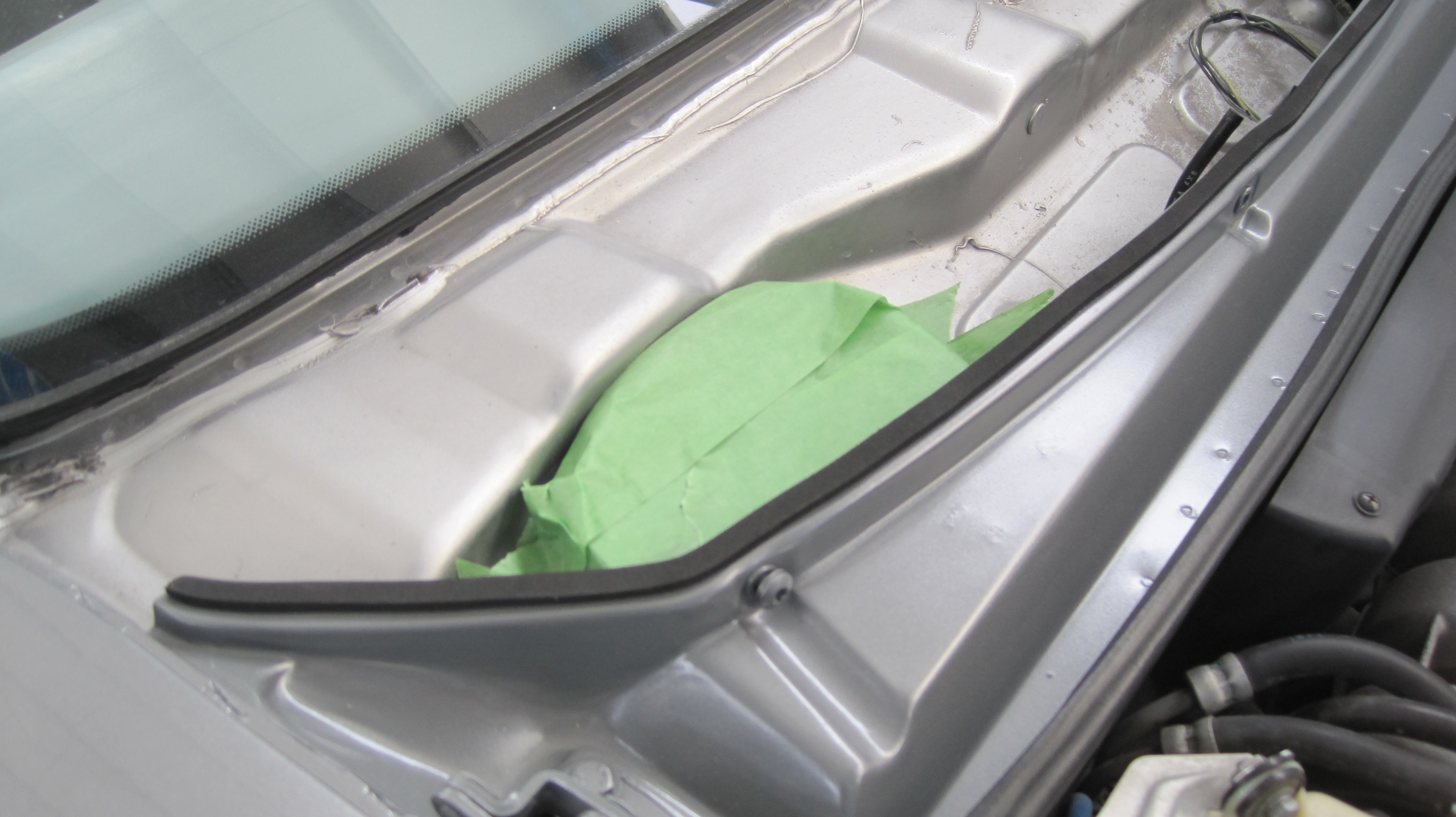

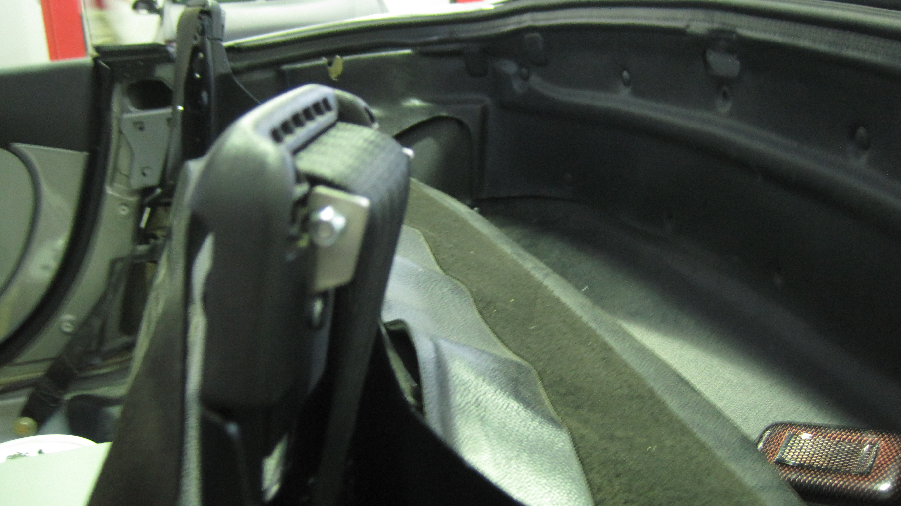

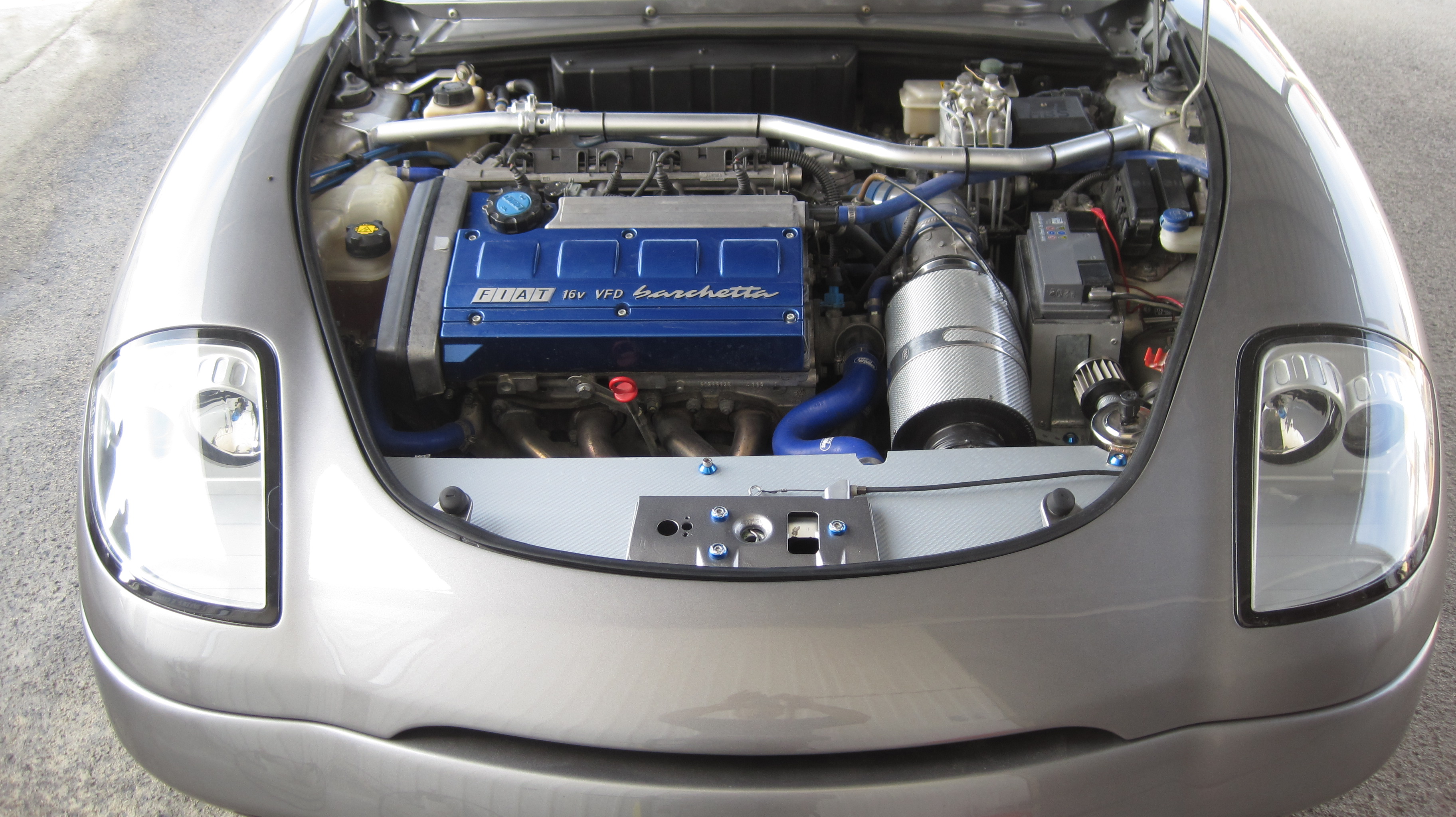

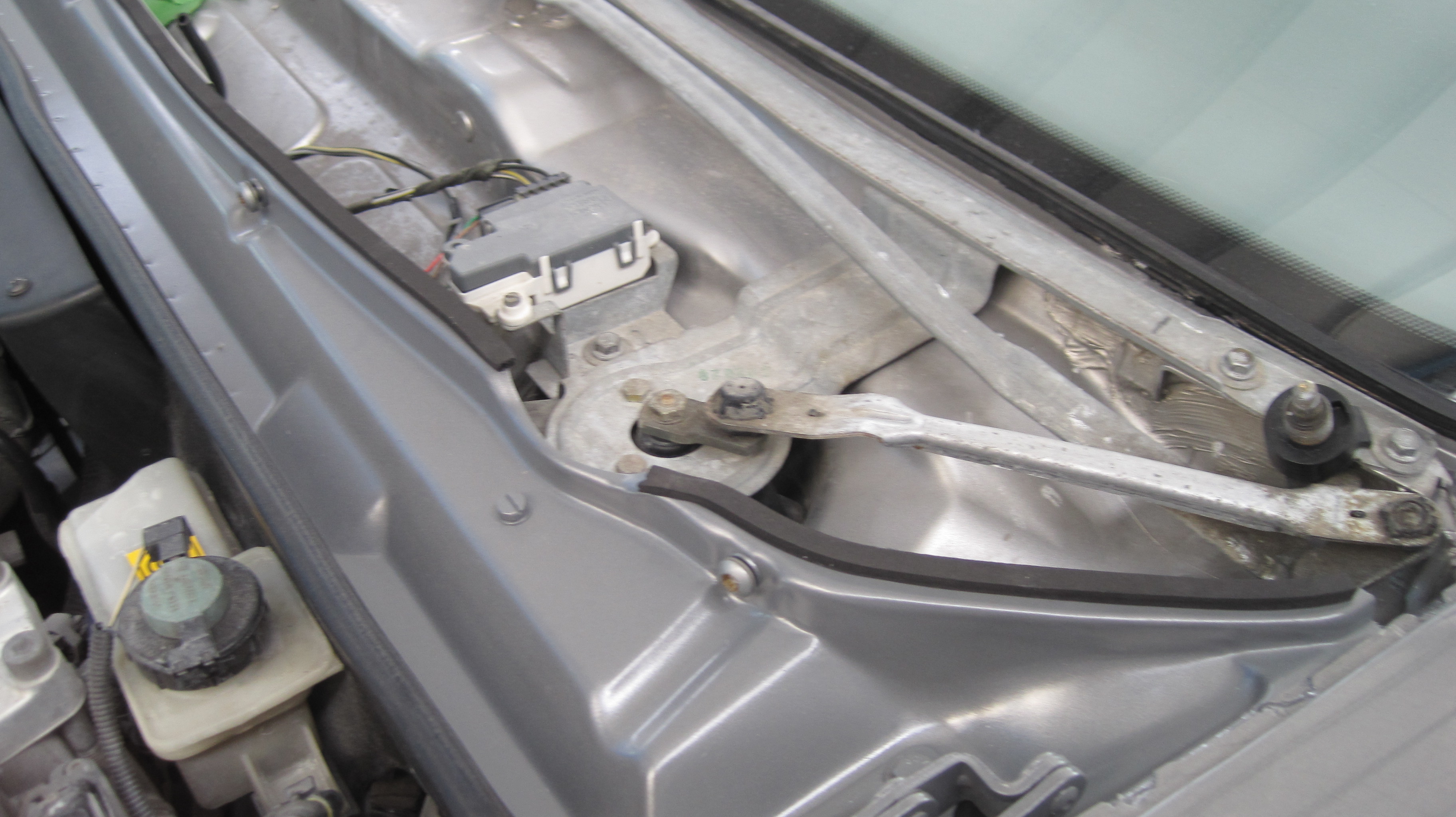

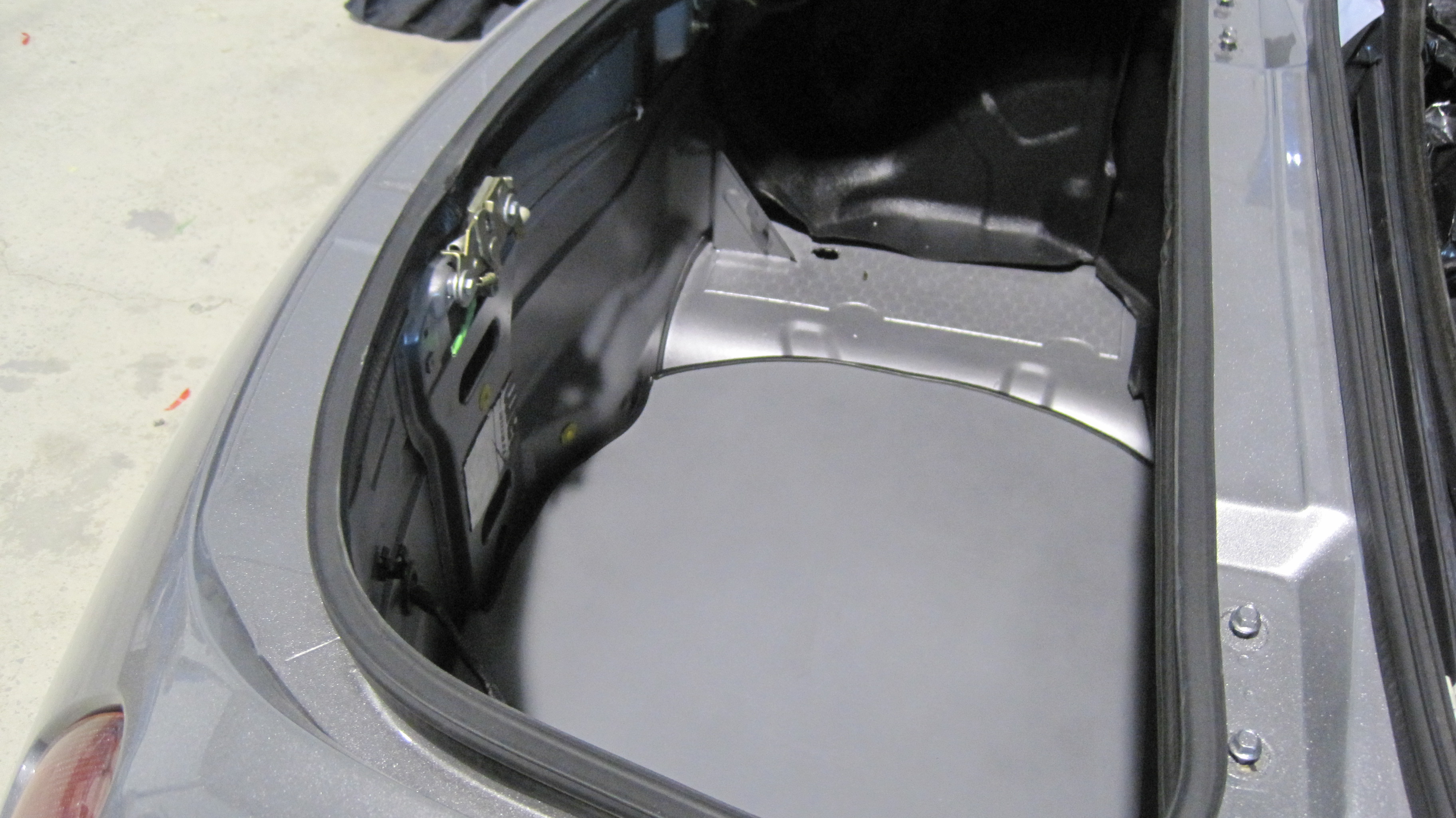

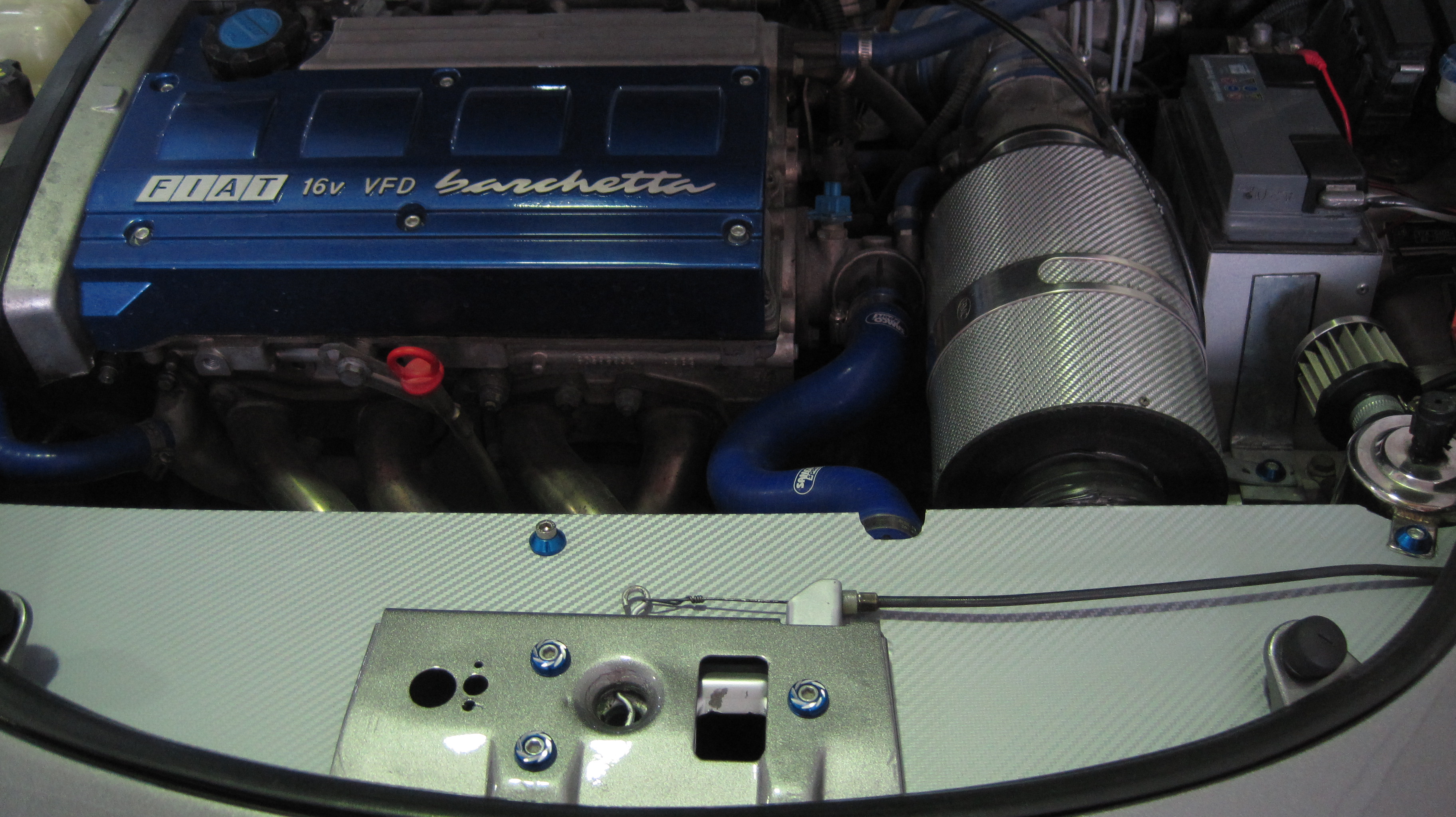

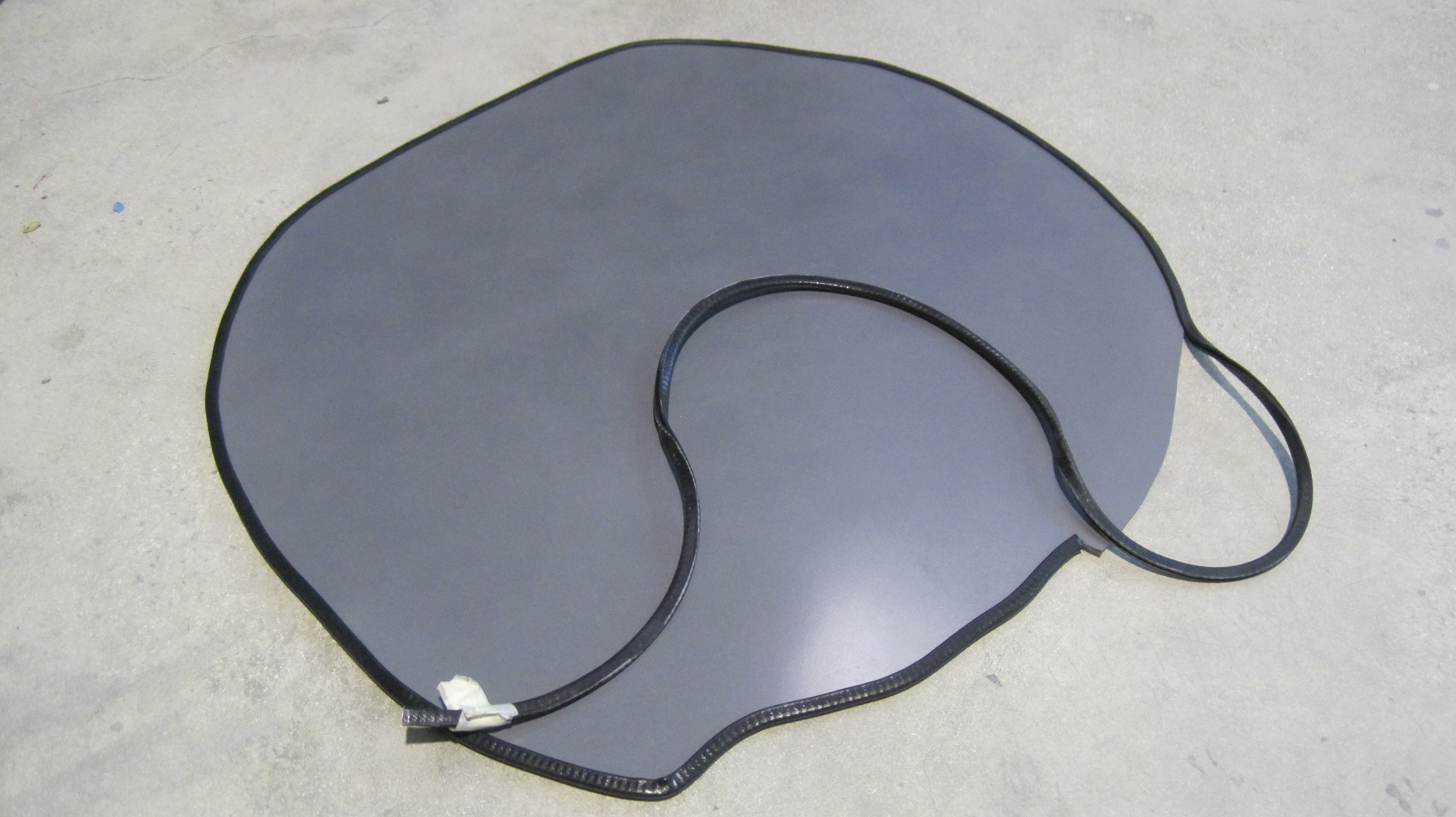

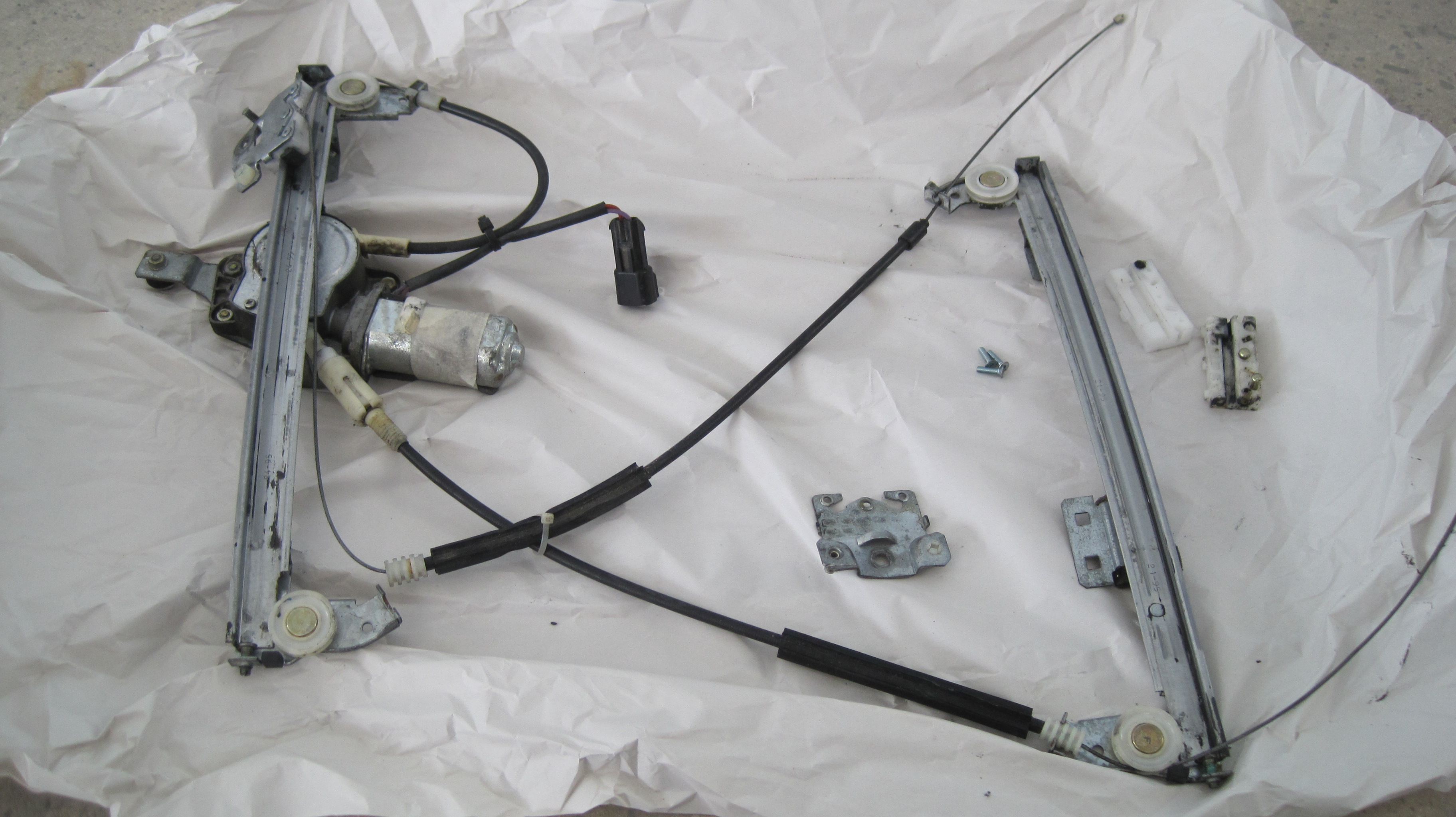

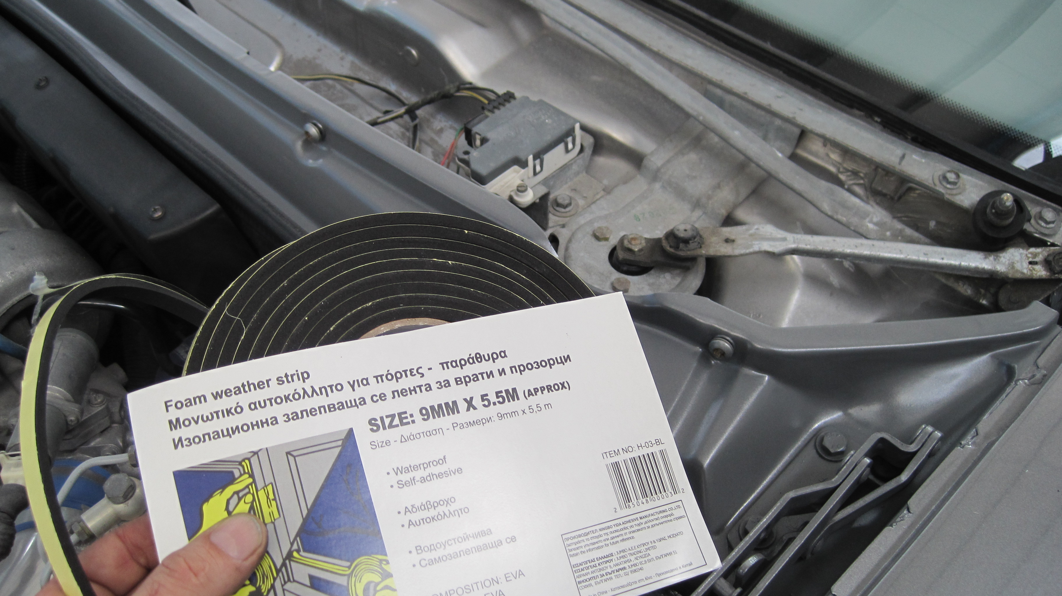

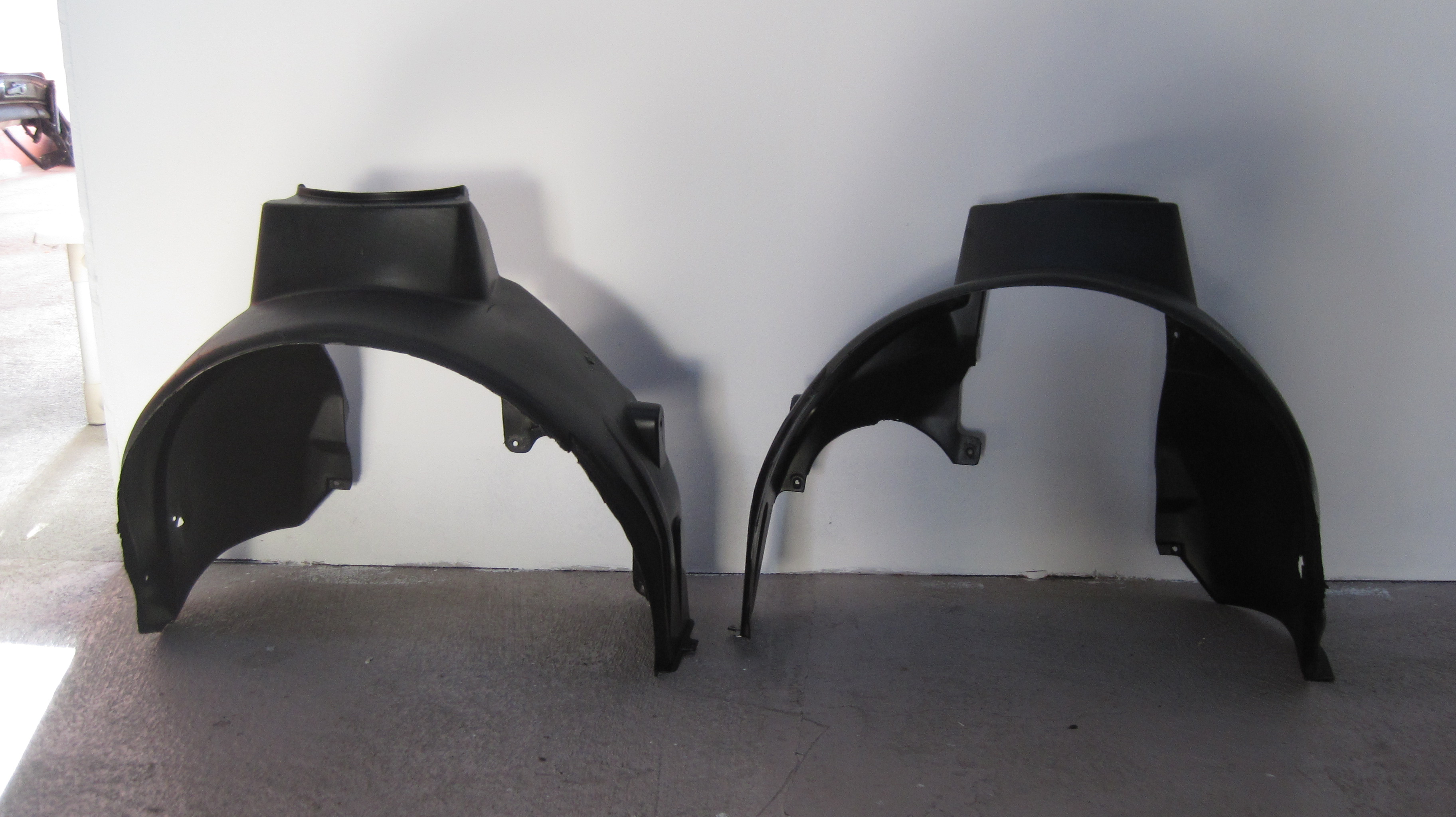

New window guides fitted, Center console prepped for painting, New rear tray instead of spare. Weather strip anti vibration on wiper mechanism panel.

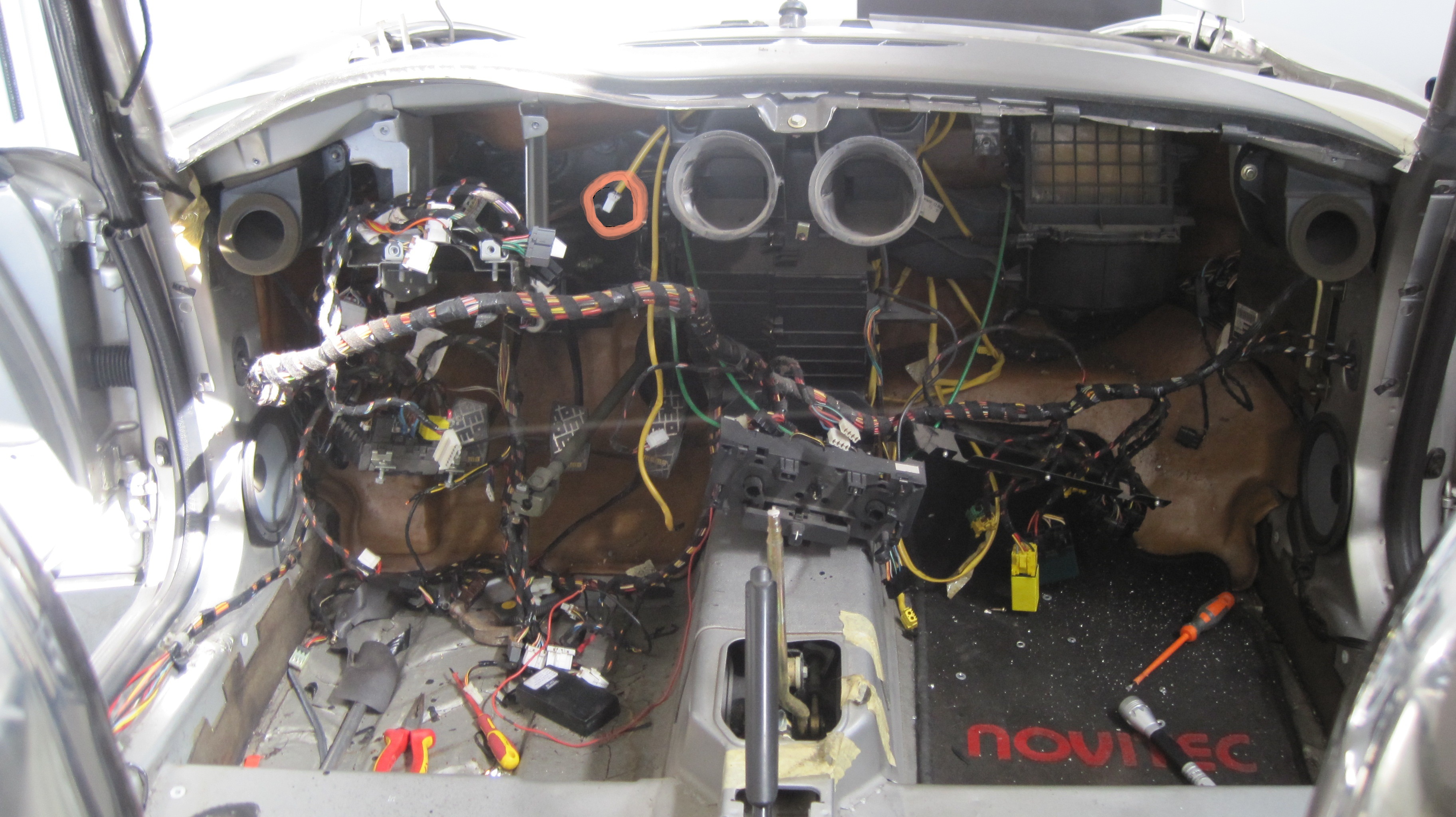

Does anyone know where this yellow cable plugs into, Its something to do with the air bag as my light comes on.
It was the only wire left after i last dismantled the B.

Yellow wires, one each side are for the seat belt pre-tensioners. Maybe worth removing the factory connector and using bullet crimps. It seems from other members that the length of the connector in the limited space under the seat stress and breaks the wire causing the light to come on when connected. (Search airbag light)
Tom
They go under the 'carpet' from the handbrake, under the centre consule and connect to the airbag control box at the front of the transmission tunnel, slightly to the right of centre, between the consule bracket and the firewall.

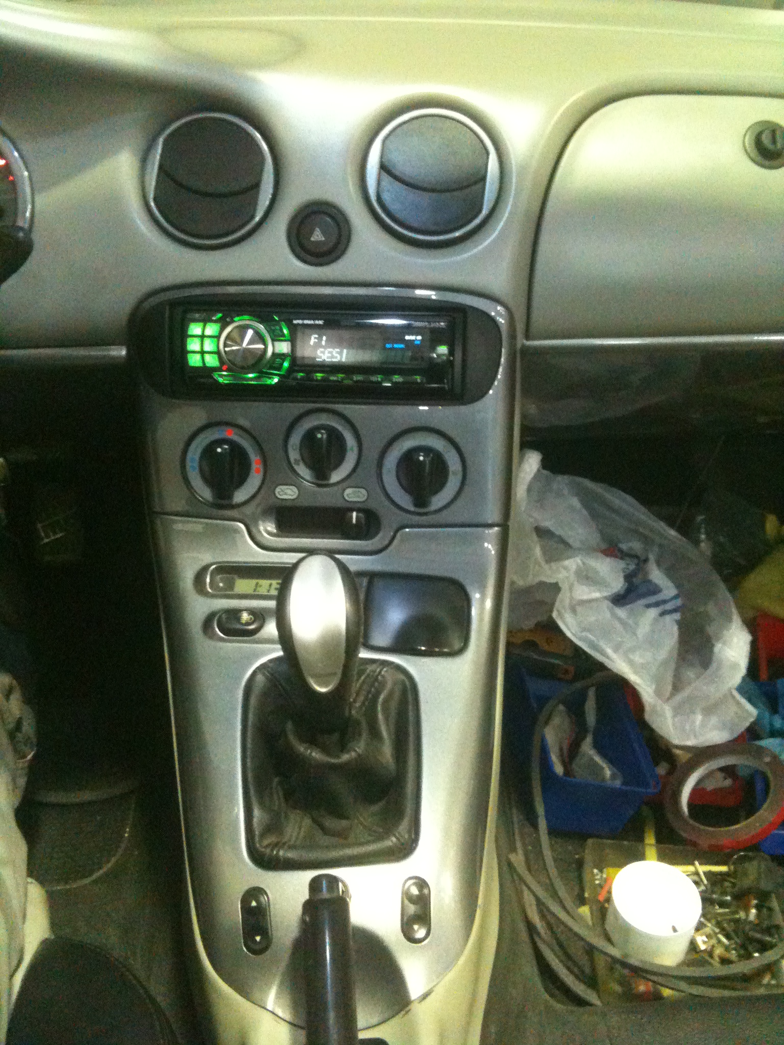

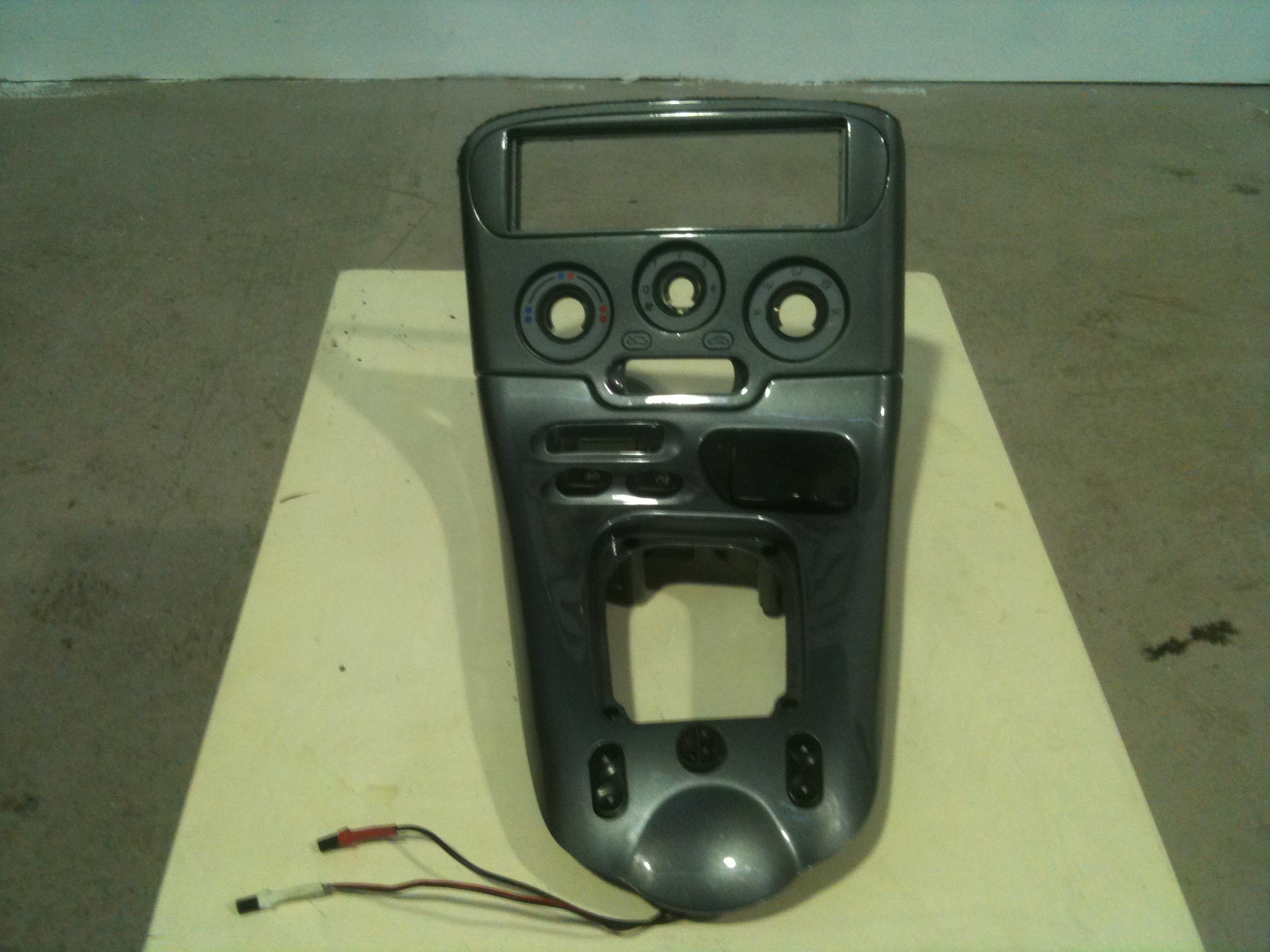

Pictures of the consule

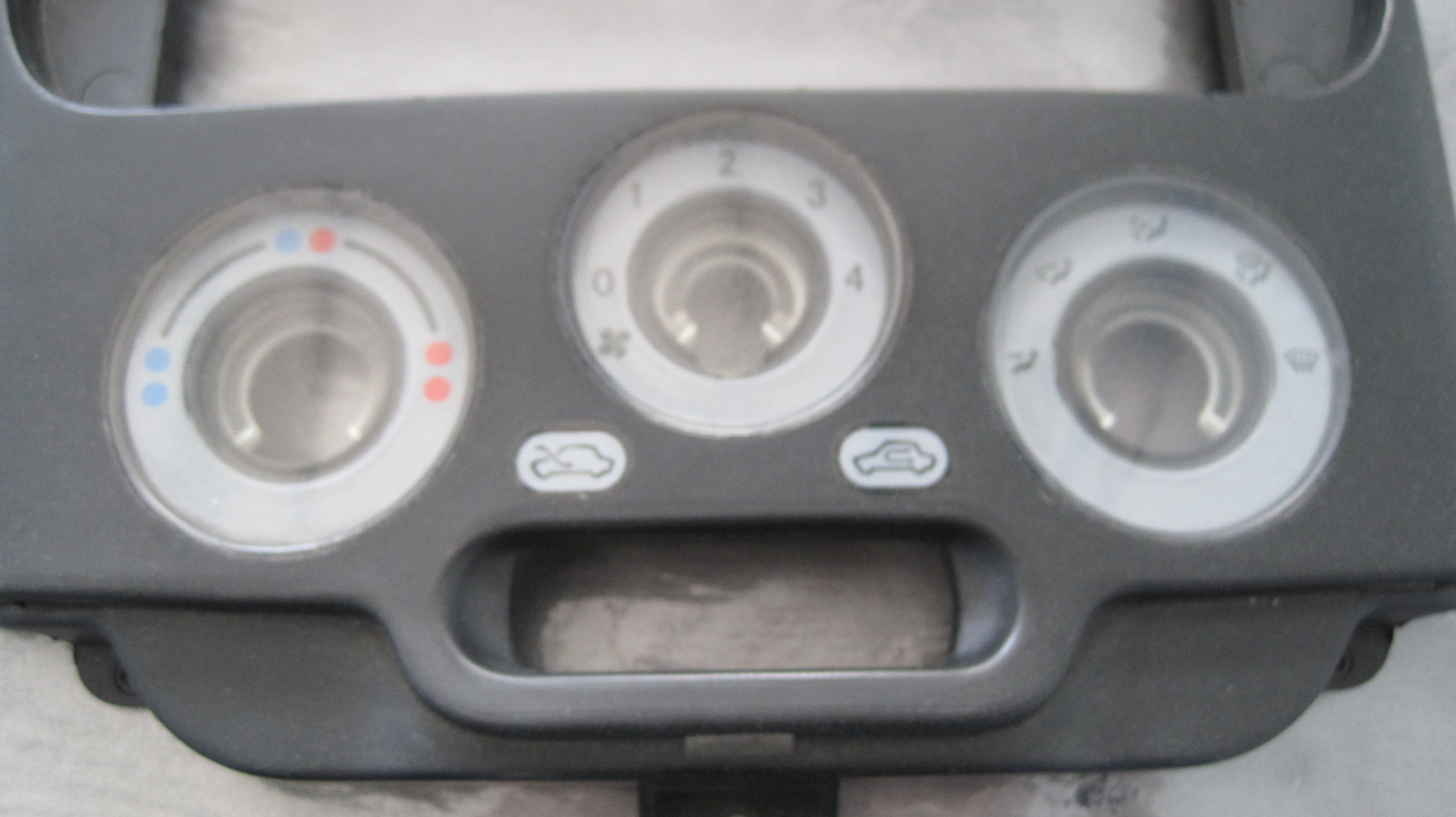

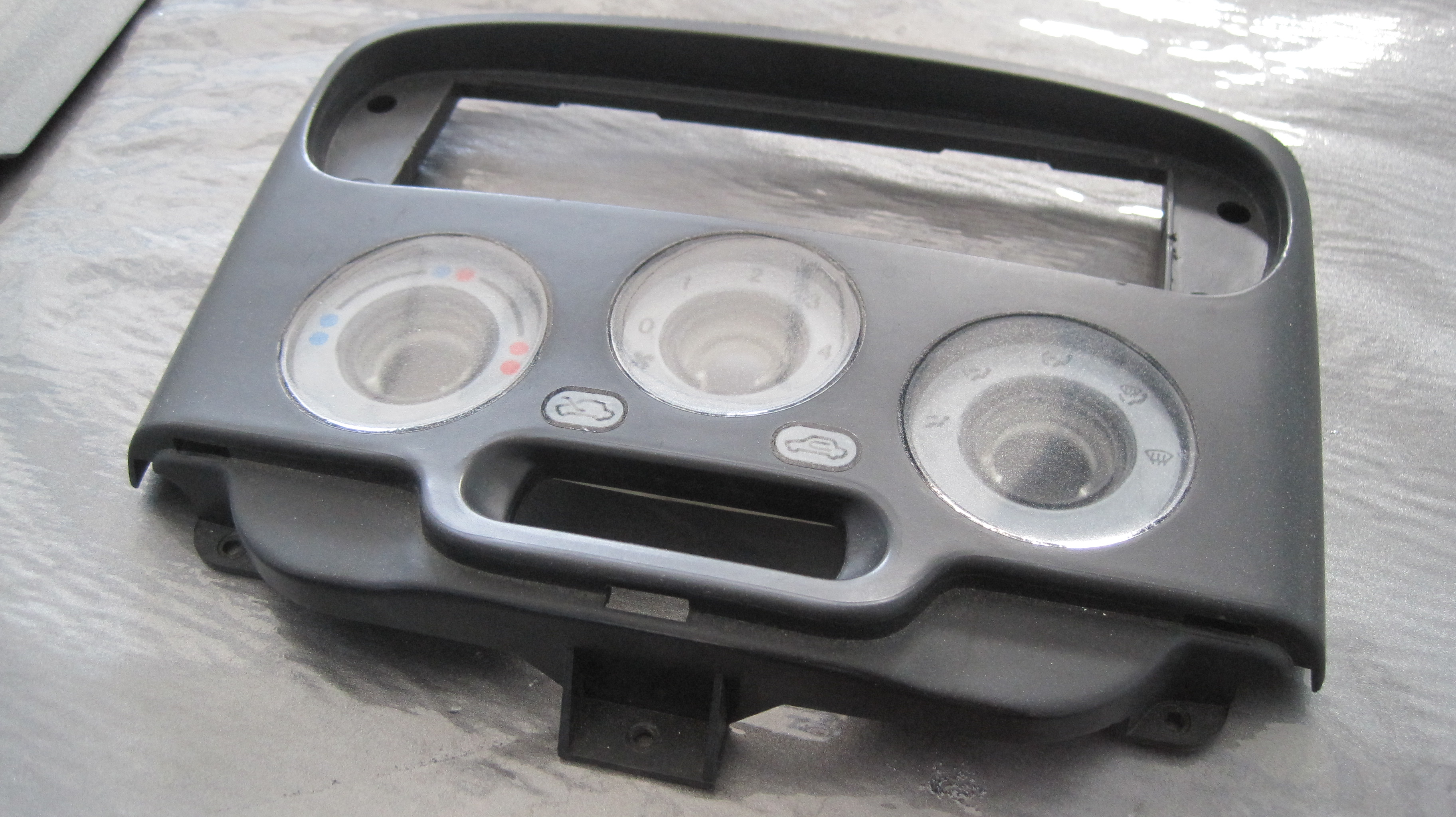

Had to paint all the interior panels again as they were now clashing with the new color and have just painted them the same as the vehicle.
The center dash consul will be slightly different as I have cleverly stuck stickers over the lighted control areas and after there painted and removed will leave a larger black ring highlighting the lighted controls.
Pictures to follow on Monday.

Hi Tom,
Thanks again, It the yellow wire and plug I have circled in orange that I,m stuck with, I don't know where it should plug into and it has left the air bag light on.
Would I need to remove the dash again or does it plug in somewhere behind the center console
Can you please show me with an arrow where it should go.

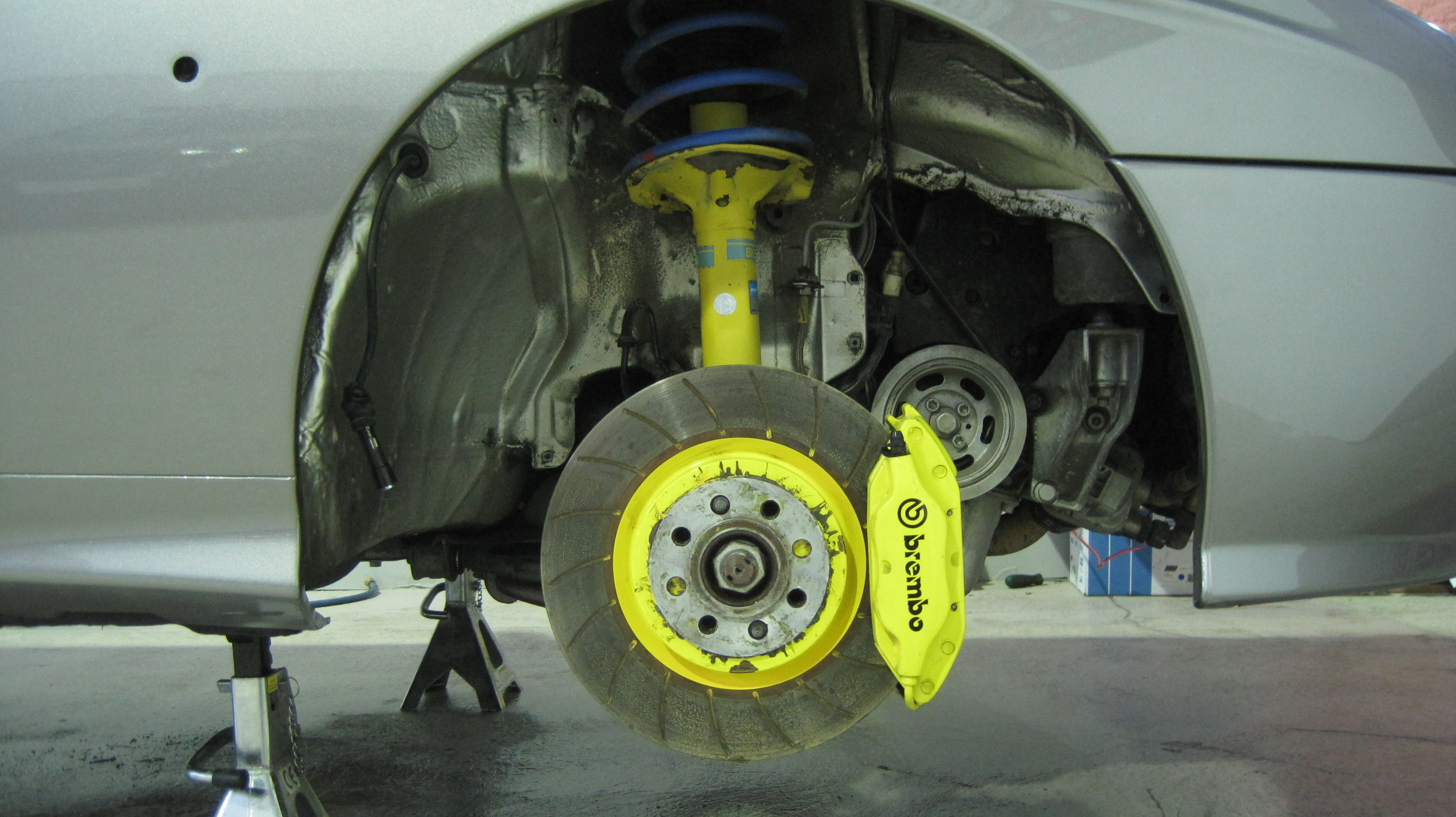

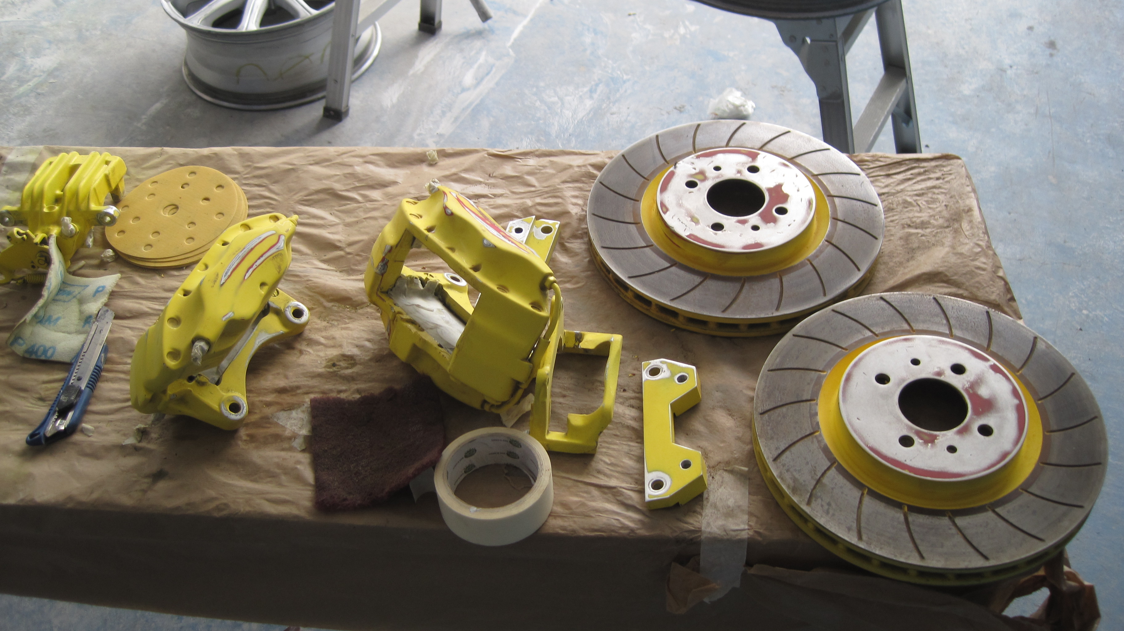

Decided to re paint the Brembo's although not sure what color at the moment.
UUHM :confused: Silver, Black, Blue or even a darker yellow again. :D
Will be striping and rubbing them down tomorrow so we'l see.

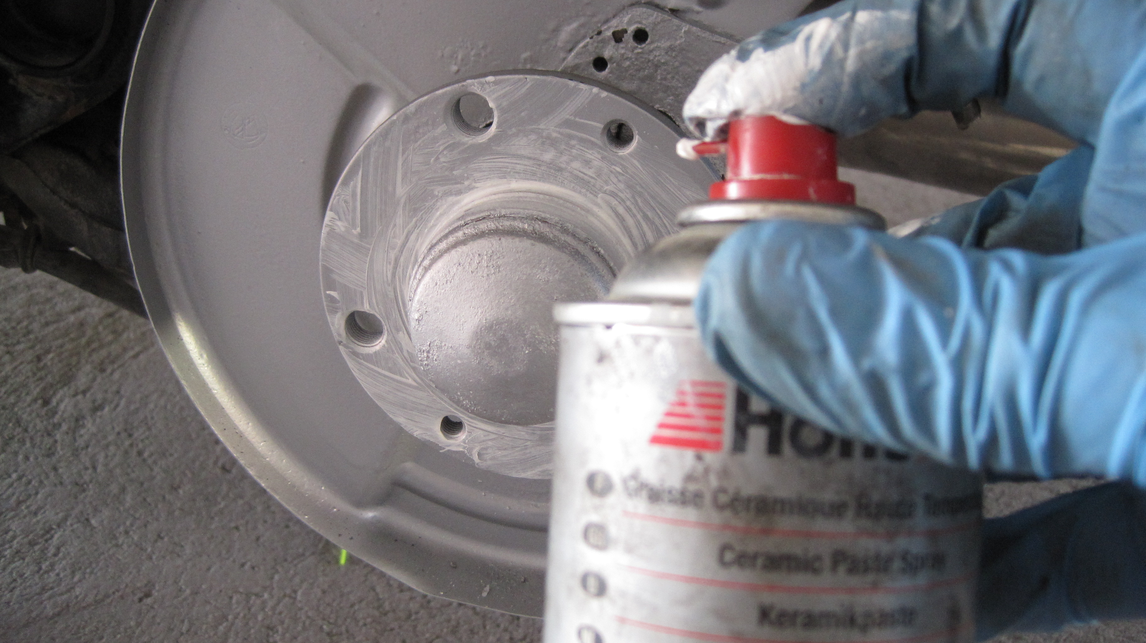

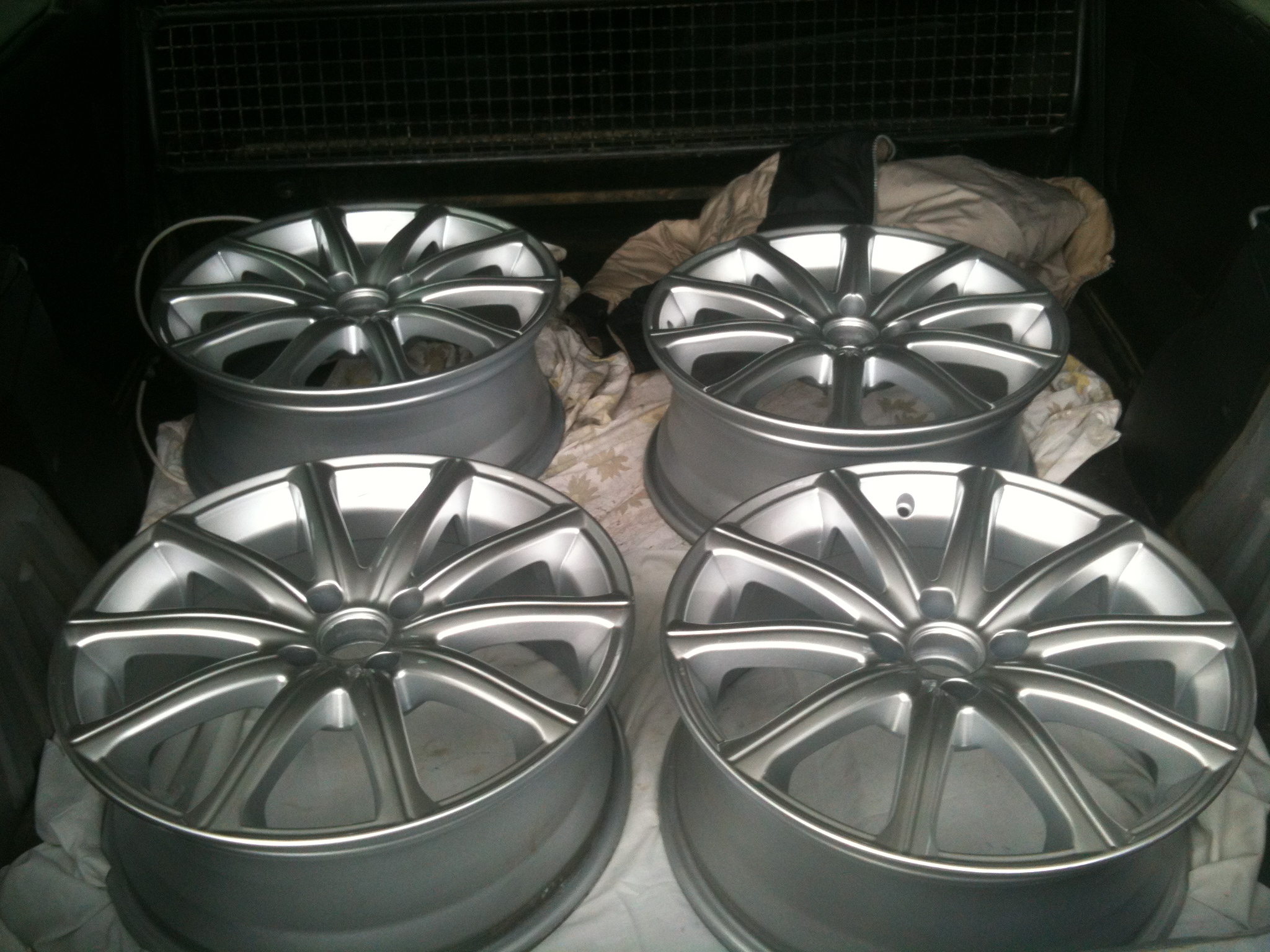

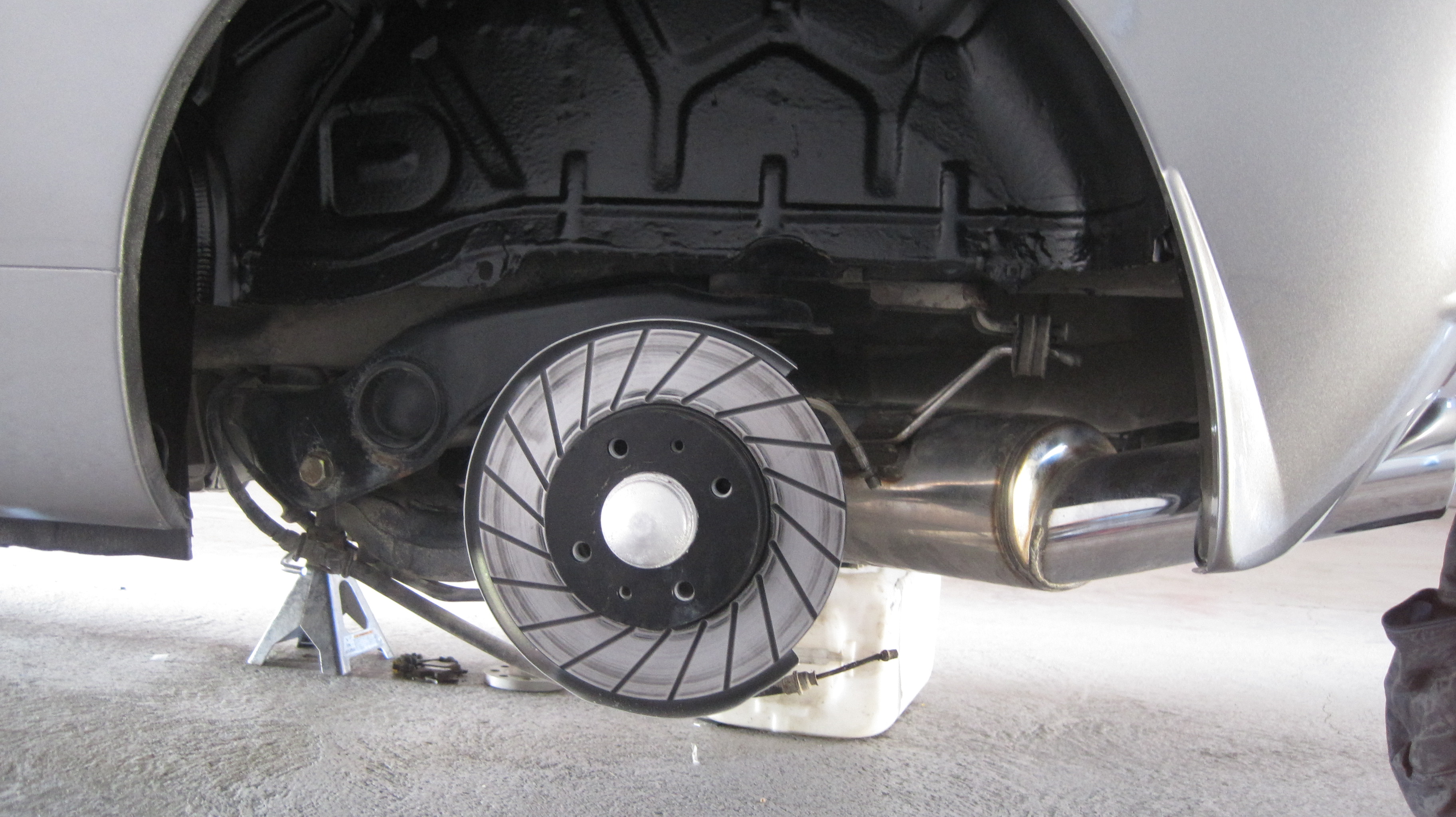

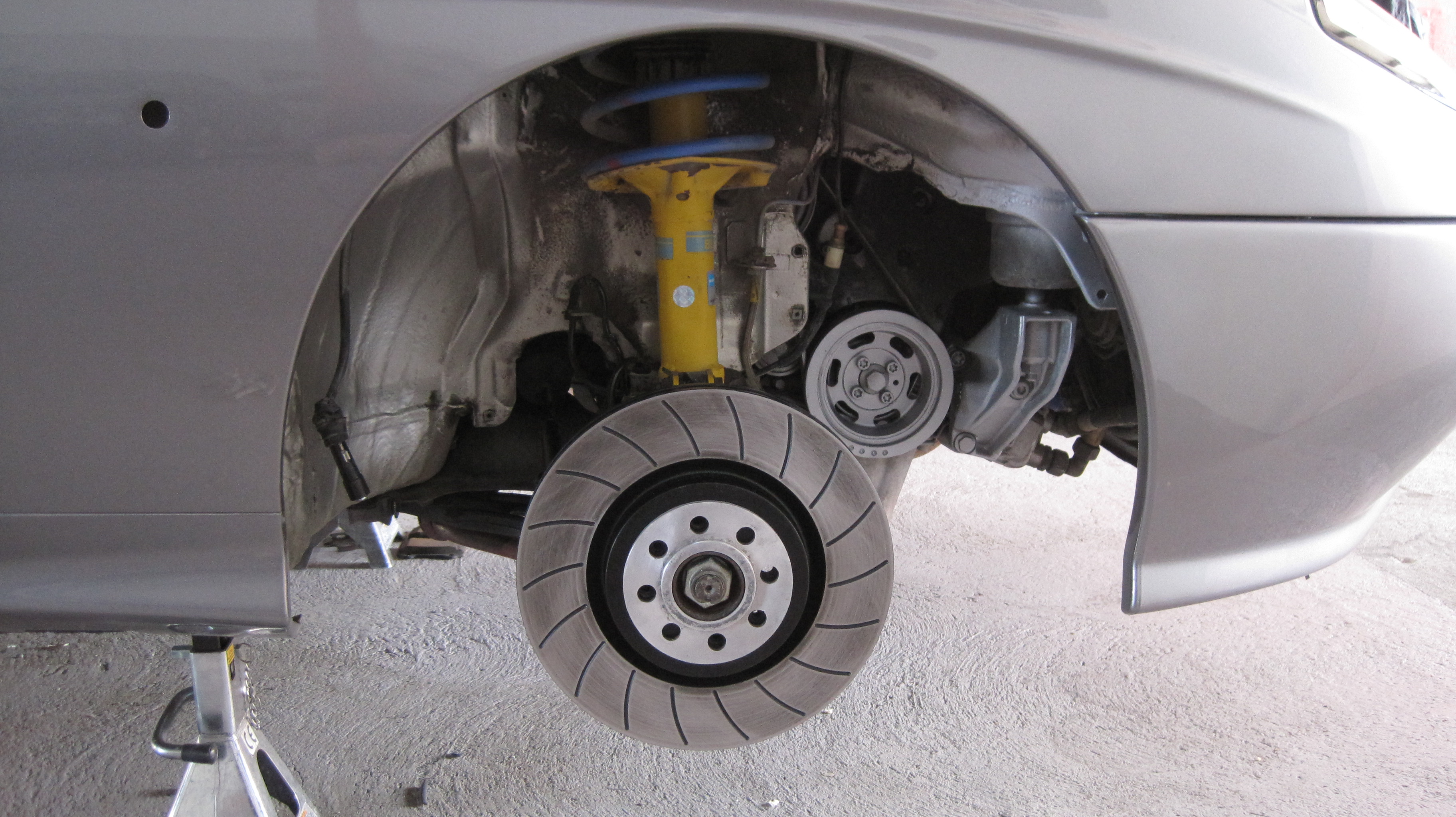

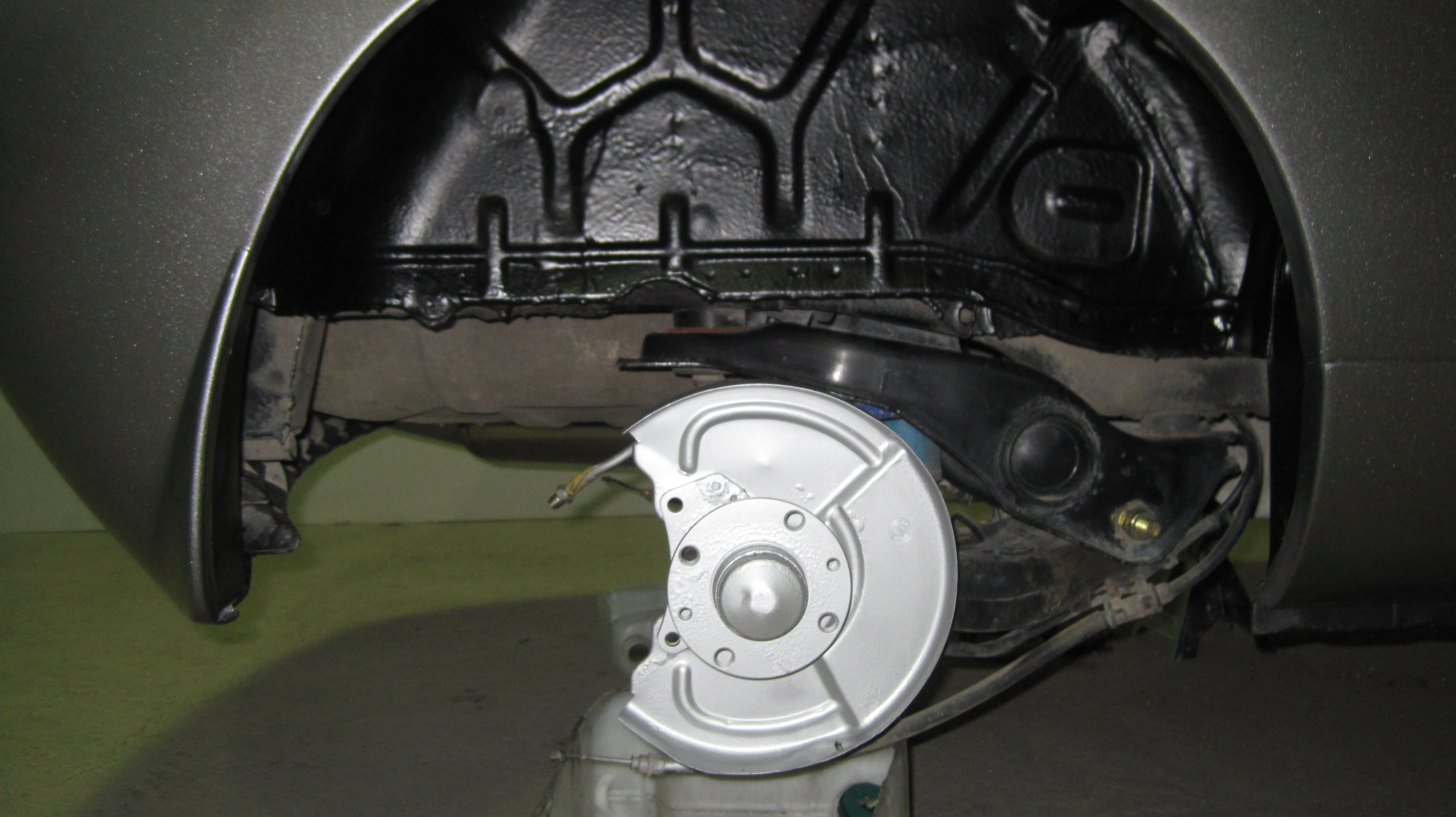

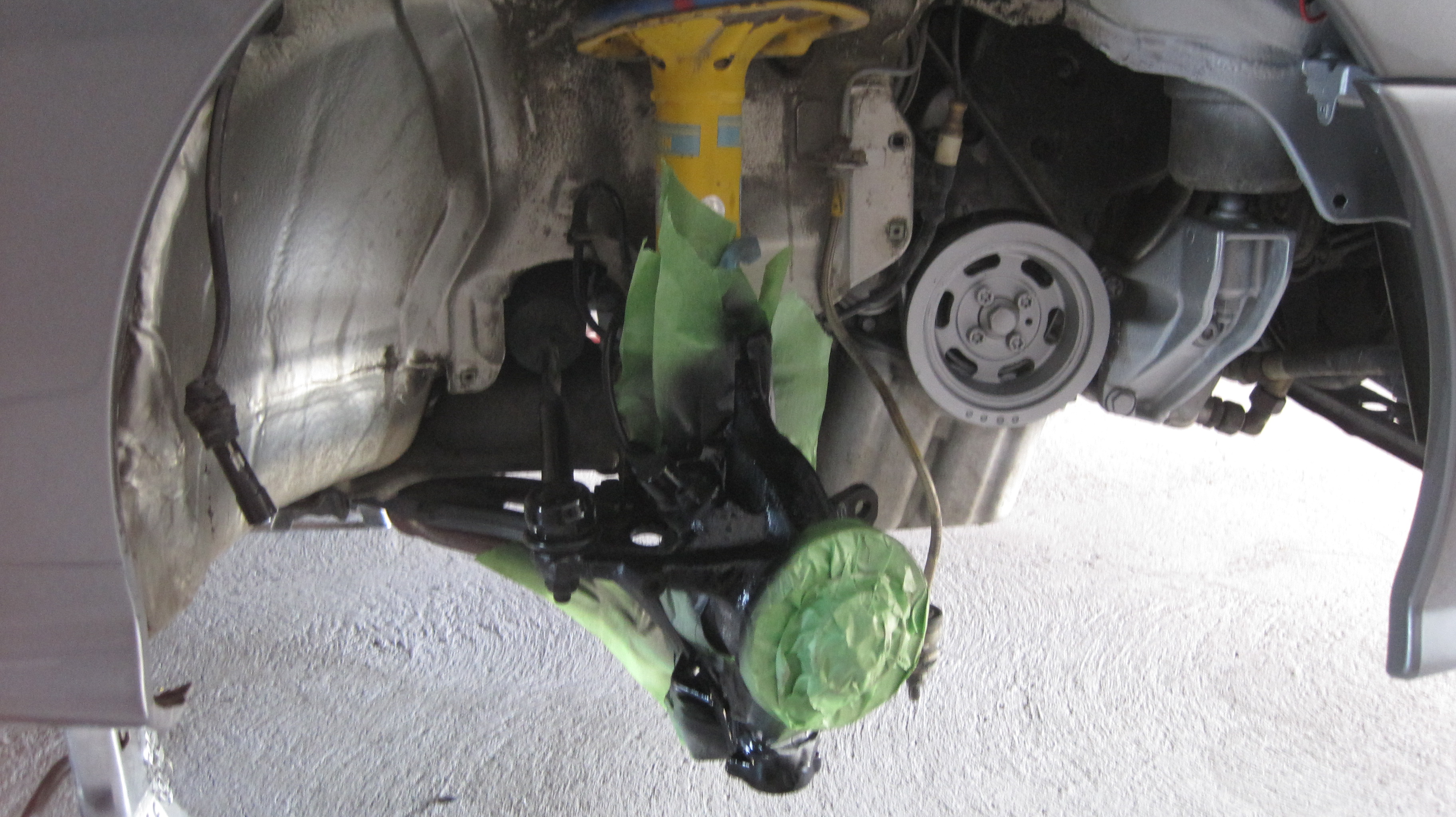

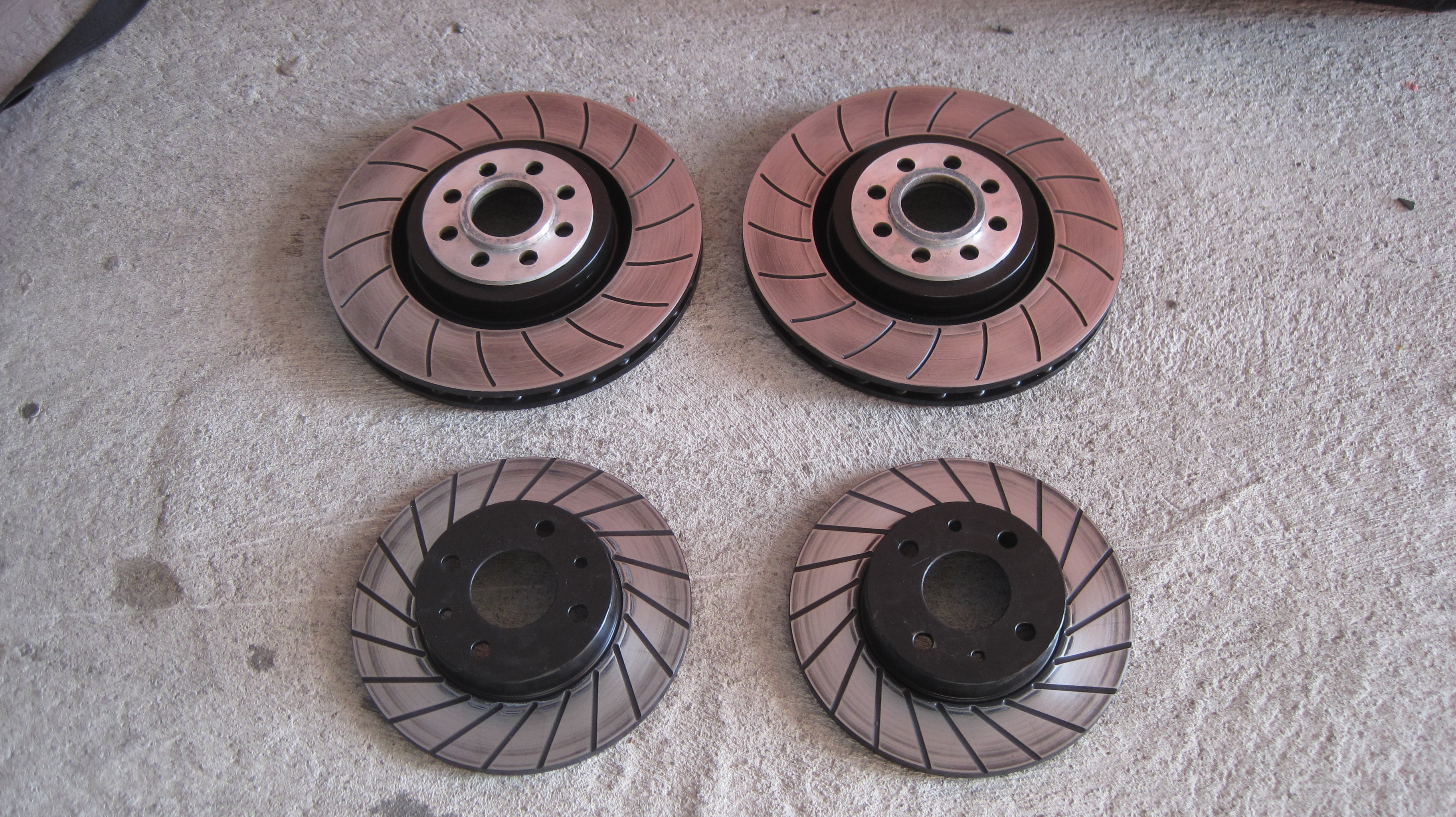

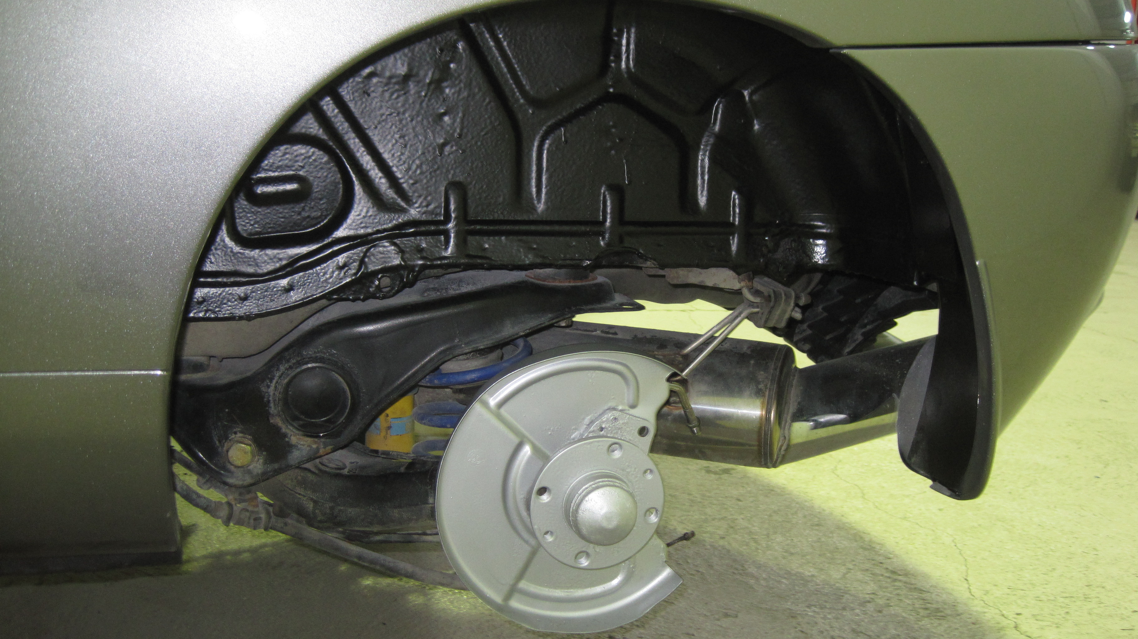

The wheels,the Brembo's and discs got painted today.
Sprayed up some of the undercarriage.

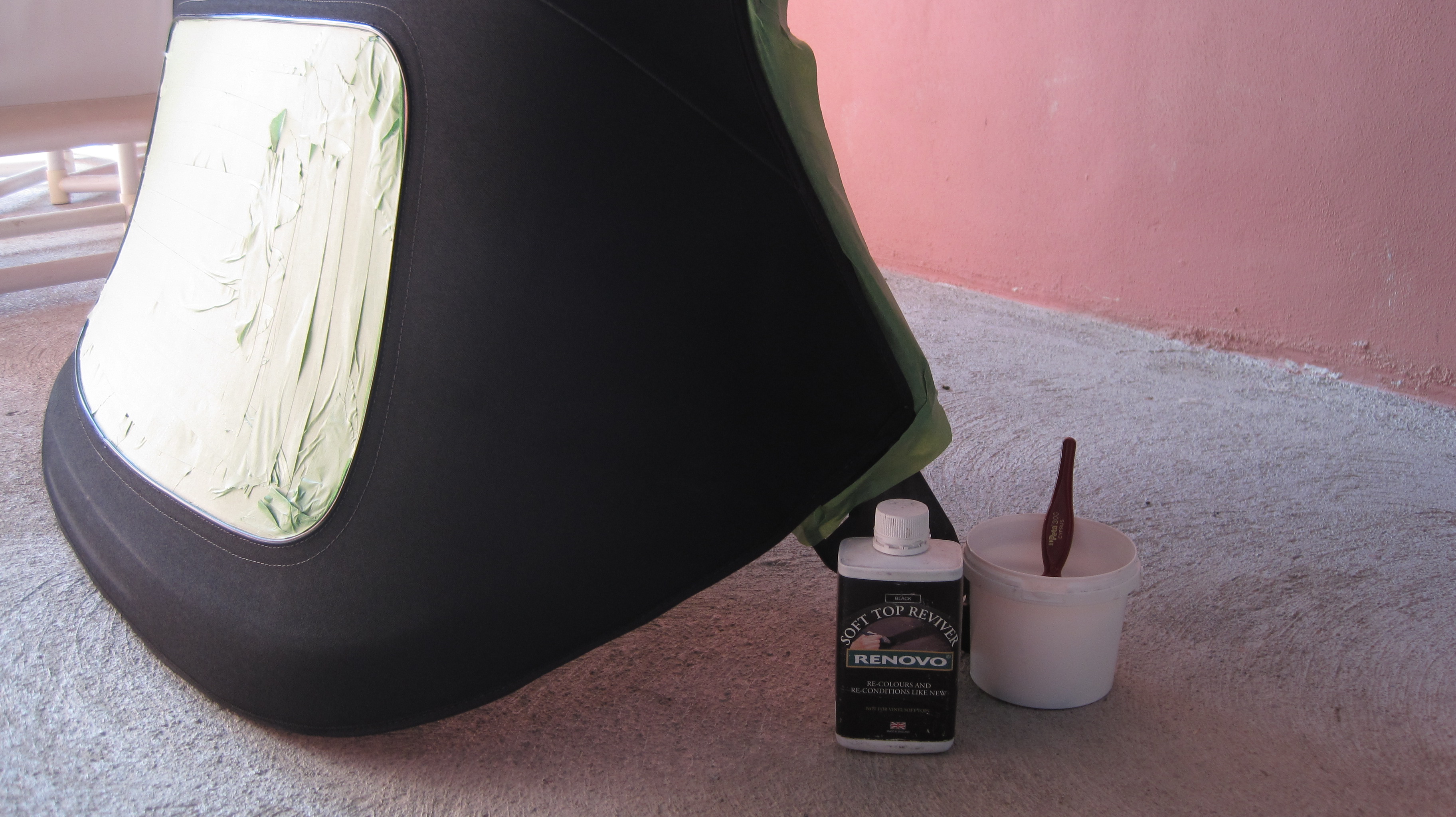

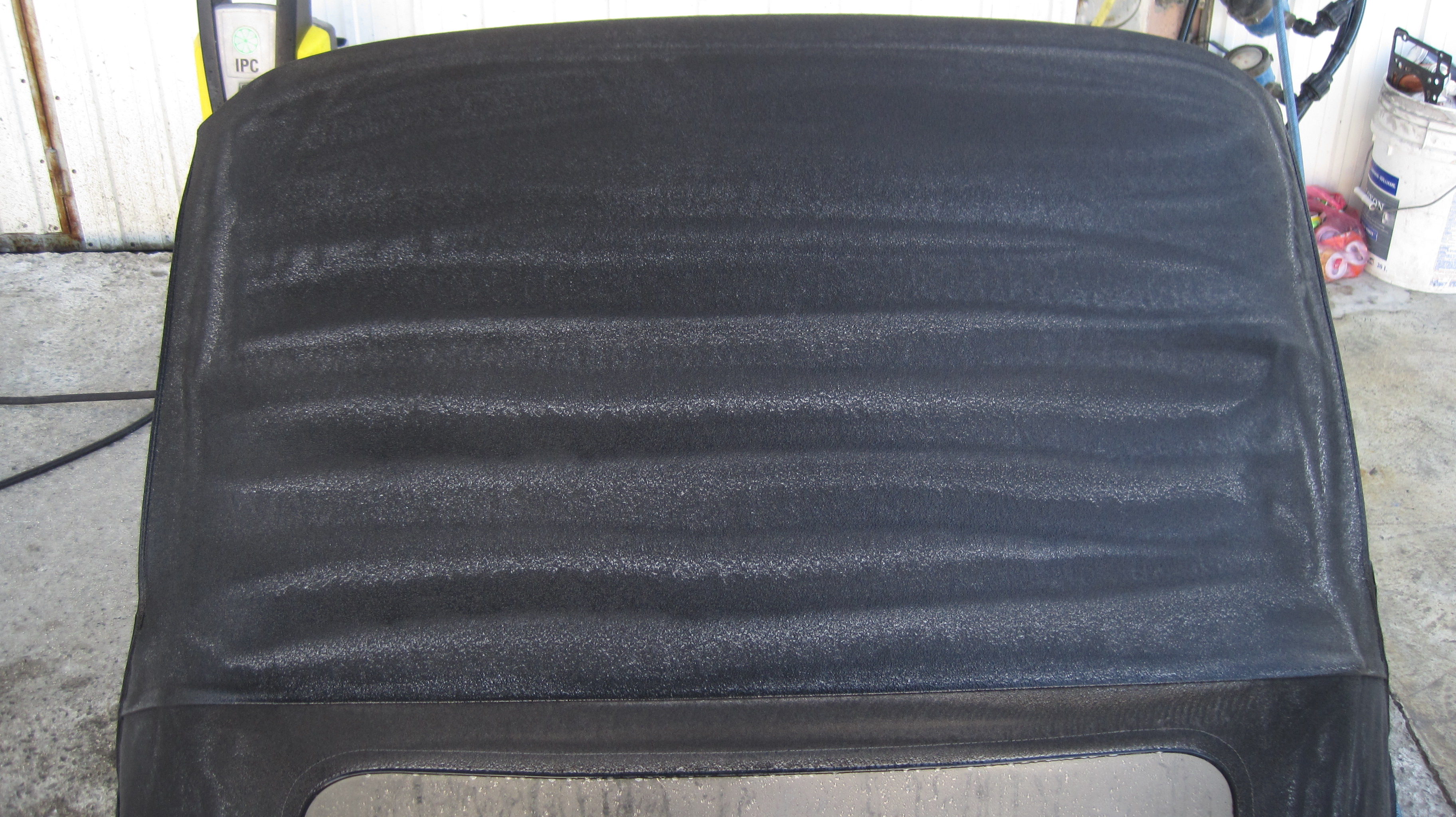

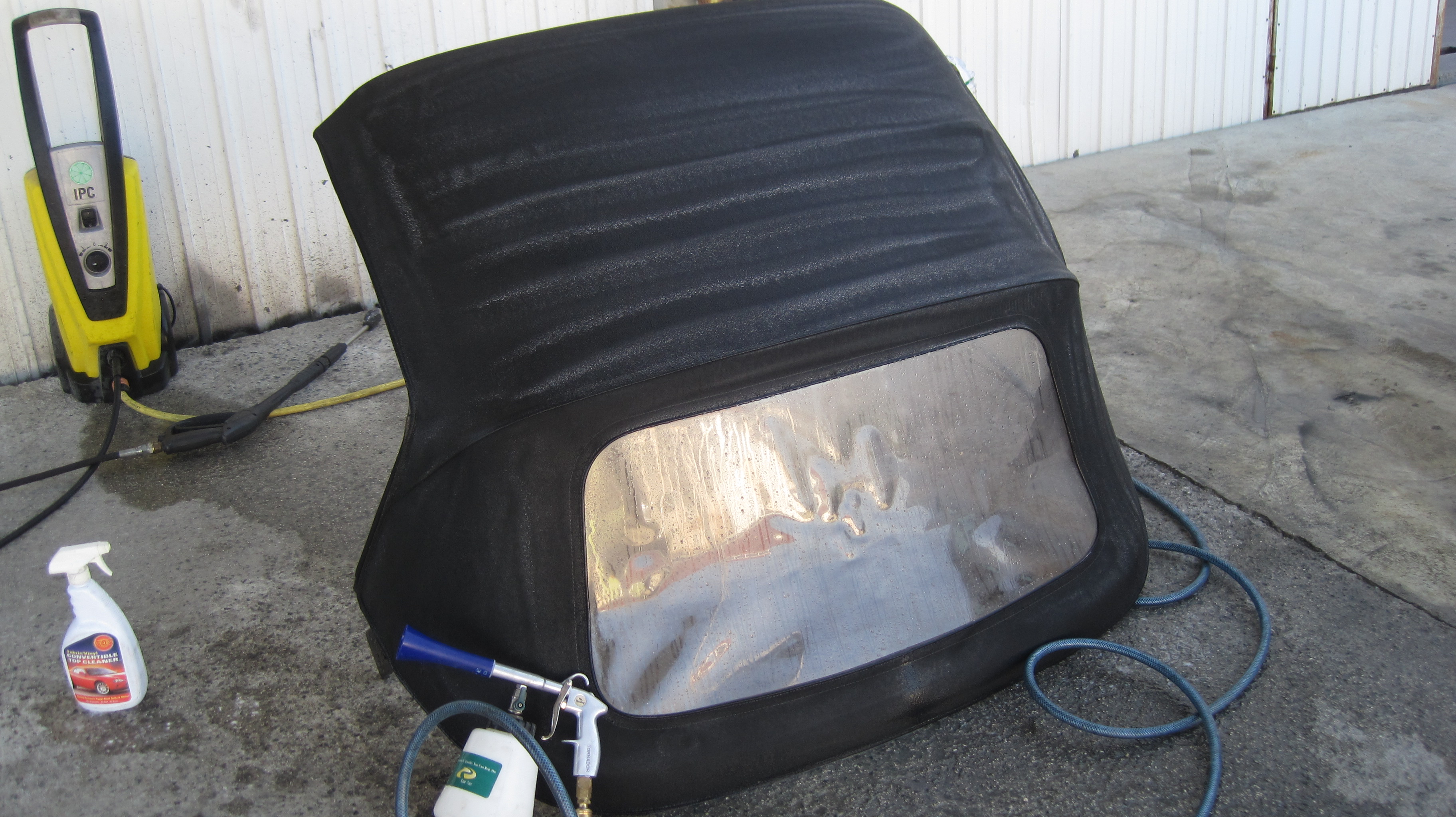

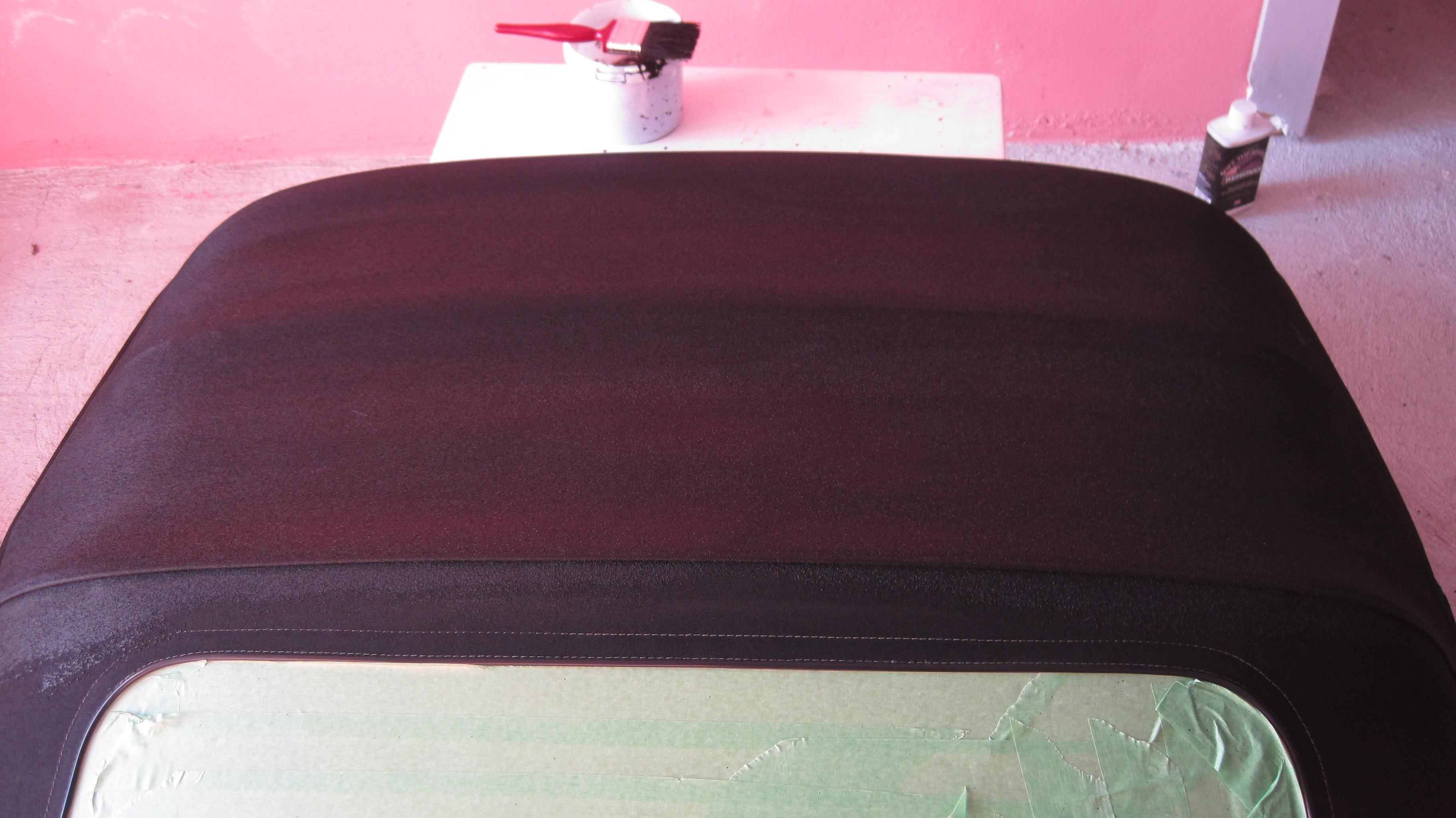

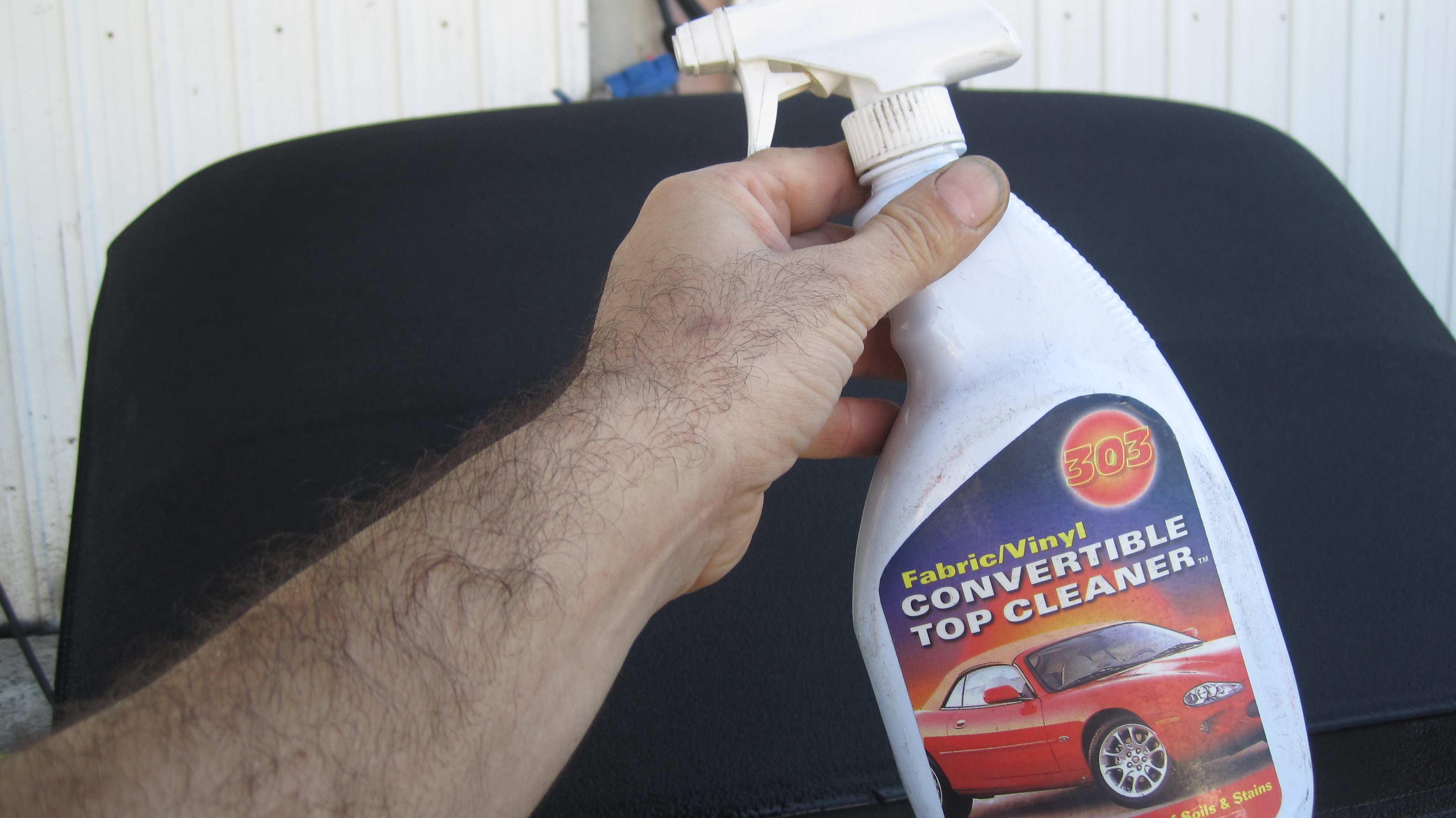

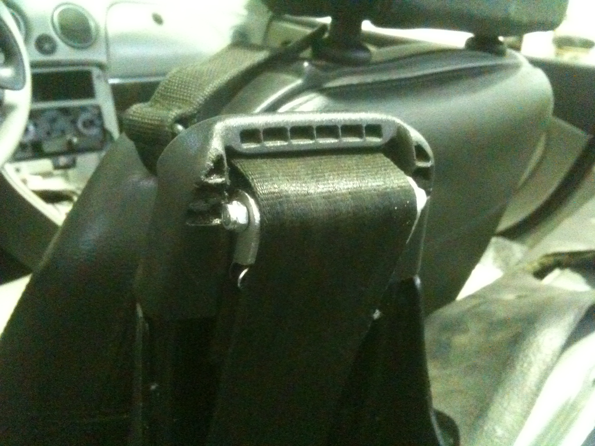

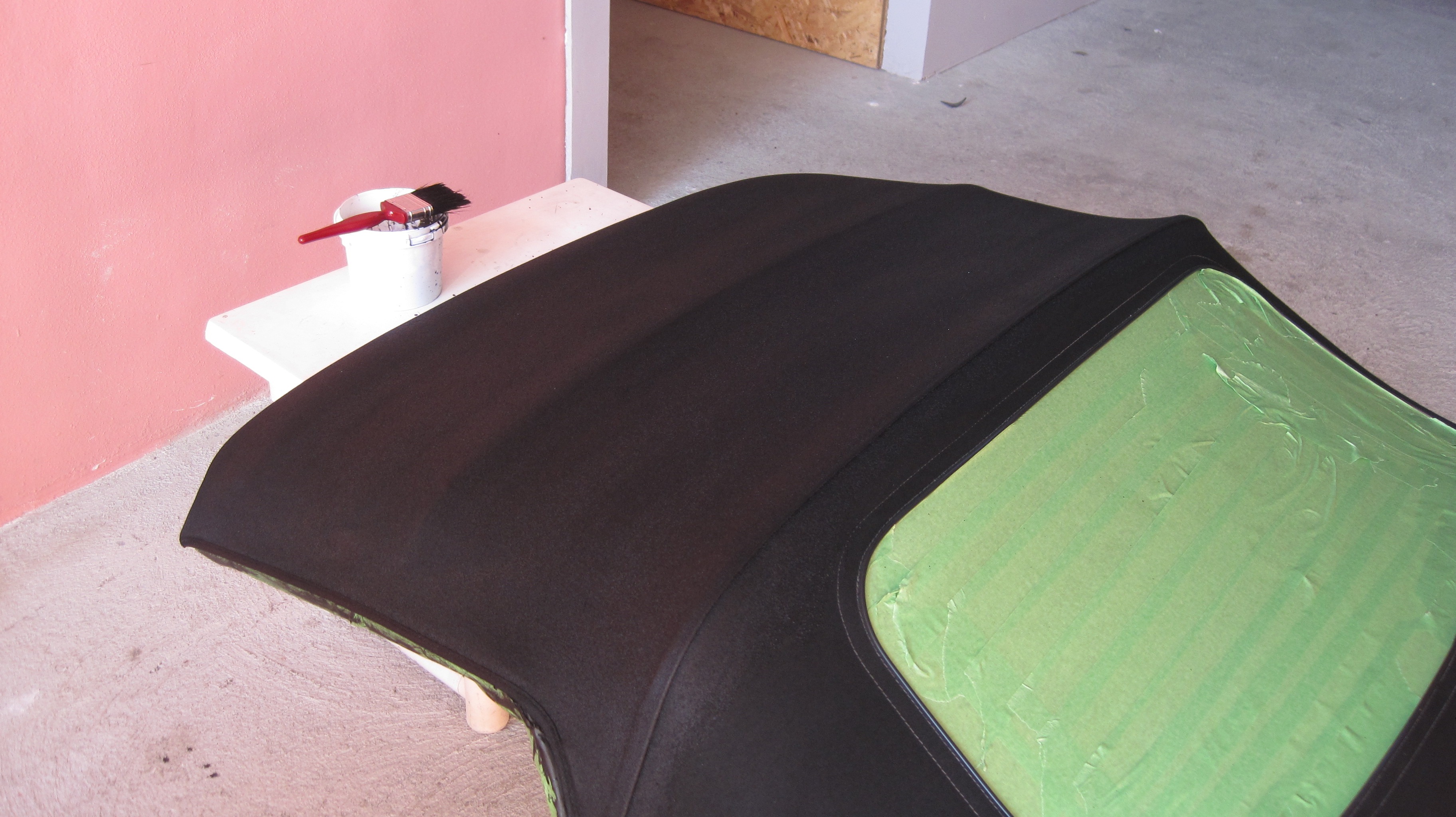

Also fitted the new seat belt guides and renovated the soft top.

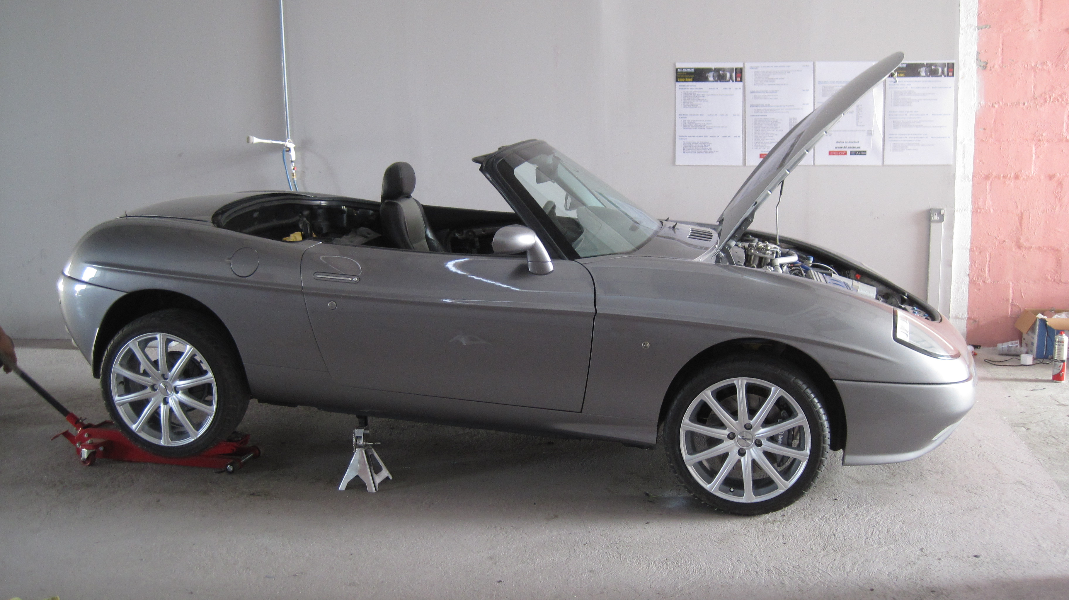

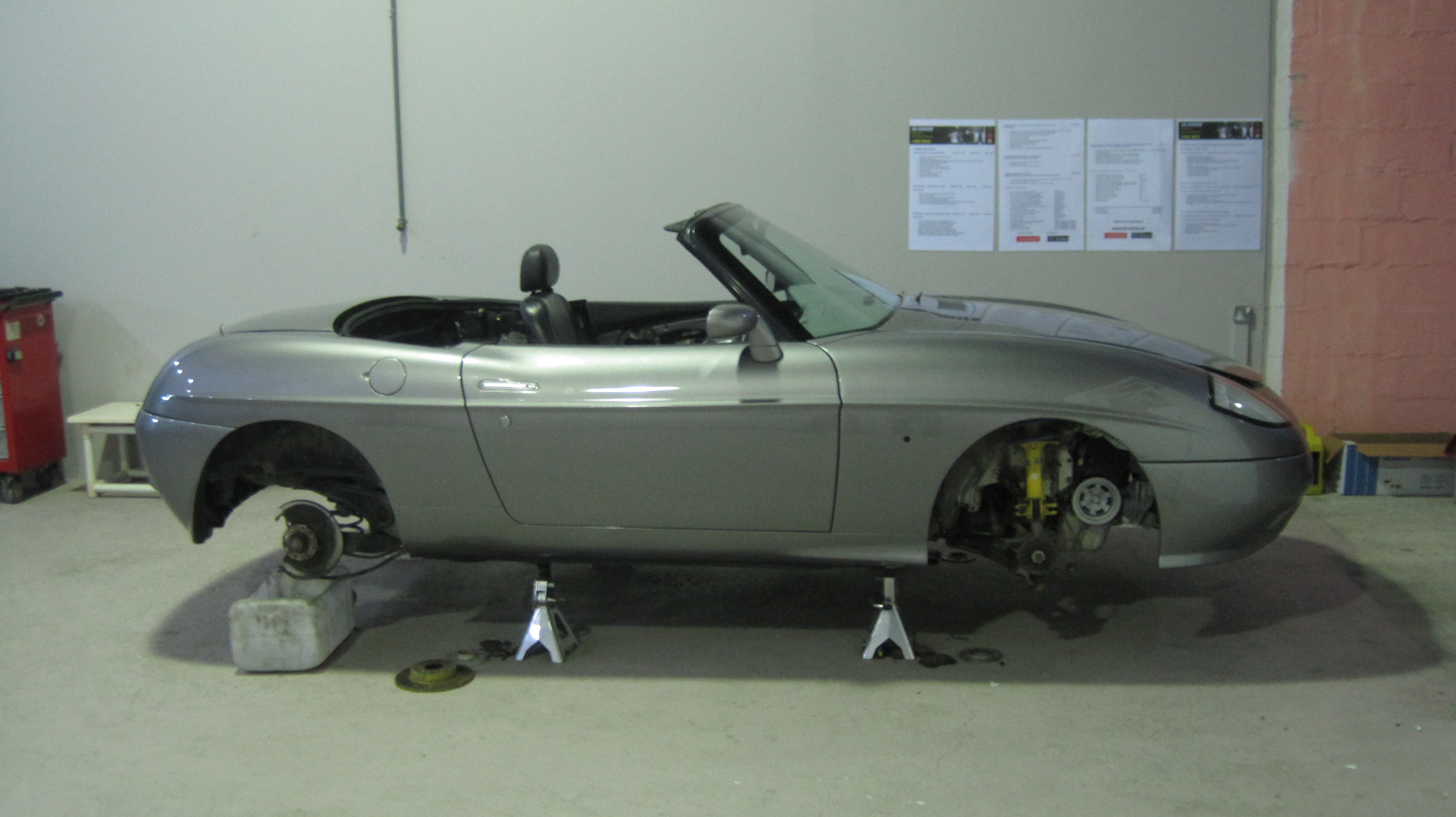

Picked up the last of the bits from the paint shop today and so put the brake calipers back on. filed the seat belt rollers as Steve mentioned. fitted the center console back and now you can see the black rings around the dials which makes it look better me thinks. :)

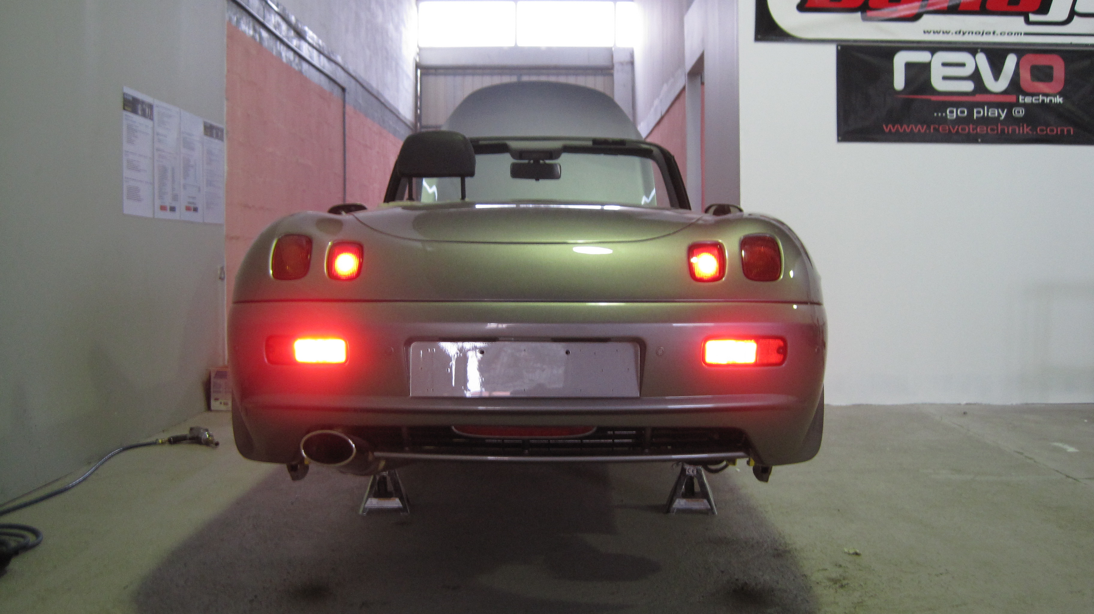

WEY HEY!! :D

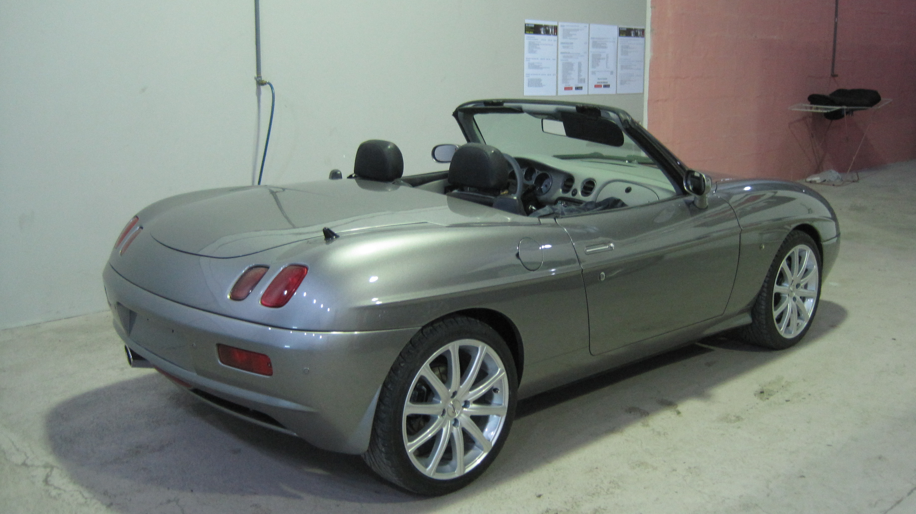

My work on the B is finished for now, shes all back together and I,m pleased with the final paint-job.
Until the next project!!
Lowering the suspension,
Carpet interior
More power. :devil:
