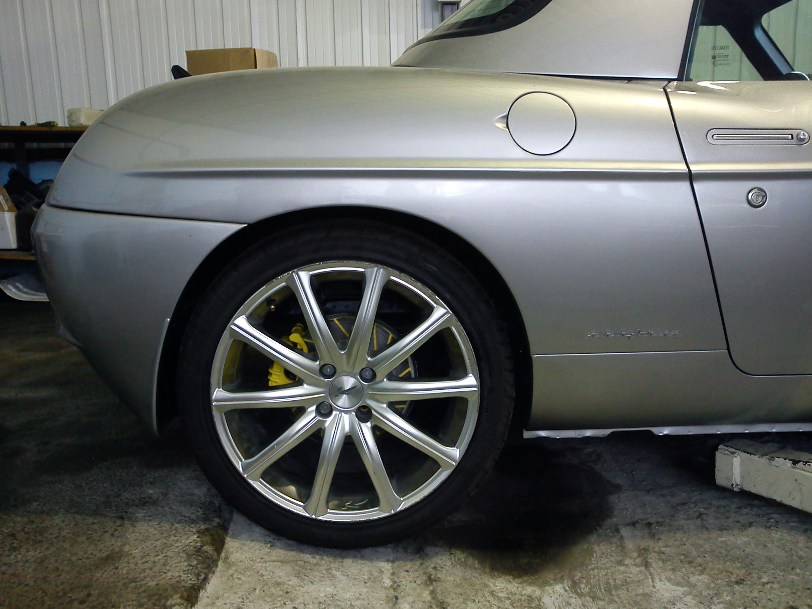

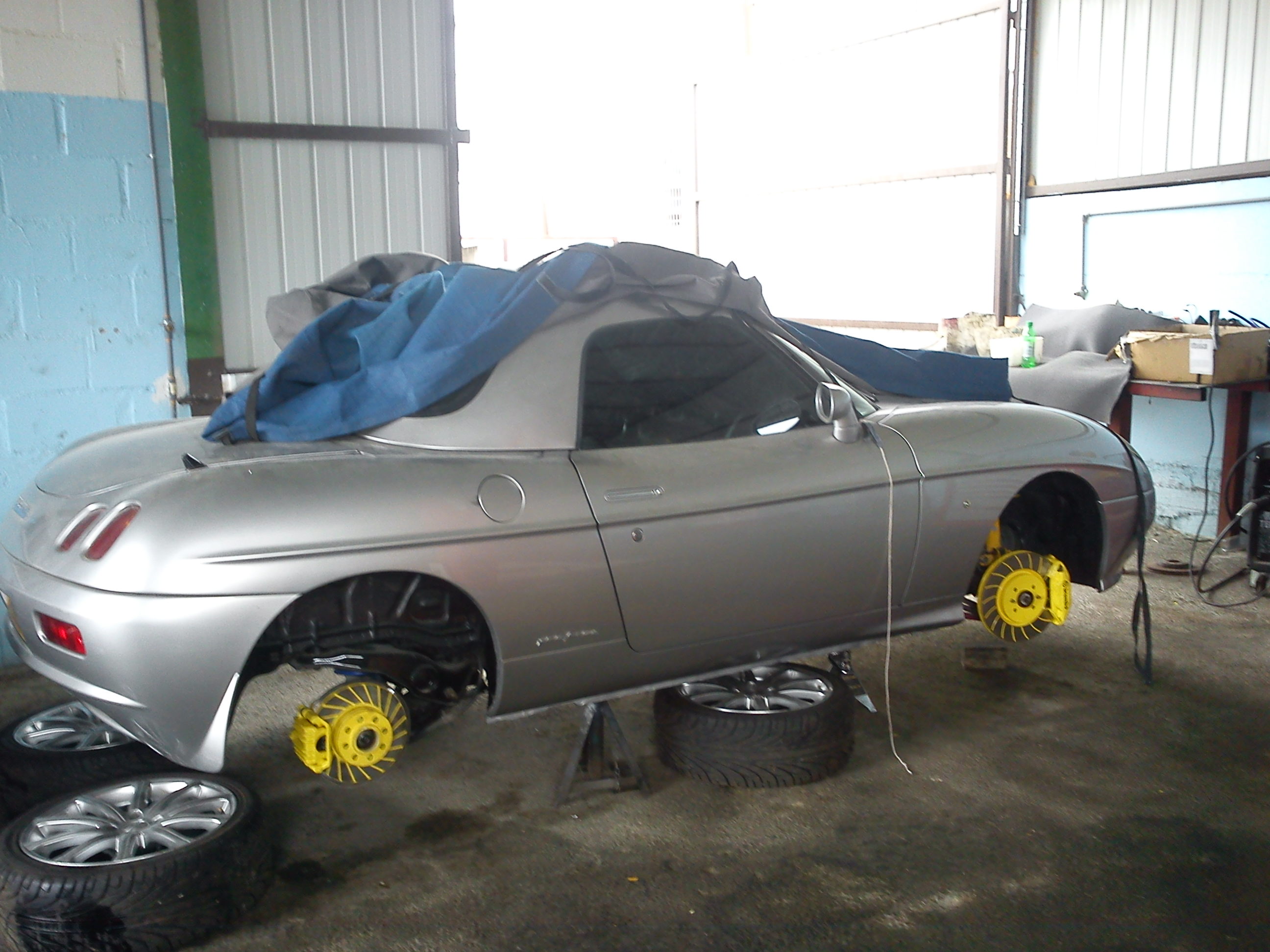

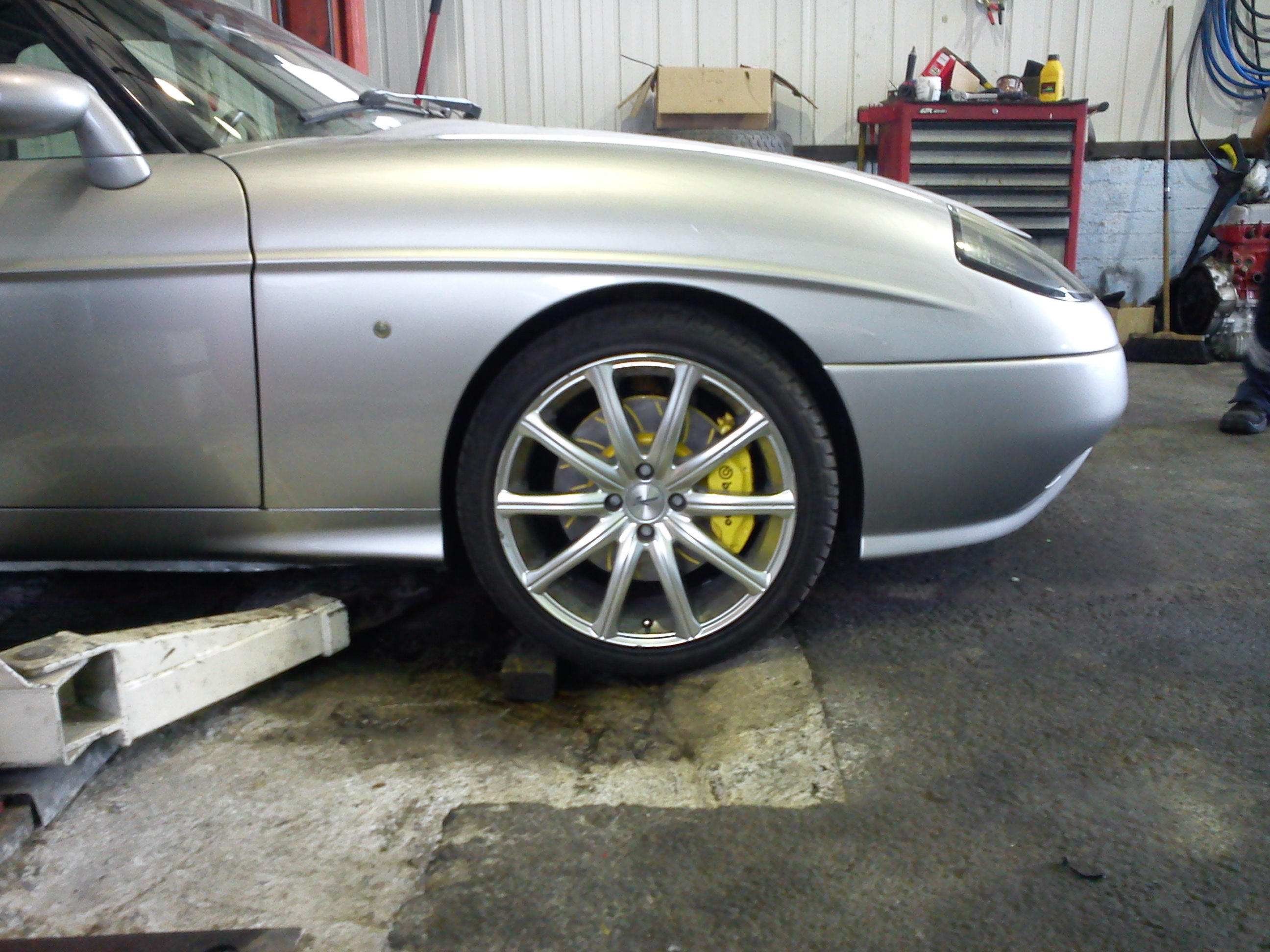

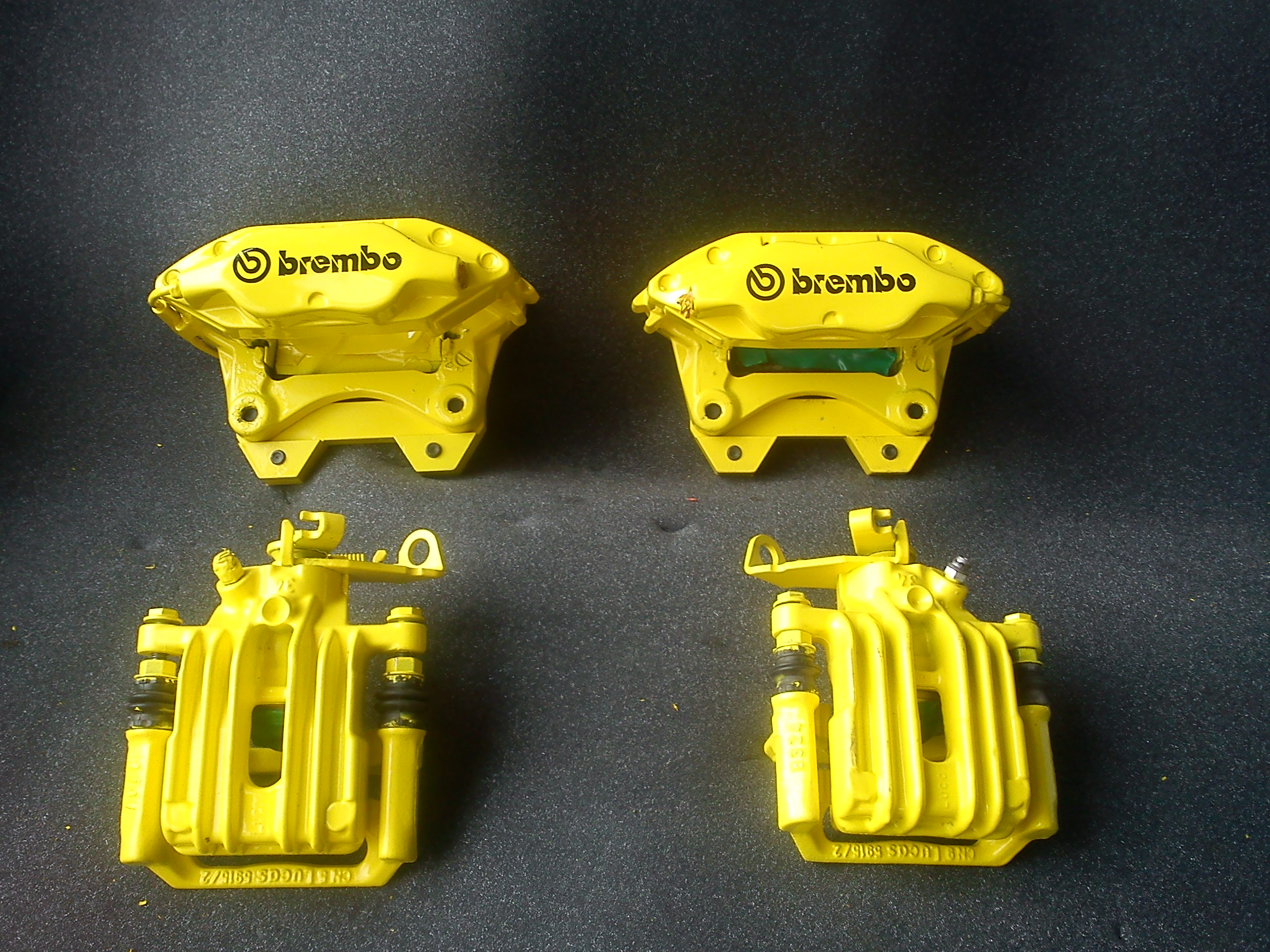

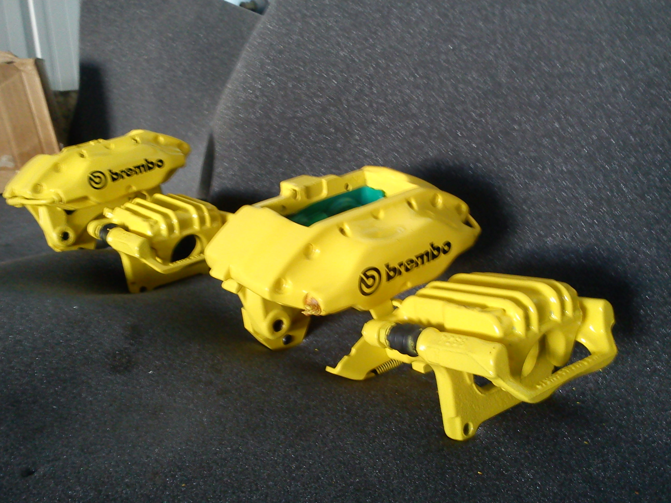

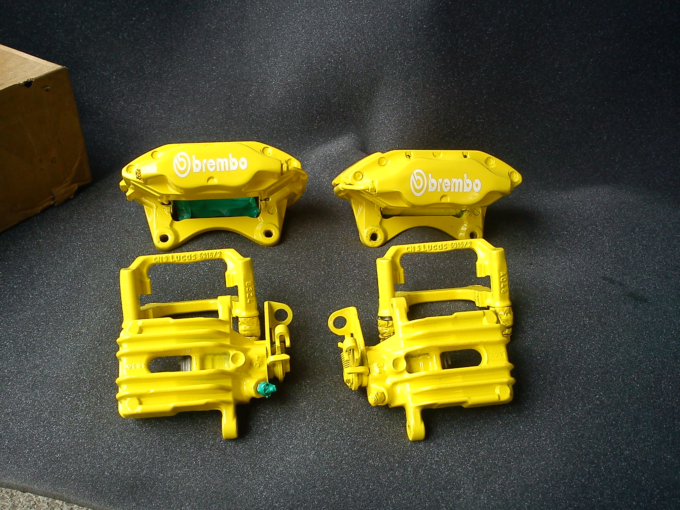

:D New brembo's repainted just the way i like them. :D
Tried white stickers at first but believe they needed the black over the yellow.
My nephew Mike who's a mechanic and best man come to think of it, plans to devote some of his time this weekend and refit all the brakes back again. Ive got new discs and pads for the front but will need to buy some new for the rear as their worn, Planing on the Tarox F2000 discs with Tarox Strada pads, Guess they would be nice up the front too. :)
I,ll give a full report when the brembo's are all fitted and tested. (y)

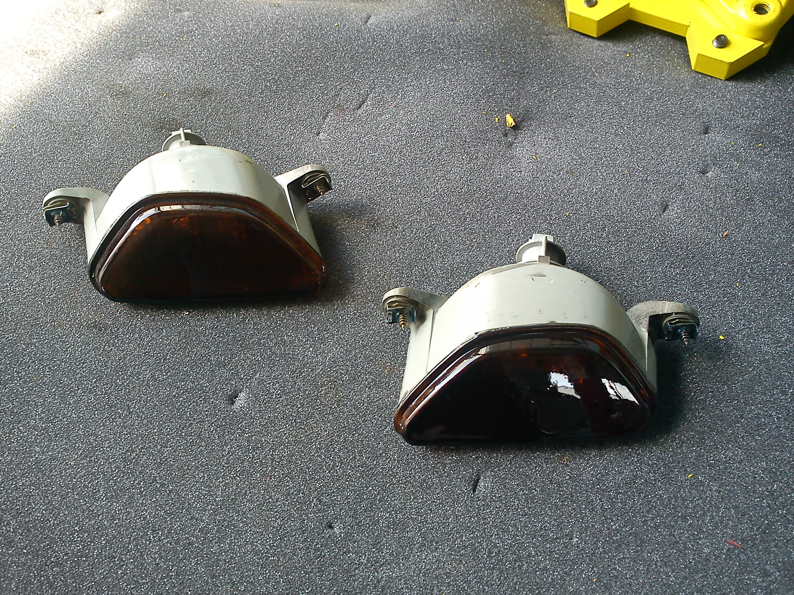

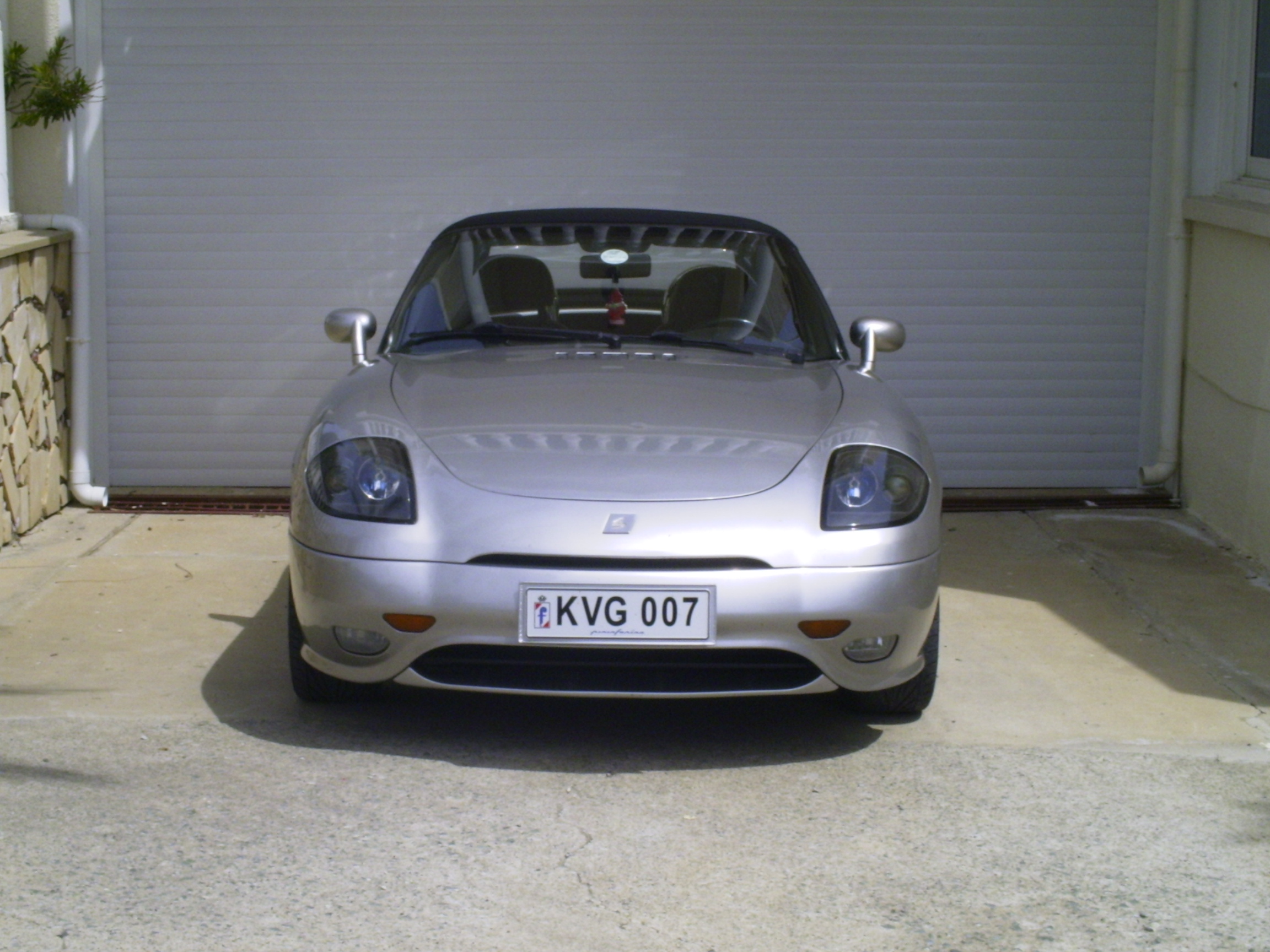

While at the paint shop having my new brake discs painted I noticed the sprayer had sprayed someone's light clusters so as to tint them.
This gave me the idea to have the same done with The B's front orange indicators.
Think it will give the B a more sporty and modern look.
Heres some pics of the B with orange indicators and the new indicators light spray tinted.
More pics to follow when there on the car.:)

I would love to have some clear indicators. I saw one last time, but can't seem to find any anywhere:(
Hiya Bollie, never seen or heard of clear indicators for the B, are you sure it wasnt the fog lights you may have seen, they can look very simmilar when off the vehicle, but there are clear lenses avaliable for the side indicators.
Hi, yes I know those 2 are available.
But I'm sure of the clear indicator lenses. I saw a barchetta once with ones fitted. but can't seem to find the picture .

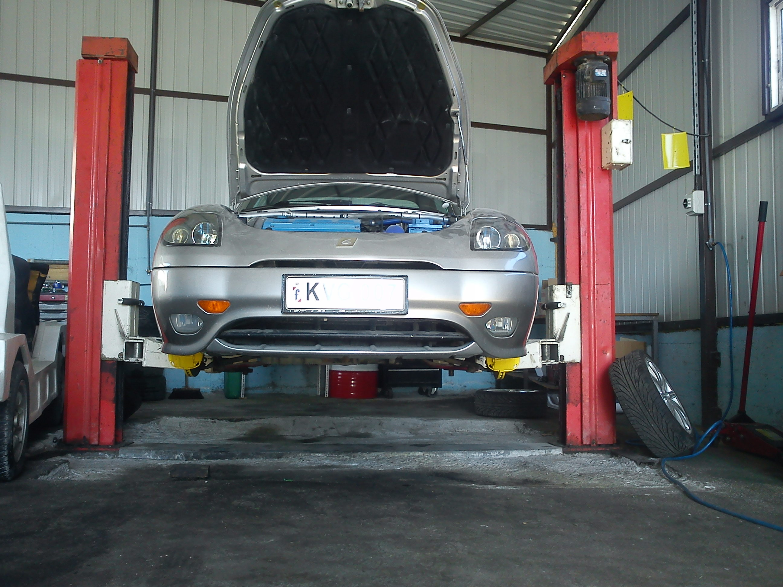

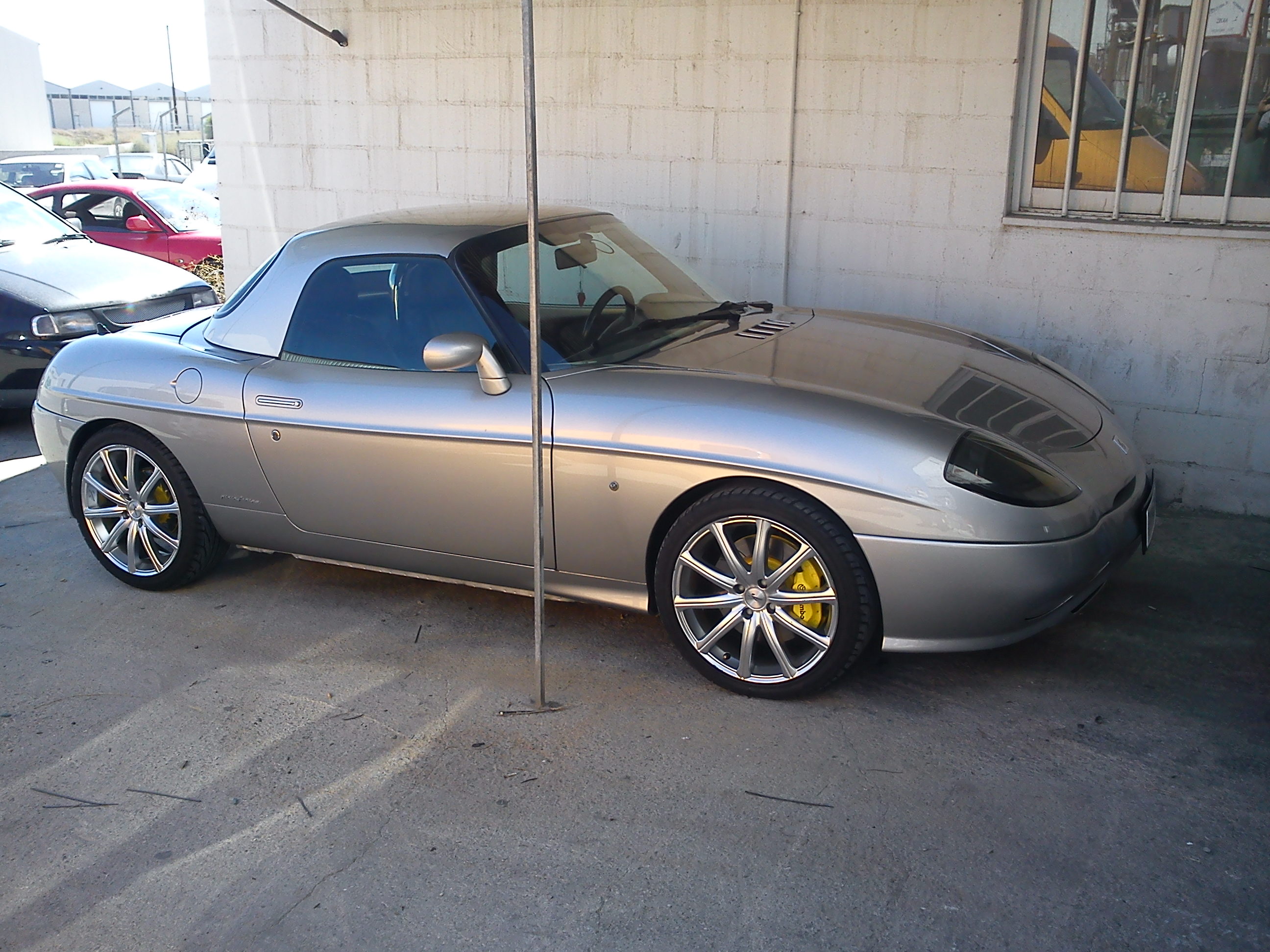

Had all the new brakes put on the B today, :D so i,m a happy man.
Tommorrow i will get the exhaust back on and get to have a test run and see how the brakes are working.
Doc!
Managed to have quick test run today and brakes feel good, the pedal is a little spongey but thats until the new pads bed in. Only problem is she's pulling to the left when i slam them on. The track ends are the original and i remember once when i needed the tracking done, the mechanic wasnt able to undo them from the rods as they had ceased/ rusted together. Also the ABS light has come on. but i,d imagine its because i had the rear discs sprayed with the hubs on and may have got paint or dirt in the teeth.
On inspection my left track rod end has some play in it and also one of my rear hub bearings are worn and idealy i should have the tracking done again.
So! Back we go into our savings and i've ordered complete new left/right track rods & rod ends which arrive tommorrow and i hope to get on and get the tracking done.
I will require new rear bearings and discs at some point but their is a little more life left in them so i,ve left the old ones on for now and just added new pads.
More testing and reviews once its all done.
They LOOK GREAT though !!!!

It looks the dogs man!
I wish I could place grooved disks too but MOT here in Belgium don't allow any modification to the brake system.
Unless they don't see it. but I think they would:p
Verry nice wheels too. aren't they too big to maintain a confy ride?
