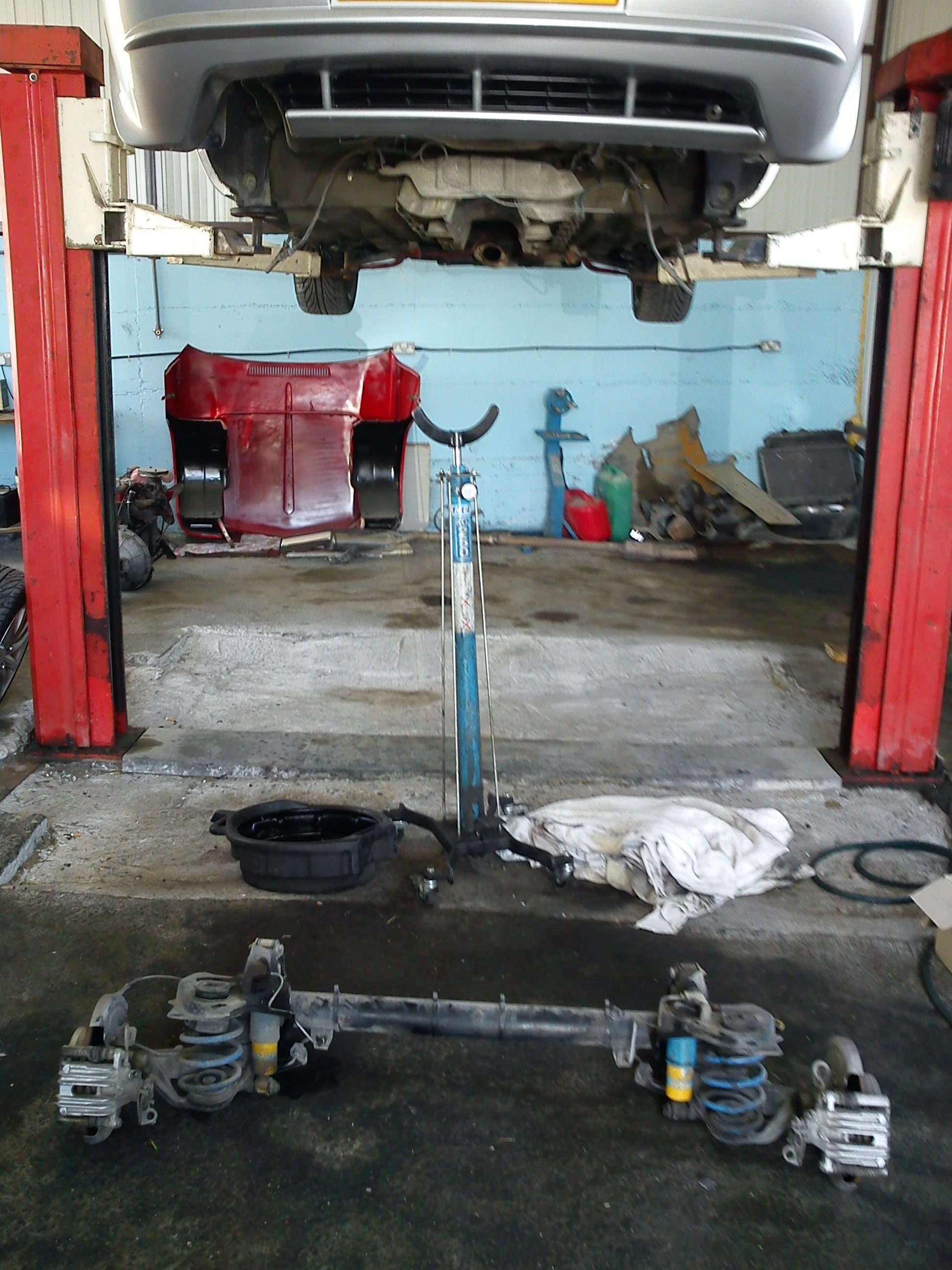

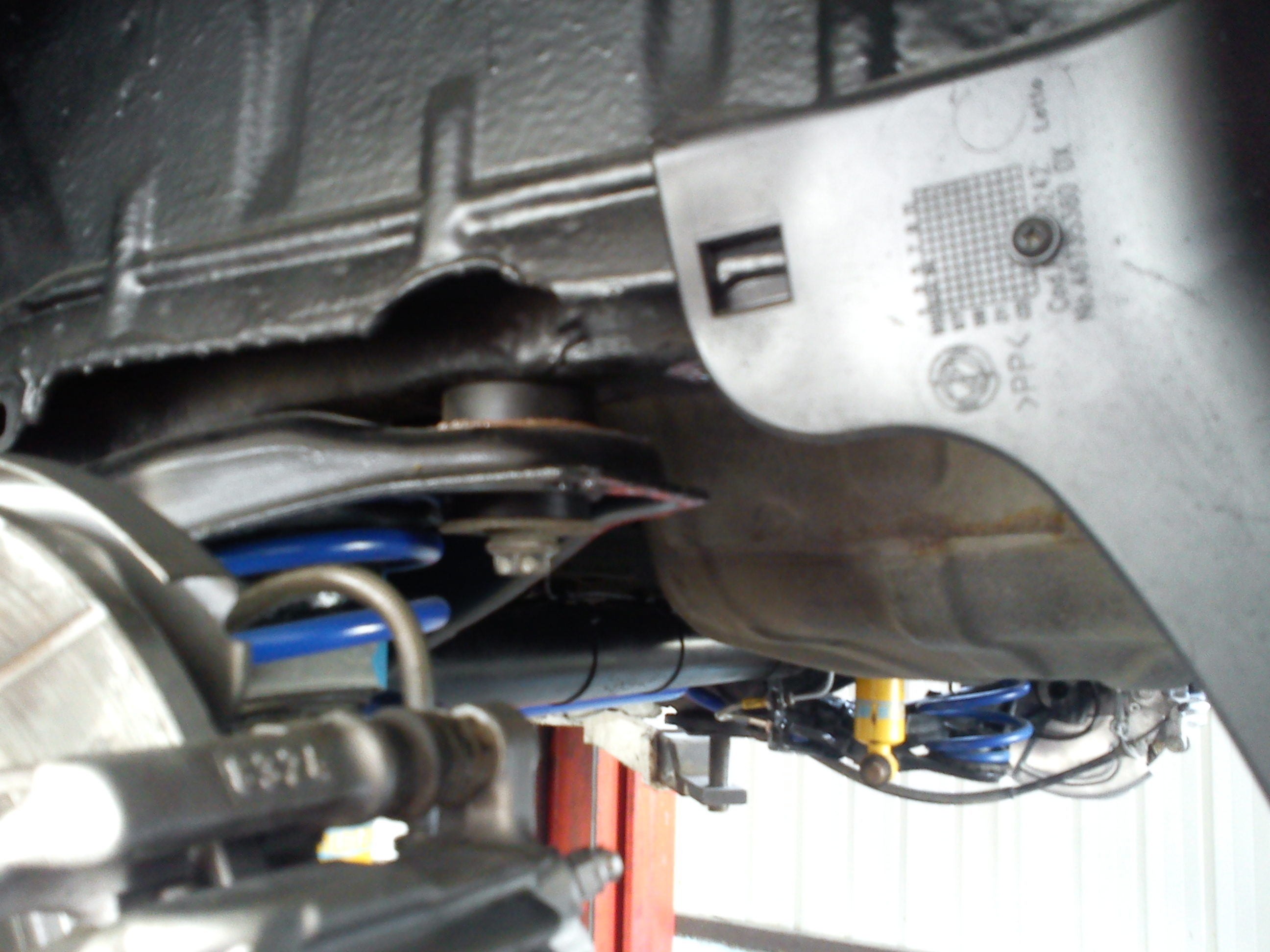

Also I have had the rear suspension down to change the top bushes which i bought a year or two ago.. Funny Thing:rolleyes: !! I still havent used them.
The lathe guy mentioned using teflon instead so have also had these machined and fitted so should never have a rear bush problem again. :D
I will repaint the rear sub frame and parts before having all reffitted.

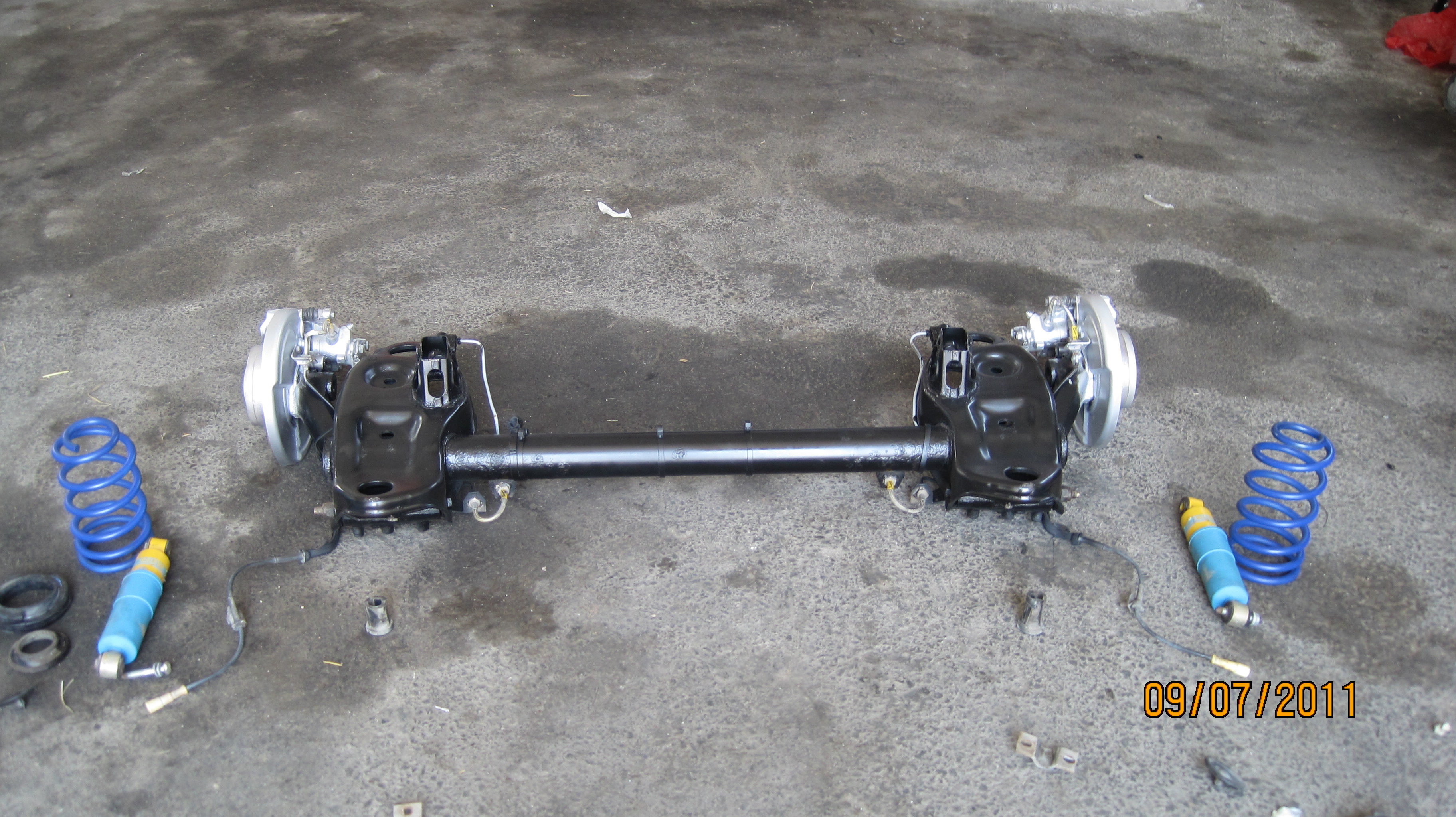

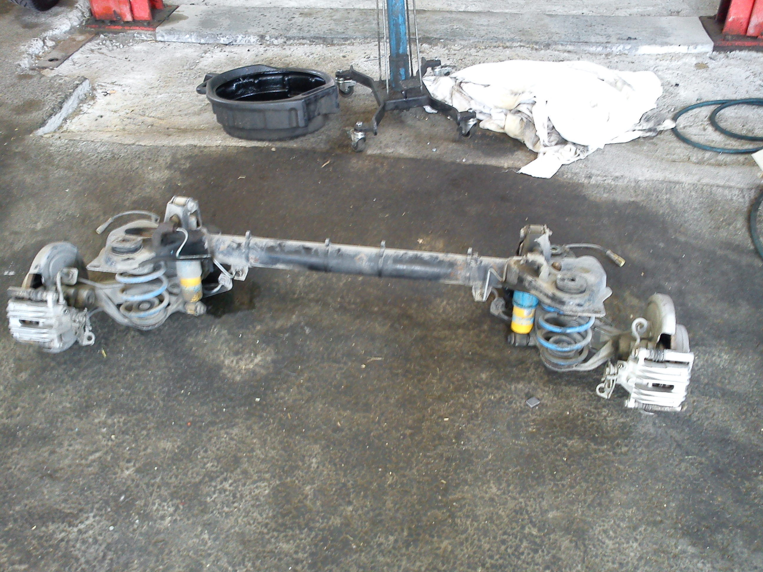

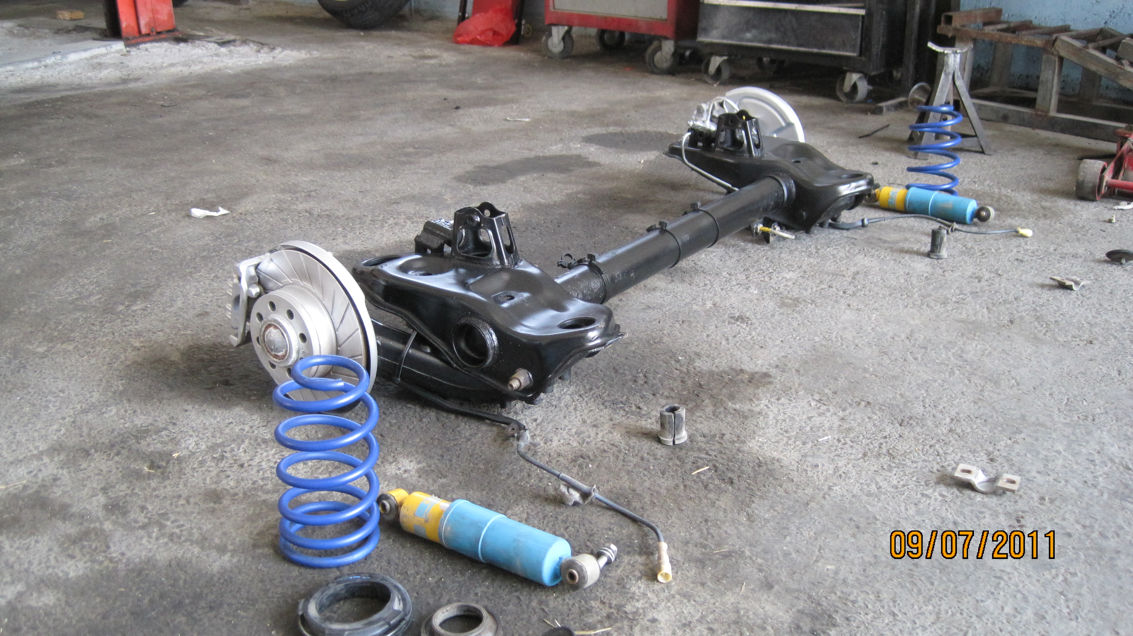

Some more pics, of the rear subframe, now repainted and with the new teflon top bushes, They cant be seen in the pics but the old rubber has been replaced with a solid teflon, which most rally, motorsport cars have fitted.
It may stifthen the rear end slightly but thats a good thing. Will let you know how she feels when back on the road.

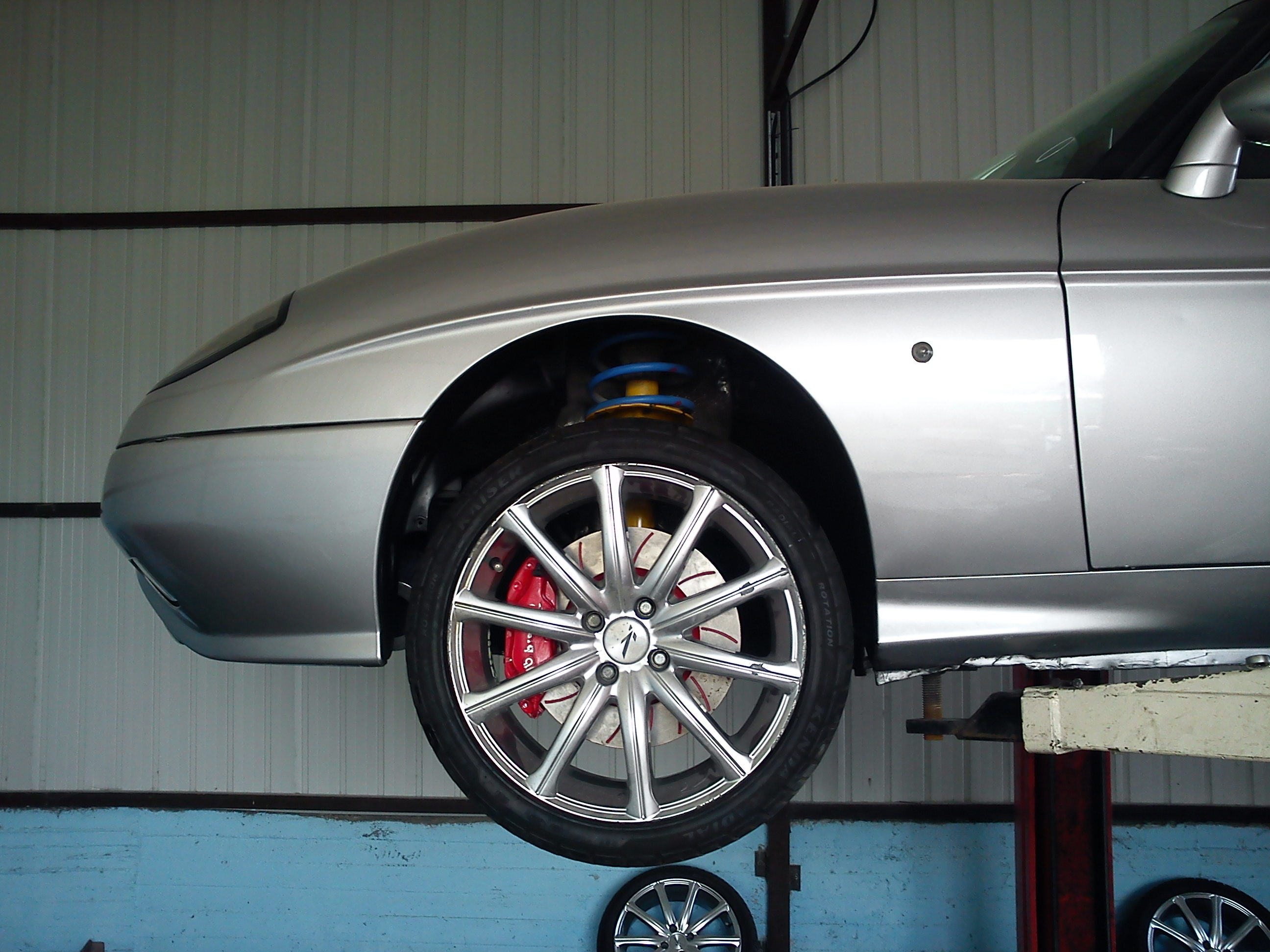

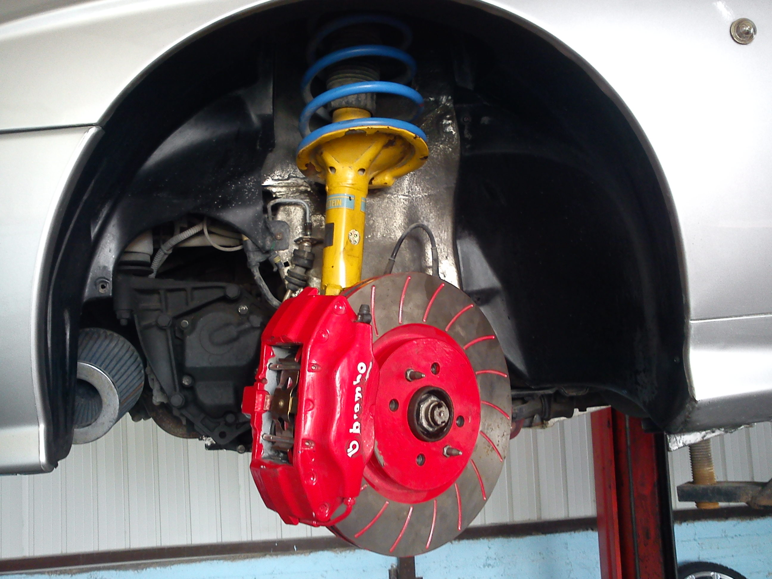

Just managed to get the brembo's fitted today, but they are just slightly fouling the rims, because of not enough offset to them..
Will need to have the discs machined by a mil or two or add a spacer..

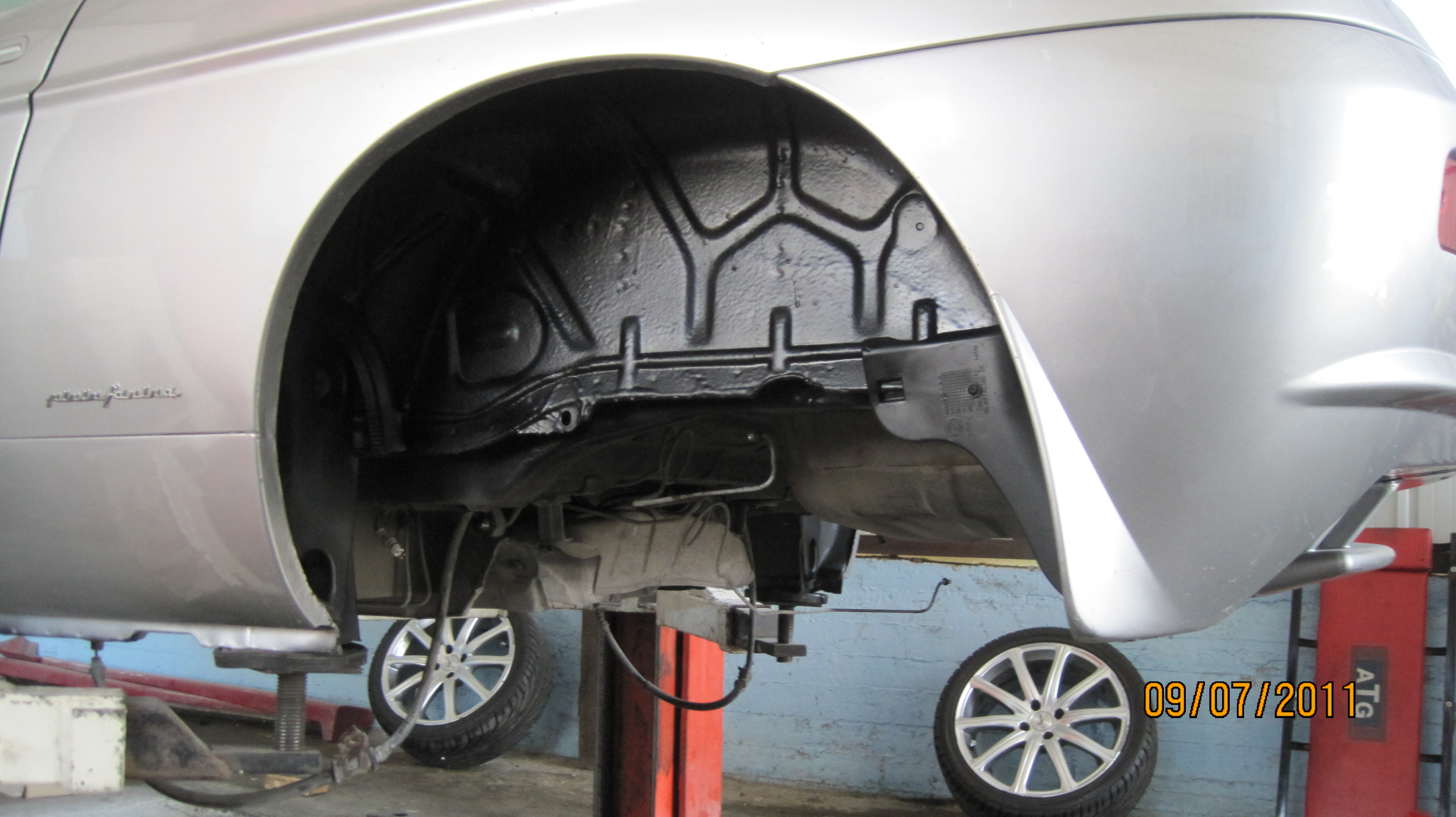

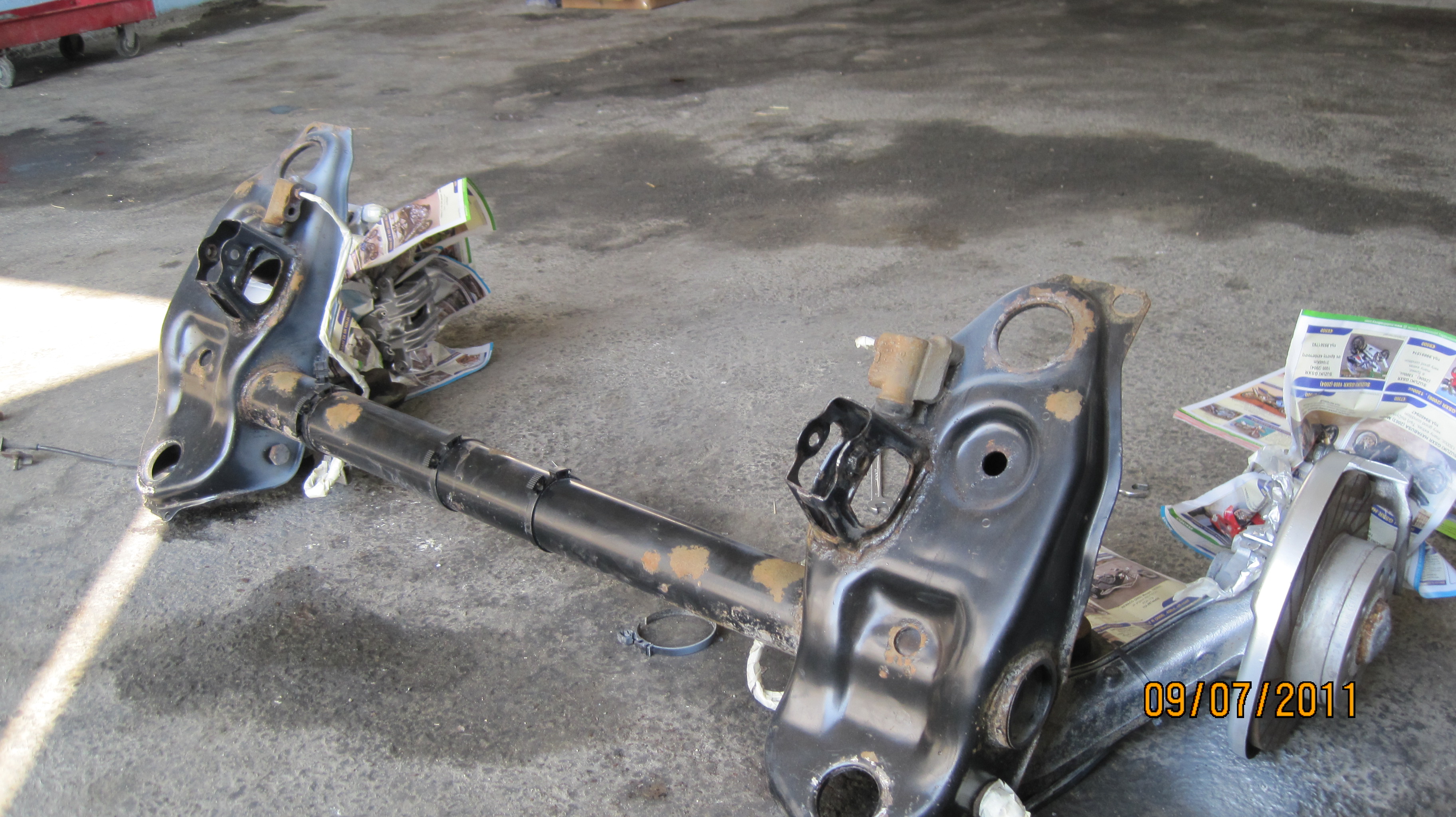

The back axle was in reasonably good shape to begin with, there was only a few spots of surface rust and was just dusty and dirty.
A good clean/ de-grease and scrub with a wire brush and then a rub with a fine grade wet/dry paper to take the old shine off.
Then I sprayed the rear axle with high temp acrylic spray paint from a can and sealed it with a clear coat laquer.
The disks went threw a similliar procedure only i used a high temp silver spray paint.
Once the brakes run on the painted disks it will clean the surace area and leave the rest looking nice.

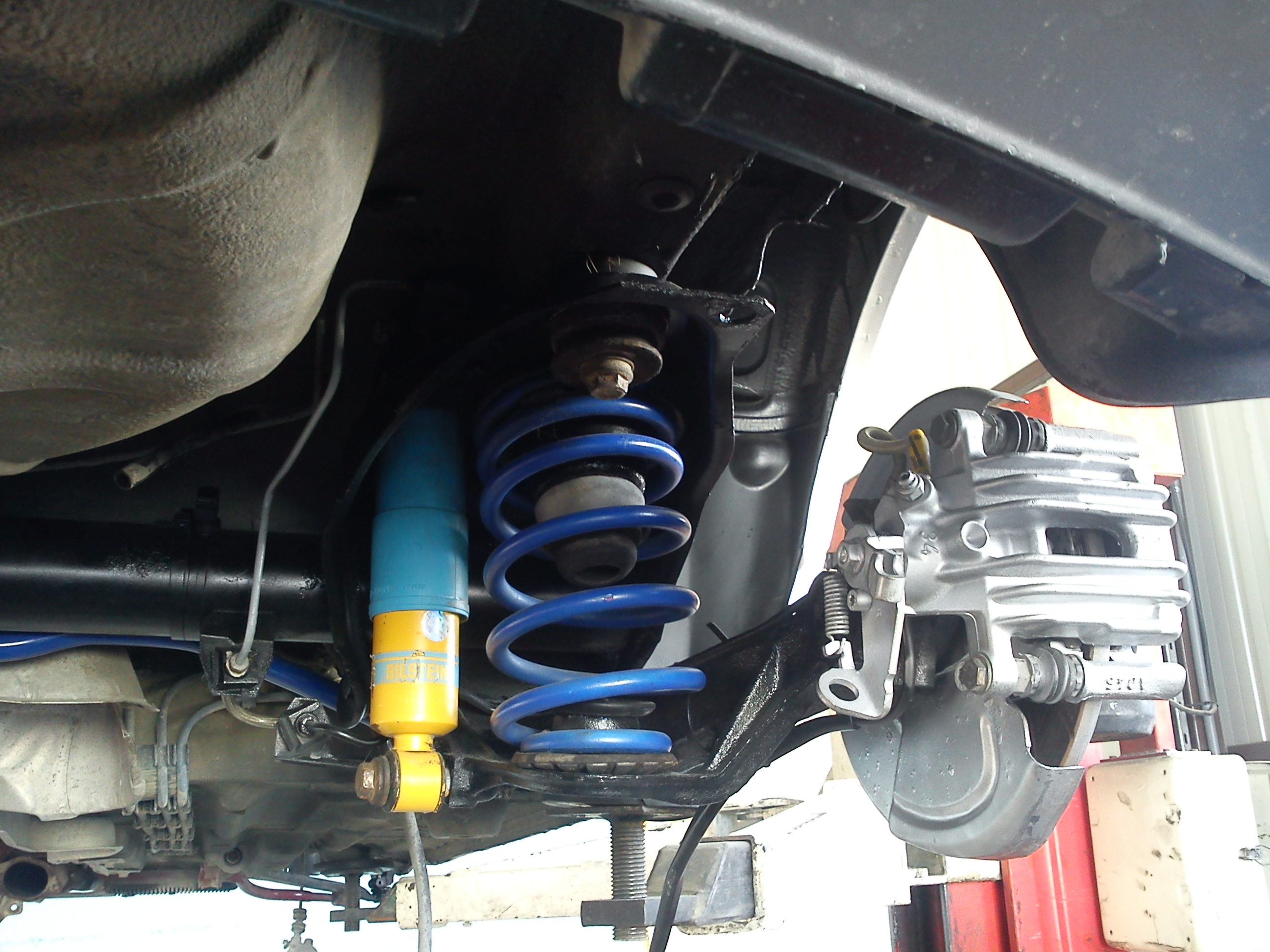

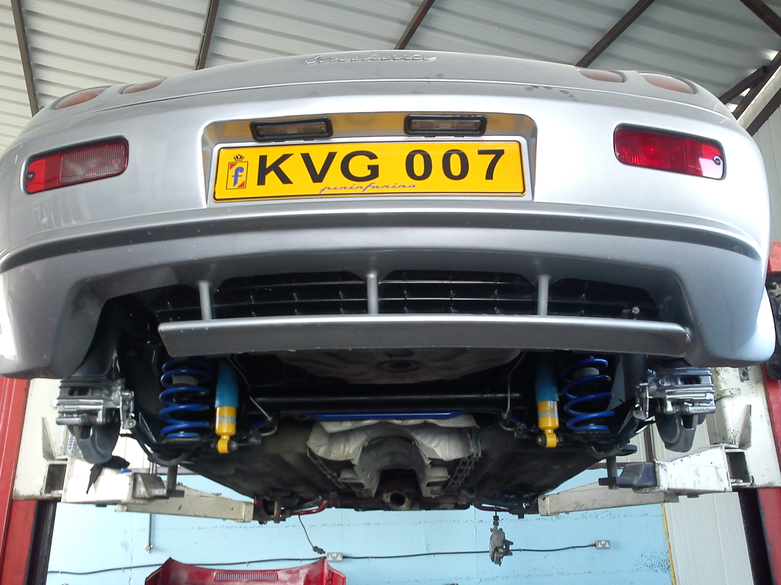

Brembos are on, rear bushes upgraded to teflon, Eibach anti roll bar repainted blue and i will also repaint the front brembo's and discs when i can..
