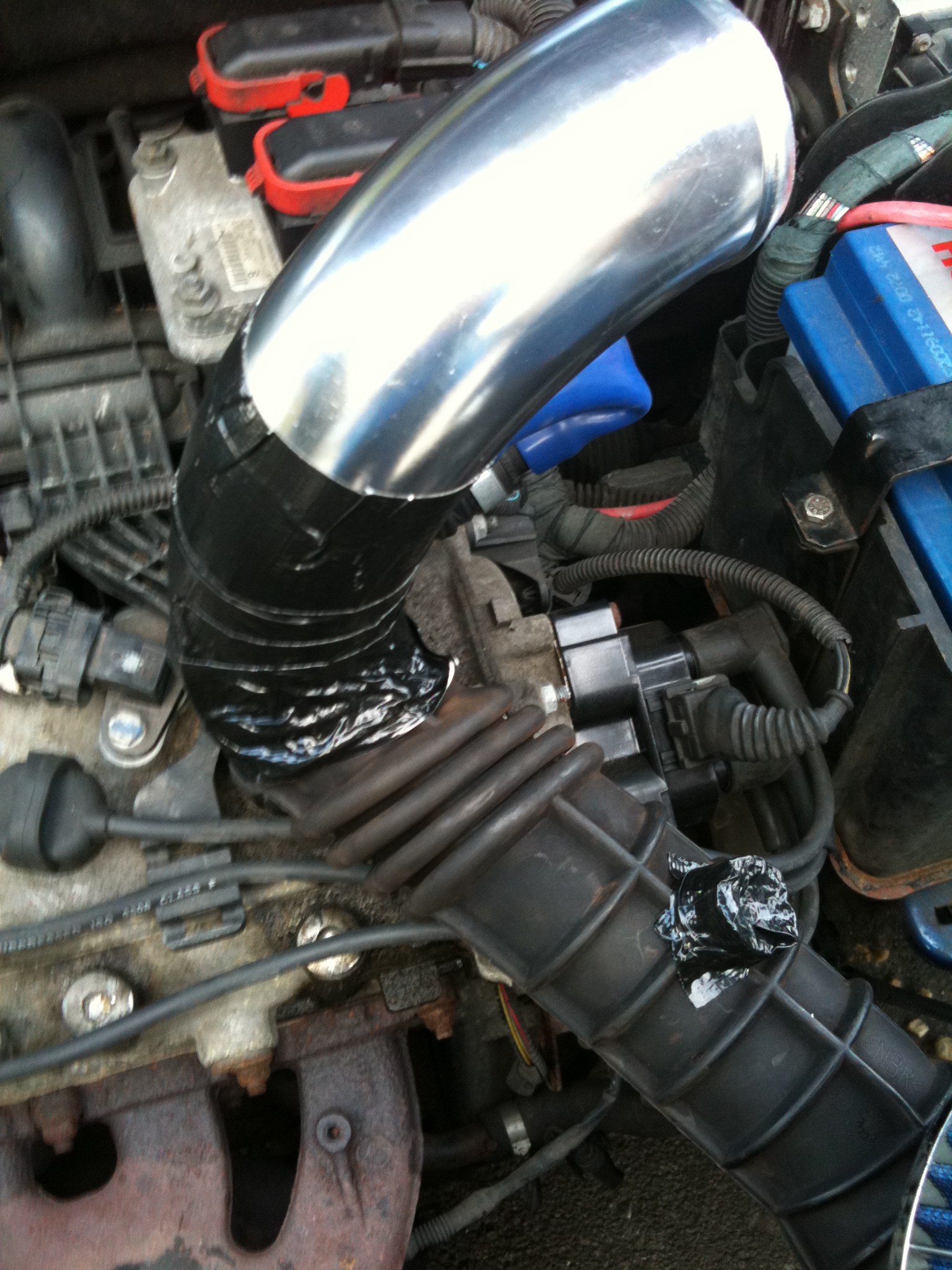

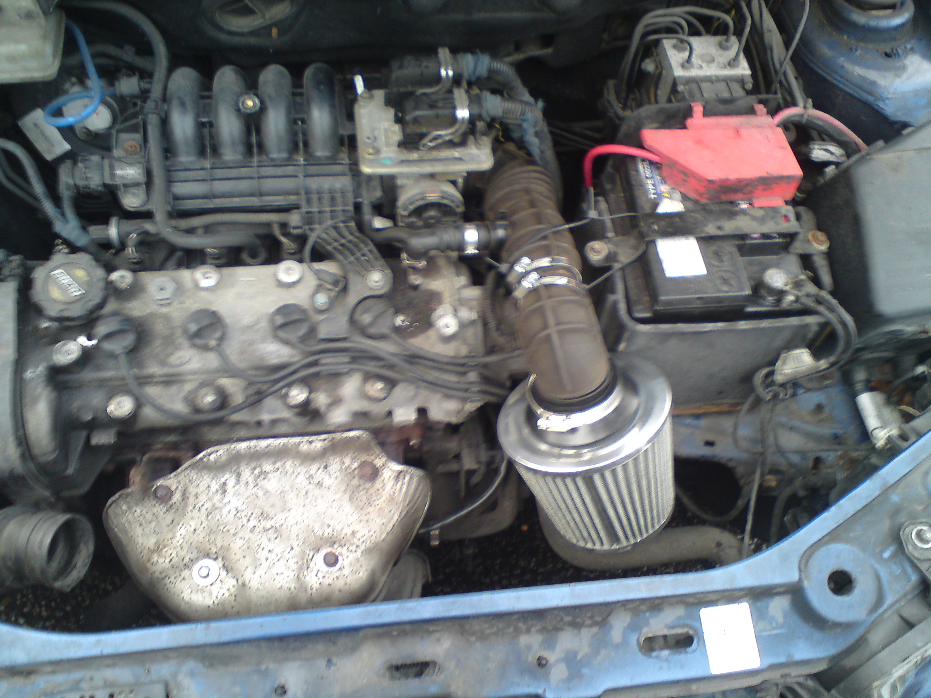

its all good tho. worked pretty well and sounded good, toyosports one is slightly louder than my diy one when u floor it and less turbulance into the engine, but a little more heat soak from the metal pipework vs the diy. id prob look at getting something to reduce the heat soak if i was gunna further mod my punto but cant be bothered now. sounds and looks good so im happy.
lol. simplicity is best. ;)
Our issue was that the Toyosports one wouldnt fit around the battery tray, the 90degree bend wasnt sharp enough, we tried placing it behind the battery, but it sat where the clutch and gear linkage is, and stopped us been able to change gear.
so we decided to hacksaw the pipe to make it fit.
but i agree, simplicity is best. but regarding the heat soak. the 16v engine emits a lot of hit, the plastic air box that sits on top of the engine gets very hot. im sure the our placement to the side is much less of a heat soak than before :confused:
all i did was remove the battery tray, bend the battery strap at the side in a little and drill another hole in the top part for it to fit. solved all the problems of fitment. doesnt sit on the coil pack or anything. ive also routed a cold air feed from the bumper and put it in the inner cone of the filter to get that little extra air flow.

I think one day i might do it properly and buy the silicone pipes to make it look a little more put together than duct tape and yeah ill probably do what samurai suggested and move the battery tray a little bit. But im happy for now lol
