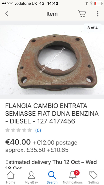

52 euros get it sent to you Italian destination !!!
Dude, in Italy we have a saying :
" You eat as you pay"
It means : Cheap price = low quality. ;)
This is the top quality in Italy, this flange is the best you can find around the world.

Ha yes. But I went for lunch once and it cost me €300 Because it had a good veiw Blew the budget !!!!! [emoji209][emoji1360][emoji1360]
