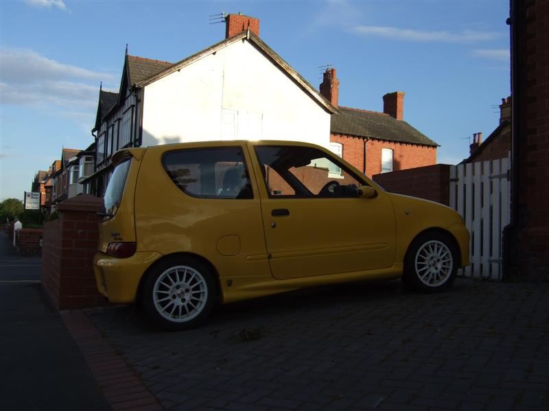

better pic, car on slope but not as weighted!
It does look nice on that picture and has shed any doubts on its appearance, cheers arc (y)

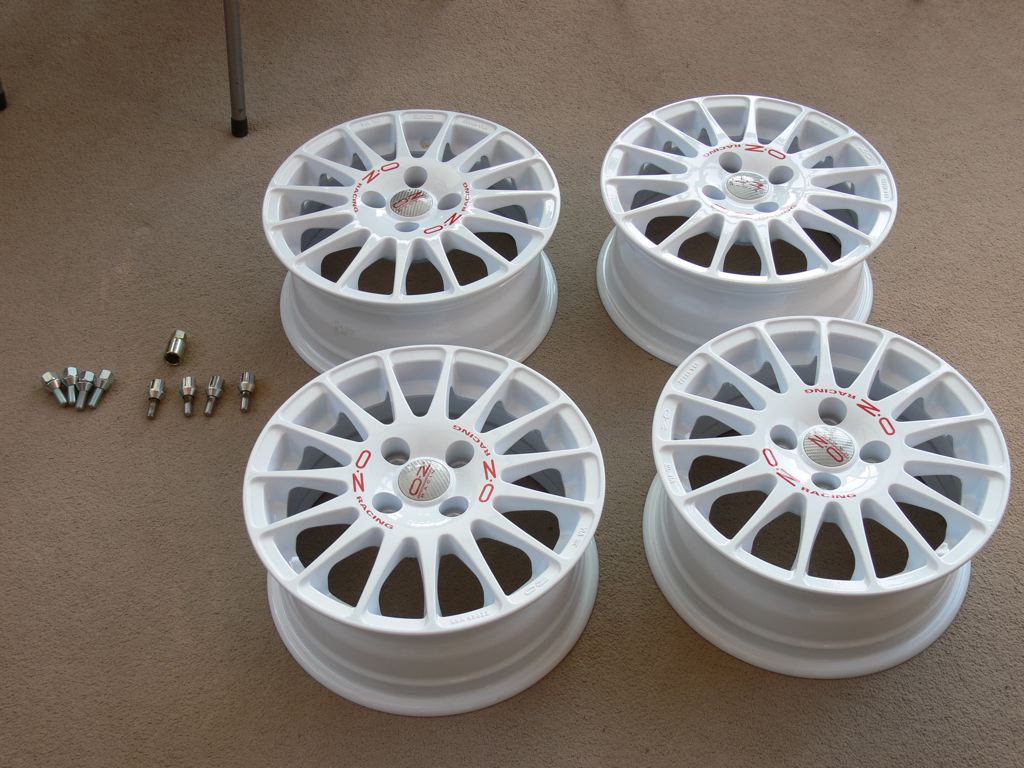

The alloys arrived today :D The came with a full set of wobblys, wobbly lockers, metal spigot rings, and look sweet!

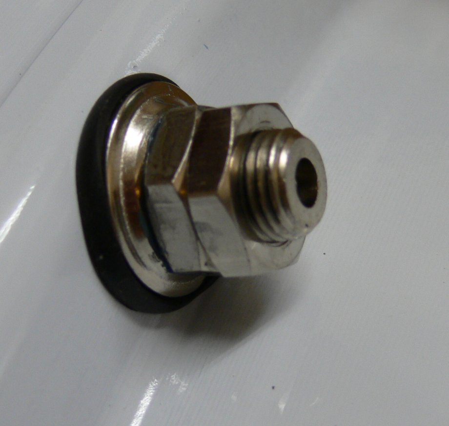

TBH I am thinking of fitting the valves myself with flush fitting valves, they look really neat!! and maybe the costs for fitting will drop as a bonus :)

The tyres arrived today (y) and also the flush fit valves.
Now I can't fit the tyres myself but CAN fir the valves and they look great :D
I will spray the covers white at some point, and then you'll not even know they are there!
I put thread lock on the two nuts to make sure they don't come loose.

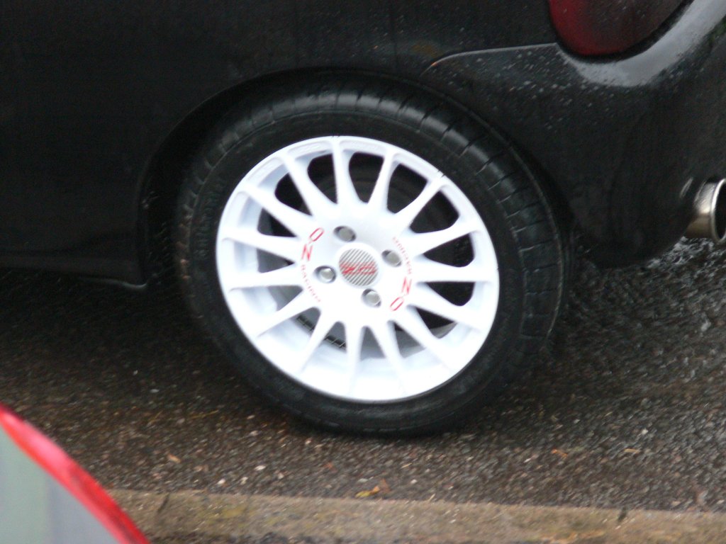

It is absoultly chucking it down today, but I braved the weather, and got drenched....the results were worth it though :)
They look great I think (y)
Those shots were taken about 30 meters away from a window upstairs due to the rain, expect better pics soon.
I havn't done the pressures yet or tried moving it! The rears are very close to the arms, but thats 'cause I have no spacers there..4mm onces arrive tomorrow though :slayer:
not sure what pressure to inflate too....I have heard of max - 10% as a recommended rule, but i couldn't see the tyre pressure on the wall.
For graham, the total weel wheight is 13.4kg, not that light! The 13's were 10.4 Kg although there is less metal and a lot less rubber there.
You all like??
