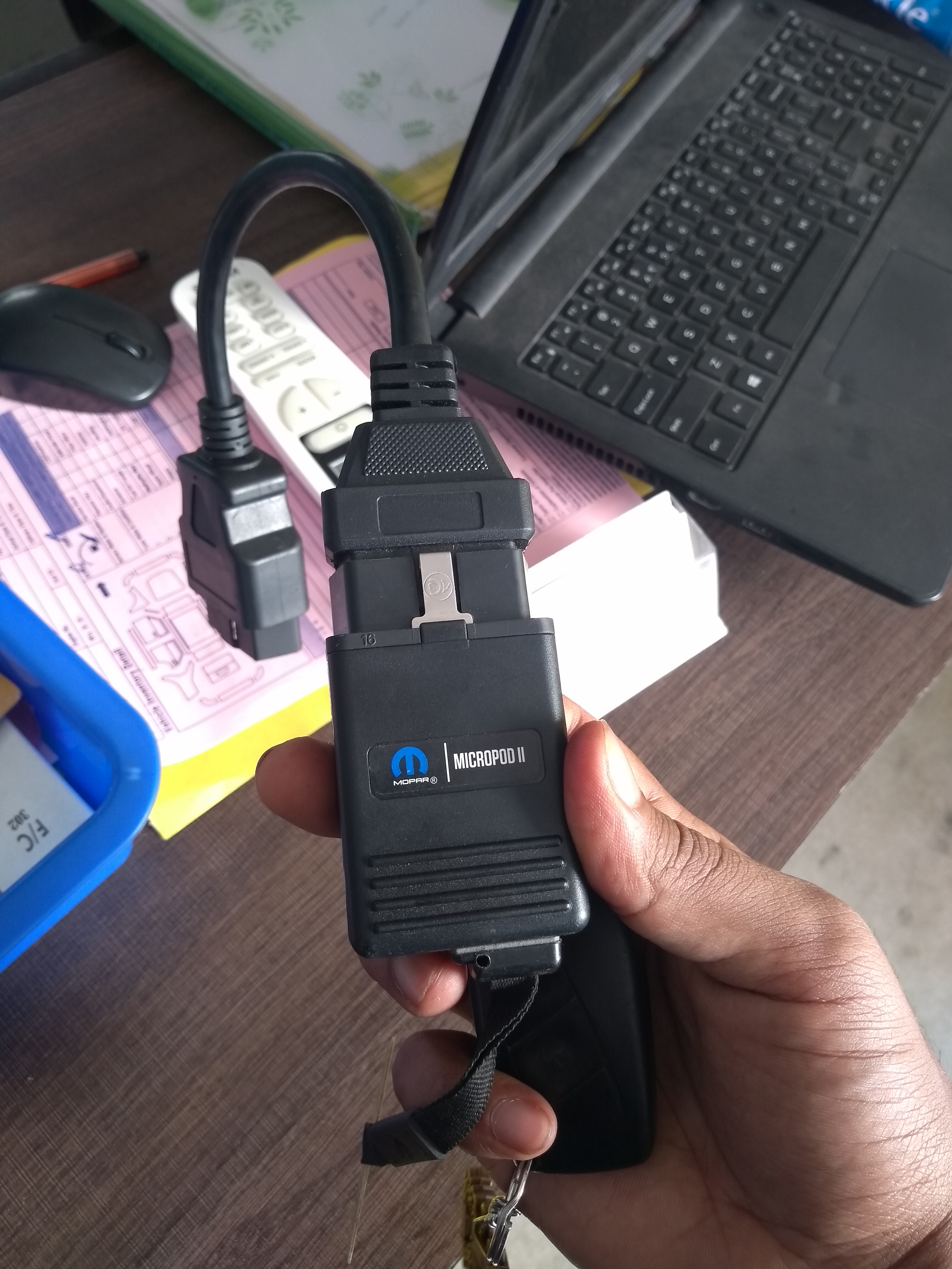

Interesting to see that a missfire is reported as an injection failure. What OBD tool did you use ?

Service person in FASS used Mopar MICROPOD II for OBD scan and said since the problem is mentioned as 'intermediate', we go for hack for now.
Yeah. I will replace the failed coil soon.
Attaching the photos I taken for Mopar MICROPOD II.
