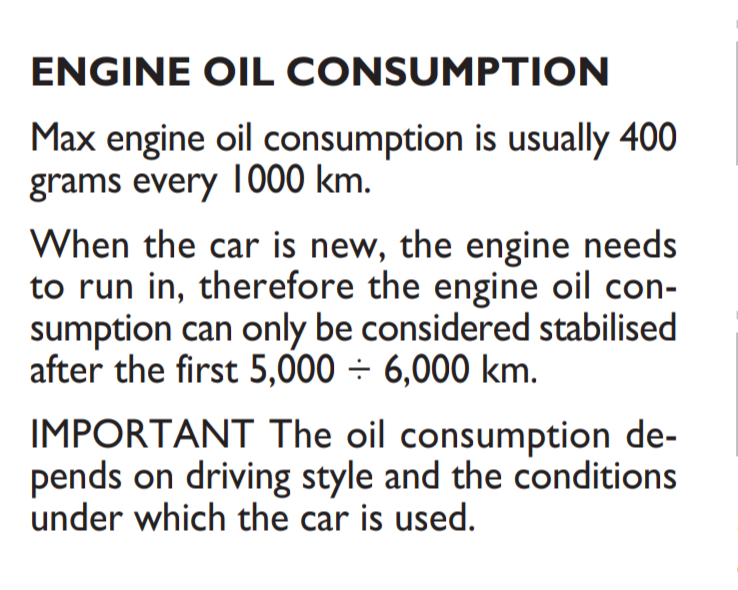

. After 6500 miles I had to ad 2l of oil
They vary quite a bit in oil consumption from car to car, some people never top up between oil changes
But fiat usually quote 1 liter per 1000 miles as acceptable limit on most of their none turbo engines
3250 per liter is well within expectable
It should say in your owners manual, here's my car

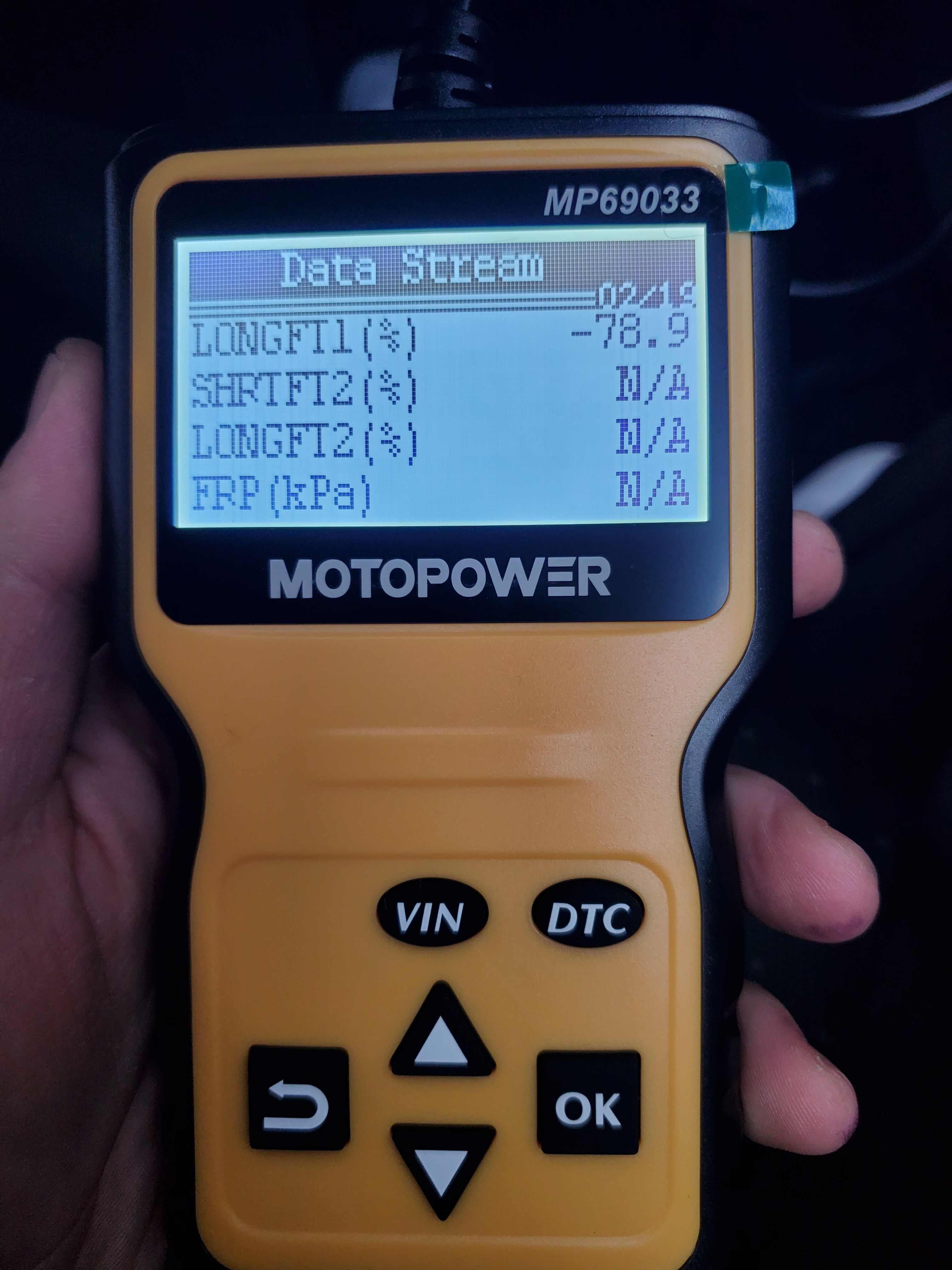

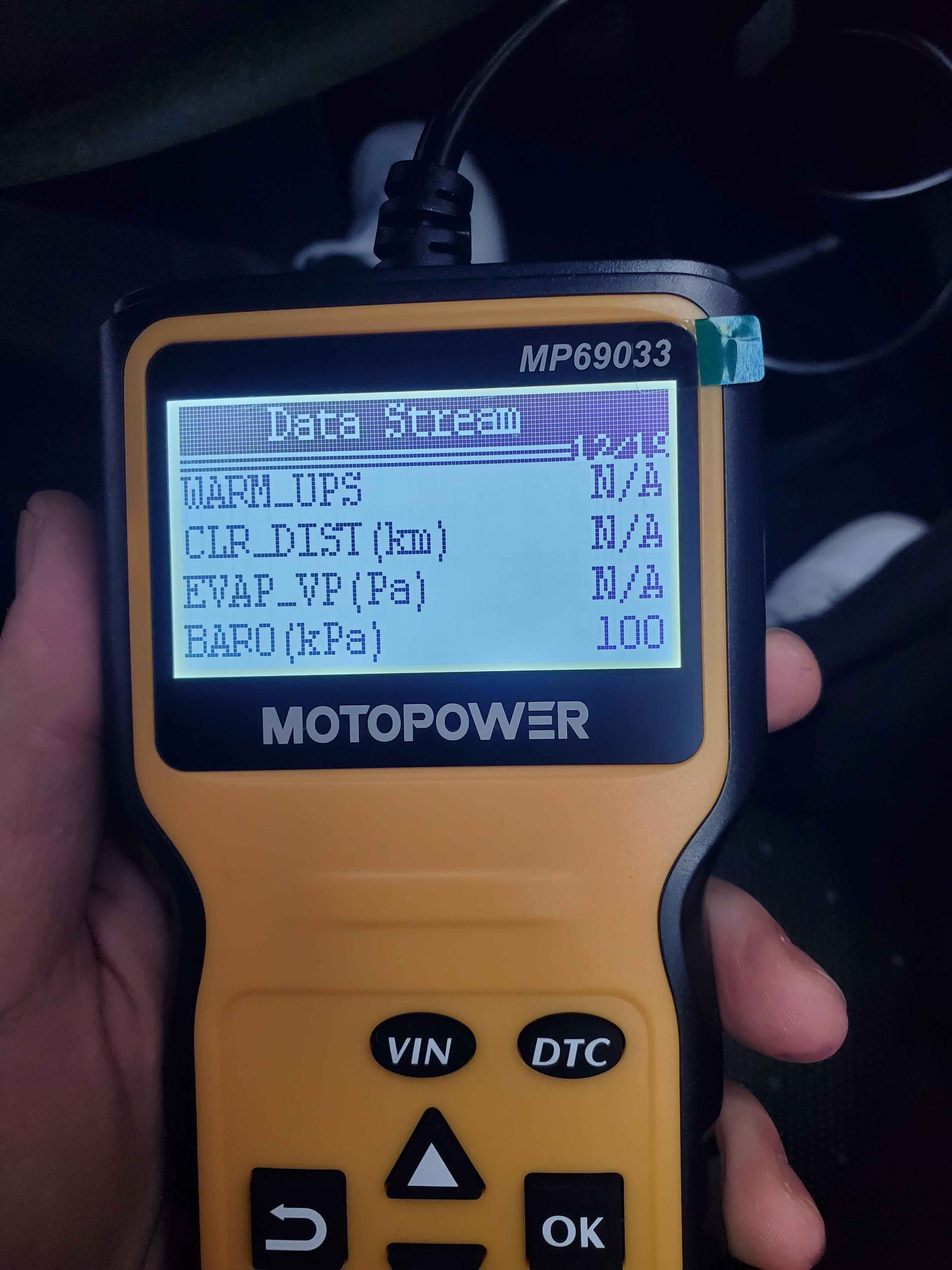

So I just came from work and done some check no error code on the diagnostic tool..I will put some photos of the diagnostic tool and the oil on the card..I have done a video of the smoke usually I haven't seen this smoke maybe because today it's cold and foggy?

Does your scanner do a list of Error codes showing rather than the live data?

Maybe..however the photos from the scanner are not live..because the ignition os on but the car was not started..one thing that I noted is the Spark advance in the photo attached...as you can see it's -47 when it should be positive..after some research I find that negative Spark advance means """Negative timing refers to the spark plugs firing afterthe piston reaches top dead center (TDC) on the compression stroke, instead of before. This can lead to several problems, including reduced power, increased fuel consumption, and engine damage."""
Possible cause of negative Spark advance:
Incorrect timing belt or chain installation
Faulty sensor readings
Vacuum leak
1 month ago I have done the replacement of the timing belt on a garage in Manchester...and the problems have started after this..I don't wana think that maybe the installation of the timing belt was incorrect

Engine not running, most of the live data is meaningless
Except the MAP sensor is reading the atmospheric pressure correctly
This also applies to the Grande Punto.
If the OP has done 6,000 miles and used 400ml per 1000 miles thats 2.4 litres. More or less what he says he has put in.

I have just checked my owner manual and it states max 400 ml for 1000 km..so probably the consumption of oil is normal because I have done 10000 km and topped up 2l so basically 200 ml per 1000 km consumed.
However tomorrow I will replace the oil and filter..just bought the oil that fiat indicates Selenia 50W-40 and before I will flush the engine and after put the new oil in..I will monitor it 😀
