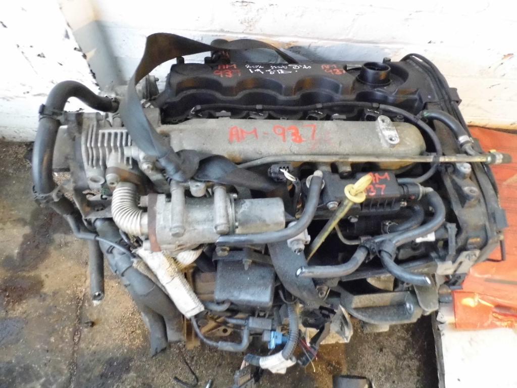

This is the ones that I am trying to find which goes where.If anyone can tell me that would be great.
It can be a bit tricky to find.If you are looking from above the engine they are right underneat the EGR valve.I think its easier to see with engine cover off.If you look at fuel filter and then left and a bit down you should be able to see them.I have marked with red in the picture where roughly they are.Many thanks

So I had quite a few looks over the internet at those hoses.From what I can see is that one hose that is coming from overboost valve is going into the vacuum tank directly.The one that is coming from the bigger hose (I think its the vacuum pump) is going into the upper part of the vacuum tank.And the one from the shut off valve is going in to the upper part of the solenoid/valve.I have done all this on my car but still no luck.As a matter a fact it seems worse than before.Does anybody with Fiat Stilo 1.9 jtd lives nearby Perth,Scotland?
