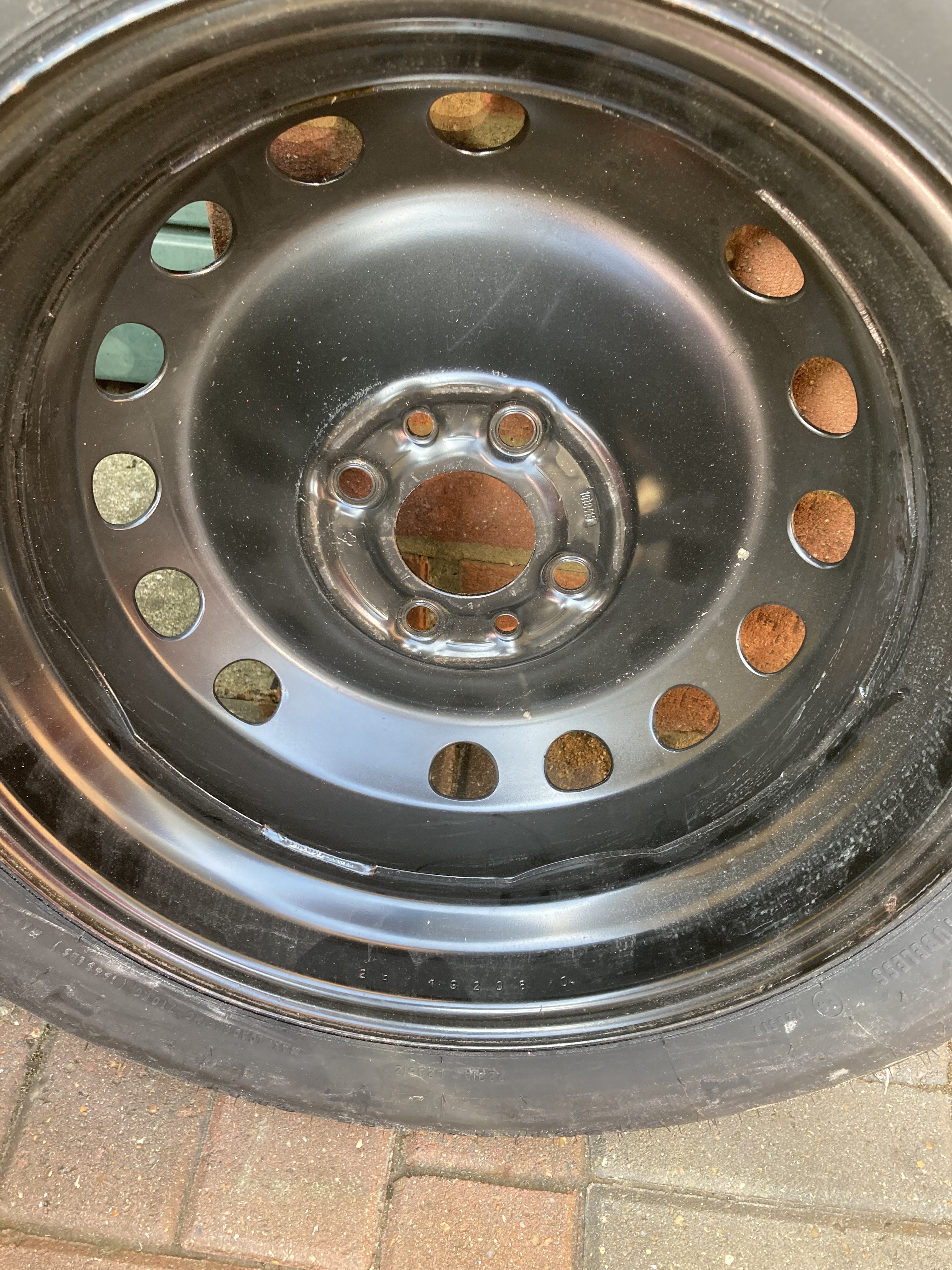

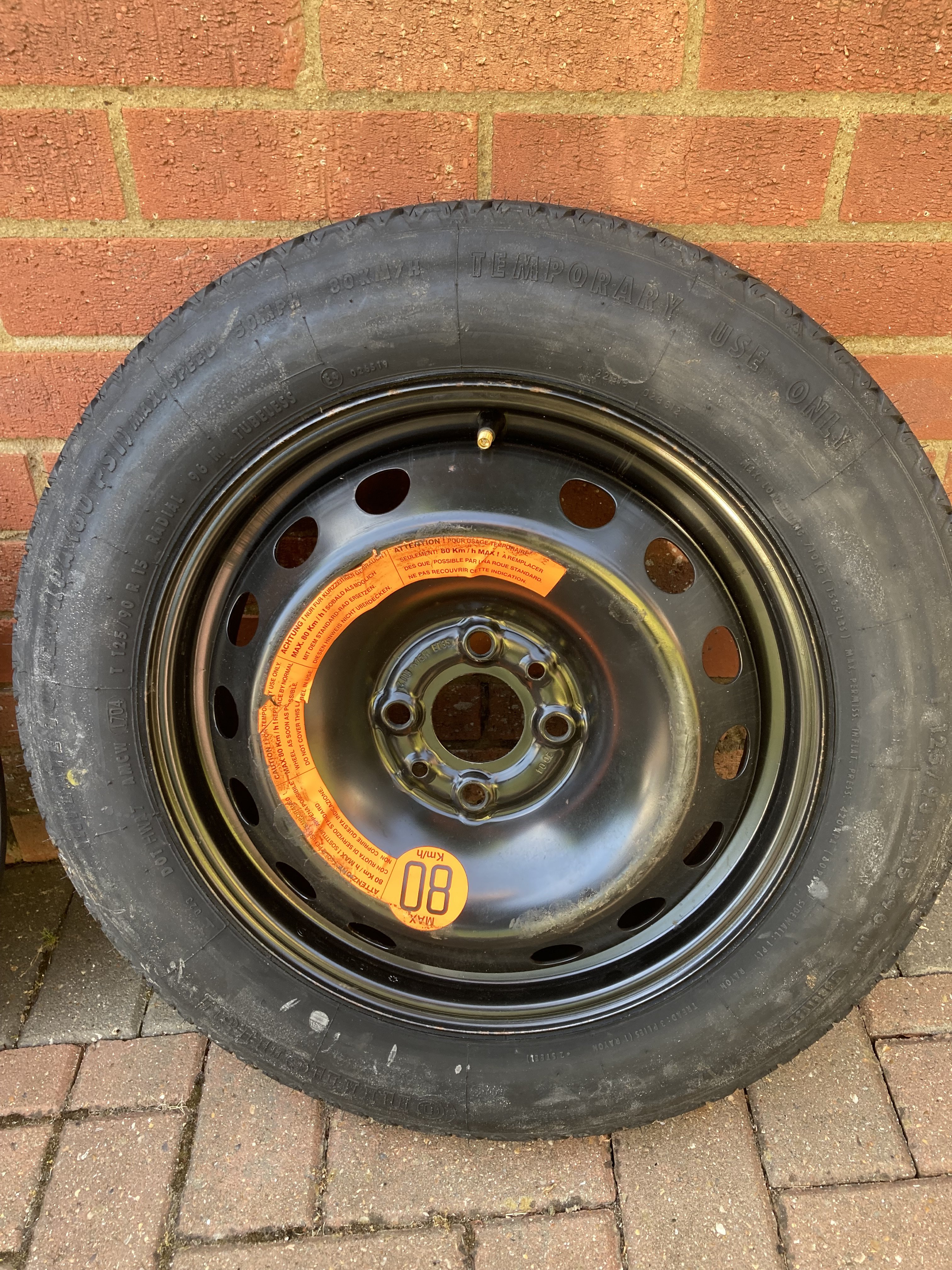

Hi,
I have a 2004 Stilo 192 1.9 JTD 3 door complete spare wheel kit available for sale and have been asked the distance between the wheel bolt holes on the spare wheel. It looks to be 7cm but does anyone have the technical information on this or know where I can find it please. It’s difficult to measure to an accuracy that would be required.
Thank you to anyone who can help.

Yes FIAT is conventionally 98PCD
easiest method:
Get a tape measure
Set the wheel so the 4 bolt holes are at 'compass points' North East South and West
Put the tape measure on the WEST hole
With the 100mm mark on one edge of the hole (left edge)
The East hole..same Left edge should now say 198mm (100 + 98 )
Ask if you need more info :)
