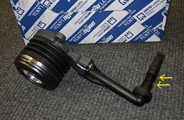

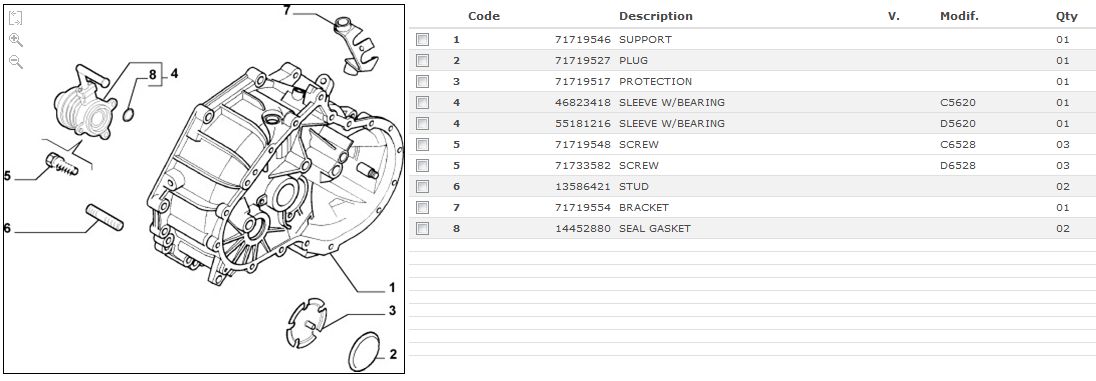

same problem with the clutch. clutch pedal is on the floor and i have no clutch. no sign of any leak but still trapping air somehow. i've bleed the clutch using a bleeding pump. after, everithyng was fine and 2 days later same situation. Anyone knows what is going on with my clutch? how can i check to see where is catching air though? a mechanic sugested it could be the O ring on the bleeding pipe but i haven't seen any O rings on the pipe when ive done the bleeding. in ePER, in the clutch section doesen't show any O Ring on the bleeding pipe. Anyone?
Some JTDs with the internal clutch slave cylinder have two "O" rings on the cylinder pipe to seal the sliding bleed mechanism, as arrowed in this diagram.

I'm going to ask fiat dealer if they sell separately the O ring and try to get hold of them. if that will fail to fix the problem are there other scenario of what could be the fault for catching air in the clutch line?
I had some on order with local Fiat dealer for about a year. Eventually, they told me the seals were no longer available as a seperate part.
They are still listed as "orderable" on ePER though. Part number 14452880 £0.79 (GBP)+VAT each but are shown as only orderable in packs of 10. A dealer may not want to keep the other 8 in stock so you may have to buy the pack if you find a dealer that can get them.

No.. I was just gradually getting all the parts together for if/when I need a new clutch. I saw the "O" rings on ePER and didn't know what they were for so I ordered 2. Later, when I bought the new concentric slave cylinder, I realised what the "O" rings were for.
