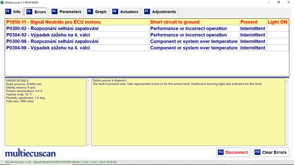

I have some codes. I cleared them and started the engine and only one came back, the earth to ground problem. The other codes will come back when i drive the car again. I'm scratching my head... :)
Can't say i'm fussed with the Polish(?). How can i change the program to English?

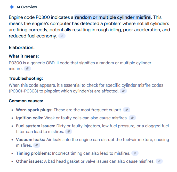

Google AI says the following;

OBD is a worldwide standard
The initial 4 digits point to a GENERAL fault =. Misfire (general or specific cylinder)
The dash and 2 digits point to a likely problem
Lost Earth, poor Signal, low voltage etc
My Google search for your - 98 only found a Alfa forum post.. But at least it's Italian / related
Many descriptions are for Honda / VW actual error may be different for you 🙄
MES should give an accurate description 🙂
When I clicked on the MES description it gave the "98" as a misfire with overheating, no extra information. I've cleared the codes now but I'll be driving it later today and I can check again.
I googled and -98 is the secondary fault overheating, but it would seem to mean fuel not being ignited and then extra fuel exploding more strongly.

I found a website relating to a -98 error on a Fiat 500 that turned out to be a faulty injector, he found the problem with a resistance test, i think he took the injector out and tested the resistance across it.

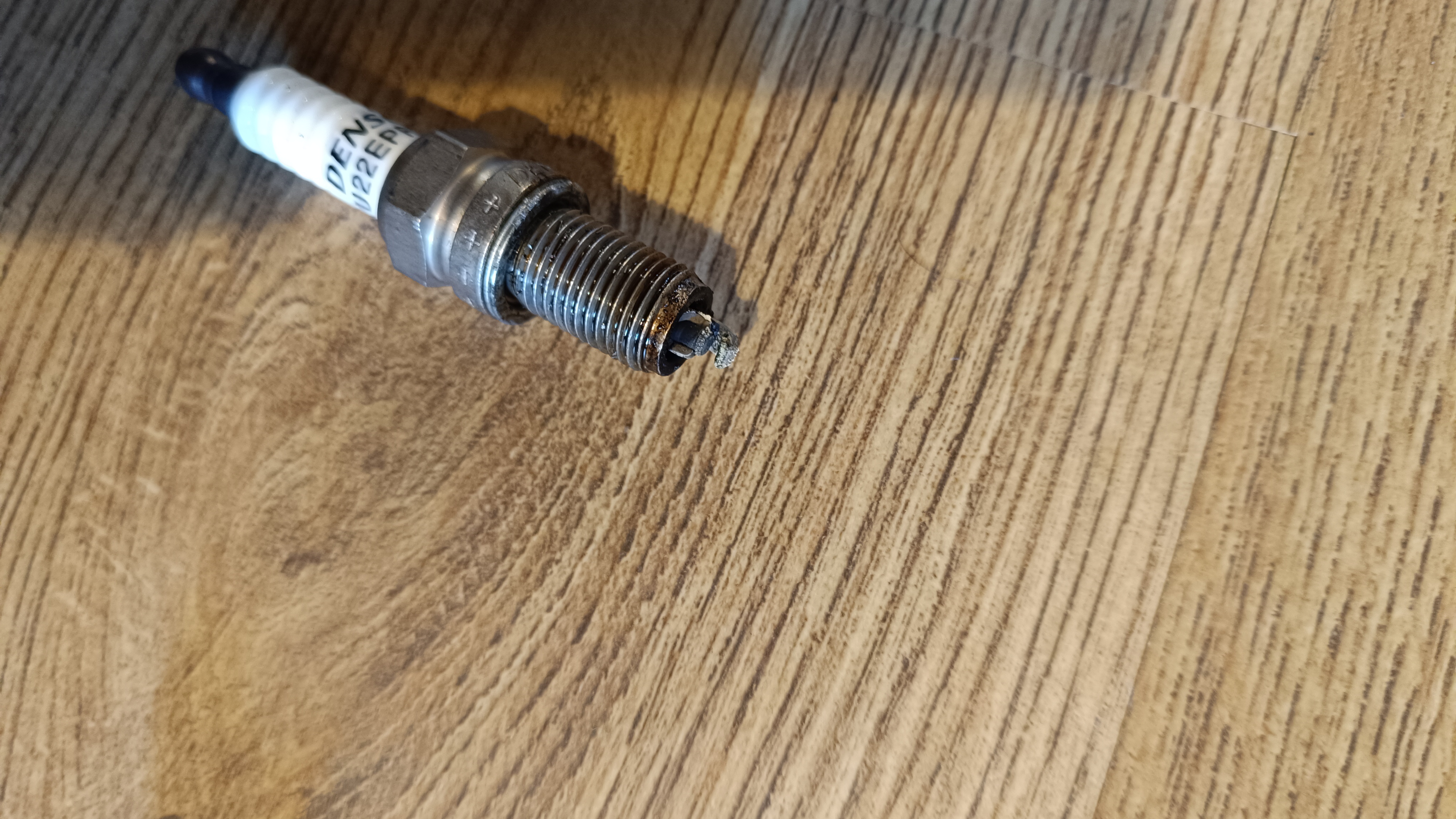

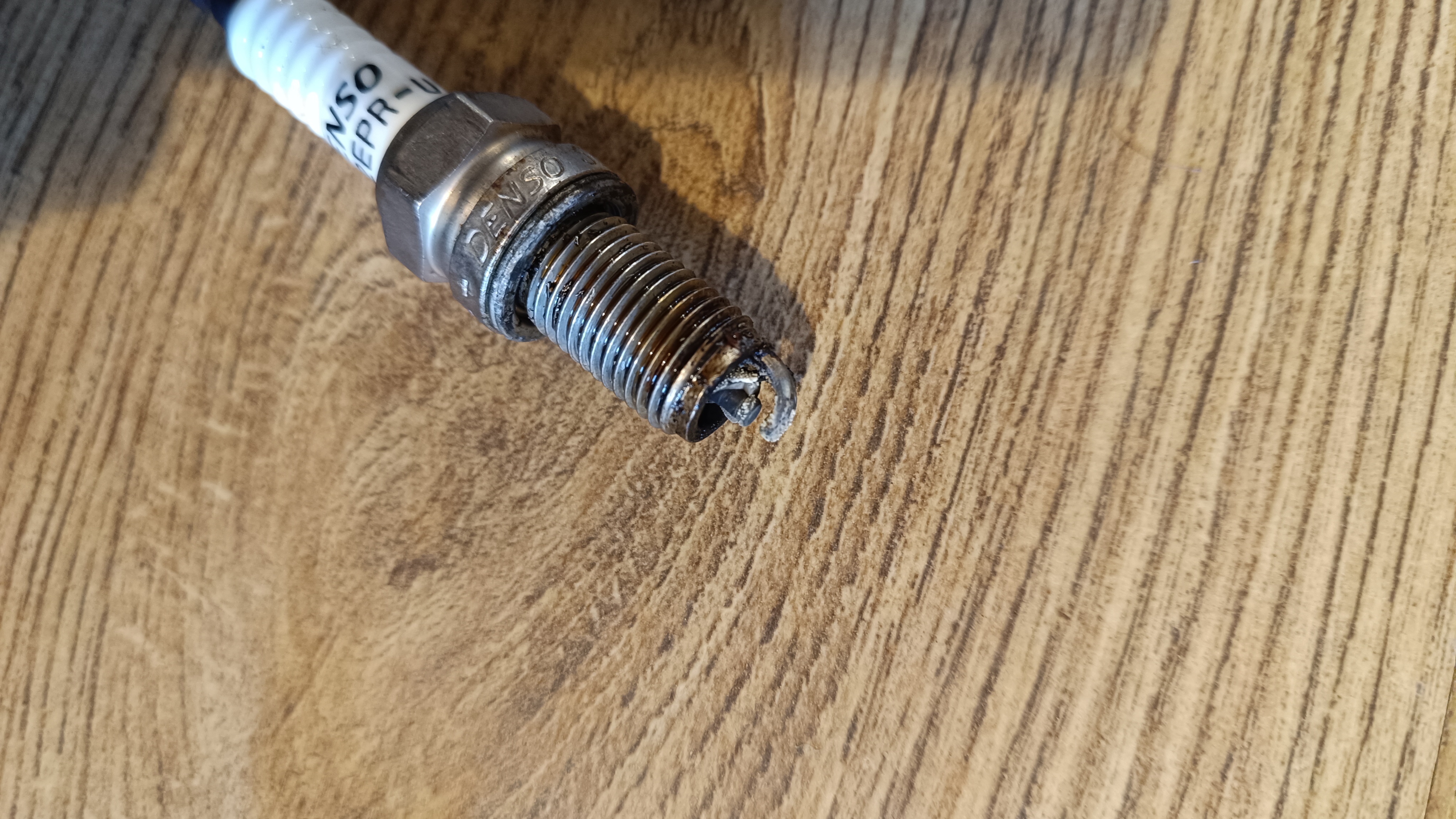

I don't think it is the spark plugs either, but i'm going to change them on the basis that I bought the very cheapest set I could find, and if they are the problem it serves me right lol. And i'm also going to replace them because i have some spare at the house. I'll report back later, hopefully there won't be any mishaps :)
Happy days! So what make were your "cheap" plugs. If they are the simple "copper core" type they look to be then the 20,000 miles you mention they've done is pretty good going.
I didn't know that. I thought they all lasted about the same as each other, 50,000 miles. I only changed out the plugs for position 1 and 4, because the codes indicated they might be an issue, i wish i'd also done 2 and 3 now. Anyway, the MOT is next week, this may throw up bigger issues i'll have to address.
They were Denso copper core spark plugs.
Good enough quality Denso is. It's only stuff like iridium and platinum tipped which will go to "starship" mileages. When I started out in the motor trade a "big" engine service, often yearly or around 10,000 miles (but with an oil change at maybe 5,000 miles) would include an oil filter and engine oil, air filter, set of spark plugs, a rocker cover gasket because the valve clearances needed to be checked and, often, adjusted. Then there was the distributor points and often a condenser too. Now a days you can pretty much take spark plugs out their boxes and fit them to the engine because the manufacturers pre gap them for you. Back then you wouldn't have even thought of doing that without checking them with your feeler gauges. The points had to be set up too, quite a skilled job, and, if you were being diligent about it, the timing should really be checked after new points were fitted. And that was just a simple engine service! Brakes would need to be manually adjusted on every wheel and there were other tasks too. There's much less to do now a days but the manufacturers have often made access to components a lot more difficult.
Edit. Copper core plugs? actually pretty much all plugs have "copper cores" but it's the metal used at the tips which make the difference. But it's become a convention to refer to basic (ie non iridium/platinum) plugs as "copper core". Basic plugs are absolutely fine but if I use them I pull them at every service, check the condition of their electrode ends and regap them if I think I can use them for a bit longer. I would not fit basic plugs to a modern wee turbo engine but I'm happy running the likes of our Becky (1.2 Panda) or the Jazz my daughter in law had, on them. My local factor sells them really cheap.

I paid £2.84 each for 8 of these Denso plugs a couple of years ago, it felt like a bargain at the time. I fitted 4 to my EVO and intended on fitting the other 4 to my GP. I decided not to fit them to my GP because the spark seemed fine and it felt like i could potentially give myself a problem where there wasn't one. Two of the spares have just gone on the EVO. Its quite possible that if i'd not changed them 20,000 miles ago the old ones would still be working! Anyway, i do a lot of miles so I'm going to fit Iridium tipped plugs whenever possible in the future.
