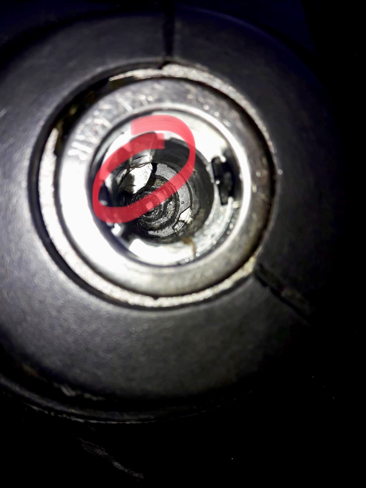

Is that the ignition ring in the remains of the barrel (photo). Is there a transponder within the key? Is it possible to hold the key into the barrel and turn it over with a screwdriver?

If the ring is still there hold the key against the side of the and lock and turning the key should start the engine if it's un damaged
But as above they shouldn't have been able to start the van by just breaking the ignition as the imobliser should stop that?

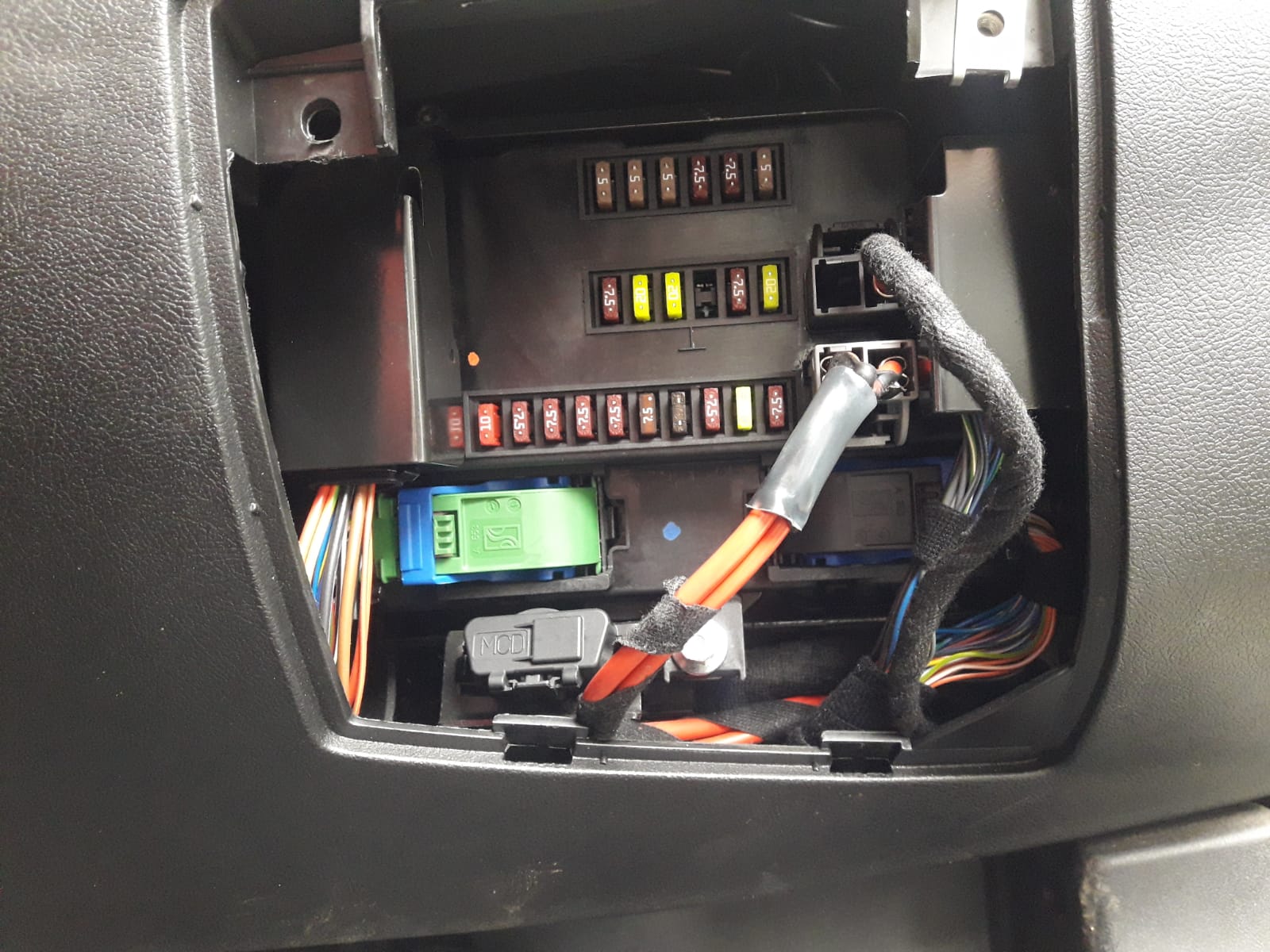

They had broken the cover and accessed the fuse box below the steering wheel.i cannot see any tampering tho.

Don't suppose the cover was off The obd port when you picked it up?
But looks like they used a laptop via diagnostic port to bypass the imobliser
I literally drove it home and parked it up for 3 days before it went missing. From memory the fuse cover was loose. After the theft or was broken and thrown on the floor, so they defo accessed it. Is the diagnostic port the black one labelled MCD? If so, it was still covering the port when I collected it.

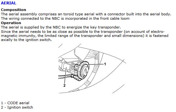

Yes the 'aerial'is probably just a ring that clips around the lock barrel

It should be clipped to the ignition lock body with a wiring connector plugged into it, Just unclip it and swap it to the new lock assembly.

I have now changed the lock set. The antenna ring was intact so that clipped back on and the whole setup looks like new now. I changed the key in the transponder and it starts without issue.
