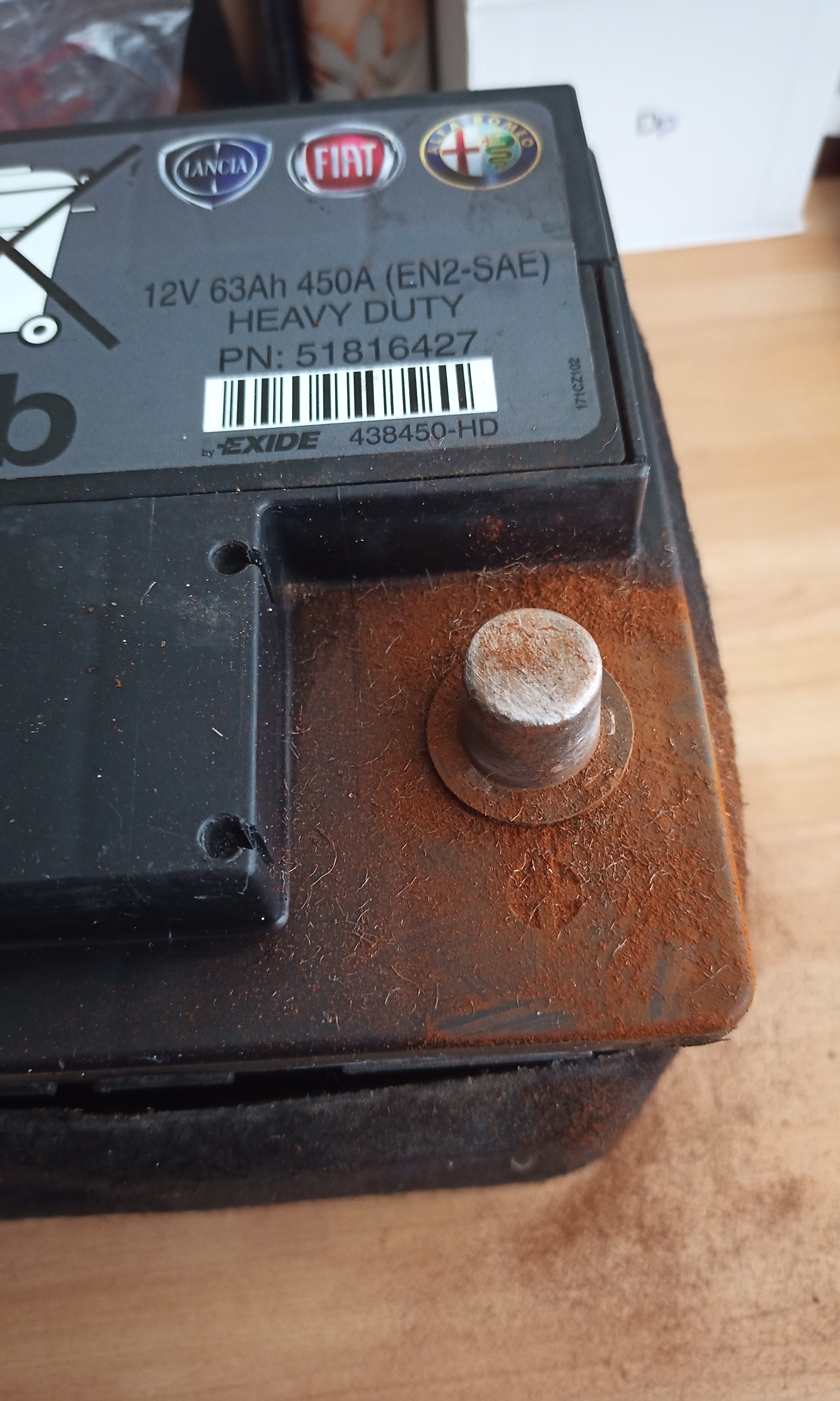

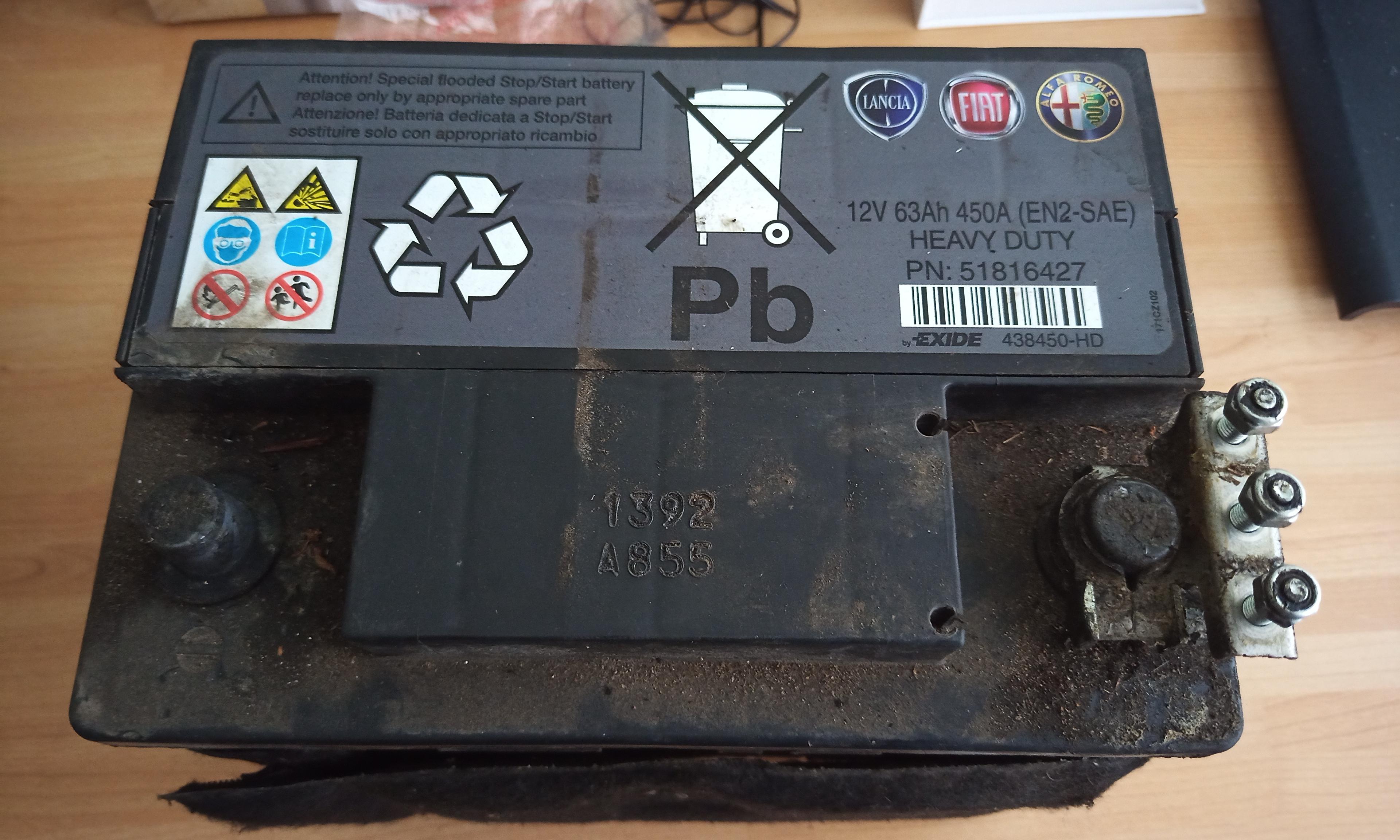

Before I set fire to myself or - worse still - my house with the missus inside, would it be possible for someone to advise as to whether it is OK for me to trickle charge my Fiat Panda 2012 Twin-Air battery please? Here it is:
Looks like the same battery from brand new(?) Judging by all the dirt I'm guessing the previous owners didn't really do that much maintenance on the car in general.
I purchased my Panda back in July 2023. I live in London and only use it on Saturdays to go to the supermarket.... I think the battery is drained because when I tried to start it this morning I got a bunch of sensor errors and a rapid clicking noise.
(If I can trickle charge it I will clean up the battery connectors to confirm that it isn't a bad connection.)
Cheers!

If thats the original battery from 2014 it's done really well to last this long but it's well overdue a replacement & I would really consider changing it for a new one as most of us on the forum know the original ones never last this long usually with false errors being thrown up, difference in the feel of the steering etc & also the electric dual drive power steering relies heavily on the battery. Get a well known decent branded battery such as Bosch, Varta, Yuasa etc as they don't do too well with the cheap ones & it should be all good

That’s a stop start battery… they don’t like small current charging. They have a different internal structure to an ‘standard’ lead acid battery ‘of old’. Also they rarely last more than four, or five if you’re lucky, years. Cars that see low mileage use (less than a couple of hundred miles a week) will fare less well. You get a good indication when the stop-start system stops working, or restarts just seconds after stopping.
You need a new battery.
