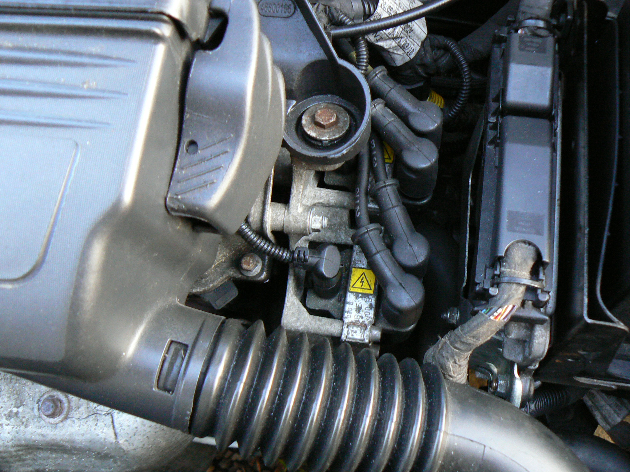

Do you need to take out the battery for access on the 1.2?
Recommended habit to disconnect the battery when working in the engine bay or on the electrical harness. A falling spanner could make a very bad short and even destroy your car by fire !!
ALWAYS disconnect negative FIRST and reconnect LAST, so when working on the positive pole nothing would happen if you short your tool to the car's body ...
BRs, Bernie
If someone here helped You fix -or better, understand- your issue, hit the thanks icon @ bottom right corner, it's free and makes us feel helpy ;-)

Mr Haynes says to remove the battery and battery tray - presumably including the ECU - to gain access, and when you look at it that could be best? You are hard pressed to see it as it's hiding under this lot!
Mind you Mr H did tell me to remove those parts to allow the coil pack and bracket to be removed prior to dismantling the cam cover - so you can lock the cam - when I did the timing belt. I found you could, fairly easily, strip the coil pack and it's bracket without disturbing the battery or ECU (I'm a great believer in, whenever possible letting "sleeping dogs" - or any other troublesome animals - lie.) Anyway, service due around Easter time so not long to wait.

Ive never removed the tray from my panda.. so will be just the battery out for access.
