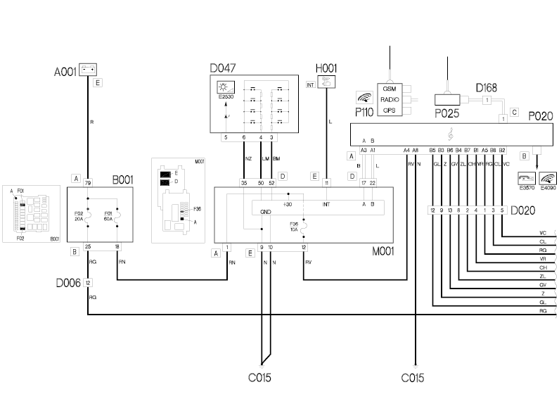

That's the little unit I found, it is absolutely tiny!
That seems to indicate that it's line level feeds then..., I don't suppose your documentation includes a wiring diagram.....?
Of course I have it :D Hope it helps!
