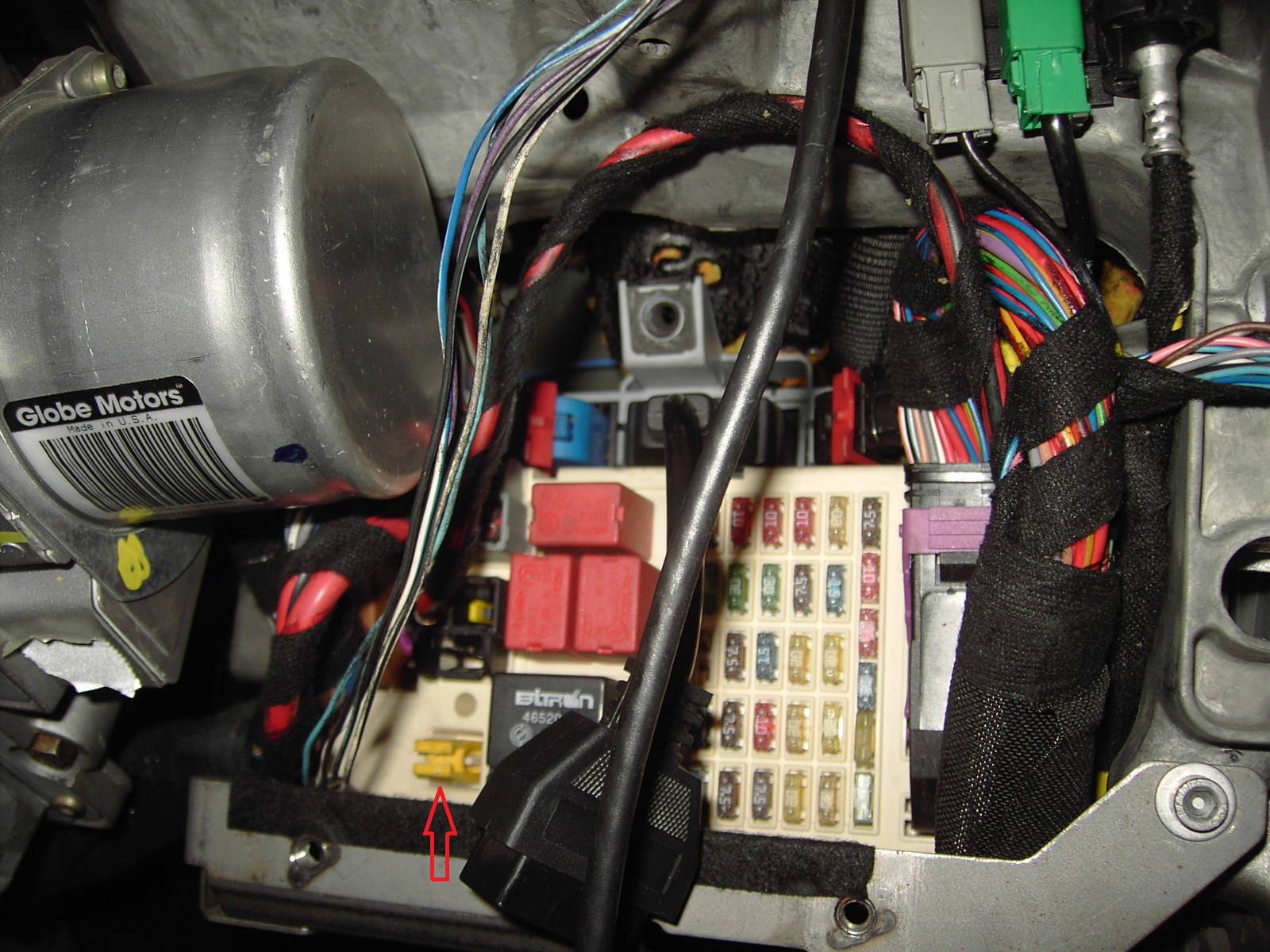

There should be a yellow or white plastic tool to assist removing the small blade fuses. It's located at the bottom of the dashboard fuse box.
