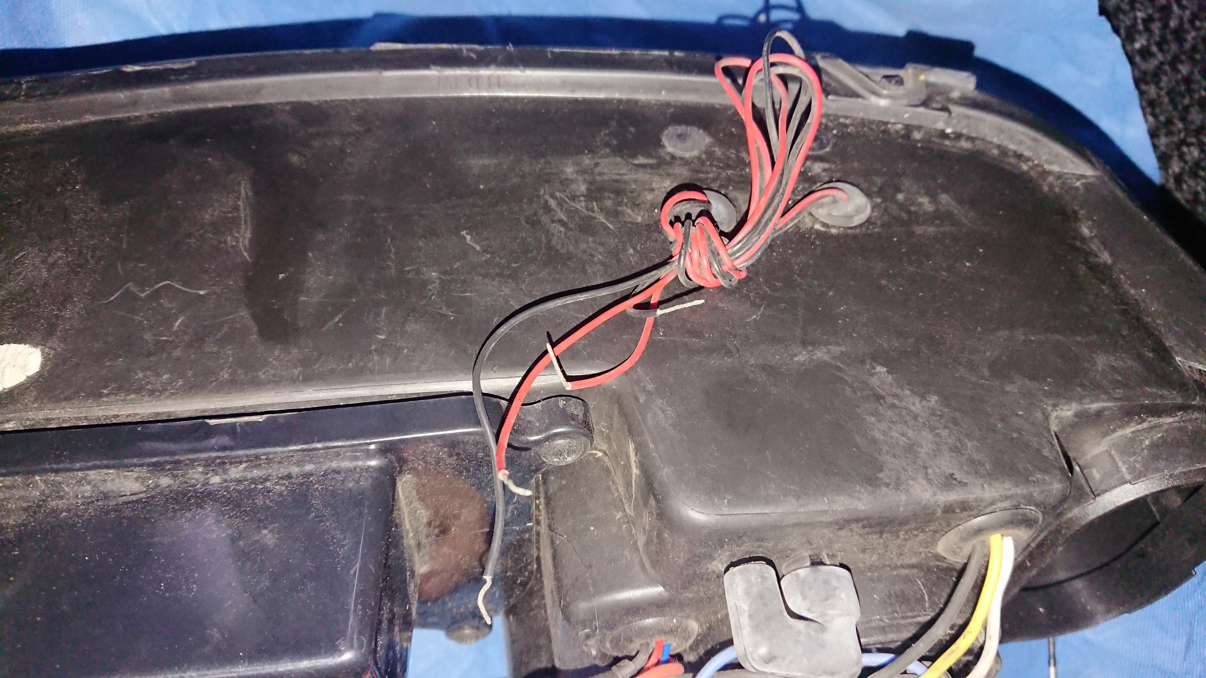

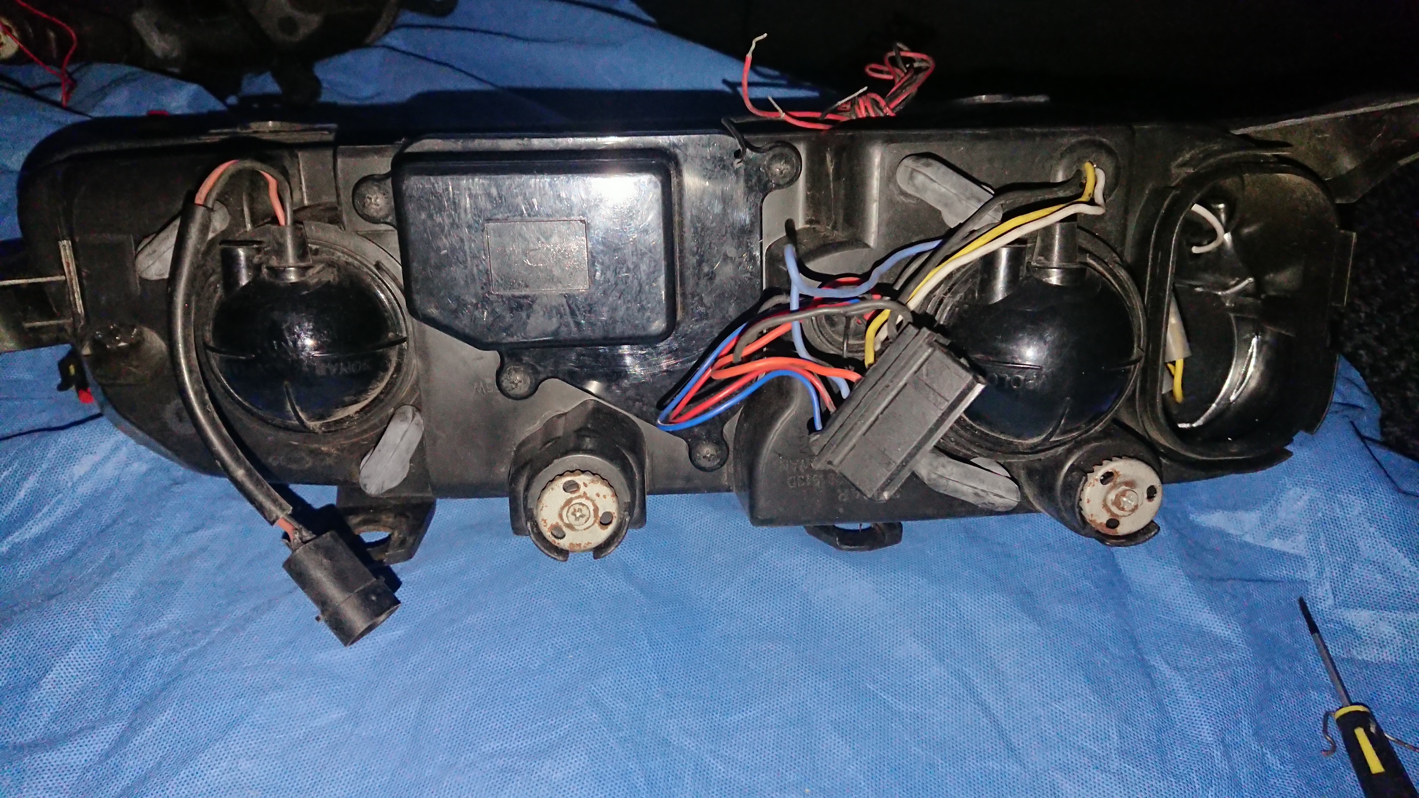

So I've recently got my hands on some second hand angel headlights.
Most of them are plug and play but these have wires hanging off.
I've asked the person I bought these from but they didn't reply.

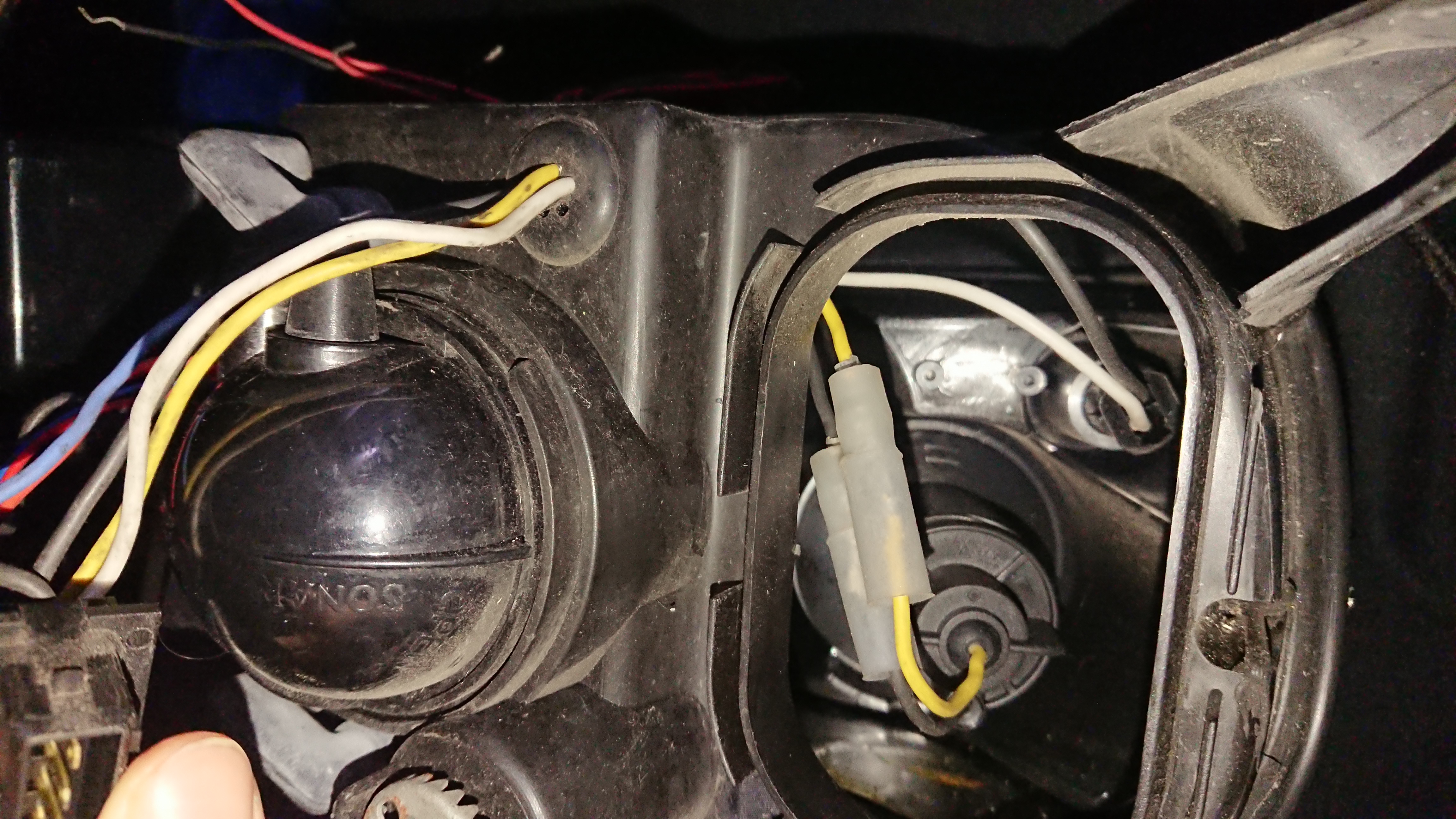

The only thing I know is that the wires ( 2 black 2red) are from halos and they have to be connected to sidelights. The thing is I've never done it before and have no clue which wires to connect and which way. I've bought the clips to connect the wires.

The side light is the small light in the third picture with the black and white wire coming from it, the halo will need to tap into that. I'm assuming the black wire is the negative so connect that to the black wire on the halo and connect the white wire to the red of the halo. As the halo is LED it will only will work one way round, if it doesn't work that way round, try it the other way. You can test the halo with a 9 volt battery if you want.
