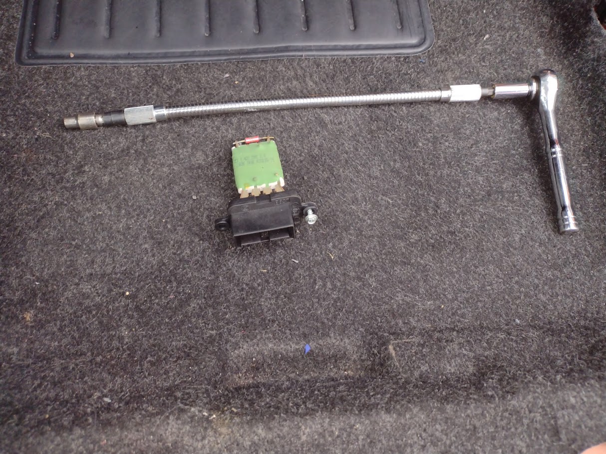

Old thread but maybe help someone with a RHD Panda and no 1-3 fan.
I've had the driver's seat out and lay on my back. Moved the air recirc flap to look at the speed control resistors.
Thanks - found this really helpful while I had the front seats out to dry under the carpet. I'd never have found the resistor pack by just referring to Haynes.
Here it is looking up under the dash (the green thing).
Is it possible to get better access by dropping the steering column out of the way or even removing the instrument binnacle?

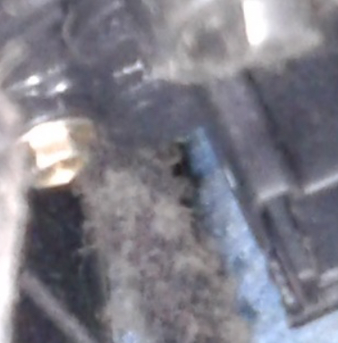

I removed mine without removing steering column. It's one of them Panda jobs that has to be done by feel. I don't see how you'd get a spanner or straight 1/4" drive socket on that bolt with the steering column out :confused: I found a flexible extension in my tool box which coiled up behind the steering column while I used the other hand to go in front of the column and guide the socket onto the bolt.
Someone on a thread mentioned 5.5mm bolt heads (y) Yes it is.
For me the fuse had not blown as it didn’t show as open circuit with a multi meter.
The connections had rusted so needed some dermal to clean up... then on refit with the bendy extension and 5.5mm socket... fan speeds 1-3 it still didn't work. :bang:
I removed the electrical connector again and squeezed the spade connections inside the black plug and bingo... all 4 fan speeds work.(y)(y):):D

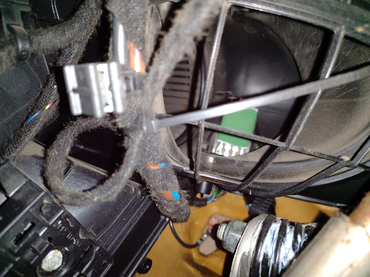

My 04 Active only has speeds 3 & 4 which is a painbut you live with it but, if it can be fixed, even allowing for some contortions of the body would be classed as a win-win! In that top photo there is a sort of "open grill" surrounding the resistor - is it plastic and if so can the cross-pieces be cut away?? Would that allow any easier access??
I'm not about to squeeze under my dash to re-acquaint myself with mine, but I'm sure the resistor sits inside the heater box. I think the photo might have part of the heater box removed to show the resistor in situ, and teh mesh supports the removed cover. Not a good idea to discard any part of a car, as there will be a reason for its existence.
Vehicle manufacturers work hard to control costs, so no part is created or fitted unless it is necessary, either for function, or aesthetics. Fiat are expecially good at not fitting anything unnecessary. As that mesh is not pretty, it must have a necessary function, even if that is not obvious to us. My advice is to work around it, or through it, but not without it.

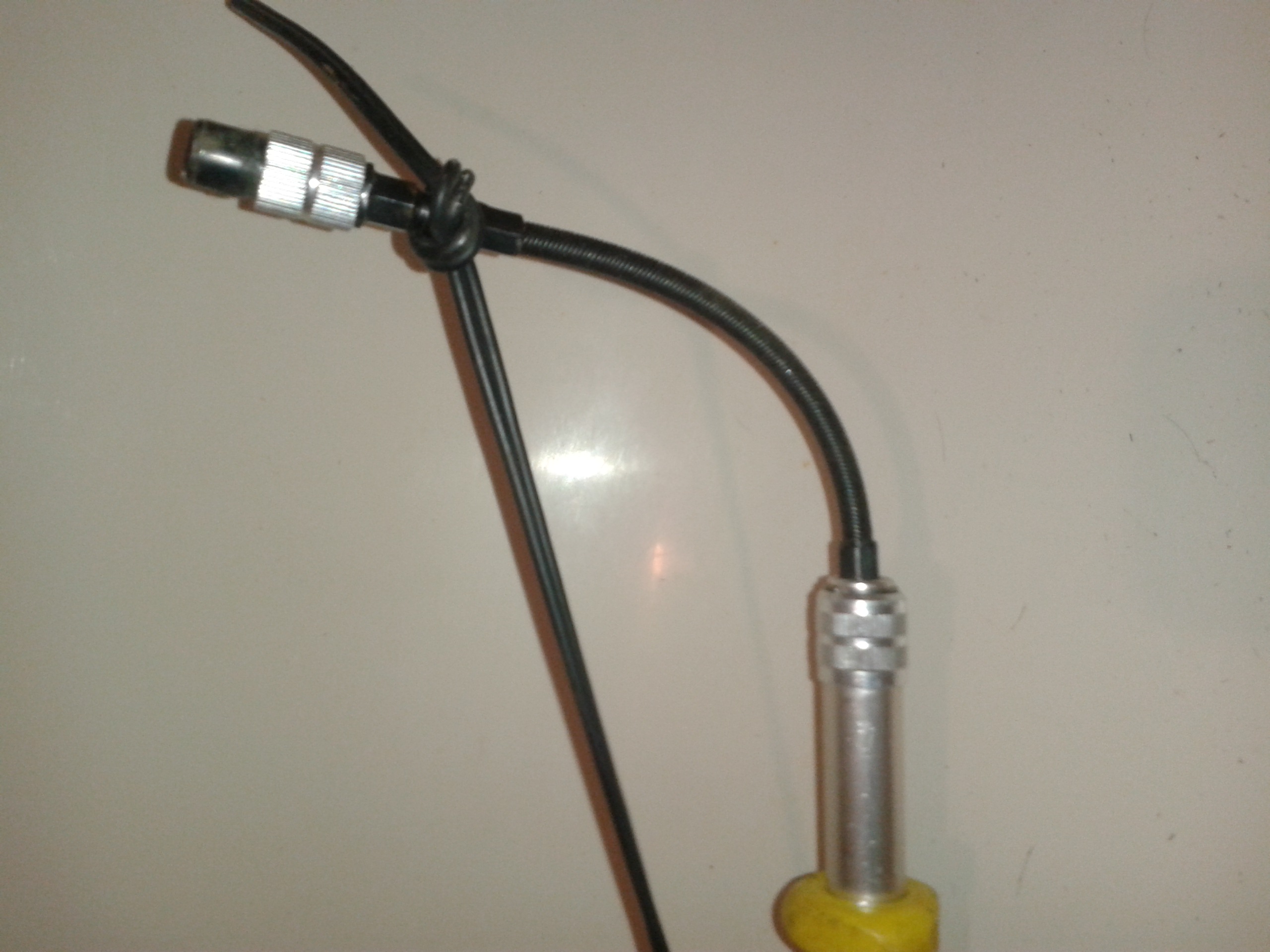

With the right tools
Torch, long screwdriver, flexi drive and 5.5 mm socket it a fairly easy job
There’s no point in cutting anything
I did mine just to see how it could be done without removing the steering column (RHD 05) if you got the tools ready before getting to the car it’s really is only a couple of minutes
@Louie Bee used a similar method without too much problems
In my case you had to push electrical wires out of the way with a long screwdriver to see the bolt. In my experience if you can see a bolt you can undo it
I think it’s a trick of the angles of the photo it’s very hard to get a meaningful photo with a phone
