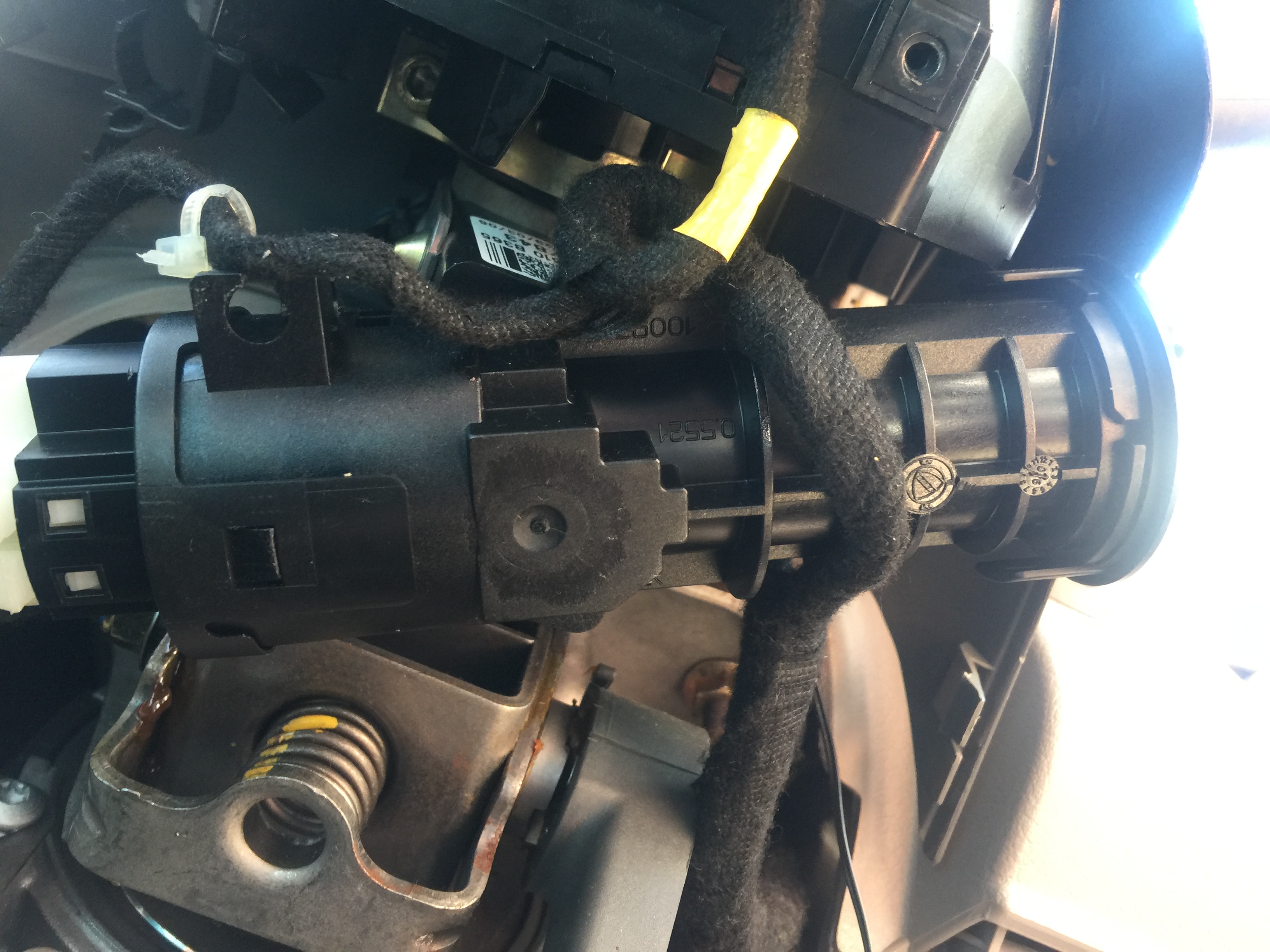

It will likely look like this, if your lucky you may get the bolts out but I did it still on,
the white bits on the left end are the wiring connectors the black they plug into
is the switch above the spring with the yellow paint you cab see a small oblong
there's one each side you press these in to release the switch bit, if I did it again
as the switch comes out I would try to slide a small screwdriver through the slots
and hold the two discs behind the switch in place then hopefully slide the new switch
in so keeping the discs in place.
This is were mine came from yours is likely to have 7 connectors the seller seem to know
what he's about so worth asking if not sure.
Ahh awesome, thanks! I’ll keep this to hand when I start yanking it apart tomorrow. This looks the sort of fiddly job that goes hand in hand with copious amounts of swearing and scuffed knuckles.
Yep when I did it the language would have made any female within 50 ft pregnant.
ended up sticking the discs back in with some electrical grease.
Just remembered the switch can be turned all the way round so make sure
you set it the same as the one that comes out or the drive slots wont line up
with the key bit.

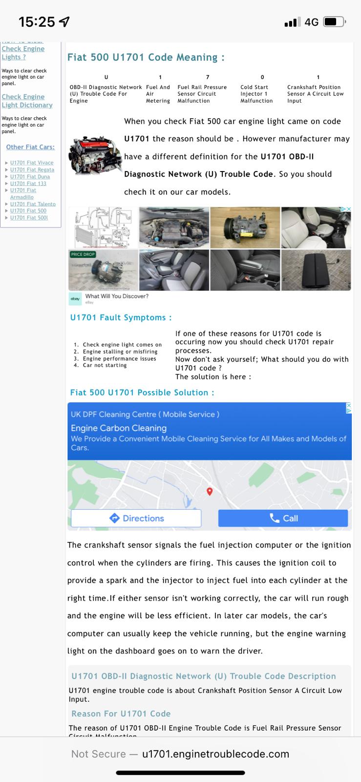

Just an update, got some diagnostics done and the only code it’s bringing up is U170187 which the guy said is an issue with the crank shaft sensor so keys are all fine and he said all the other tests came back absolutely fine so kind of a good thing but needa get it to an auto spark to fix and get me sorted

If it is the crank sensor any mechanic should be able to replace it,
they are not meg expensive and all they often need is the tip wiping.
