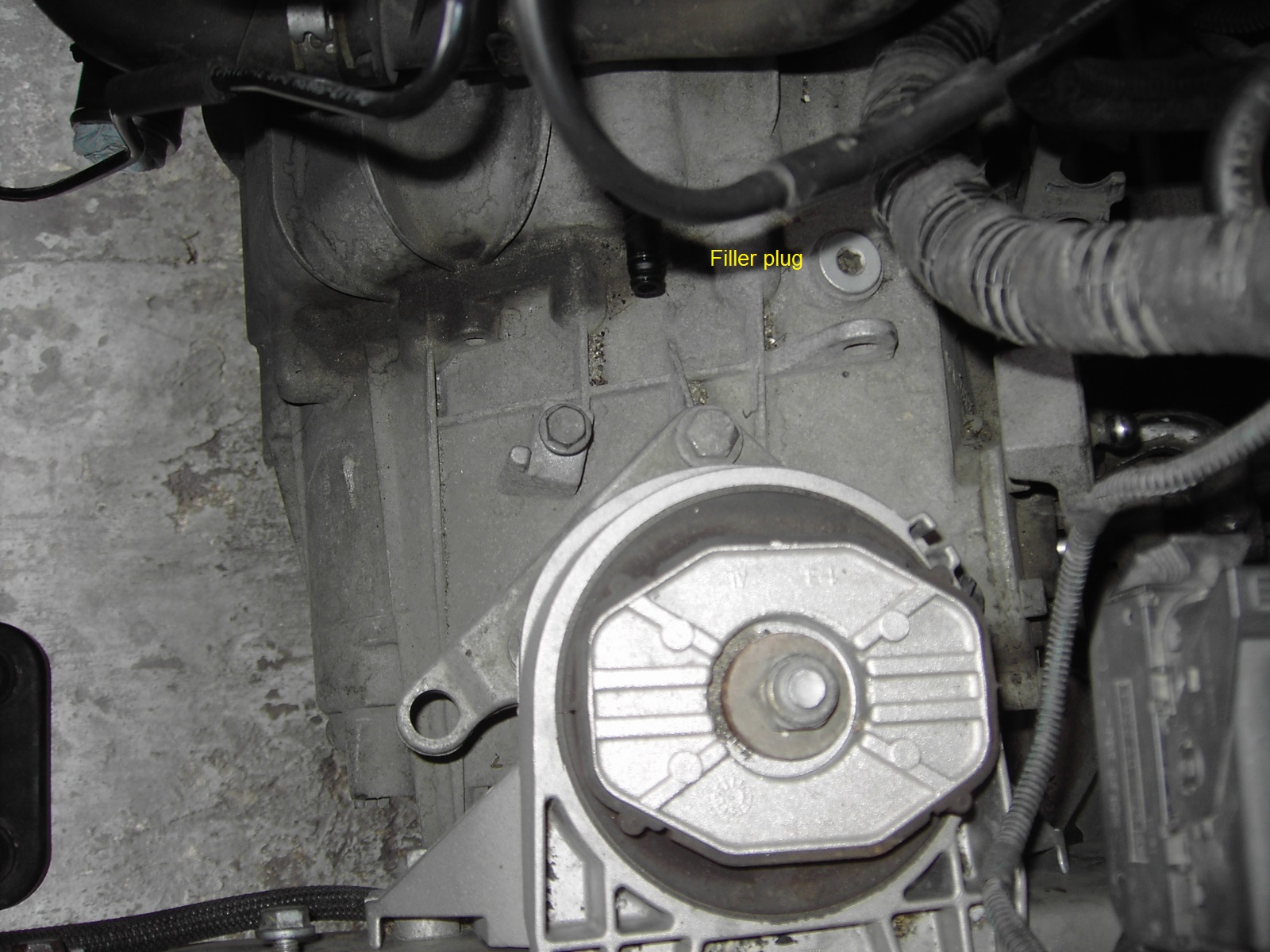

Pictures below show the locations of the drain, level and filler plugs for the JTD gearbox.
