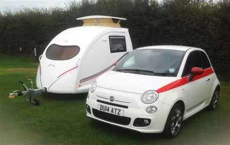

I'm thinking of towing this with my twinair, anybody have experience towing with a twinair? or other comments they'd like to throw in?
My panda towed our 1250kg caaravan when it was threatened with being washed away below a faulty damn. It totally mullered the job. It was easy and stable on the mptorway. I would recomend a stabilisertoo. If you are new to towing, tow it a few times without a stabiliser and get use to how it behaves and feels without first. Stabilisers do a good job but must not be over workedgoinhg too quickly.
The engine is great for towing in fact superb, but consider additional cooling. I would suggest waterless coolant would be a good call and see if you could install a secondary cooling fan if possible I would be happy towing that little beastie with my Panda TA with no worries at all. If you are buying now ask for a test tow. If its OK in this hot weather it will be fine anytime. Allow the engine to idle for 5 to 10 mins when you arrive for the turbo to cool so it does not cook the oil.

Just thought. when I towed my carvan behind my Twinair TA for around 35 miles. Some was motorway and some A road and and back lanes. Temperature was fine on a normal summers day nothing abnormal detected at all. There were notable hills on the route. I maintained 50mph with ease.
The tow is now on order, but once fitted I can at least use it for towing my trailer.
A Go-Pod is about (give or take) 90% of the cars weight.... I'll check exact figures if I go for it.
Ive looked hard at them. Towing I am certain would be fine. They are quite pricey. Next year I should be clear of building projects. Im thinking rear drop van as these are cheaper. I need to actually look see as I will be 69 and the doors on these may be too restrictive. With a 4x4 Panda some outdoor timeis a must.
Well, as much as I like camping, putting a tent up and down (especially in the wet) no longer appeals to me, and as I love the 500 I'm not likely to get a bigger car to tow a wopping great caravan. Also leaving the caravan at a site while touring locally does appeal to me. (& I'll be 68 this year).
