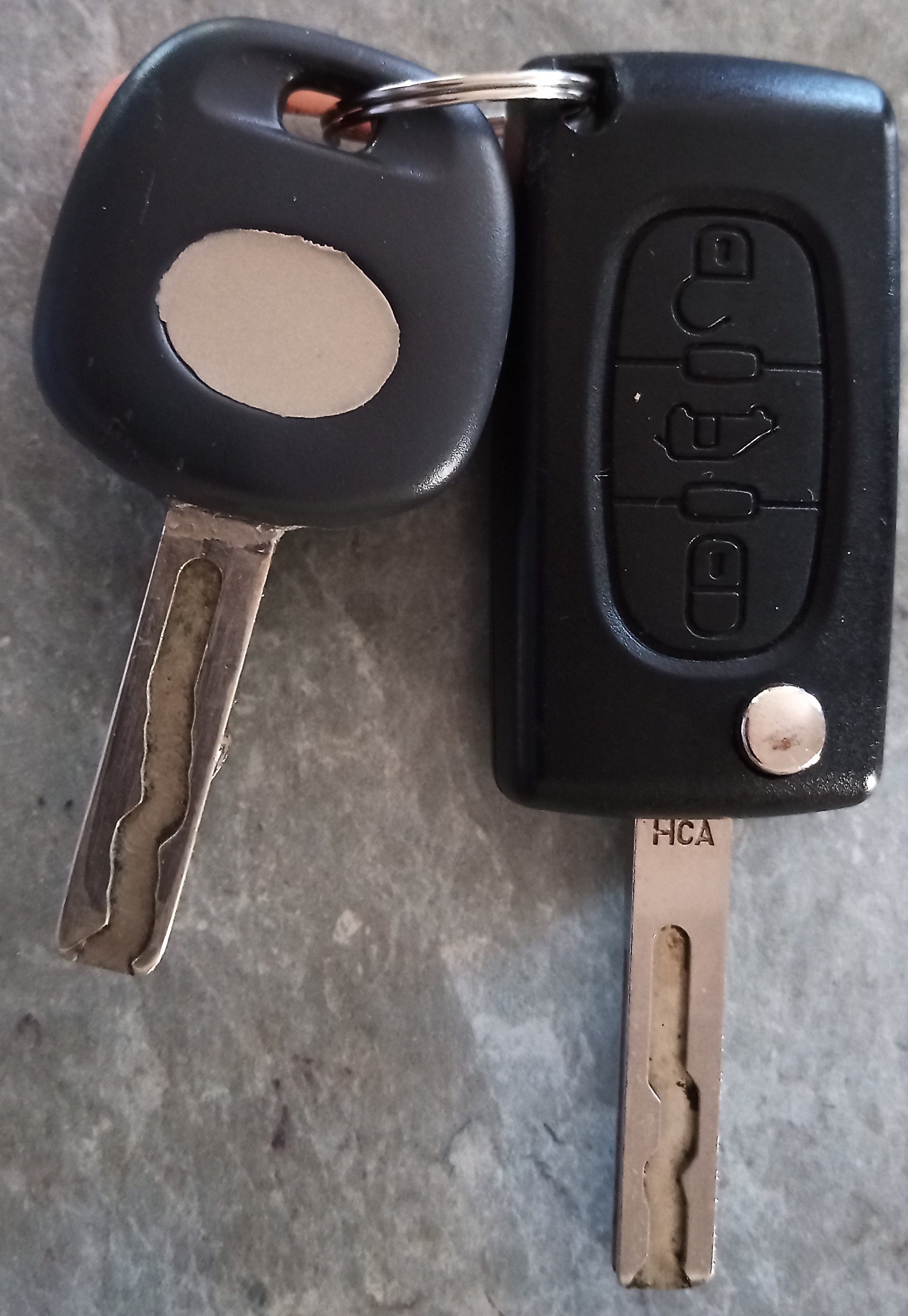

Follow up on this matter. I ended up buying a replacement lock and key from wreckers in Lithuania for about $60.00 as all local wreckers had prices over $150.00 All I needed to do was replace the new blade into the key fob with the immobilizer chip, keep the old blade and fix it to another obsolete base to use for the fuel cap and the door locks and all is well.
