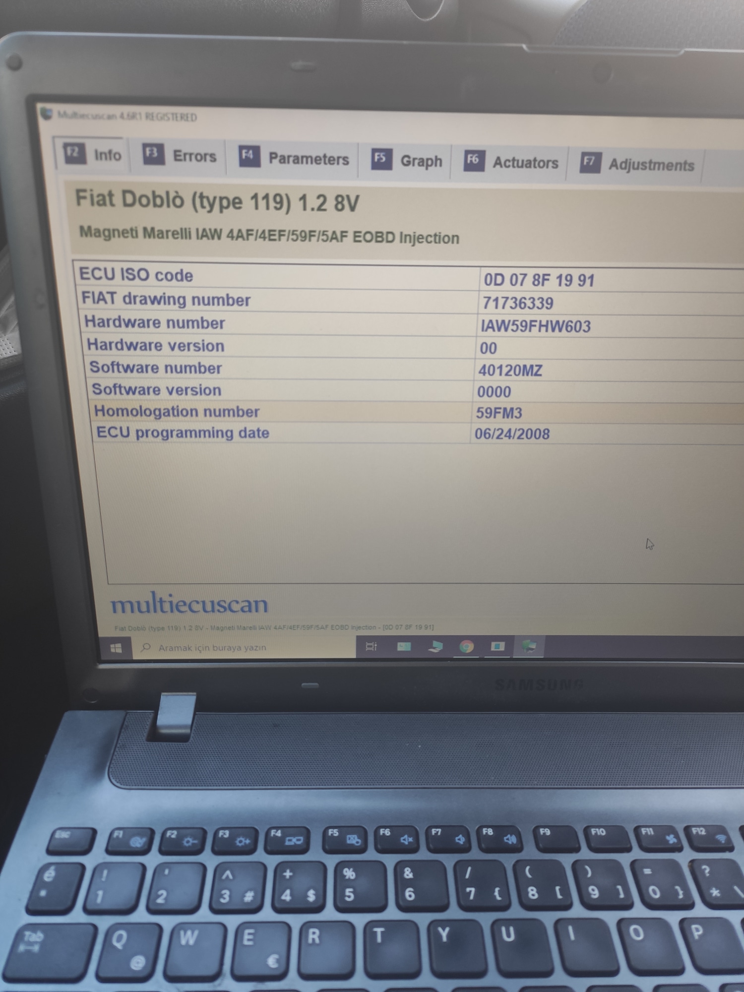

Hi, i know this is irrelevant and not helpful to you but i have a question if you can answer me. I have a 59F.M3 that i want to mess with fuel maps, ignition timing, MAP sensor readings etc. What hardware and software do i need to use? Multiecuscan says its HW603. I have absolutely no idea how to tune these ecu's and i'd like to know much more about them. I'd ask woj but his last online date says May 2022.
