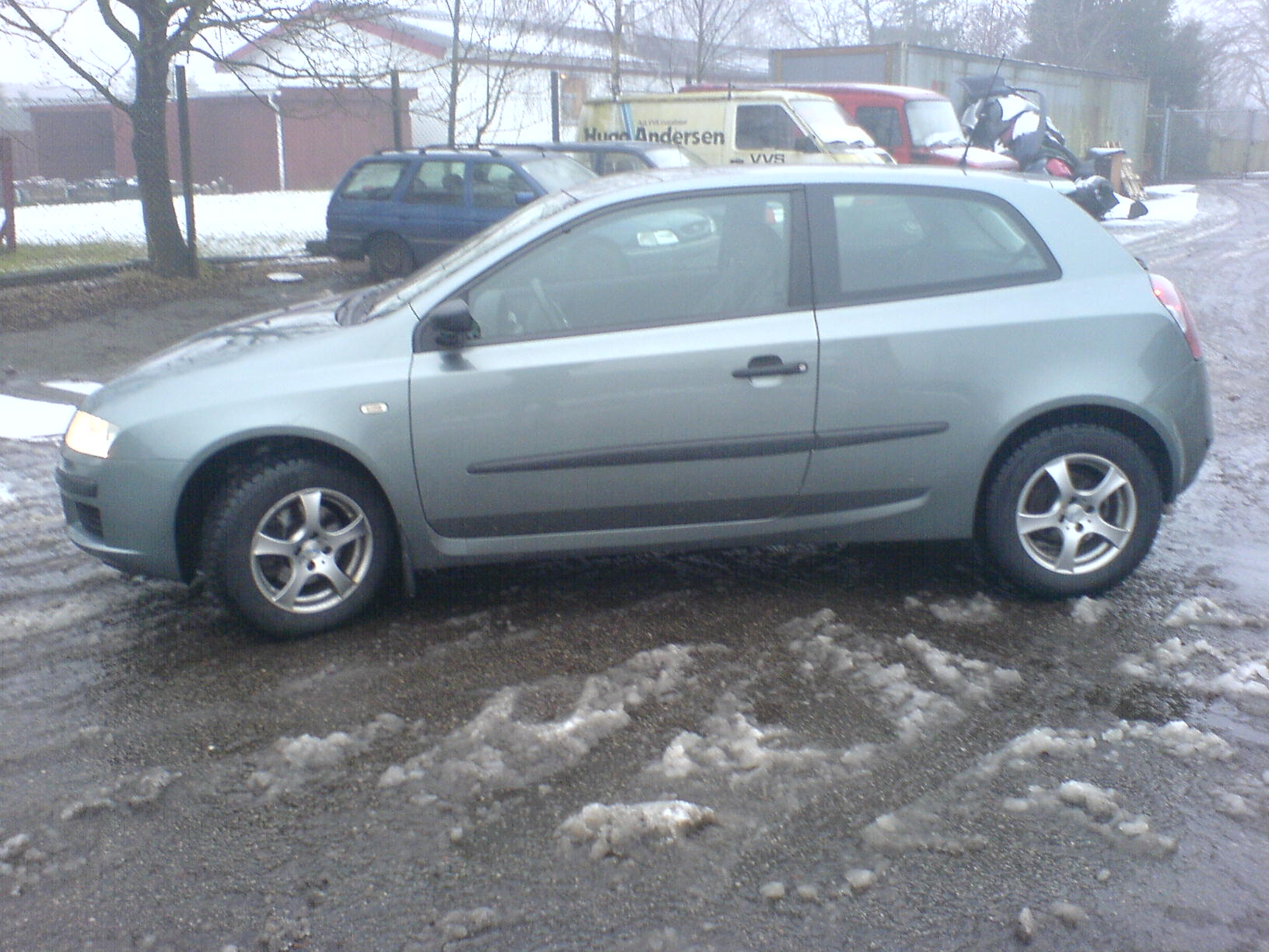

now i have bought connect hope i will recive it soon
