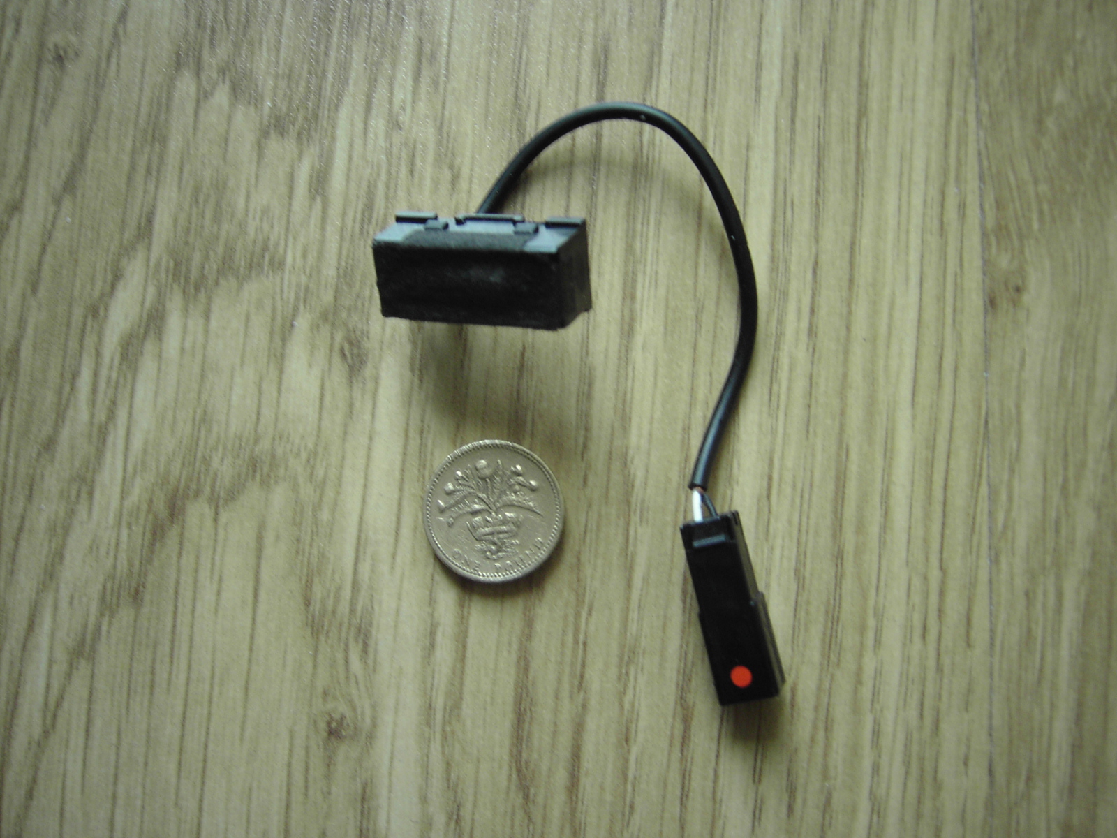

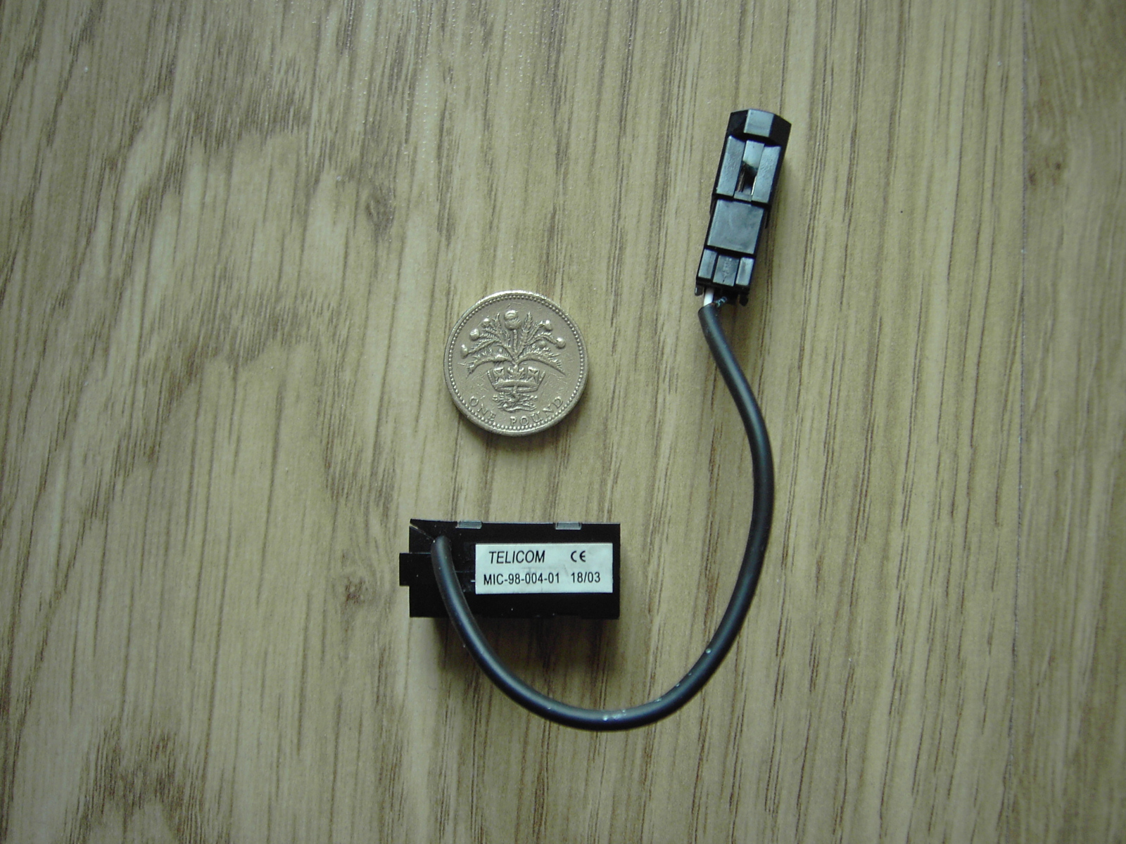

hi i have same prob fitted a cn+ got original antenna with gps and gsm in the base all works i cant find a mic to work i have tried many but none of them work it must need a preamp. ePER keeps saying an error has occured do you know were i can buy a mic ?
thanks
The microphone from Fiat is only supplied with part of the interior light. The interior light is different depending on whether you have the alarm and/or sunroof. Basic one without alarm and sunroof is part number 735303207 at about £100. With alarm and sunroof it's about £700.

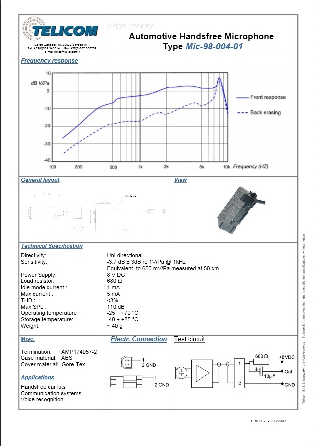

The original CN+ fitting guide in the guides section says that the actual microphone in the interior light is the same as the one fitted to a Lancia Ypsilon. The part number for that one has changed from the number shown in the guide to 735492864 at about £60.
Picture of the actual microphone only, and the manufacturer's spec sheet for it is below. You could search for that part number of approach the manufacturer direct.
