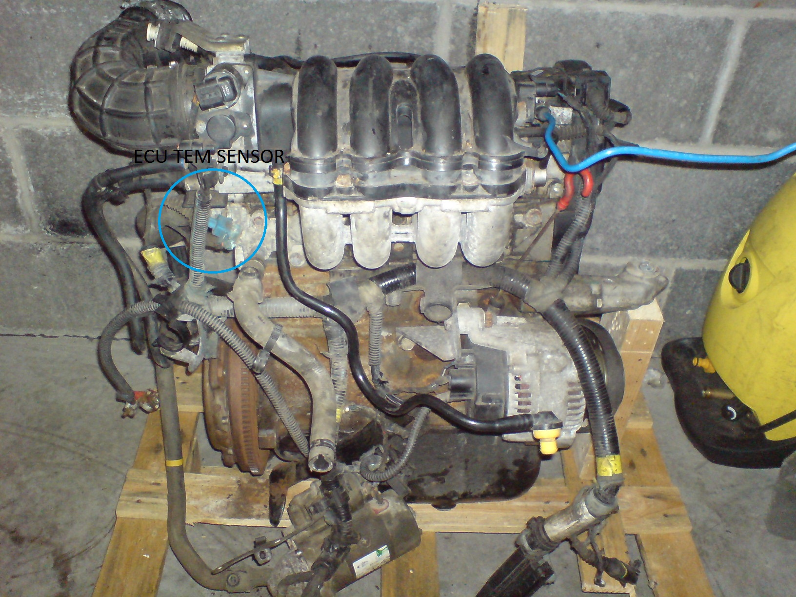

I'm not sure how you lost this connection. When I was swapping Punto engine I kept all wires which go around engine. Then I only had to feed ECU wires properly, get proper earth and "link" it with dashboard clocks. If there no cable cut etc...you should find this connection very easy.
PS
Please check pictures...it might help. As previous person said...you need blue sensor to be connected.
Other thing...if there is no connection to this sensor ECU should rather use max temp reading that "cold" engine reading....but I might be wrong.
It is also probably possibility to avoid this temporary by putting resistor instead of sensor (if you find right wires) it should be about 270 ohm (90degree) and 3.2kohm 0 degree.
PS

Hold on a sec, there are two temp sensors on the mk1 16v engine set up.
The one on the end of the block is 12v and is for the temp gauge only, its the one I mentioned piggybacking the wire to the panda temp sensor wire.
The second temp sensor is 5v and used by the ecu. It's the blue one fitted to the inlet manifold by the heater pipe outlet.
Thanks for all your responses. The photo helped.
I have been scratching my head but it looks as though I had set the loom correctly. I had plugged the 5V temp sensor in (didn't even realise it was a temp sensor. Just fitted all of the connectors). Maybe the sensor is faulty? I'll have another play tomorrow with the multi meter.
