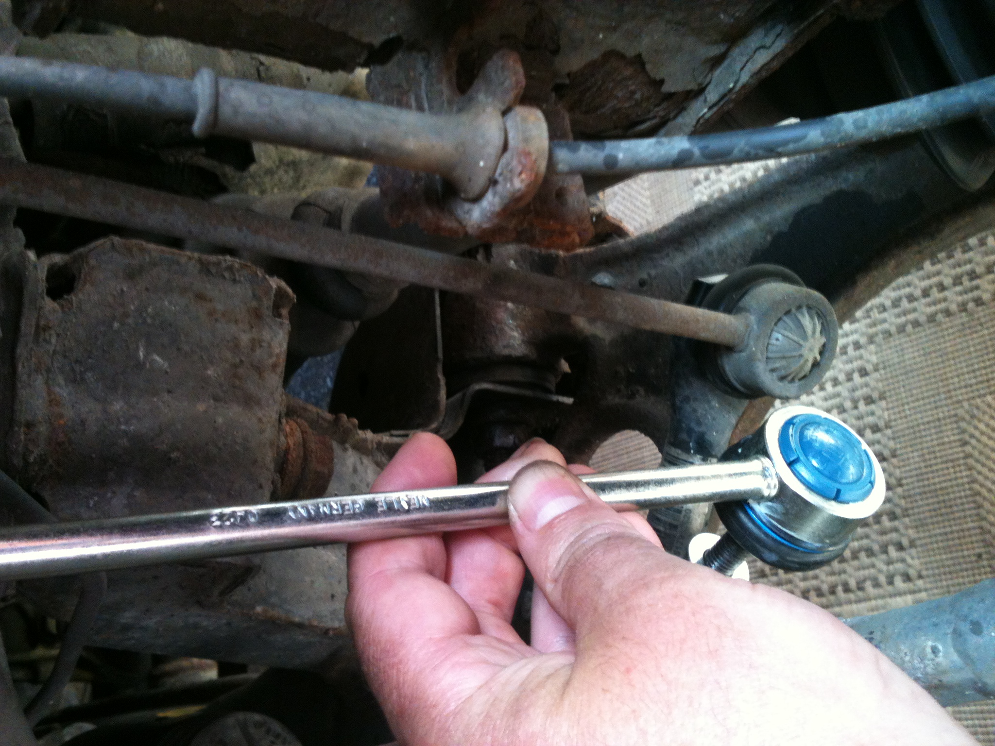

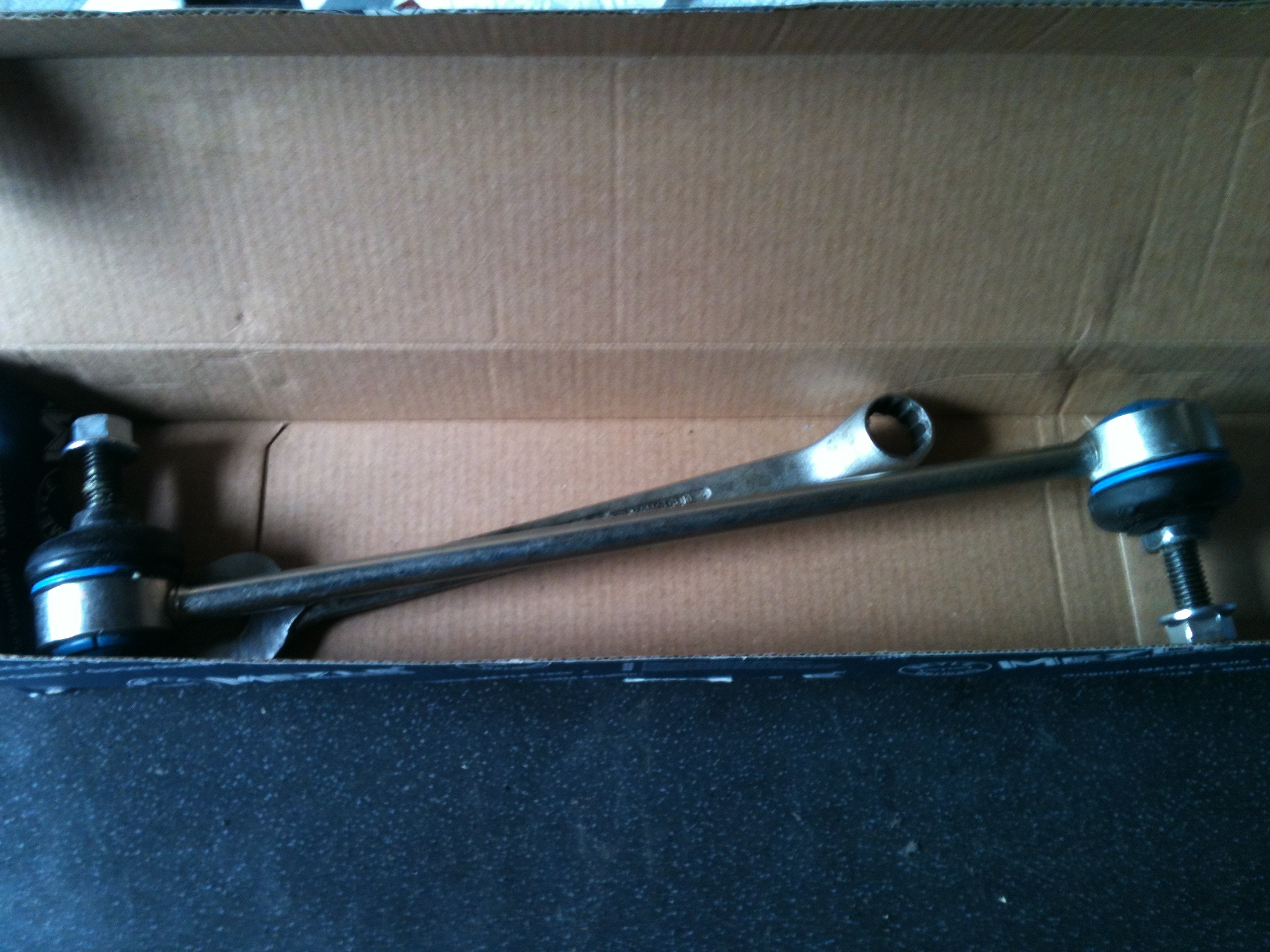

Anyway, here are the drop links and they’re just held in at each end by a self locking nut. The only problem is stopping the screw from turning whilst you remove the nut that’s been there for a few years. New nuts don't come with the links and it's worth putting on new ones. Not cheap though at £1.50 each

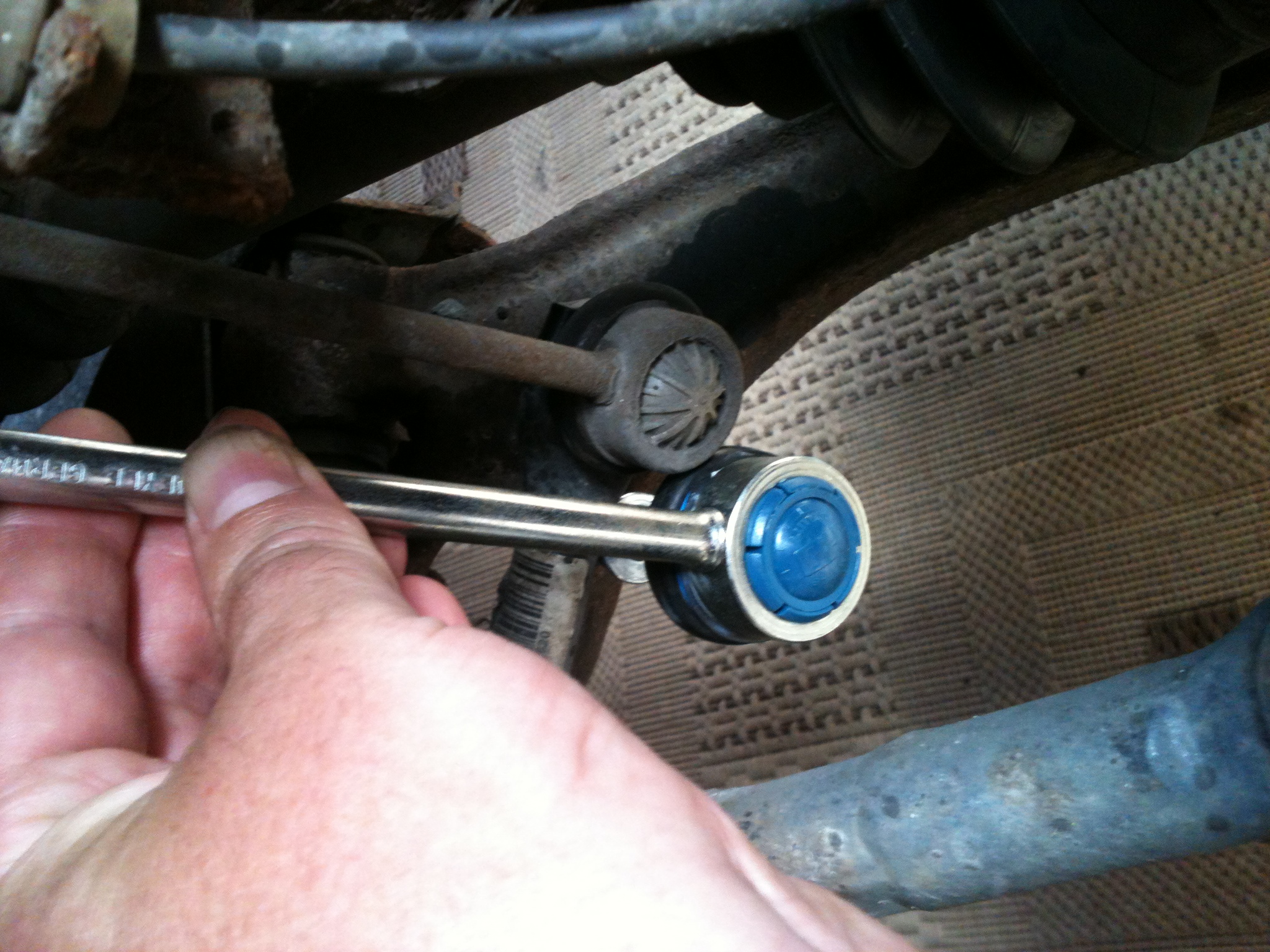

Now access to the bottom link is much more restricted and you can try to hold the allen key slot or you can just go straight for Plan B. The problem is you need to be able to get hold of and stop the screw from turning.
Bend the link arm back from the top out of the way, it’s not very strong at all, you can bend it with your fingers. You can also raise the drop link arm by putting a bar in and levering it up a bit from the bottom triangular widhbone arm. You'd be wise to pull out the sensor cable that's in the area out from its holdings and put it out of harms way

Now you have access to a nice round but useable surface to clamp a mole wrench onto tightly and off you go and remove the nut easily on the other end
If you’re careful you can use the same method of holding one side with a mole wrench whilst you tighten the nut on the new lower drop link but be careful not to damage the gaiter of course
For the top link then you can use the allen key easily on this new one to help restrain whilst you tighten the nut. Clip the brake pad wear sensor cable back in and the job's done
