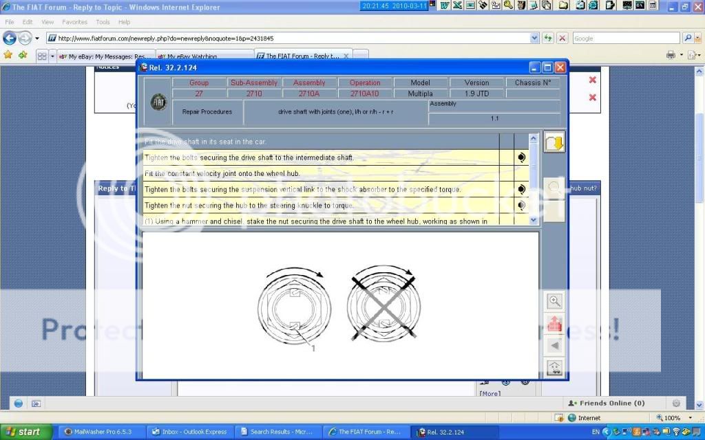

looking at the Fiat CD The Nota in Operation 4450C10 shows a picture of how it should be.
