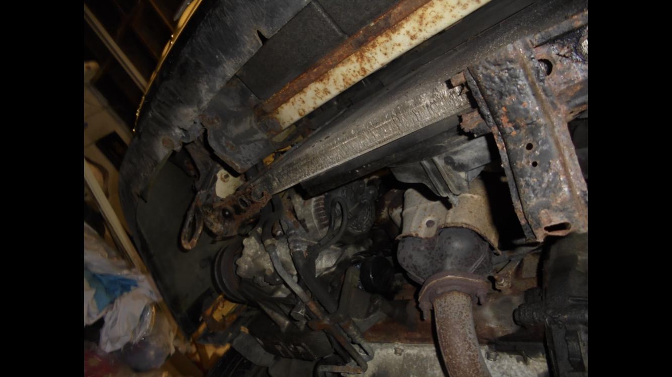

Okay so I might be buying a fiat coupe (please see other post for more info if you wish!)... only problem is the radiator support bridge has rusted off. It’s practically nonexistent. I’ve looked for spares but only came across Fiat Punto ones? Anyone know if these are similar / identical enough to use in a Fiat Coupe? (Image shows the damage!)
Anyone got any idea of how much this should cost (ones I’ve found for the Punto range from £28 up) to buy and then to have installed by a general mechanic or a fiat mechanic?

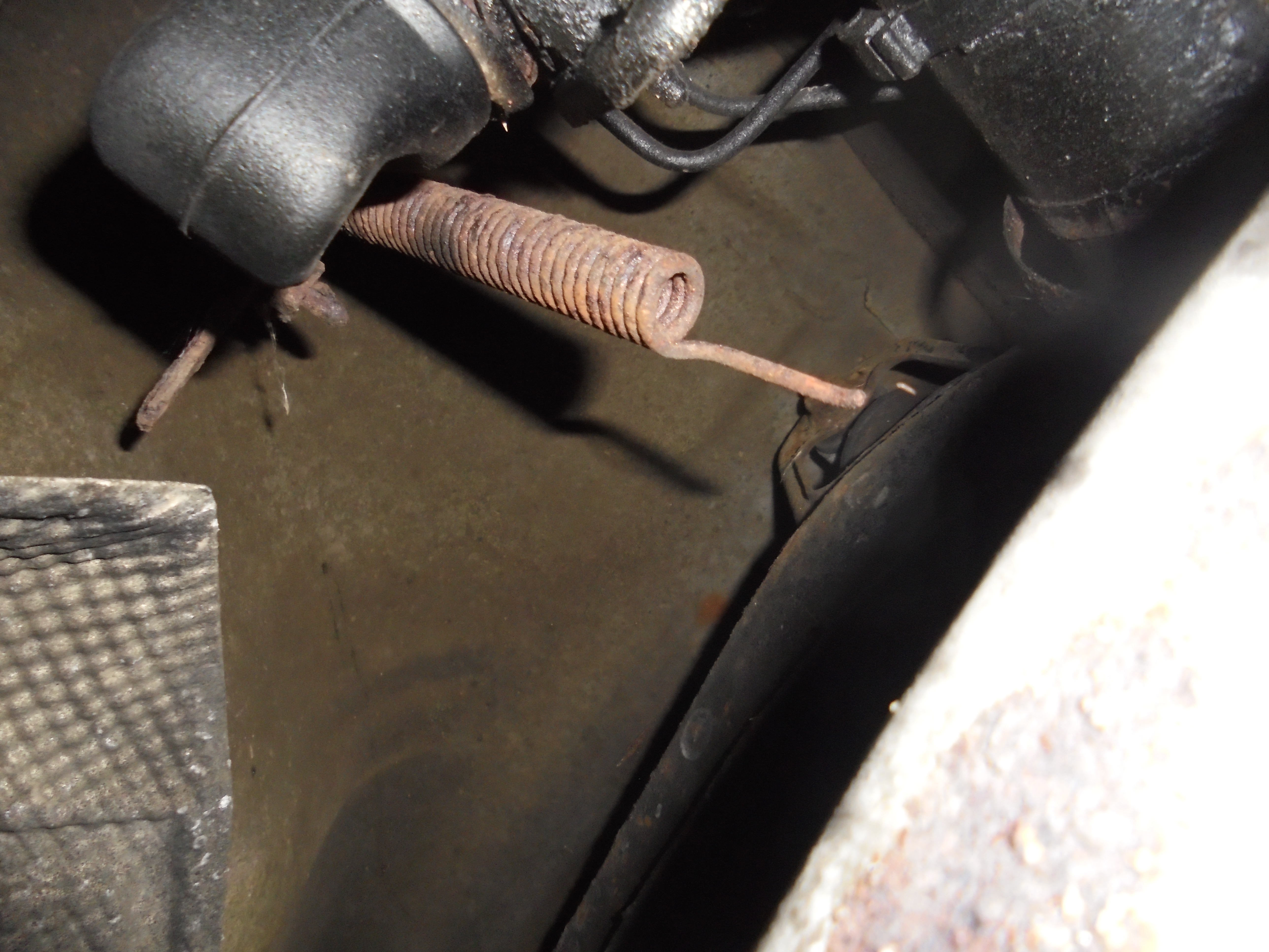

Also needs new springs... (other image) the little ones that stop the rear from locking up during breaking by relieving the hydraulics or something? Any ideas on cost for these? Both parts and expert fitting?

The radiator support looks like you'd have to make your own, or get someone to do that for you. Difficult with so little to copy. Only used on Coupe from 96-2000. Not apparently on earlier cars, or the Tipo.
Part number is 46306520. A quick Google of it looked very negative.
http://62.106.11.160:8000/navi?SGRP...SUBGROUP_7&SB_CODE=-1&WINDOW_ID=1&DRW_NUM=3|0
Find someone local who might be able to make one, show him the pic. Get a rough quote, double it and get at least that amount discounted off the cost of the car.
The brake spring looks easier, as it was used on quite a few different Fiat group models.
Part number 46438681 (If I understand correctly what you require)
http://62.106.11.160:8000/navi?SGRP...UBGROUP_7&SB_CODE=-1&WINDOW_ID=1&DRW_NUM=7|0#

Phew, yep I think you’re right about the spring! Thanks so much for the part numbers, it’s very kind of you! I really appreciate it :)

Luckily I know a sheet metal worker, and he knows someone who might weld some stuff for me. I’d need it made from galvanised steel though, wouldn’t I? They admit that they don’t know anything about cars though, so... I’ll have to wait and see there, I think.
If they can make metal into the right shape, and make it out of stuff the same thickness, it'll be fine. That part won't be special, so no extra strength steel there.
Galvanised is difficult to weld, it'll spit and splatter, so probably just mild steel and paint it well.
If they can make them for a good price, there might be a small market for them. Sell a few, pays for your own?

Okay, so basically I need to:
- Do a scale drawing of the part
- Ensure they’re using metal of the proper thickness
- Have it cut and shaped out of mild steel
- Prime and paint
- See if they’ll make a few ;)
The classic car inspector I contacted believed it to be a main structural part... I’m a bit worried the steel won’t suffice? But I don’t really know what I’d make it out of otherwise!
I know I’m just reiterating at this point, but I’m just trying to clarify my priorities - thanks for your patience!
