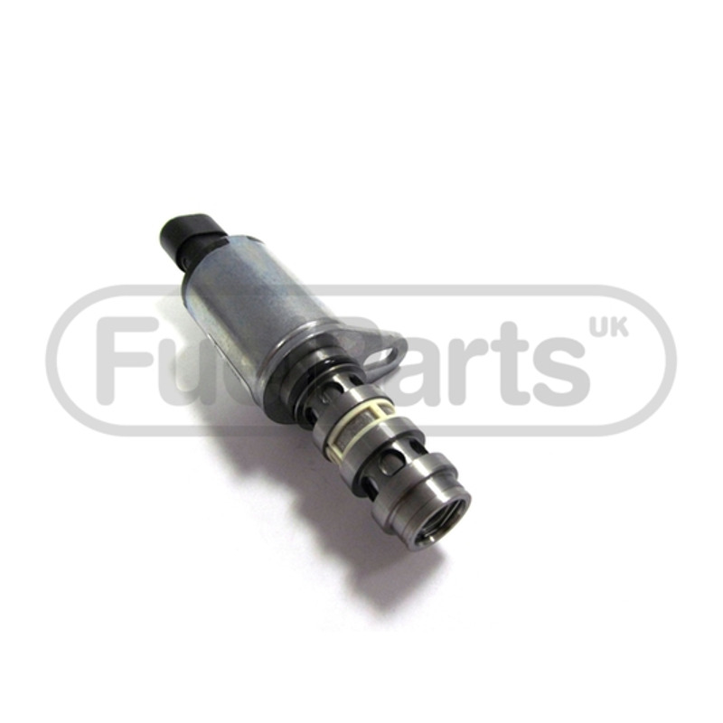

That's a good pic Panda Nut. Interesting the VVT solenoid has 3 filter screens when my 1.2 solenoid has just one like this:
