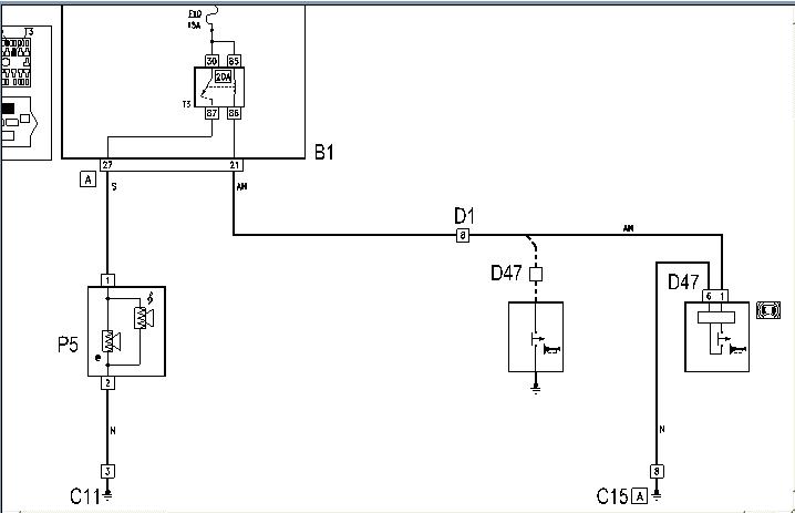

Hi everybody I have a 2005 fiat stilo and seem to have misplaced my manual and my horn isn't working and I don't know what fuse to change or what to do can any one help me with the fuse map
Thankx
You don't say which engine you have as circuits can vary a lot from car to car but i would think this would be standard across the range. Circuit shown is for a 1.6

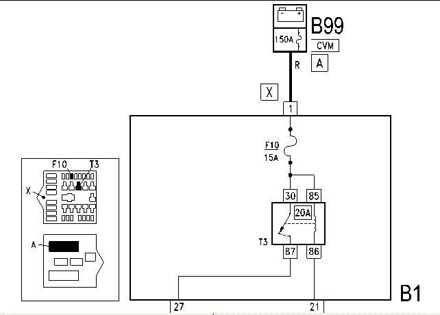

Ok check Fuse 10 15A and check if the relay T3 shown here is clicking when you press the horn switch
Power comes through fuse F10 to the relay T3. Relay is taken to earth by the horn switches D47 and operates the horn P5

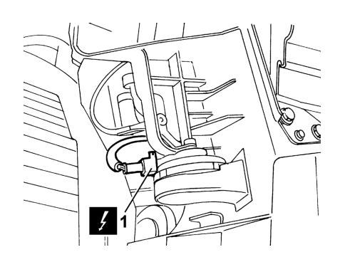

As the horn isn't used very often in this country, it more often just needs striking with a small hammer to dislodge crud in the horn internal contacts. Not so easy to get at though as it's behind the front bumper.

if you remove the drivers side (uk) grill on the three door- the horn is just behind that- 5 door doesnt have removable grills so its well behind the bumper
What and where is the drivers side grill? are we talking the fuse box? or under the bonnet?
