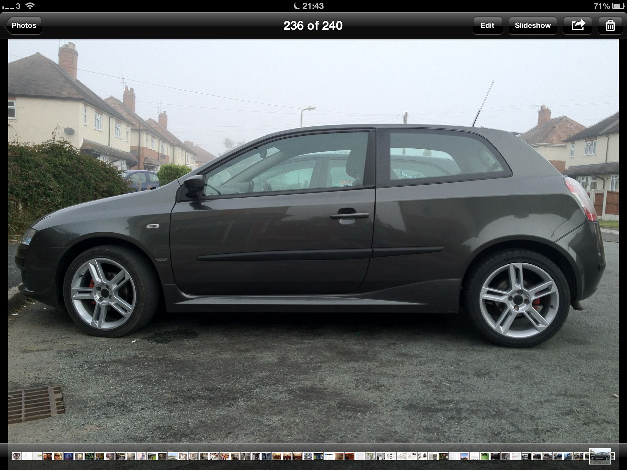

Just joined the fiat family. Recently bought a fiat stilo 1.4 active sports 2007 as a first car. Unfortunately the horn is still not working after replacing the fuse. Any ideas guys?

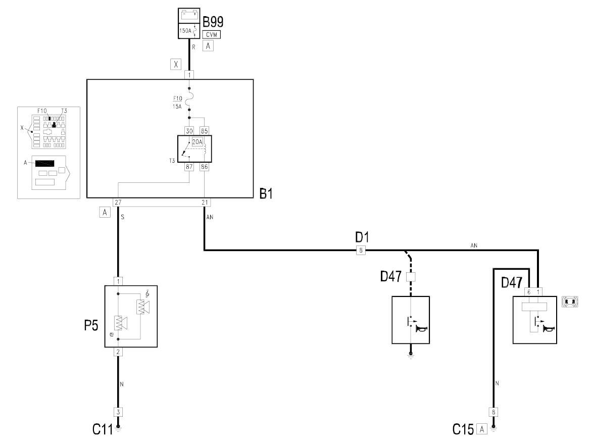

Relay? Or maybe just the horn itself. Have you checked the wiring near the horn trumpet? It's mounted in a position to suffer a bit from road dirt etc.
Like that gunmetal colour - don't see many of those. Oh and you need some new centre caps for your blade alloys...
In my punto, you could hear the relay working(clicking when you press steering wheel horn button) even if the horn doesn't sound. Maybe that could be a check that you could perform? If it works, then it could be your horn most likely. :)

bought a set of snail airhorns off ebay for £6 deleivered, took the bumper off, removed the horn from the driver side front corner, took old off (although it did actually work it was just dodgy wiring) put new one on re-did wiring, bolted it down and hey presto done sold the spare snail horn
