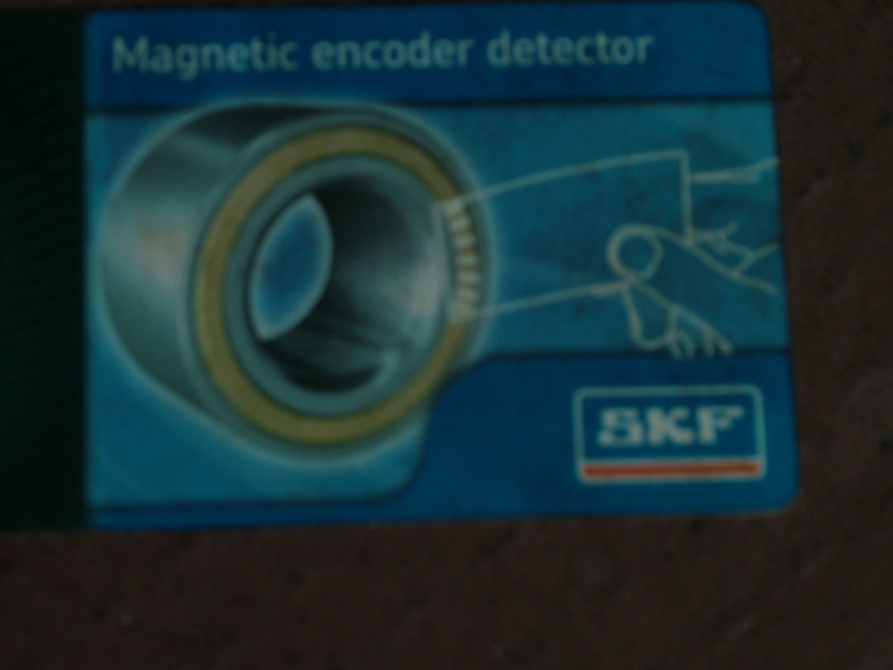

The ring has magnetic vanes so killing residual magnetism would stop the ABS from working.and can be tested using one of these cards.
