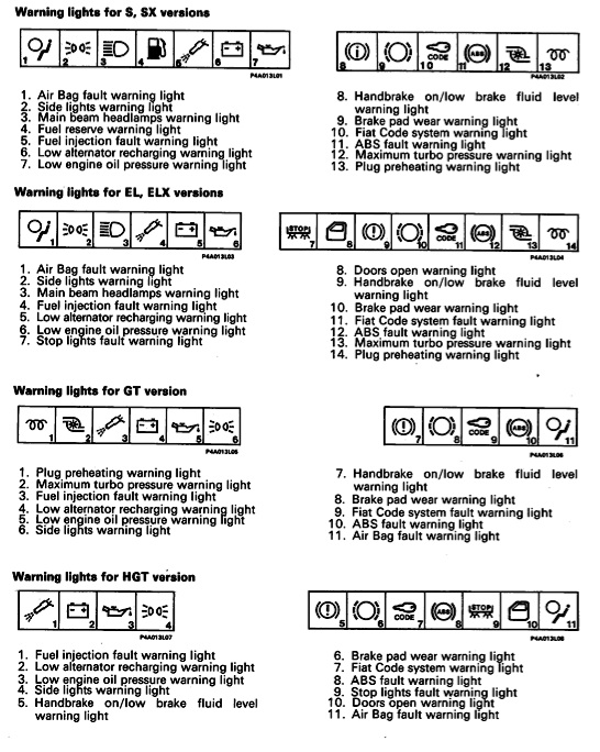

M mountainmachine Bravo 155 HGT Parked in the garage Joined Aug 8, 2006 Messages 3,884 Points 707 Location Ayr, Scotland Aug 20, 2007 #3 Which one of these does it look like? Click to blow up!

M mountainmachine Bravo 155 HGT Parked in the garage Joined Aug 8, 2006 Messages 3,884 Points 707 Location Ayr, Scotland Aug 21, 2007 #5 Have you looked at the image above and identified your warning light showing?
OP OP W wagawags New member Joined Aug 20, 2007 Messages 3 Points 1 Location york Aug 22, 2007 #6 fiatdrivingfan said: You'll have to be more specific, what colour is the light, does it have a symbol on it? Click to expand... the symbol is yellow and looks like an upside down light bulb surrounded by spikes
OP OP W wagawags New member Joined Aug 20, 2007 Messages 3 Points 1 Location york Aug 22, 2007 #7 The Beast said: That sounds dangerous! Click to expand... none of the above thanks it looks like an upside lightbulb.
bulldog5046 faster! FASTER!!! Parked in the garage Written a guide Joined May 8, 2005 Messages 9,053 Points 1,538 Aug 22, 2007 #8 its the blown bulb warning symbol, can be fausly brought on if using LED lights anywhere.
