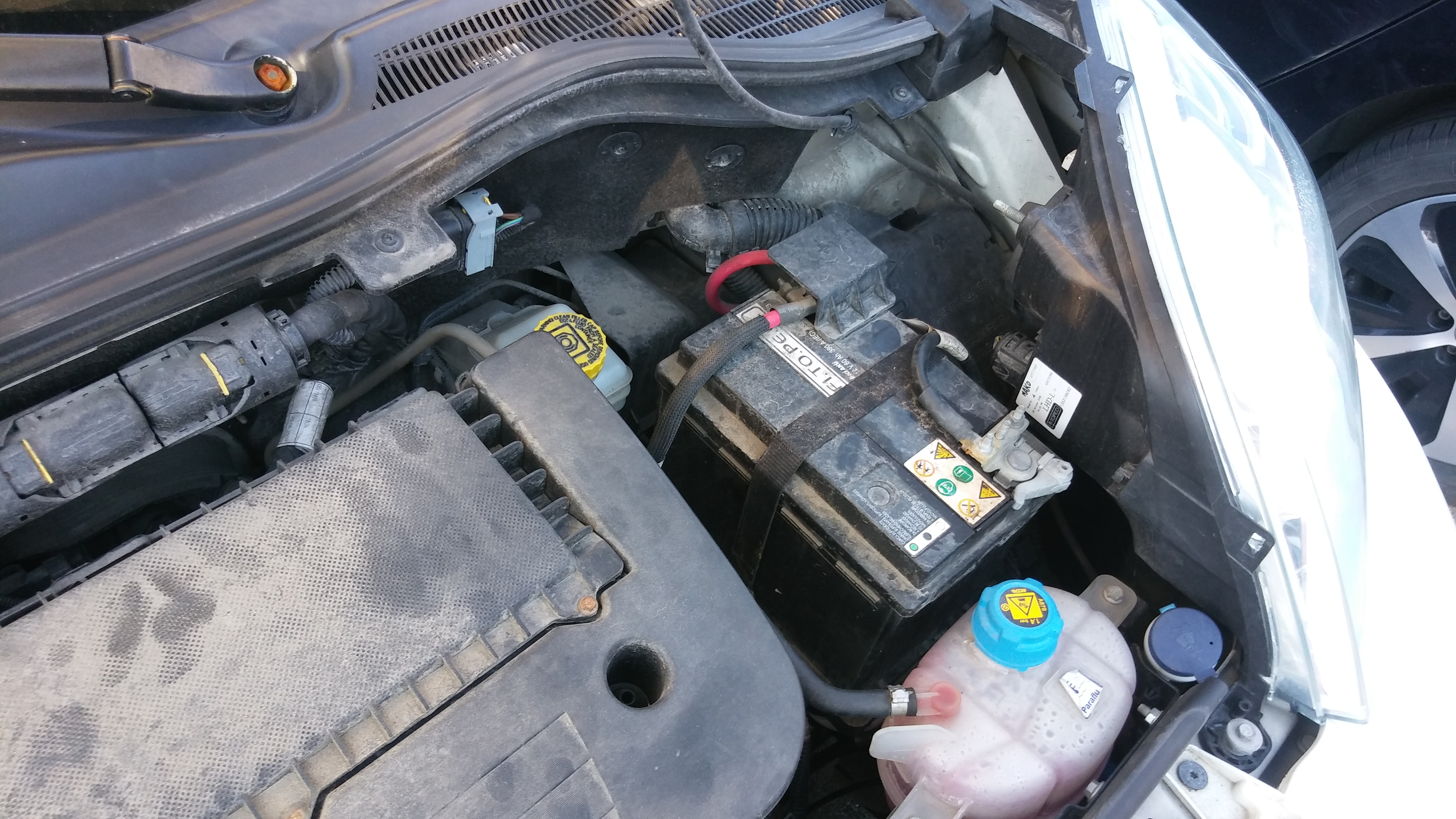

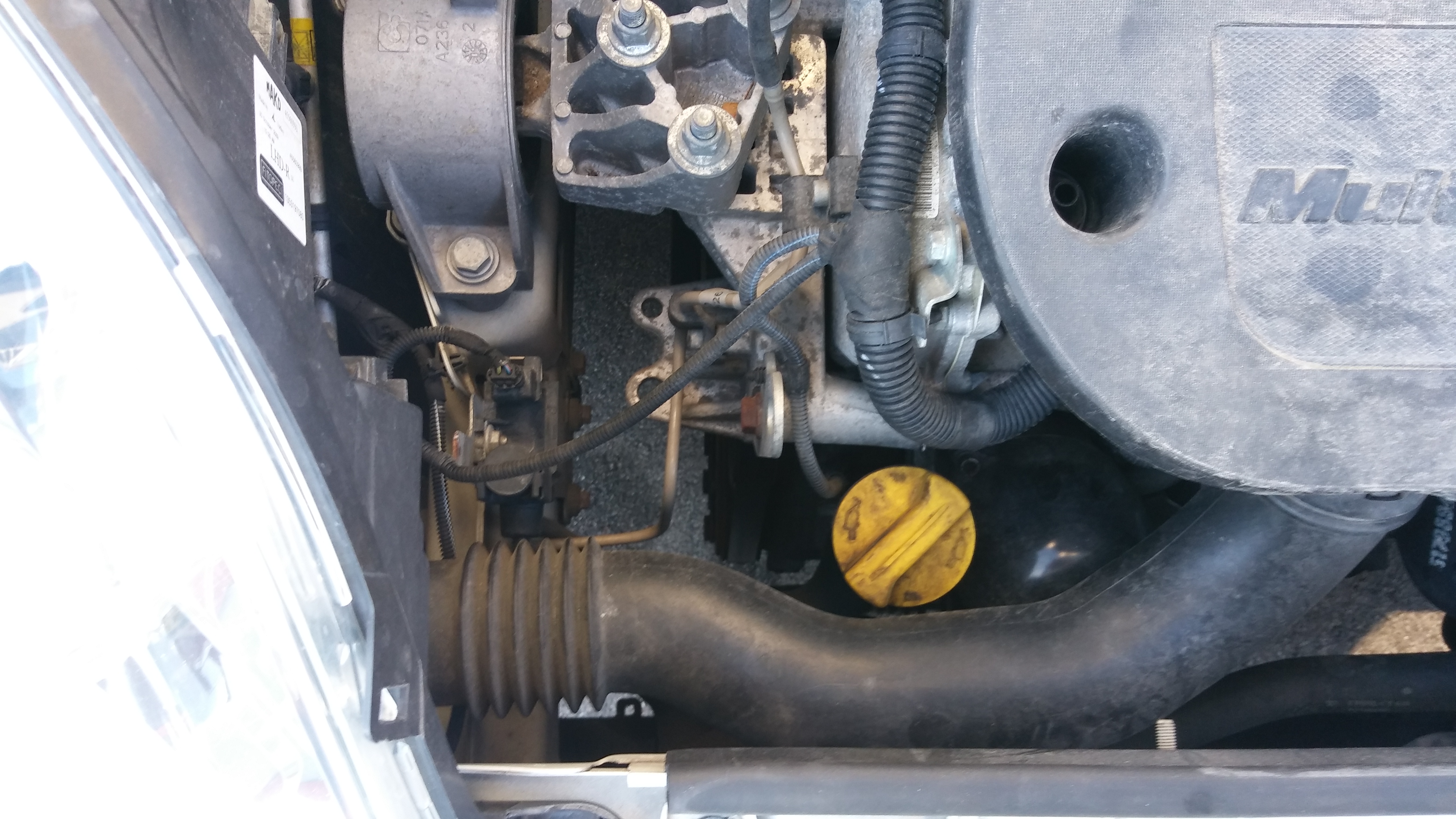

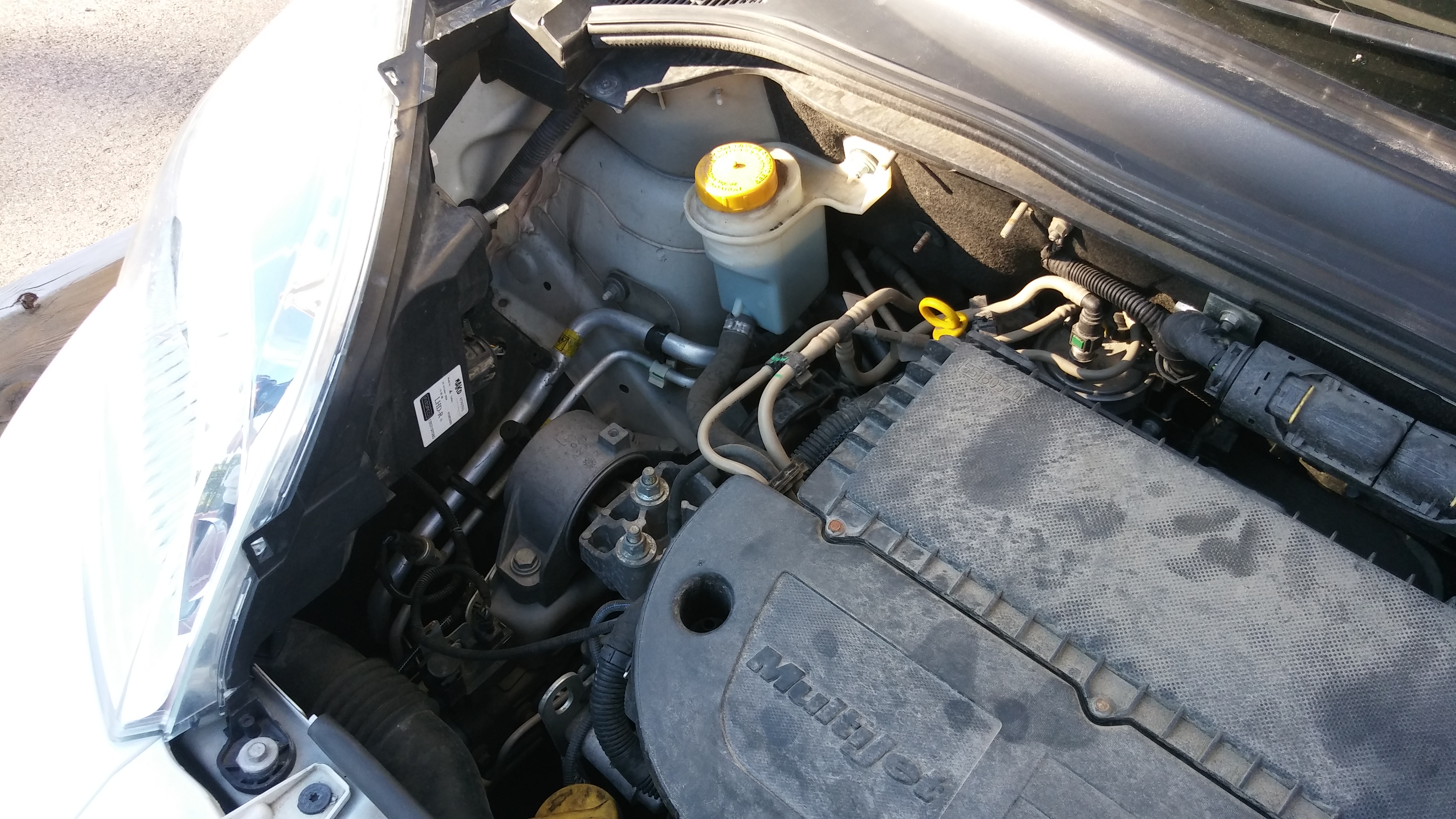

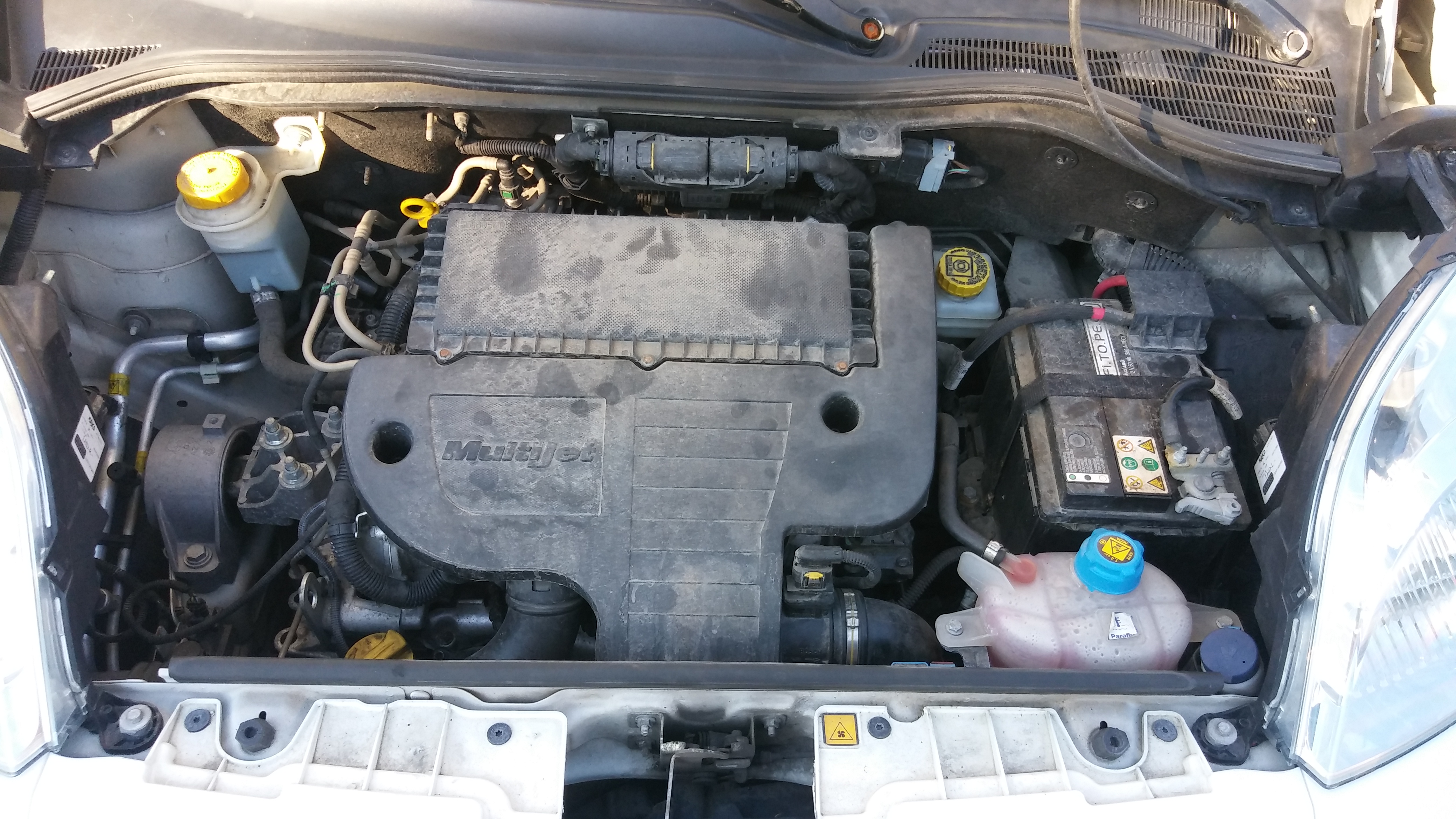

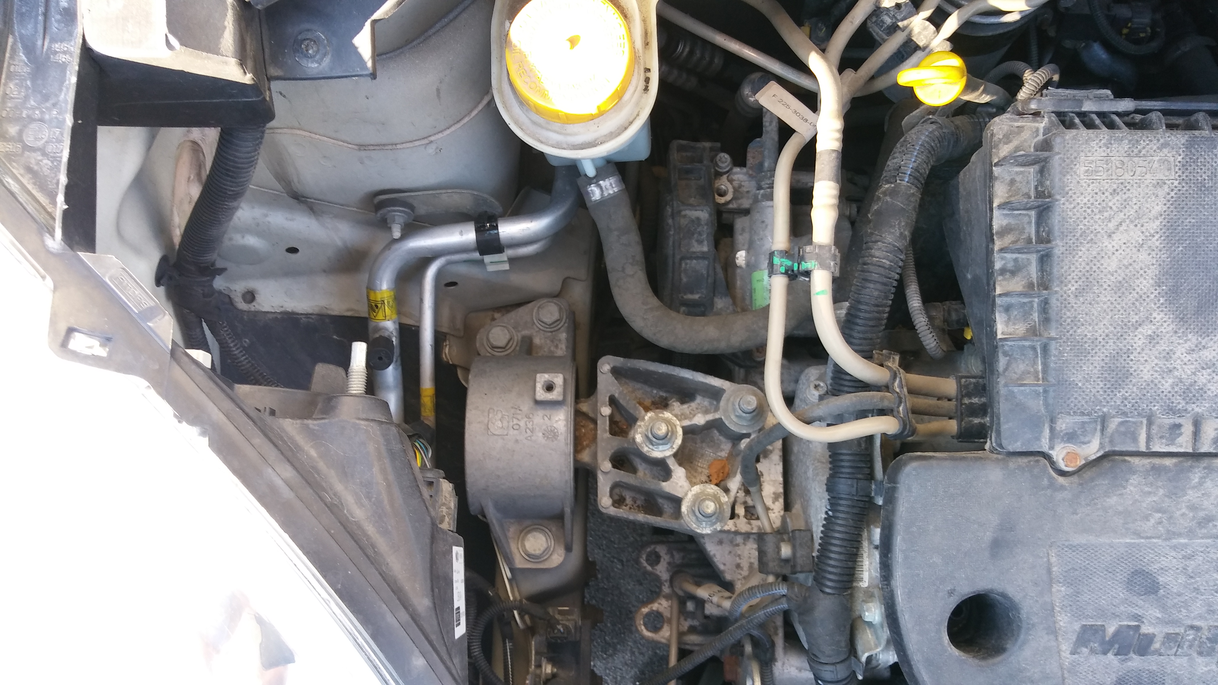

I have a Fiat Qubo 1,3 Multijet from 2009. With 104000 km on the clock. I need help with cleaning of my engine. What do I need to cover up before? Something I need too take extra careful around?
Pictures of the engine would help me understand what I need to cover and other things.
Thank you!

My method of cleaning an engine bay is not recommended but is the way every car dealership will do it.
Spray everything with a liberal coating of soap or detergent, give it a minute, then blast it with a pressure washer avoiding anything electrical (basically just the big plastic bits give everything a swish round with a large paint brush if there is still dirt, then rinse.
Never spray anything electrical and never spray the battery or the air intake. Never do it on a hot engine some people will very carefully cover anything electrical in cling film
Hello and thank you :)
If I will use your method, would you recomend to cover something under the hood? Battery, generator etc? What is most emootionally for water?
Thanks for the help!

Yes
Battery. ECU. Alternator
Abs glow plugs aircon pump
Then all of the exposed wiring connections
Did I mention its a job that needs care ;)
What charlie here suggests.
I don’t because I’m reckless and to be fair I’ve steam cleaned dozens and does end of cars in my time. If I cause a problem that’s my problem so if you’re not sure what you’re doing, definitely cover things up
