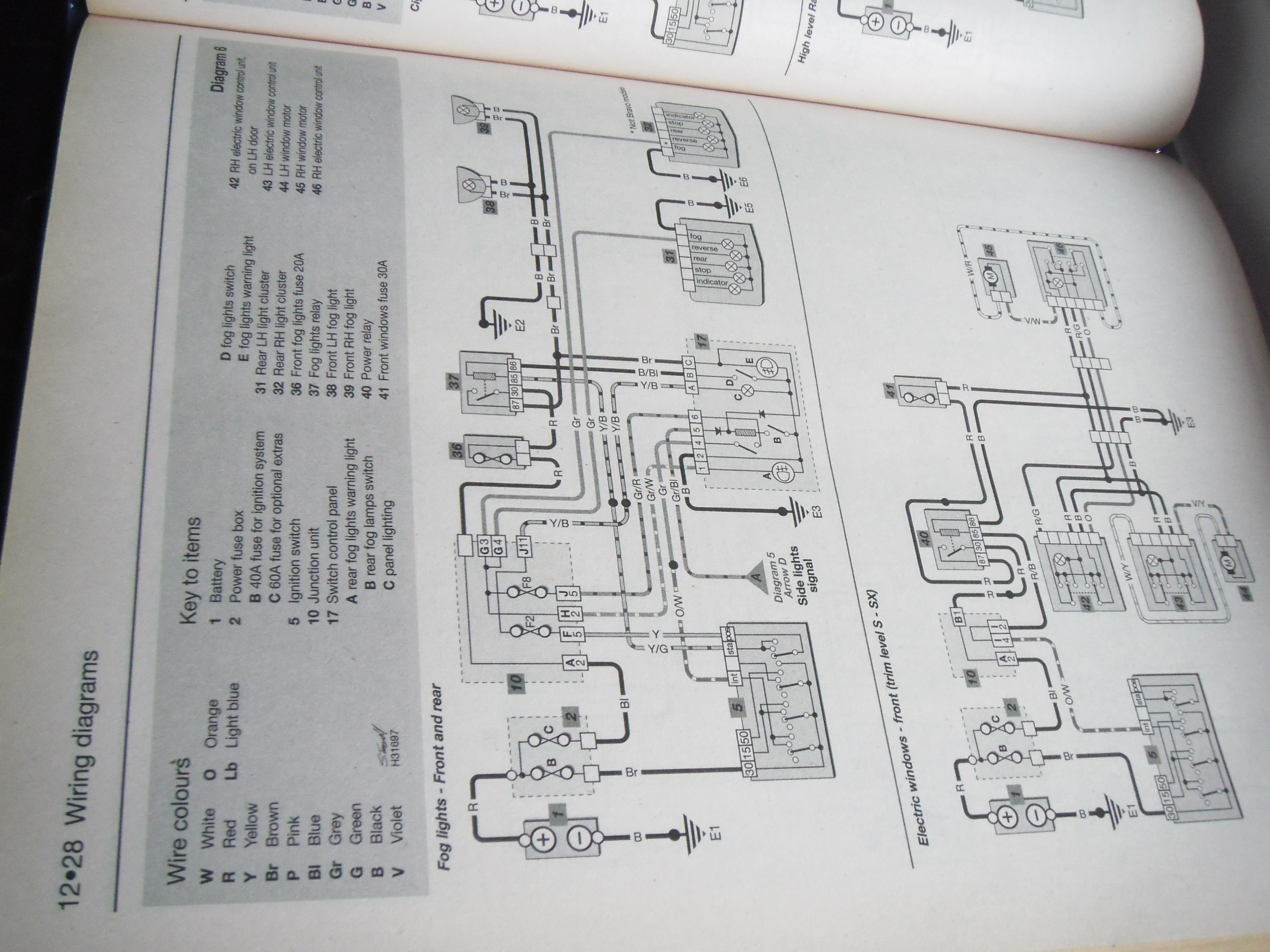

Hi, I recently purchased a universal remote central locking kit for my Fiat Bravo Mk1 1.6 SX(2000 model). I need a circuit/wiring diagram for my car in order to install it as unfortunately I don't know which wires are for what. If someone has the mentioned diagram available I would appreciate if you can scan a copy and send it to me. Thanks
can't spot it in the porter manual,
and as usual the Haynes is poor
closest I could find..
so.. is it the lock wiring you need..? as that ssems hard to find..,
Neverth or AdrianBravo
may have better info,
Charlie
Hi Charlie,
I'll print them out and have a good look at them later, but they look like what I needed, Thanks anyway for your help !!!
I think its one of my old posts. I remember the system for lock/unlock just to be two wires which are pulled to ground, one locks, the other unlocks all.
Drivers door wiring (maybe passenger, depends) has them and I think the old post even had wiring colors...?
