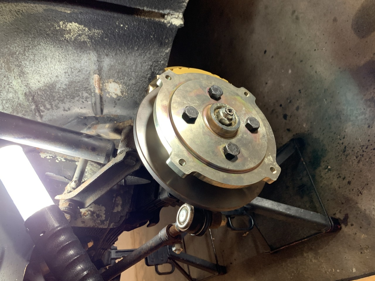

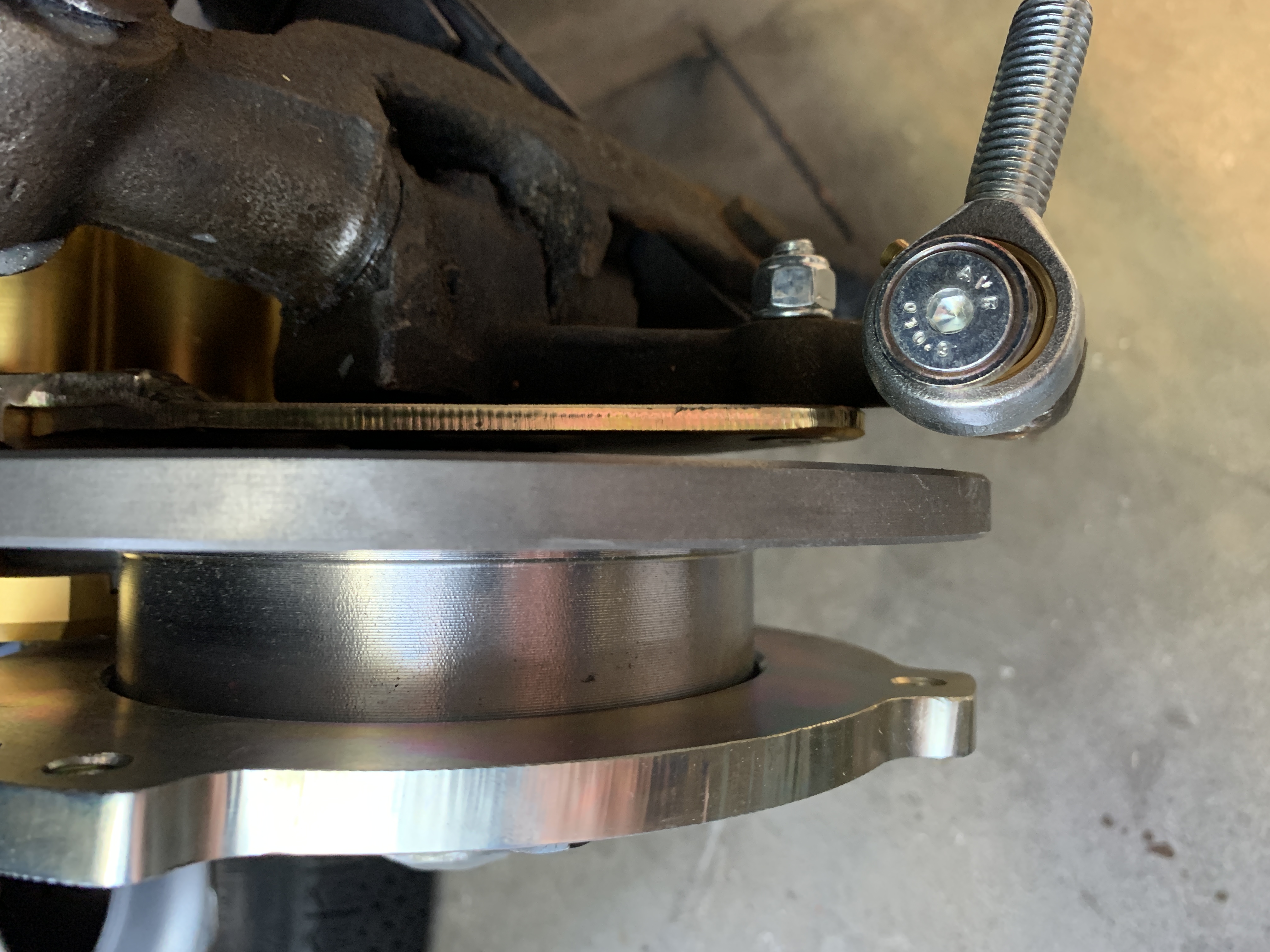

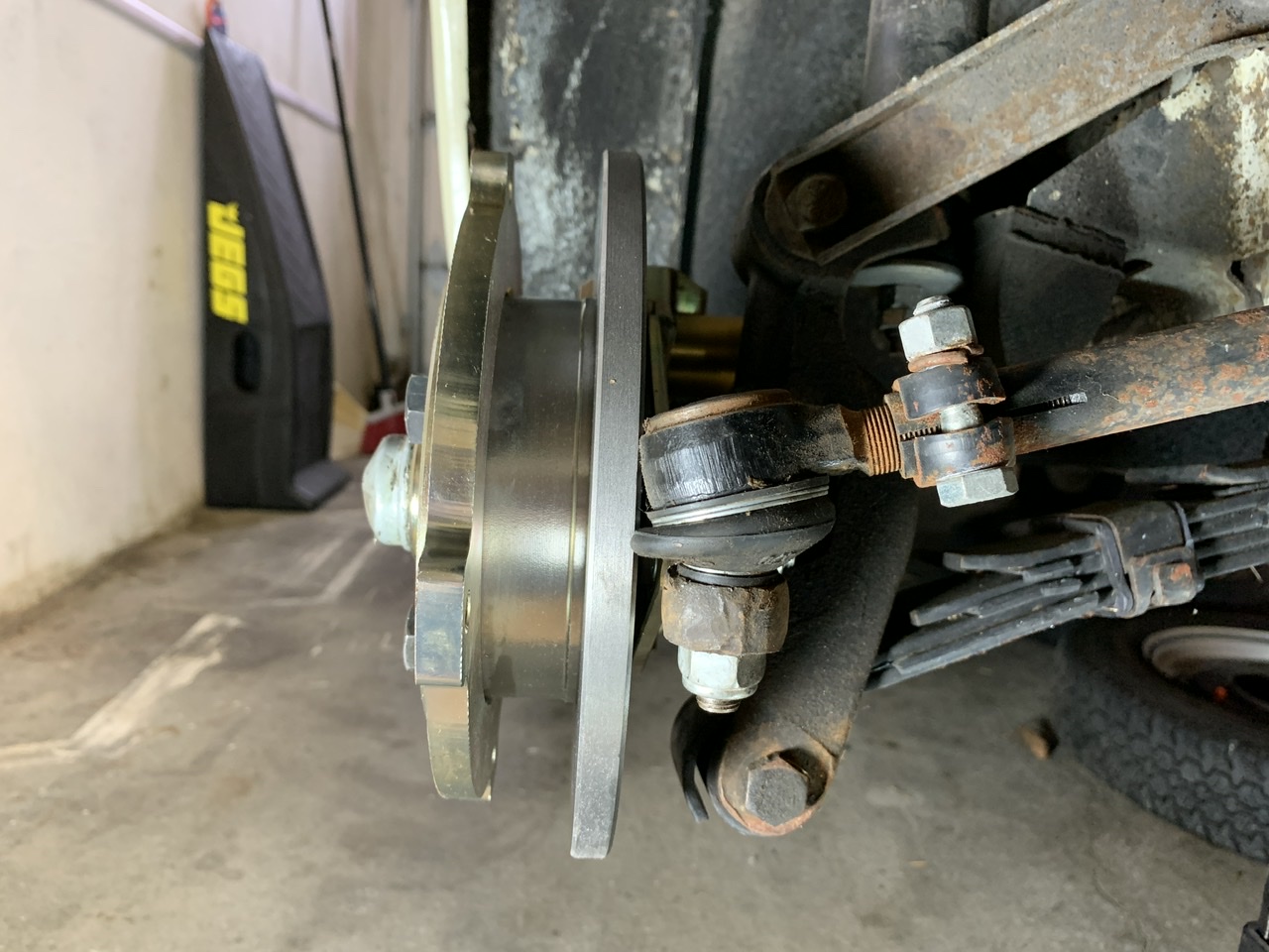

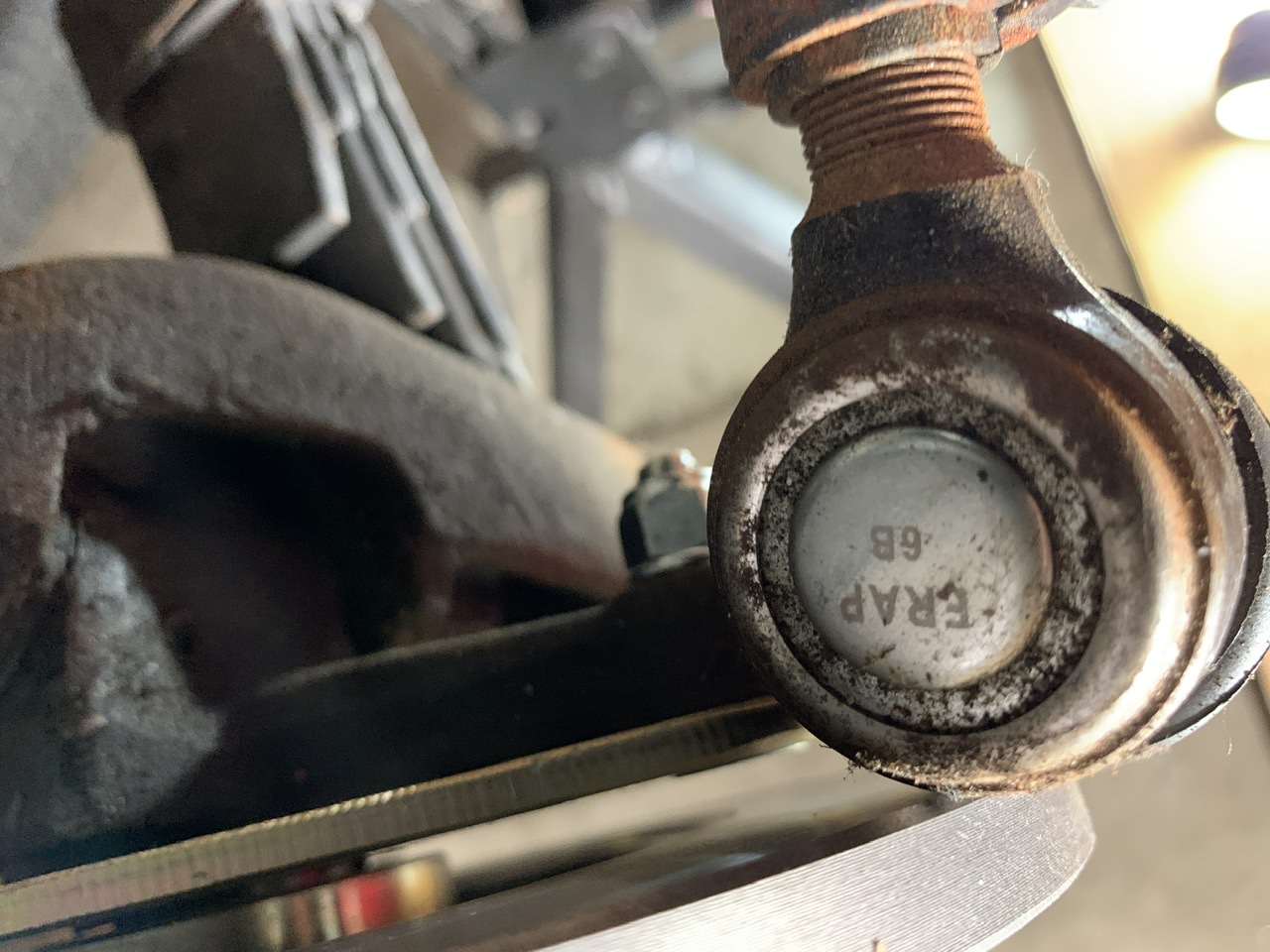

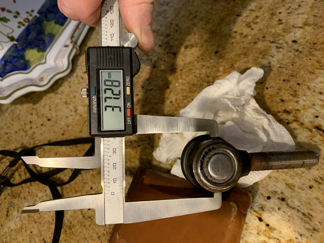

Hi all - been working on a disc brake conversion on my 1971 500L. I bought a kit that’s admittedly over the top for the car, but seems very good quality. Anyway, I have the new calipers and wheel hubs bolted on and all set. No wheel clearance issues except that the tie rod ends (ball joints) and their rubber boots just lightly contact the brake rotors (discs) on both sides. It’s not enough to impede the rotors from turning, but definitely a problem because the spinning discs will cut the ball joint boots and probably occasionally contact the discs metal to metal. I have to increase the clearance.
Below are a couple of photos. It looks like the ball joint is severely cocked but even when the car is set down off the lift and the tie rod angle relaxes a bit, it’s still too close.
The tie rods are relatively new - they FRAP. They are pretty robust, but clearly fit prior to the new disc brakes and had no issues with clearance from the old brake drums. I recall the original factory tie rods and ball joint heads being much smaller, but unfortunately I binned them after I replaced them. But my recollection of the originals makes me think the brake kit designer had them in mind when he designed the kit. I think they were small enough to provide clearance.
Wondering if anyone has any ideas. Thanks!

Incidentally, I tried flipping the tie rod upside down, but it won’t install that way due to the tapered seat. It only fits as originally installed, bolt side down.
Have you thought about having the discs reduced in diameter by a couple of mm? Have a look where the pads are incontact on the discs. If the discs extend pass the pads, this part of the disc is not required; have it machined off.
That’s a good idea. I was hoping to not have to pull them all apart, but probably is going to be easier than finding “just right” tie rods that I’m not sure exist. I do have to be careful about the pad; I don’t want it off the disc, but I should have a few mm to spare. I’ll give it a closer look.

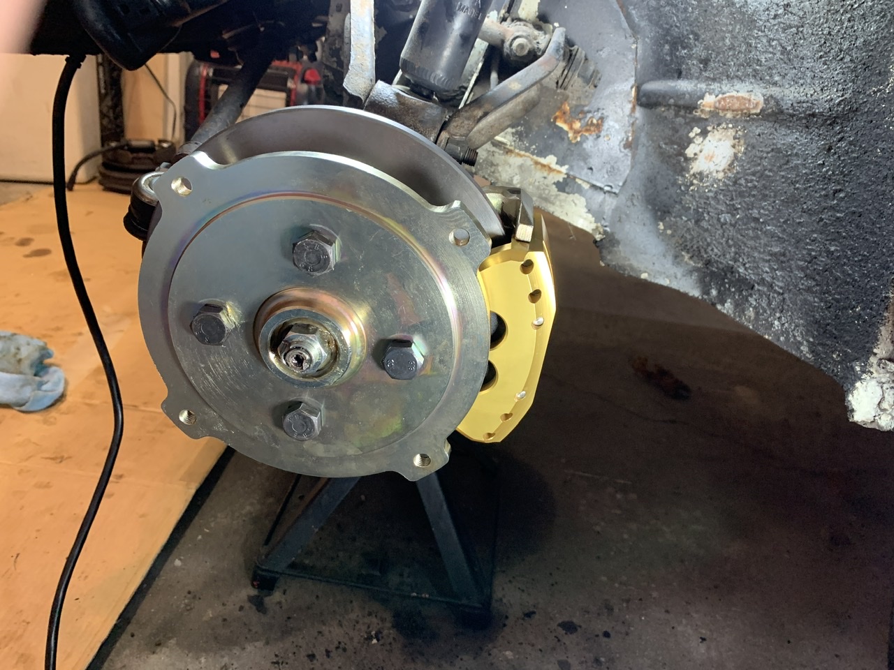

Thanks for those thoughts. The kit was supplied by FD Ricambi in the Netherlands (good vendor - I have received many excellent quality parts from them). But it also appears to be the same “A quality” kit sold by other vendors, such as Axel Gerstl, but the rotor (disc) I have seen pictured on other vendors’ sites is usually drilled. The calipers are high quality and there were no other fitment issues (clearance for original steel wheels is fine, spindle and retaining nut are all good, wheel bearings and races transferred over and fit fine). The only issue I had was that the original wheel bolts were about 5mm too long and I had to grind them down so they didn’t hit the calipers. I also got a a new dual circuit master with the special right angle brake pedal actuator bracket, and I am redoing all the copper lines to the front brakes.
My inclination at this point is as Hobbler suggested - take off the rotor and have it machined down by half a cm or so, to provide extra clearance. That would enable me to use the existing FRAP tie rods and not mess with the wheel hub/spindle dynamics. I just have to confirm that reducing the disc diameter won’t create issues for the pads being too large and riding over the edge of the reduced size disc.

Yes they are mounted on plates. My kit looks identical to the kit posted by another member here (see attached), except the disc in that phot is drilled. I don’t think I can move the calipers inward to accommodate making the disc diameter a little smaller unless I really reengineered the caliper plate/mounting brackets.

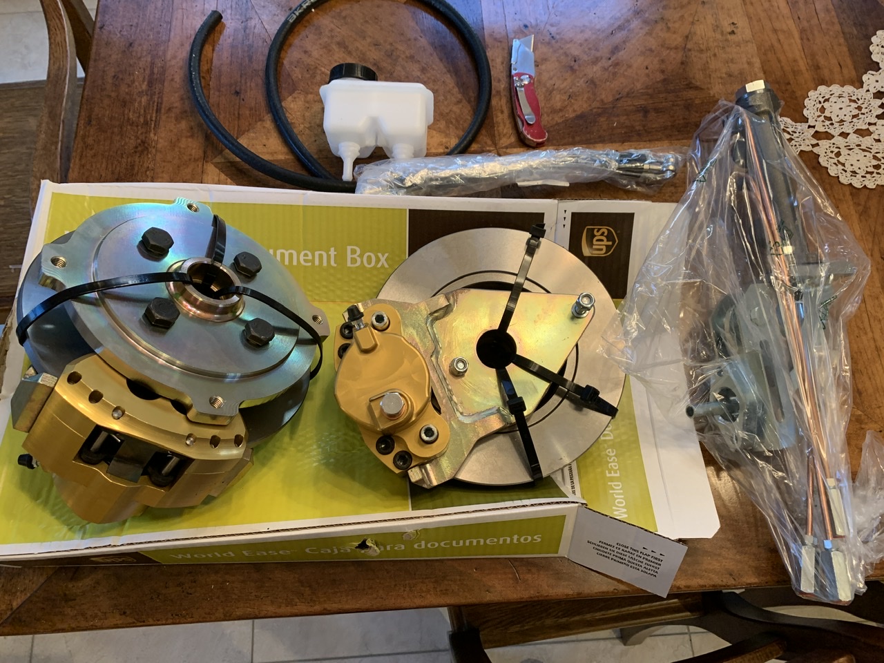

My kit:
That looks like a tidy set up once you get it sorted. When I first got my 500 the brakes, king pins and wheel bearings were all shot. In those days I did not shop outside the UK so bought the £450 Ricambio set up which solved the problems. When I examined the parts a few years later I realised that the main brake parts were modified Fiat parts. The discs are machined down in size, the calliper carriers are cut away in a couple of ways and the disc pads themselves are cut down. I have never seen replacement parts available so if you are in the same situation as me you would need to have these parts specially made.
Yes, thanks. I am not expecting to ever need to change the pads due to wear, given how little distance I drive mine, but I guess you never know. I figured if the time comes, I’d have to do a bit of goose chasing to find the pads the kit maker used, which I suspect are from a Fiat relative of some sort!

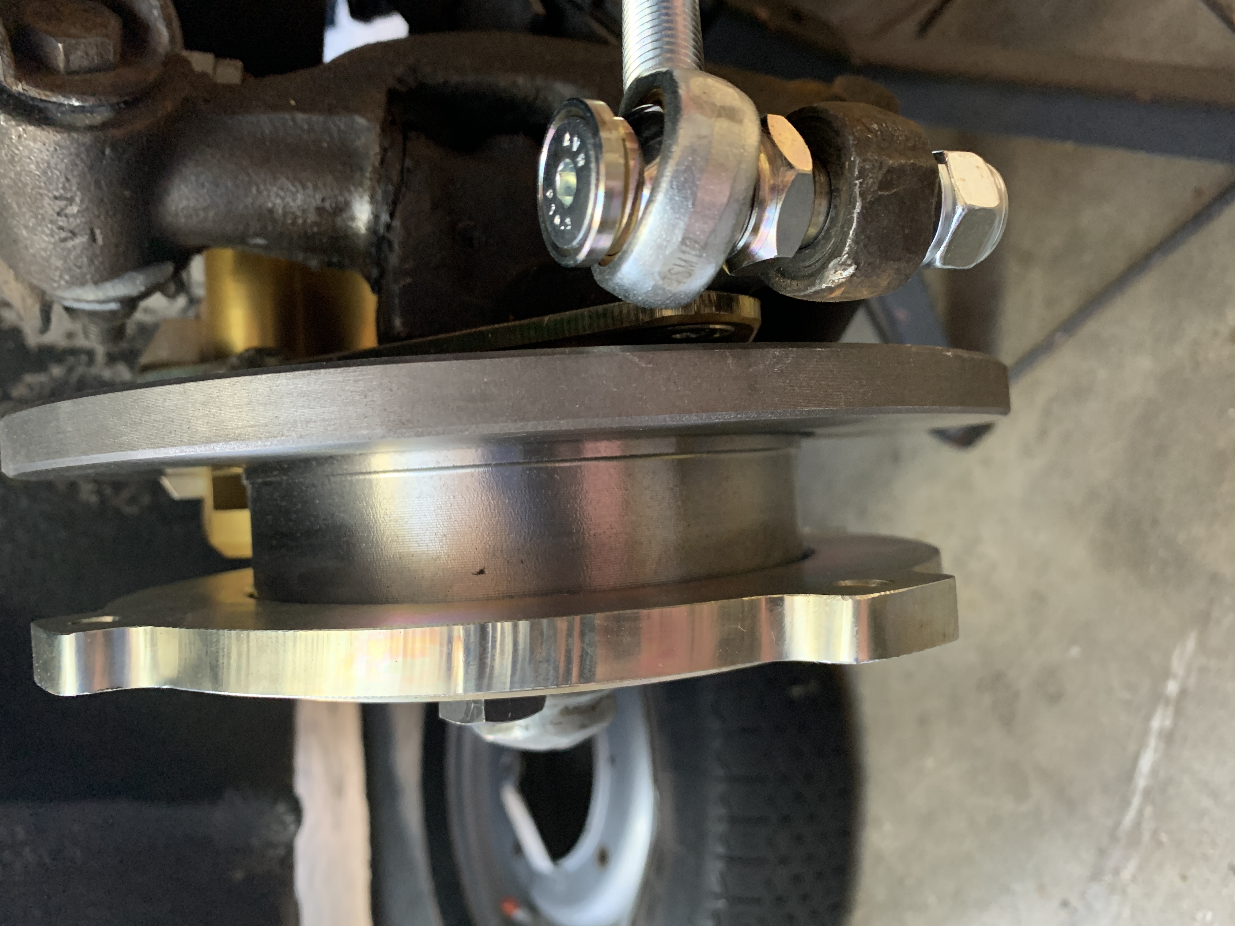

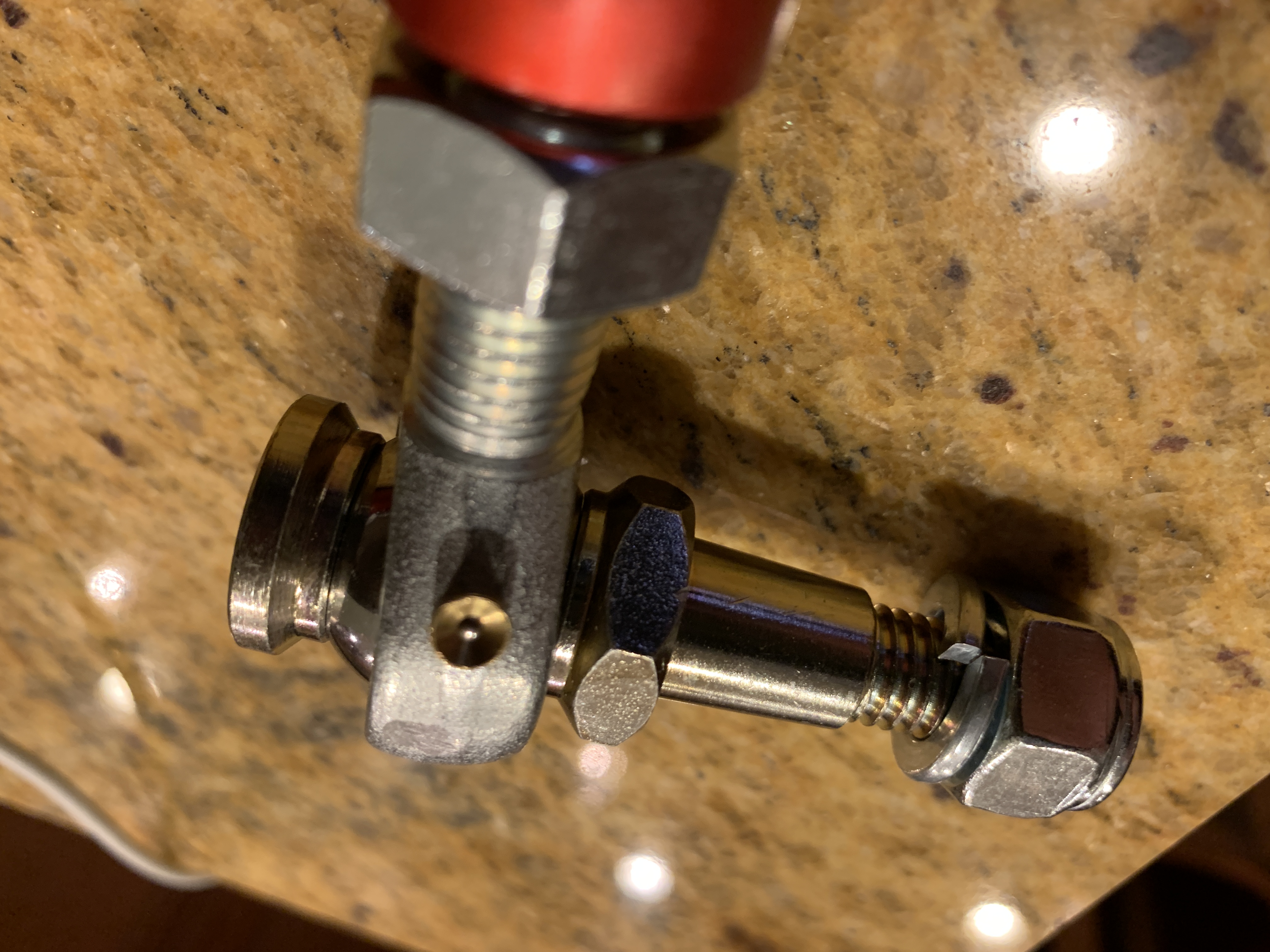

Hi all - so I found a solution that doesn’t involve modifying the discs, which I cannot do anyway, because the pads are already at the disc edges. I found “uniball” style tie rods and centre link that has a head diameter around 30mm. It fits - no clearance issues! These are made by ISB Industries. Now I just have to figure out how to grease them, and make sure I install them correctly!
There are special spray lubes for uniball joints. CRC makes a "Dry PTFE Lube" or there's Tri-Flow's Uniball and Heim Joint Spray lube. DON'T use grease or WD-40.
Curious how much noise/vibe these transfer in the little cinquino, but they should help tighten up the steering a bit.
Thanks! Makes sense. The lube nipple is ridiculously small - 5mm, and looks like it would only accept a thin oil like PFTE. Now I’m trying to find a lube container/spray tip that mates with that tiny nipple. Looking forward to installing it all. Hopefully doesn’t make steering unpleasant. I never intended to change the standard steering, but this was the easiest way to solve the brake disc clearance issue.
