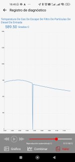

Just an update: today I saw two regen attempts during my drive, both with a lot of white smoke. In one of them, the DPF temperature rose to around 800°C, but then dropped down to about 580°C before the regen was interrupted. There’s no clear pattern in pressure or temperature when the regen cuts off — values go up and down but nothing looks extreme.

About the temperature: I’ve seen the DPF temp reach 800 °C during regen attempts, but the actual cutoff doesn’t happen at that point — in fact, when the regen cuts off, the temp is around 580 °C. So maybe the peak temperature isn't the trigger after all. I haven’t found a consistent pattern between temp, pressure or speed and the regen interruptions.
Eventually the DPF did regenerate properly after the last trip, and the saturation dropped to 16%. But I’m still trying to understand why so many regen attempts get aborted before that.

Re: the data, how high does the DPF temperature go before it gets interrupted?
Sorry, because my later answer:
In the interrupted regeneration attempts I recorded, the DPF temperature rose up to around 800°C. However, the actual cutoff didn’t happen at the peak — it occurred when the temperature had already dropped to about 550–580°C, several seconds after the highest point.
So it doesn’t look like the interruption was due to over-temperature. It seems more like a logic or electrical event — possibly a momentary ECU reset or protection trigger, because the dashboard briefly showed the ignition “check” messages, and the OBD data stream dropped momentarily at the same time.
