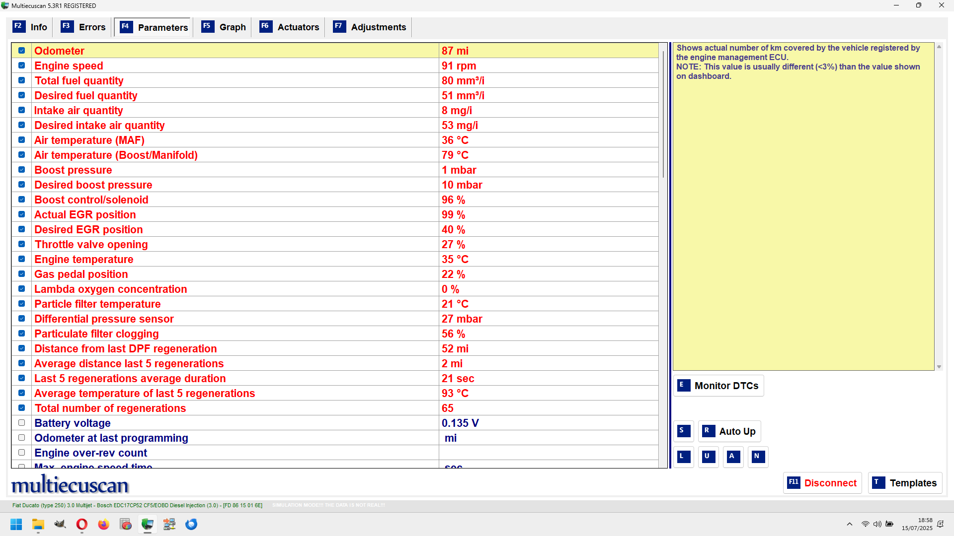

Attached is a template for the 3.0
intended to ivestigate the DPF
Run it for 20min at least 10 mins when upto temp
Once you do the recording check for even brief anomalies in the differential pressure reading.

I will try to do that when I’m home from vacation as you can see in your template dpf clogging is 56% mine never goes above 6-7 %
The clogging info is simulated data. The value used to trigger a regen is typicaly 100%. The differential pressure sensor is well known to be a problem with early models because of its position low down and condensation. And as mentioned some after market versions cause issues.
