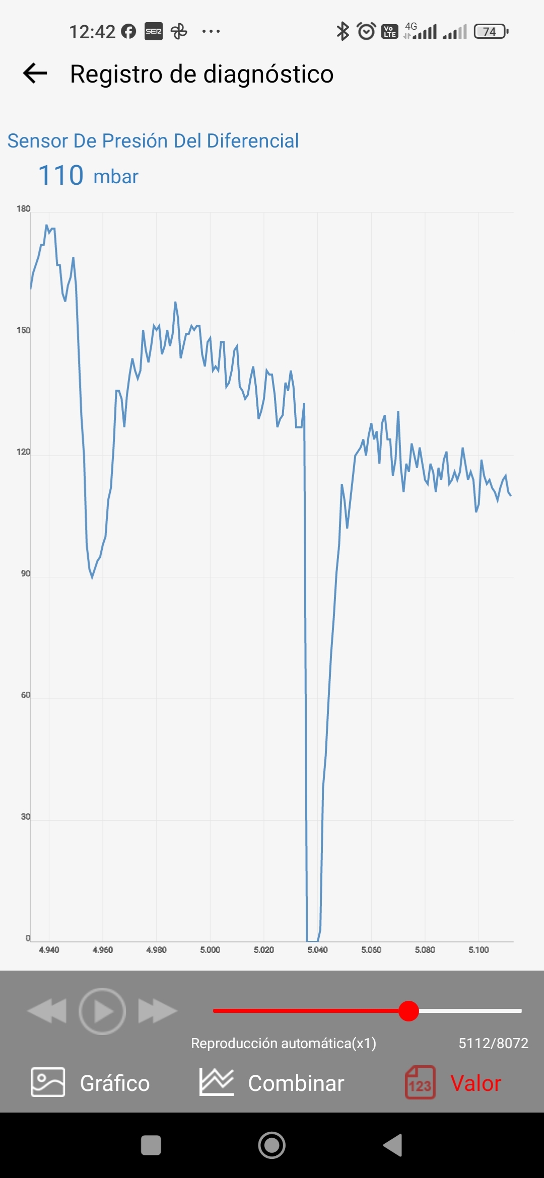

What I can offer is if you record a regen attempt with the speed, rpm, instant fuel consumption, differential pressure, DPF temperature I can try to match that next time mine is due and we can compare the data. Ideally with some normal driving before.
Looking at your graphs again, your DPF is quite blocked and the soot load should be way above 100%. Do you have a longer recording?eplace

I can't export my recordings. I use Ediag app.

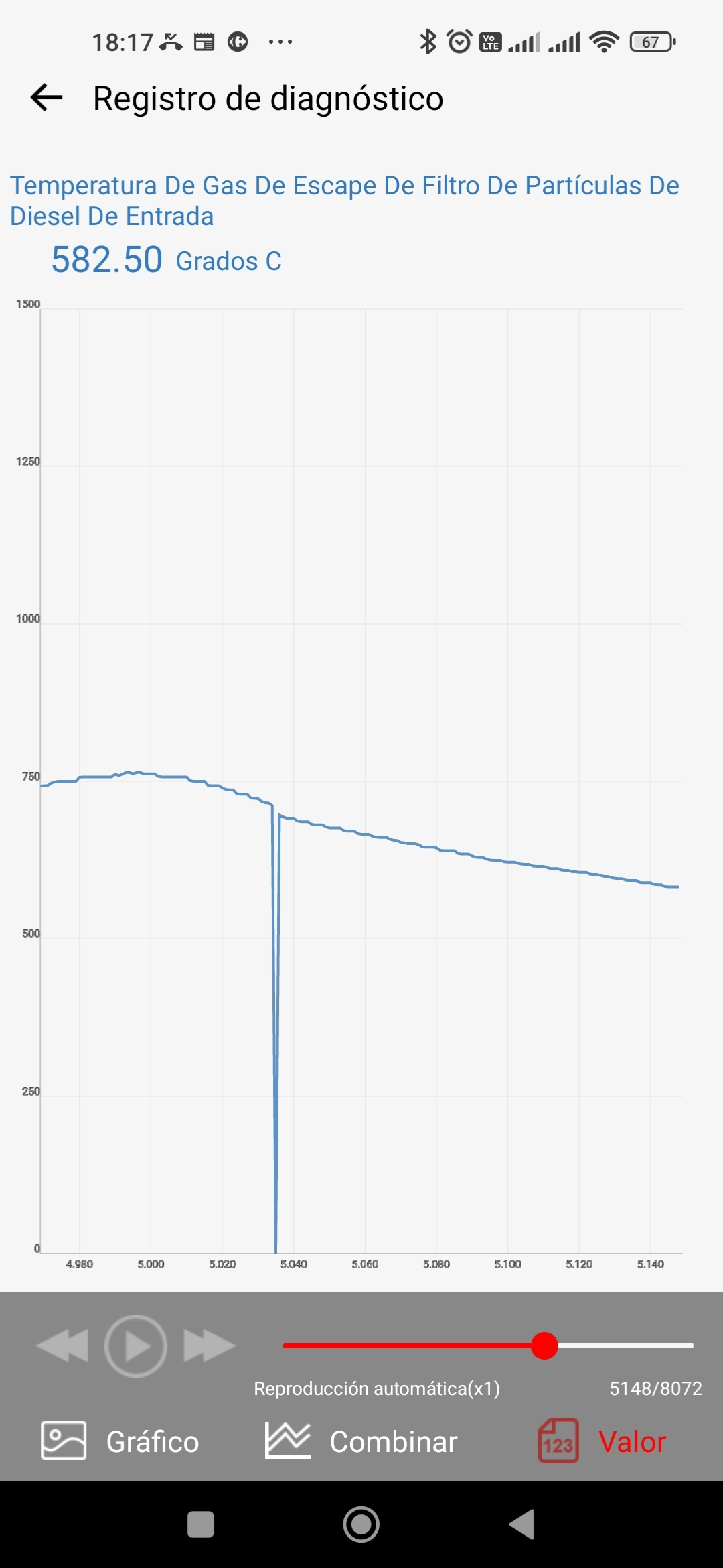

Yesterday, during a regeneration cycle, the temperature at the DPF inlet reached 893 °C, then the process stopped suddenly and the ECU stored code P2085-11 (exhaust gas temperature sensor fault).
So, even with the new DPF, new sensors, and a clean intake system, regenerations are still interrupted due to excessive temperature and heavy white smoke.

Have you got any data of a regen with percentage clogging. Have you a graph of the inlet reaching 893C.

Here you have the graphical when the temperature get 893C. And then when it fall to 200C when the error appear and the regeneration is stopped.

It looks like the temperature sensor may have actually burned out during this event.
When I stopped the engine and started it again, the sensor began reading correctly. But I’m afraid it might have been damaged. I replaced it last August.
It’s crazy to replace it only for it to burn out again on the next regeneration.
