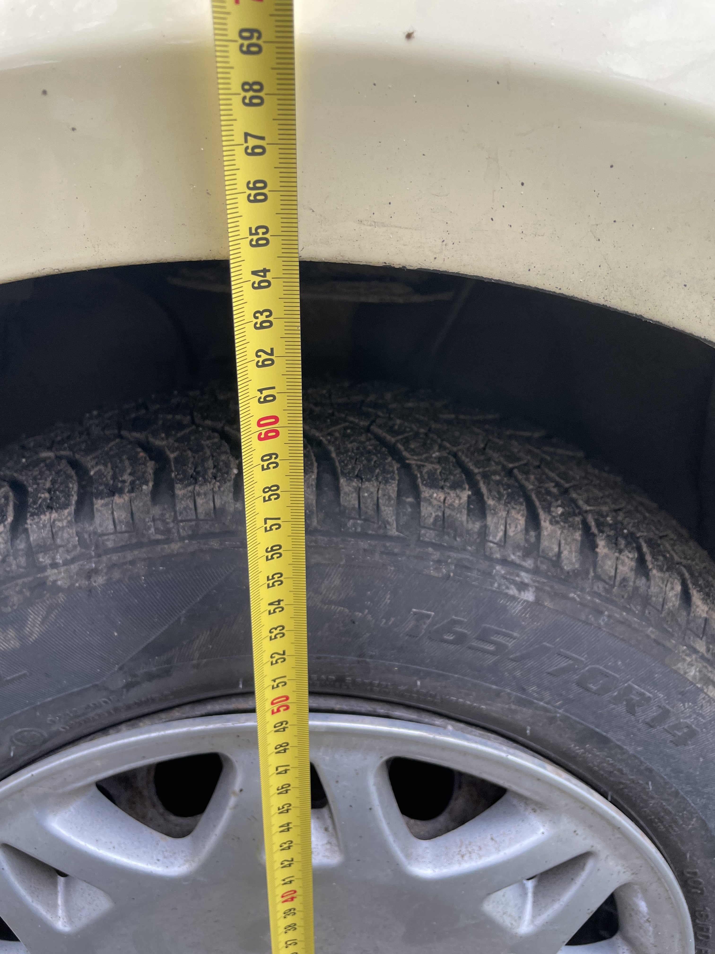

What's the height from the ground, vertical through the center of the wheel to the wheel arch
Should be 631mm for the 2wd

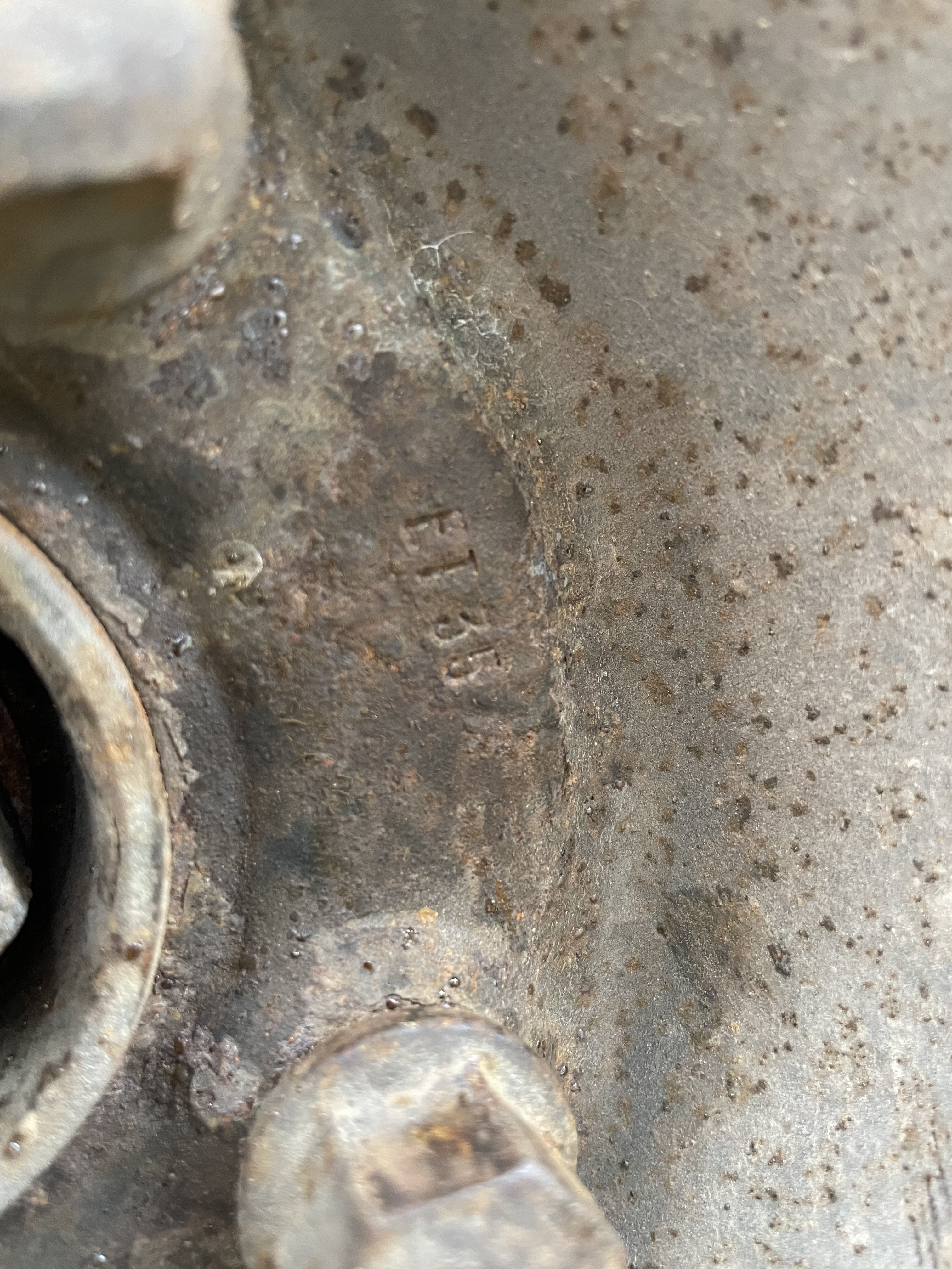

It was bought new from Italy by my colleague, who later drove it to Estonia and then sold it to me for 300€. It has original 14 inch steel rims with ET35.

I measured the distance from ground to wheelarch - 645mm. I think the NaturalPower(CNG/Metano) version sits a bit higher since it's based on 4x4 body but I might be wrong. There used to be two pressure tank under the belly - one in the RWD shaft tunnel and other under boot floor where AWD model has rear axle differential. I had them removed due to our stupid regulations so now it's just a regular petrol car.

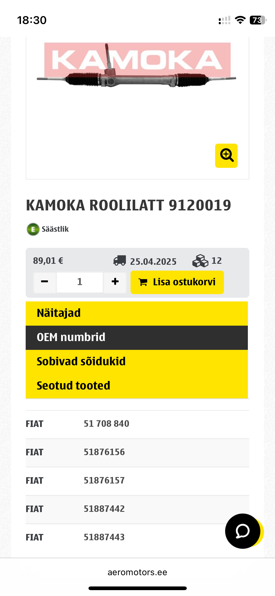

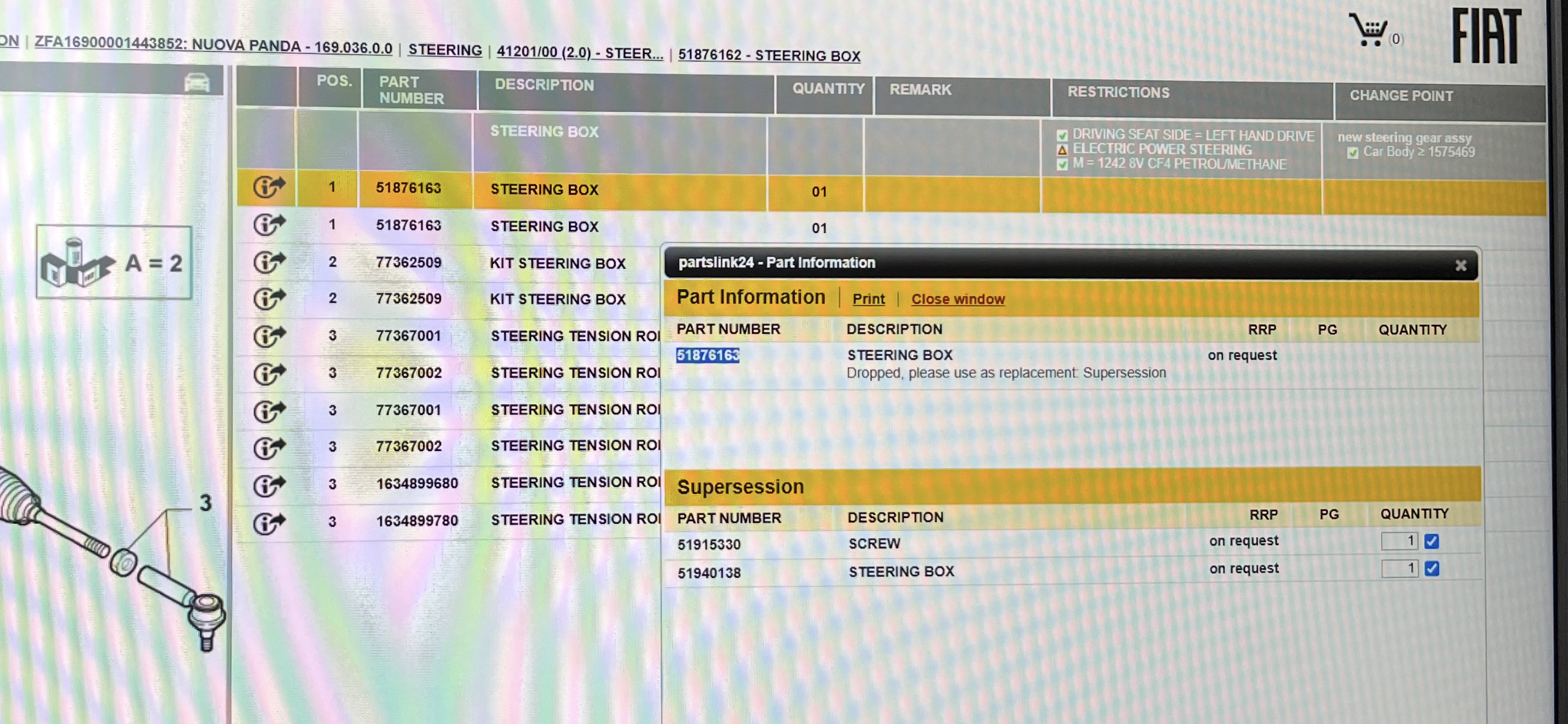

Today I asked from my local mechanic to search for the part based on VIN, he agreed to assist and sent me a pic with correct part nr highlighted - 51876163. Can anyone confirm, maybe based on ePER as I can't seem to find correct answer?

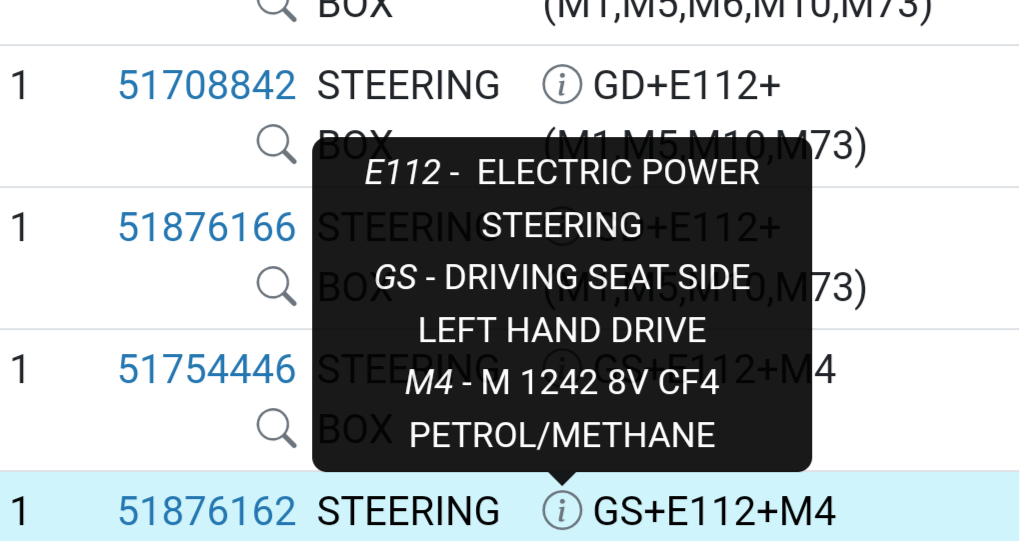

Hi, original is 51876162, so that or new compatible like 51876163 and 51940138.
  • Like
Reactions: juh
As per post 2
Any 2wd petrol LDH EPS rack 2003-2010 is fine
So 51915483 51940138 51876162 51754446 and so on
Or TRW JRM485
But if it's based on the 4x4 chassis and front subframe this could be wrong as the 4x4 uses a different rack and has different front geometry
