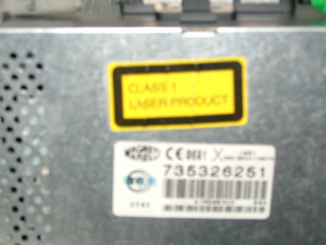

Post a picture of the unit and the part numbers from the paper label stuck on top of it.
Yes the cd works stereo too,also has a phone inbuilt the slot on the side
its a magneti marelli c141
Ive attatched 3 photos (hopefully)

Your picture is of a Ducato Connect Nav+. The part number (735326251) is listed in the Fiat parts catalogue with a price but it doesn't say which model Ducato it's for.
Assuming the unit is fully working, the navigation module should work with the normal CN+ NIT G1 navigation disc, but I suspect you will have problems connecting it to the Peugeot CAN system. It's also likely to ask for the Master Code if you do get it connected.

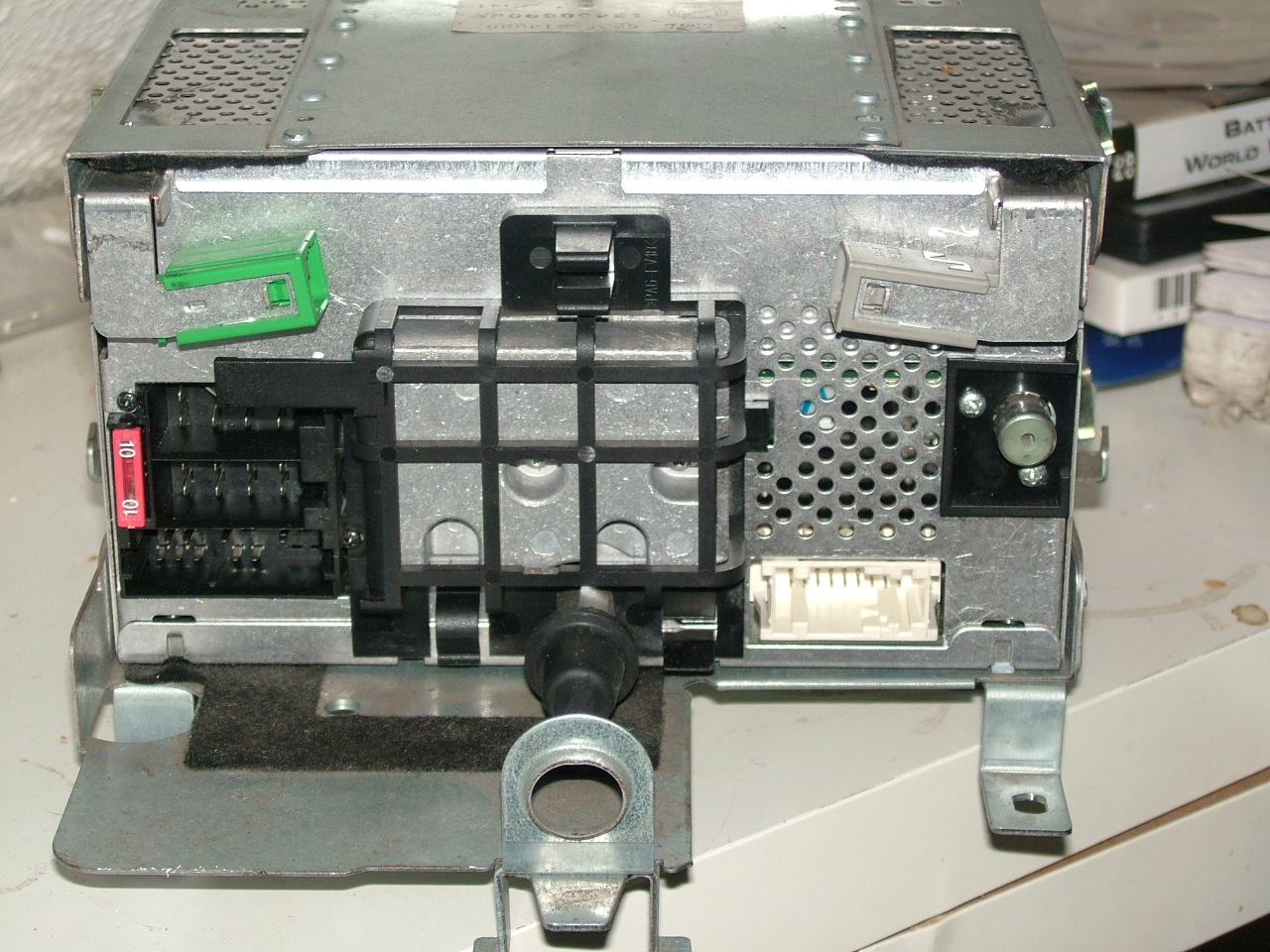

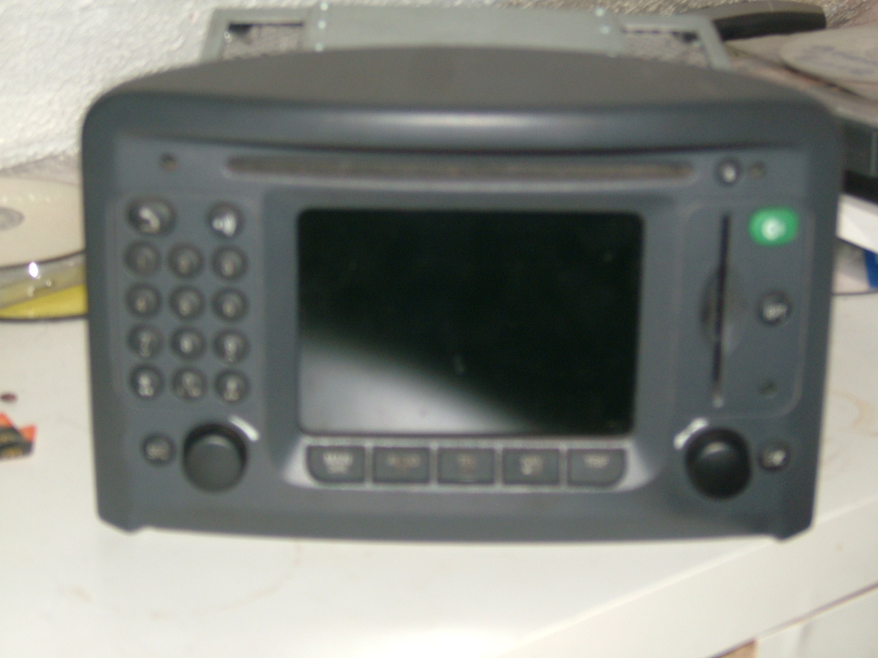

Does the unit you took out of the Peugeot look similar to the Ducato one? Post pictures of it, front and back.
Have you got the Ducato unit working while connected to the Peugeot Boxer wiring plugs or have you just connected it on the bench?

it is exactly the same unit as far as i can see (buttons plugs part number everything except serial) the fiat unit works fine, photos are the peugeot unit,as the fiat 1 is fitted and a bugger to remove. the only diff i could see was the screen boot logo, fiat now but was a pixelated peugeot with the old 1 part of the fault.
