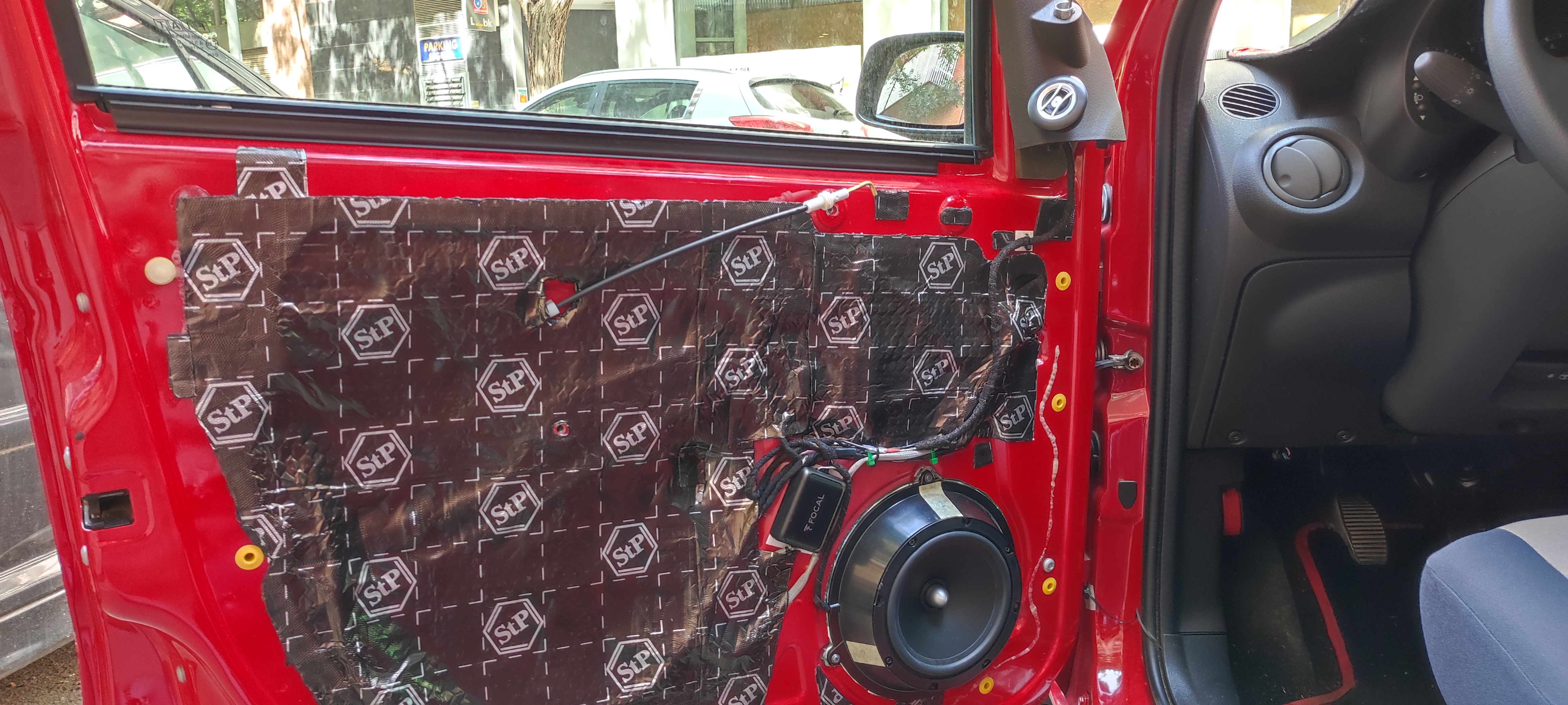

Hello! If you want to change the head unit, I recommend you a well known brand instead of a cheap Chinese one from Amazon. You know: alpine, pioneer, kenwood, clarion... in my case I put an alpine UTE-93DAB on it and the improvement is huge. I have also changed the speakers for 2-way ones. RSE Focal -165. And 2-channel Hertz amplifier. It is essential to insulate front doors. I put the tweeters in their original place. But I didn't like how they sounded, they lose a lot. So I anchored them directly to the mirror covers
. They are well oriented towards you and very secure. If you are interested in more I will tell you about the subwoofer that I have installed. It's worth it. You enjoy driving much more. It's like being at a party.
Hello! If you want to change the head unit, I recommend you a well known brand instead of a cheap Chinese one from Amazon. You know: alpine, pioneer, kenwood, clarion... in my case I put an alpine UTE-93DAB on it and the improvement is huge. I have also changed the speakers for 2-way ones. RSE Focal -165. And 2-channel Hertz amplifier. It is essential to insulate front doors. I put the tweeters in their original place. But I didn't like how they sounded, they lose a lot. So I anchored them directly to the mirror coversView attachment 413991. They are well oriented towards you and very secure. If you are interested in more I will tell you about the subwoofer that I have installed. It's worth it. You enjoy driving much more. It's like being at a party.

If you add an active subwoofer the sound improves much more. I put an 8 in. Hertz in the boot and insulation too.

I can't ear the exhaust anymore. Even I've insulate the bonnet. I couldn't resist. Too much easy

What type of material is this that you used for the sound proofing? Any tips for installing it? :)
from a webstore here in Spain: Solocaraudio. The manufacturer is STP. There is another manufacturer just as good: CTK. There are other manufacturers like gladen or focal that also make amplifiers and speakers, but they are more expensive perhaps.
In YouTube there are a lot of videos about STP. They teach you how to apply the materials. It's very didactic.
There are several types of materials. Depends on where you want to put it.
